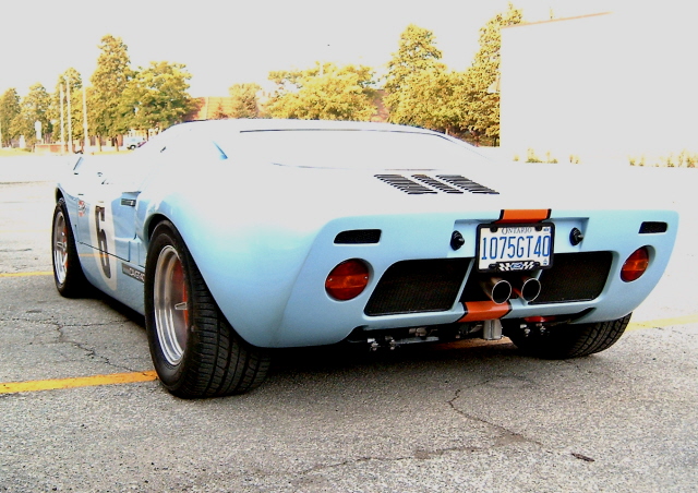

Having a look around at original GT's I have seen some vents on the rear that I have not noticed before. Can anyone point out what they are for? Releiving pressure from the rear clam?

Dave, yes, most MKIs have the vents like that picture. Some cars like P1075 left them out completely to let out as much air/heat as possible. MKIIs had screens.

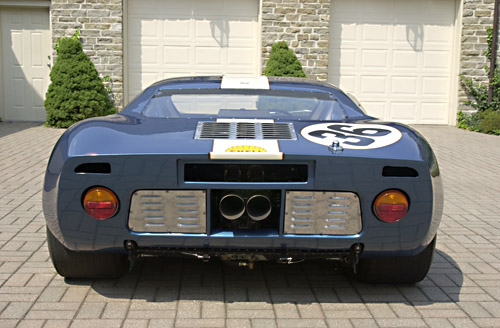

Are you talking about the stainless louvered covers either side of the exhaust or the 3 holes at number plate height (or where a plate would be on a road car)?
I must say I had not noticed the openings at the sides of the rear but would think that it could help remove heat / pressure from the rear corners of the engine bay.

While your question is a good one, that picture is a bad example to use for "original" vents. When the car was new the only vents on the back were the aluminum ones on either side of the exhaust. The three holes along the top were probably added when the car was restored.
If you want to see what the tail of 1036 looked like when it was new, take a look at John Allen's "GT40: The Legend Lives On", page 80 (it's the only black and white picture in the book). If you look closely at the picture of the original car, you'll see that the louvers get wider as the aluminum panel gets wider, something that they didn't bother to do when they restored the car.

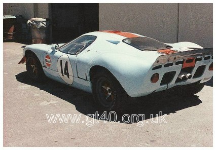

What is missing in the picture in Dave's post that nearly all cars with these high wheel well vents had is the adjustable spoiler that goes over them. You will see this adjustable spoiler on a lot of the Mk IIs as well. The spoilers have slots in the ends that match those in the fibreglass so that as it is raised or lowered the vents remain unimpeeded.
I don'k this know for an absolute fact, but I believe that this is one of the many tips, tricks and parts Ford passed on to JW for his campaign of MK Is in '68 and '69. As originally configured the early MK Is got real squirrly at speeds well under 200mph. The one other thing that was changed was the ride height of the car, which was not symmetrical front to back. The changes were primarily developed by Ford in wind tunnel testing. If you've seen the interview of JW, he talks about all the goodies Ford gave him when they pulled the plug on MK II and IV cars after the FIA effectively outlawed the big blocks. Those "goodies" included a lot of setup information in addition to hard parts for the cars.

I found this link http://www.racingicons.com/gt/1076.htm that shows the spoiler Lynn mentions on 1076. I also shows a detail shot of the corner vent I was talking about. THe text says it was a added to relieve pressure from the Wheel Well.
Has anyone replicated this spoiler for their Kit Car? It looks fairly simple in design but it would be great to know what the material used was. How high it could be adjusted into the airstream etc.

The front canards and wheel arch spats appear to be used on some of the Gulf cars for the most part. I have no idea if they proved to be effective but the Mirage cars were fitted so who knows? The rear spoiler looks to be left off 1036, maybe stainless steel?

The vents above the tailights were thought to improve rear brake cooling by reducing the air pressure in the rear wheel arches, therefore more air would feed through the ducts suppying air the the rear discs.
Im not sure if that was ever proven but they sure look cool.
The lisence plate recess was openned on race cars under the same logic, although to simply increase airflow and heat escaping the engine compartment.
The chin fins and adjustable rear spoiler were used on short tracks to increase downforce (decrease lift?) as the cars did get light at high speeds.

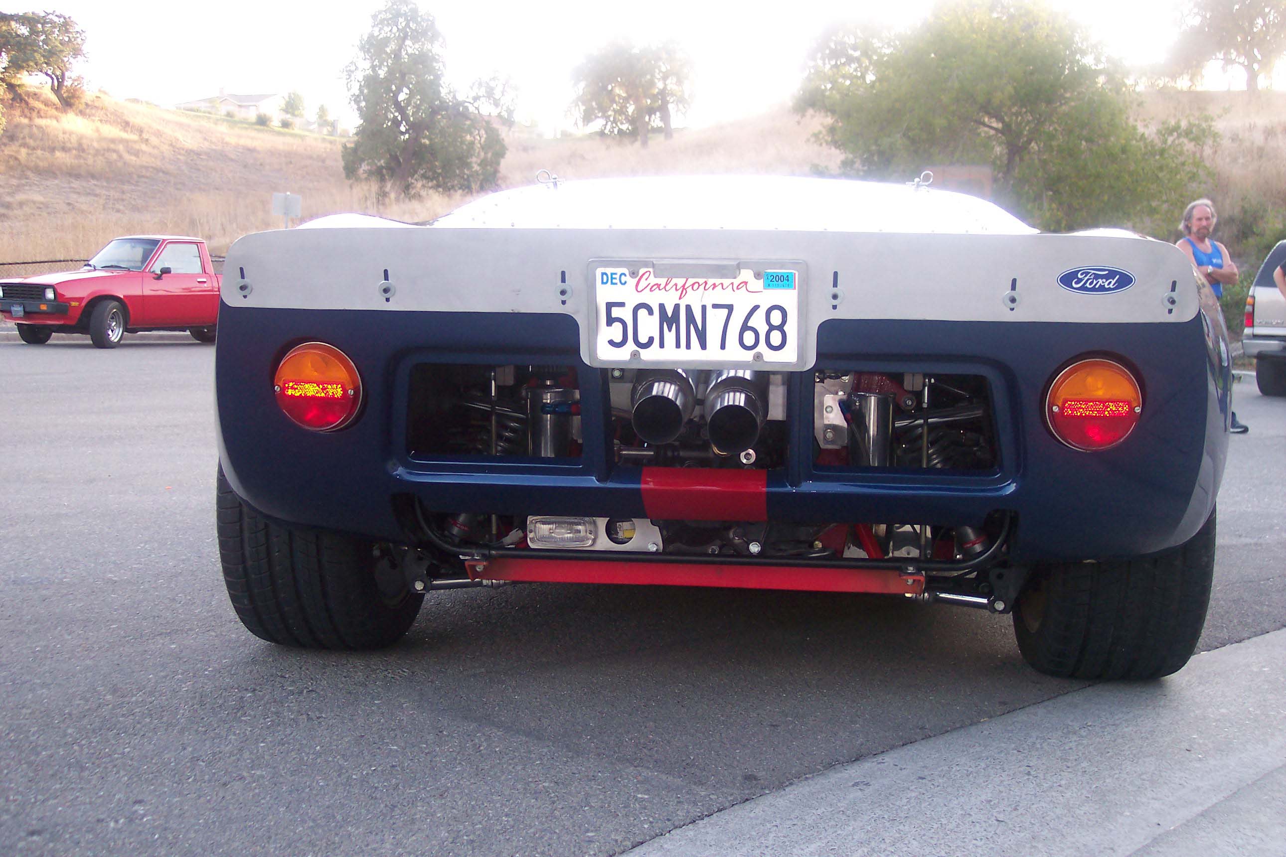

mine, I have no idea how well it works. It does make a very good license plate mount.
