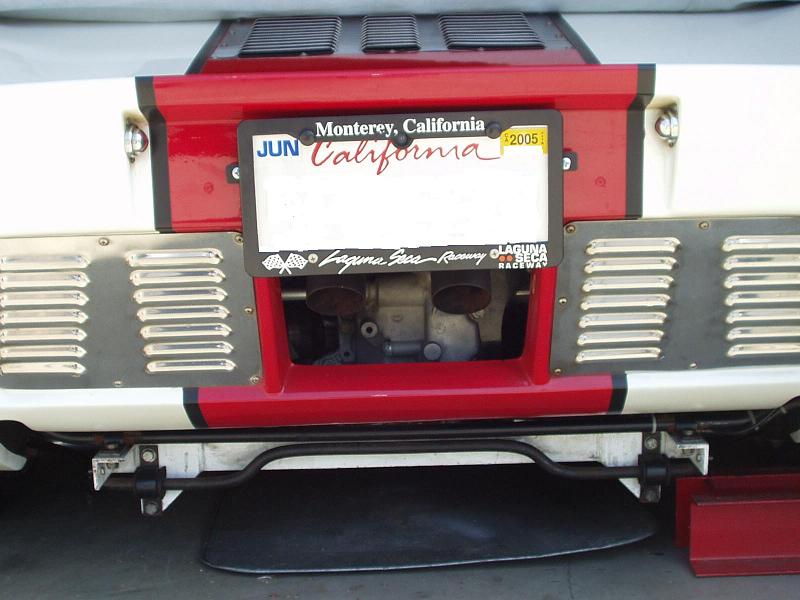

You mean like this (find the camera, not too hard)

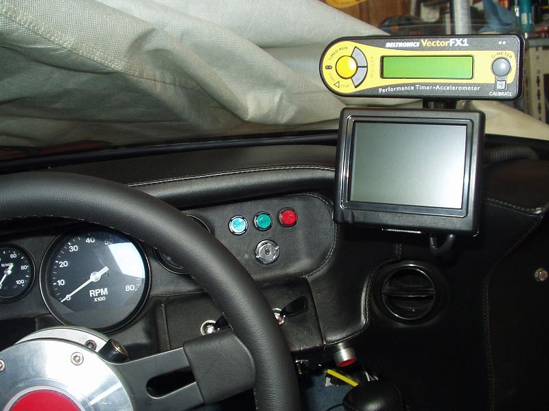

And the Monitor, (3.5", reversable), mounted on suction cup to windsheild. This setup was accomplished without drilling or cutting anything. Field of view being critical, this camera has 90d both vertically and horizontally. I tried a few and found too much and objects enter too quickly, too little and blind spots develop.

I noticed that you chose a 7" universal monitor, which may not do what you want it to, a 16:9 ratio is only good for 16: material such as anamorphic DVD, cameras of course are 4:3, you'll either stretch the image out (distorting it and losing resolution) or have bars along the sides, giving you a 4:3 monitor after all. I noted that it does indeed reverse which is needed, thats good, i thinkk you'll find as I did that mounting options are limited in the GT, especially if you object to cutting into anyhing, a 7" monitor is quite large when looking for a suitable spot, that same site has a 3.5" 4:3 reverse monitor which you might take a look at (its a bit less expensive than the one we deal with, though not as flexible). Feel free to contact me with any questiona, as I deal with A/V equipment every day.

So at 90 deg your camera view captures cars right off your rear corner, both sides?
If possible, could you take a photo to post here with the screen showing a car in such a position?
In addition, would that particular screen be able to accept two camera inputs that could be toggled from one to the other? In which case you could have a camera mounted at each side mirror position /ubbthreads/images/graemlins/cool.gif Or do you feel the rear\center camera is sufficient enough that it picks up just about the same as a side mirror?
Tim, I'll try to answer your questions the best I can. With a camera with a FOV (Field of view) of say 135d (common to many rear view cameras, objects (mainly other cars) appear so quickly that it rarely gives you the reaction time you need, lets realize one thing most rearview setups are intended for backing up with a boat or trailer, or to help out in parking situations, not at speed to make lane changes, merging, etc. Especially here in the States, driving a RHD car, with no rear visibility in traffic the camera is almost a must (combined with the side mirrors) I find that when another car is completely framed in the monitor I can change lanes in front of him, if not, I dont, seems like a simple formula for me.
Your question of multiple cameras seems feesible with perhaps the issue of where to mount them and not disturb the appearance to the car, the multiple imputs are not a problem when using a video switcher, most of these are geared toward a back up camera, and a GPS system, so when you engage reverse the circuit to your reverse lights provides the power to kick in the second source (the camera). By using a pressure switch you could put right where you wanted it and it woulld be a manual action.
The question of one or multiple cameras seems to be best answered by envisioning a 90d cone with the camera at the small end if you will, now drawing out from your camera position to see what your coverege will be, if a car is at your right or left rear corner you will probable see its back end and if following the rule of having it fully framed, you would stay put either letting it by or speeding up, framing it, and changing the lane. For me this is sufficent, I for one wouldn't want to paste cameras all over my car, that suction cup thing while probably great for the occational track event is meant as a temperary mount, we are looking to permanantly install ours.
The truth of the matter is that the monitor is the weakest link here, the camera is capable of much better resolution than the monitor is, with a total vertical res of 234 pixels, thats less than the NTSC standard (which is not the greatest to begin with), so you can see having a 16:9 monitor with this 234 pixel vertical count is far less desirable than a 4:3 monitor of the same. LCD also ads inherant problems, one is substandard off axis viewing, two is motion artifacts and three the lack of contrast (or the ability to make black) as well as the wash out factor, even though most are coated for anti-glare, just try to see it with sunlight on it, it will totally wash out, so position of the monitor becomes crucial. Lets face it the monitors we see in these applicationa are neat and small, but are also at the absolute bottom of the food chain as far as video displays are concerned (mostly made in China) their real market is for the bling, bling muliple DVD display/car dwelling video game, spinny wheel Hummer crowd where they sell real well. That is not my thing and thank goodness I dont have to deal with that.

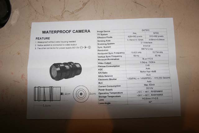

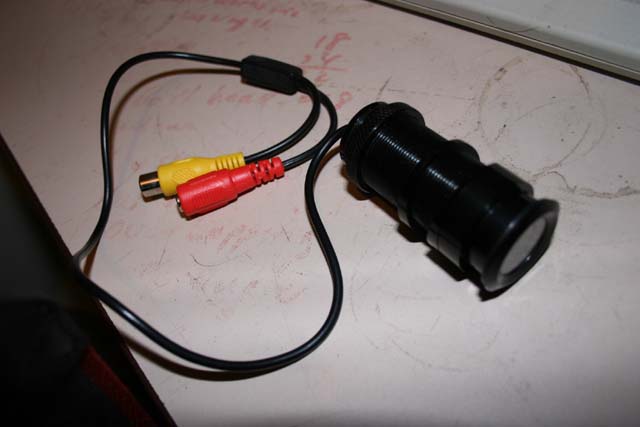

Hi Tim, Maybe this will help i picked up a camera from Jcar Australia when i was over there,it is already reversed 92 deg measures 56mm long x 24mm dia can be hooked up to most av inputs on the incar dvd players, part number was qc3452 comes in pal NTSC etc about $140 aust, not sure if you have Jcar over your way worth a try. Regards GraemeS
