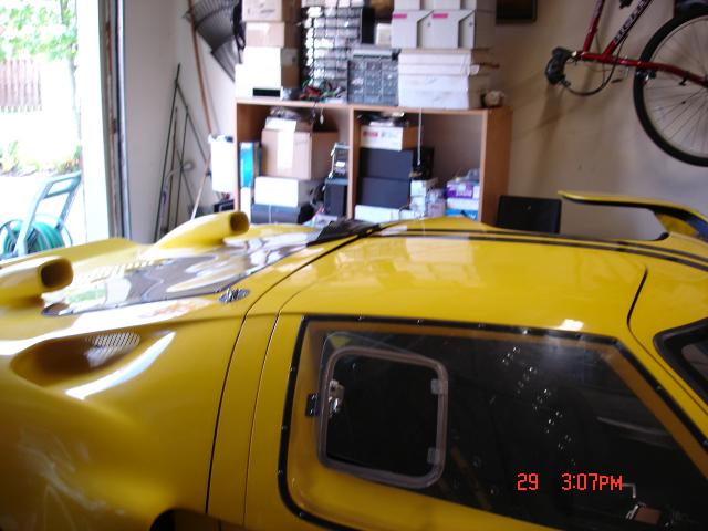

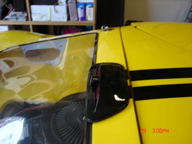

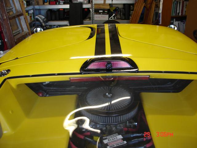

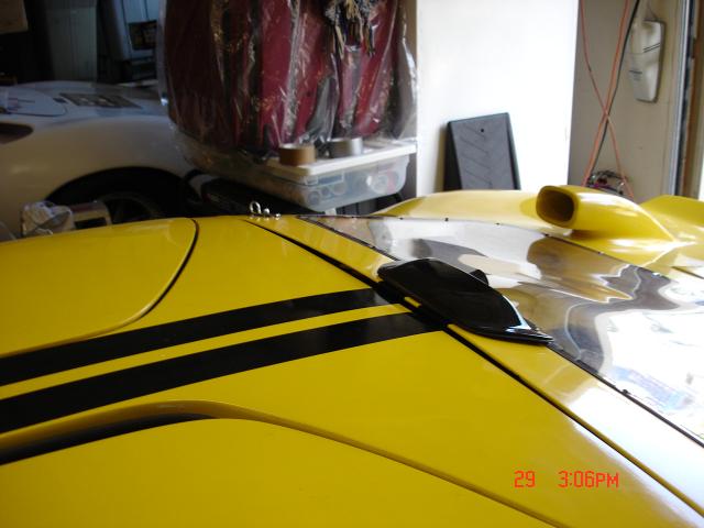

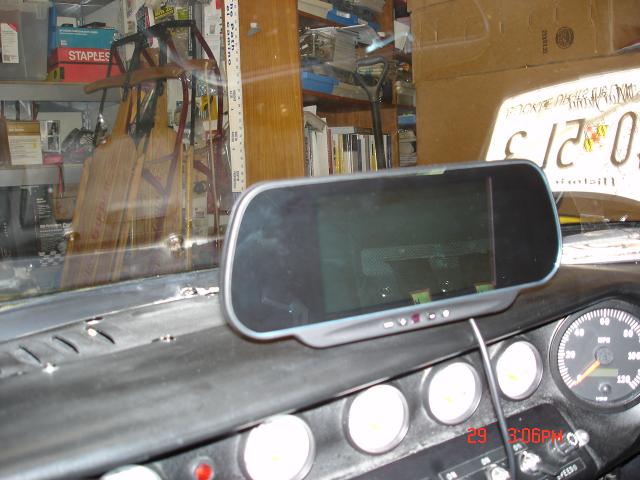

Here is my setup - I mounted a camera on the spider! Works pretty good!
John

John
Nice setup. I'm told that's the best place for the camera mounting.
I assume you have it wired to be on all the time
LG
LLoyd,
The third picture shows an LCD Panel that can also serve as a mirror. I keep the unit turned on at all times. The camera is mounted is a third brake light housing that I picked up on eBay. The system is hard wired!
John

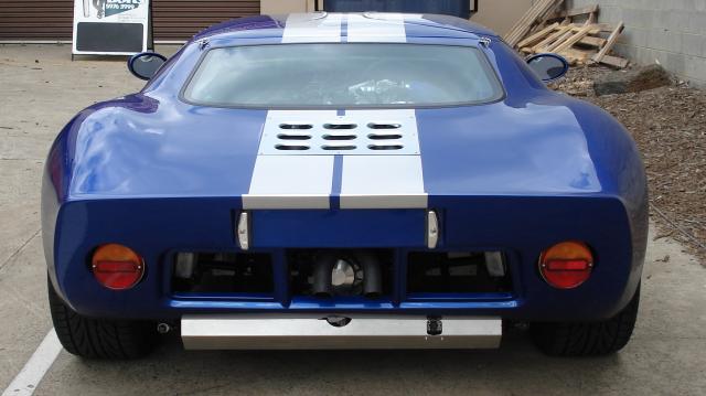

I've installed a 150deg LED camera in the bottom flash panel below the rear clip and run it through a fold away 4" screen incorporated in an AV input car stereo system. (Stereo is located under the dash panel). It's a very useful aid when parking in tight areas and if kids are in the area when backing. On the highway it's also reasonably good although depth of field is a bit hard to gauge. I know another guy who's talking about installing one a bit higher up in the rear LeMans panel in his currently under construction GT40. It will be interesting to hear his feedback. Overall a big thumbs up as a useful viewing aid. I have submitted a rear shot on the car with the camera located on the bottom right of the flashing. I will try and get better photo's of the layout for you.
