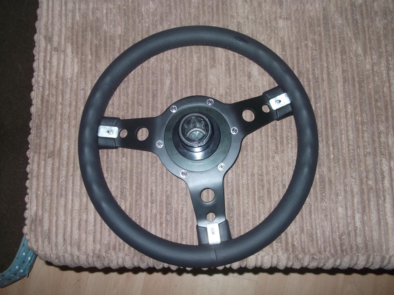

I've recieved the steering parts from Tornado for my car which I am sending up to Gelscoe so I can hopefully have one of thier lovely steering wheels and early style bosses.
Looking at the parts I can see there being a couple of issues with the Tornado supplied boss that might hinder Gelscoe and I wondered if you guys could help advise.
1) The top of the removable part of the boss has a 3 hole pattern to connect to the steering wheel. The Gelscoe wheel should share a similar pattern to moto lita which is 6 holes. Rather than using an adapter plate is there another removable boss that you can buy off the shelf to fit a 6 hole pattern moto lita?
2) My current removable boss adapter will be drill and roll pinned to the steering column and is a hexagonal shape. I can tell from twisting it in my hands that there is slight play between the adapter and the boss so should I look at getting another removable boss that has is splined to reduce the play?
At this point I am unsure of the PCD of the gelscoe wheel so it's difficult to guess what will work but the main question I have is should I replace the current hexagonal style 3 hole boss with a splined 6 hole boss once I know the correct PCD?
Also when fitting a removable wheel to the car will I have to change it for the IVA test or is there an easy way of adapting the wheel for the test?
Any help or suggestions of manufacturers that can provide a suitable removable boss
Just thought, the issue with the 2 alternatives above are they include splined 'spigots'. These spigots need to be welded into/onto the steering column.
My boss doesn't have a spigot but an adapter that slides over the column and then is drill and roll pinned so a spigot system probably wouldn't work would it?

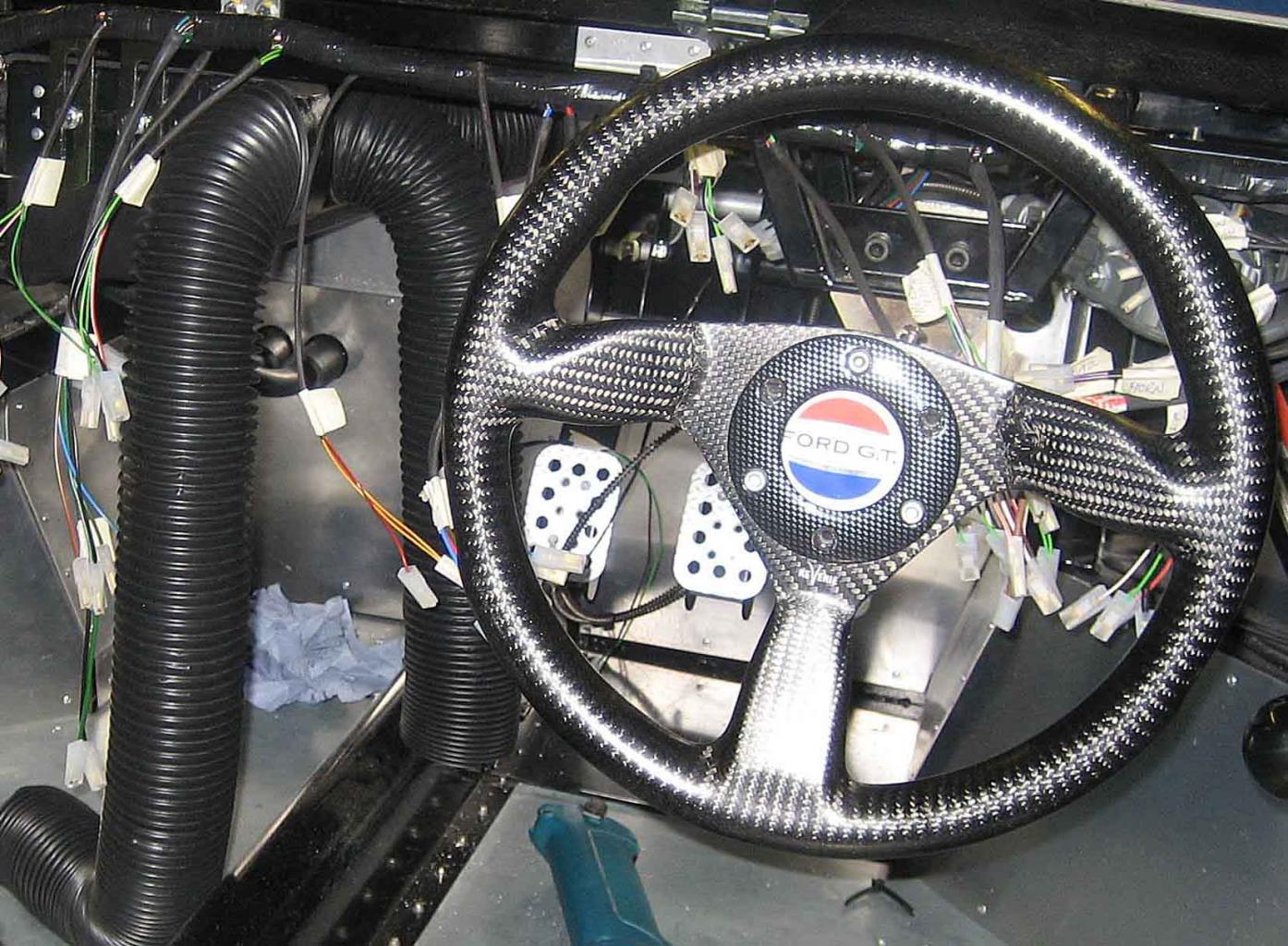

This is Southern GT's solution, which may be of interest.

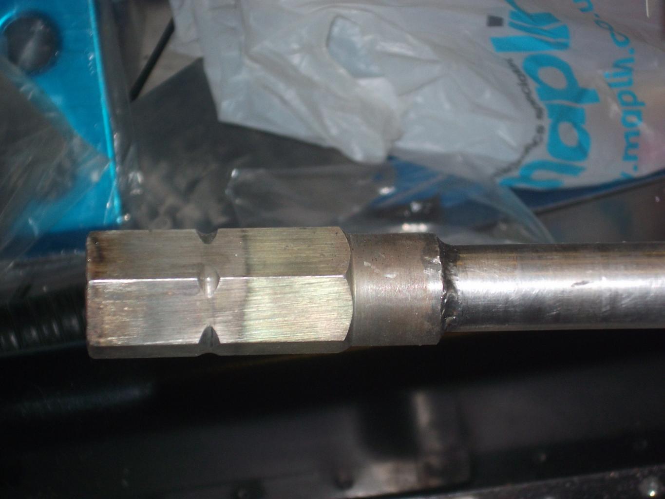

I took care of the "play" on the hex shaft by peening the hex corners slightly with a center-punch. It doesn't take much to tighten it up substantially.

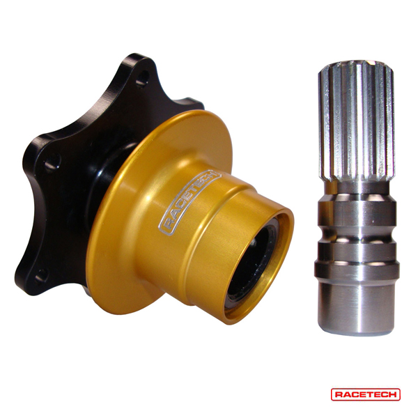

I contacted a company called RallyNuts this week. Nick there has been very helpful and have come up with a potential solution.
They offer Racetech 6 bolt removable hubs that can be specified with a 1" diameter slug. They say that Racetech will supply them with a blank slug as a special order. The bottom can then be machined out to match the diameter of the steering column (19mm) leaving approx a 3mm wall on the slug.
The slug can then be welded onto the column. What do you guys think, do you think this would work? Racetech have said that a 3mm wall should be thick enough for the application.
