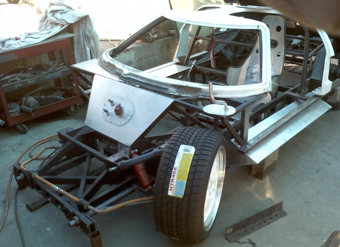

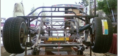

The 40 is my greatest love ... building it from scratch has been a long but worthy pleasure ...:heart:
Using Porsche bits has kept the cost within reason in my case ...
time spent designing and fabrication is something else !
some refer to it as reinventing the wheel perhaps ... in this case it is worth every hour I can spare !

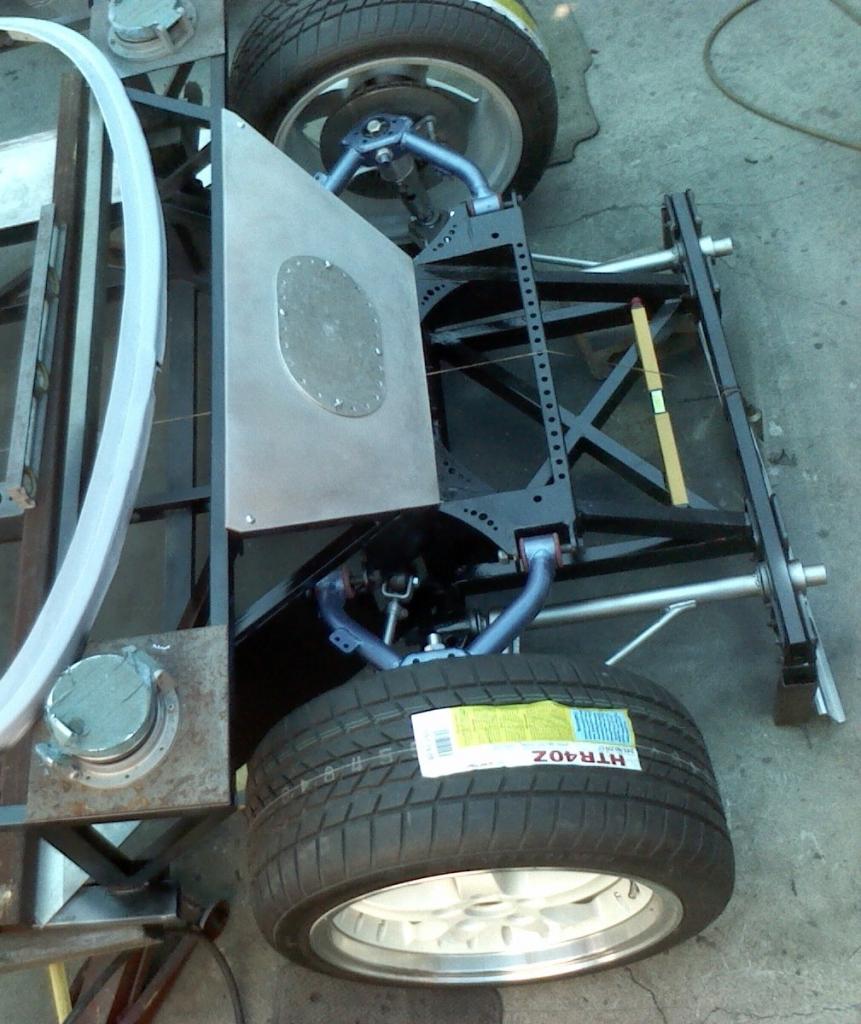

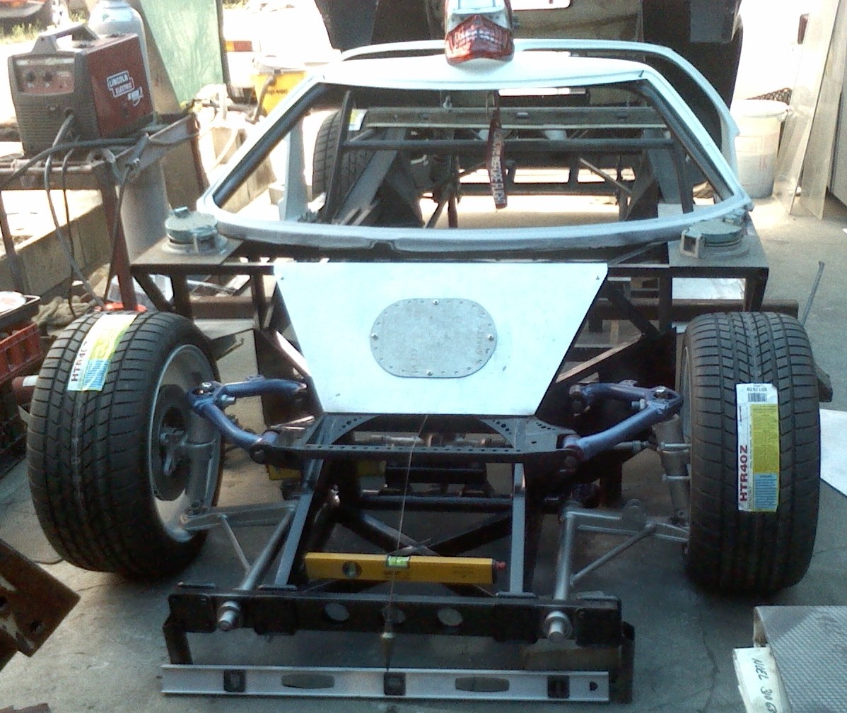

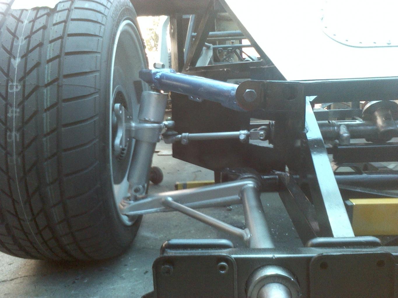

Welcome on board! I would like to see more of your front upright/arm photos if you have time. My curiosity has the best of me in that it appears to be an almost identical modification I prototyped for an old Z-car I had some time ago.
And I always thought that Anti dive was a personal religion with my wife :laugh:.... just kidding ...
I set the front suspension up to limit any harsh deflection in its travel ... it was a dial indicator used for that one ... im thinking along the lines of less than 1/8 inch difference with 4 inches traval up and down
the other thing I built in - was a grip of camber and castor adjustments
the rack hgth is also adjustable ....
can you talk a bit on the subject of anti dive ...
