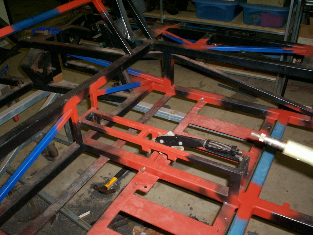

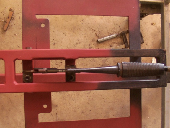

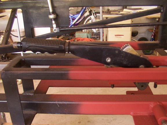

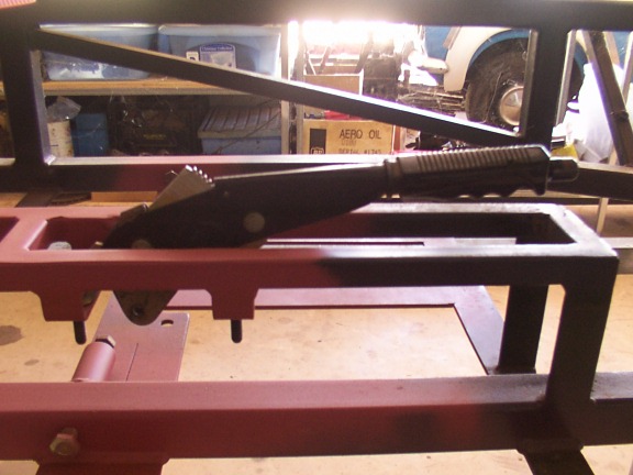

I wanted to put in a centre console that covered the handbrake lever.
To keep the top of the console low I had to lower the handbrake lever as much as possible without hitting the water pipes or running out of clearance under the handle.
Clayton

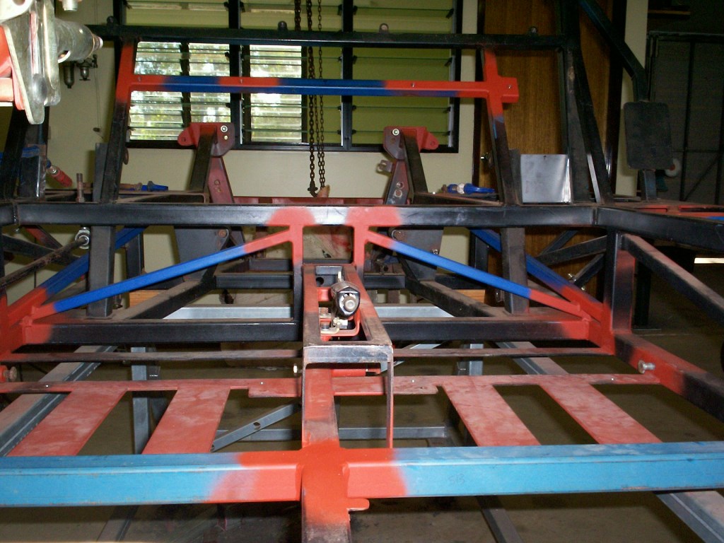

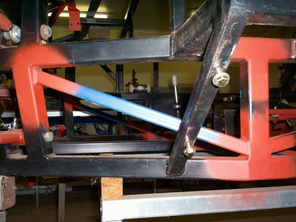

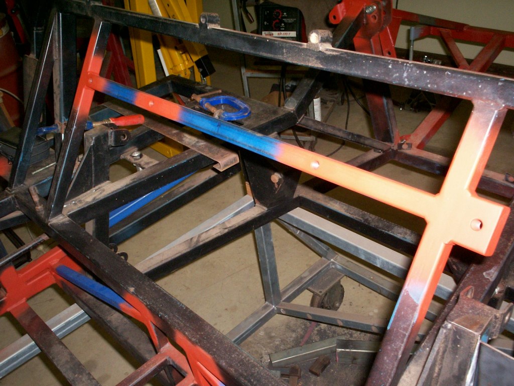

The chassis already exceeds the required beaming and torsional rigidity, but a few strategically placed diagonals can't hurt. Tried to tie the path between the front and rear shock mounts with triangulation.
Added a few bars for extra side intrusion and some across the bulkhead.
To give me some flexibility in the future, I added a seatbelt bar just below my shoulder line. (belts will need to go through the seat).
Clayton

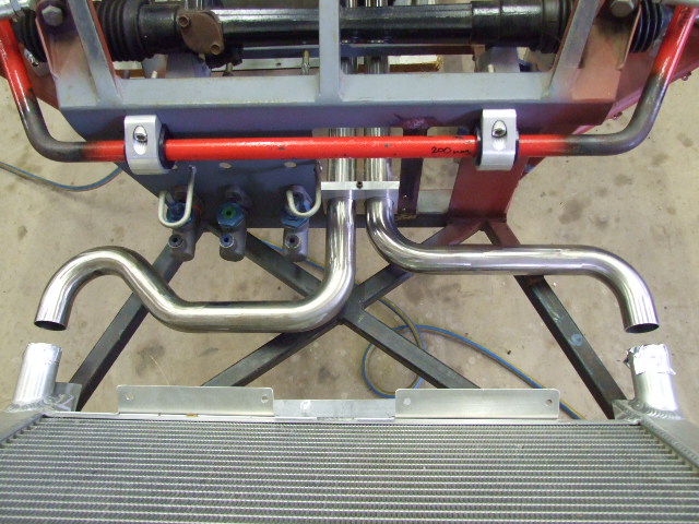

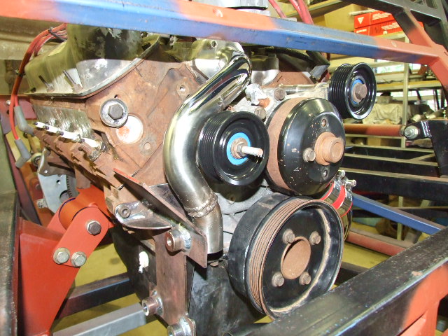

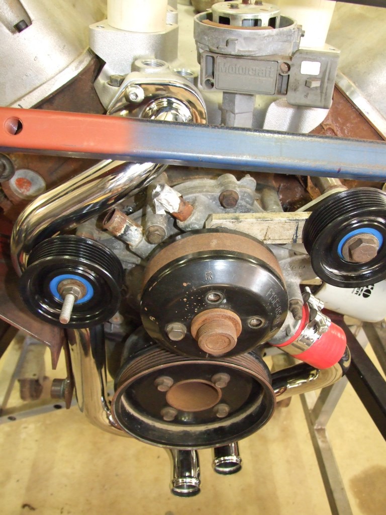

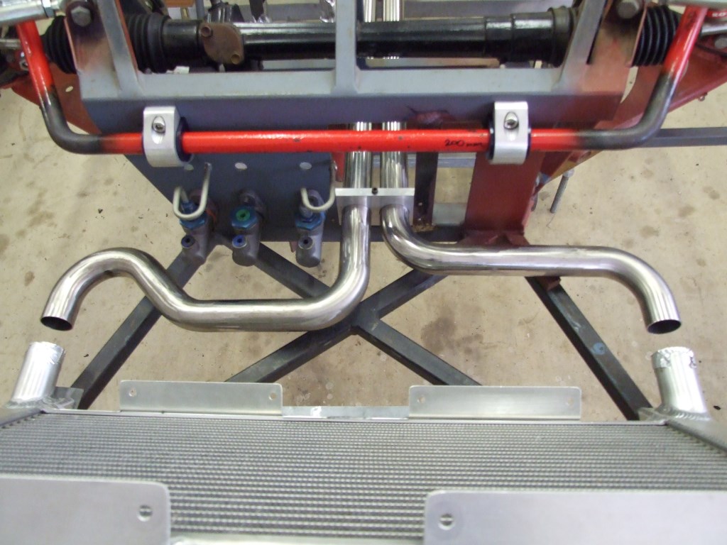

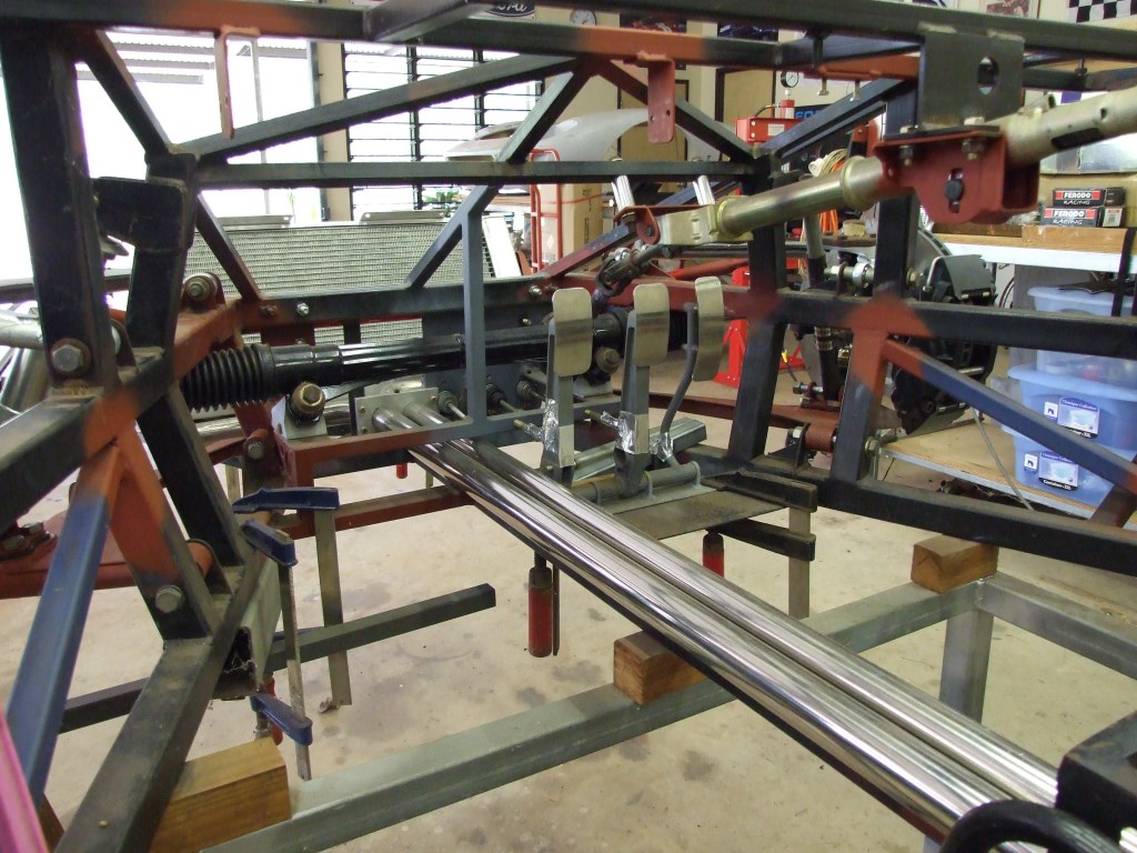

Water pipes.
I wanted to use the least amount of rubber / silicon hose as possible.
Try and limit it to short straight sections.
Pipes are 1.5" S/S and used mandrel bends welded together for the shape.
The radiator end will have sleeves welded on to suit the 40mm radiator pipes.
The rear pipes will have a crox only.
The pipes are held by a split clamp and O-ring at both ends of the cabin for sealing.
Clayton

Clayton,
I added diagonals to my DRB frame much in the way you did. In your first pic I saw that the diagonals you added to the sill frame rail point in toward the interior. I placed mine pointing outward. Is there a right way to do this or does it really matter? How about for a collision at 45 degrees rather than straight on? I am no engineer , but I am curious.

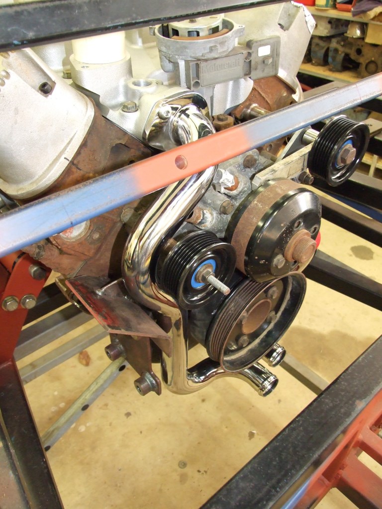

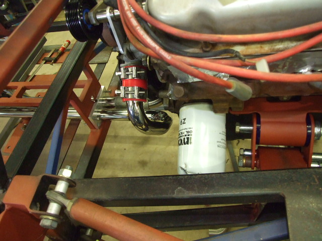

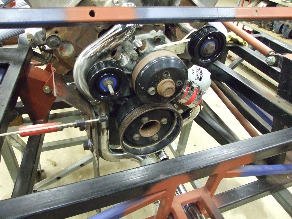

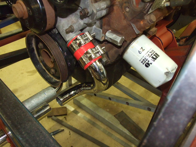

The engine outlet pipe was a lot more painful, but managed to squeeze it in.
The pipes through the cabin will be exhaust heat wrapped and covered with heat shrink.
Clayton

Clayton,
Hi Bill
I'm not a structural engineer either, but the way you did is better in my books. As the welds and tubes are in compression rather than tension. (if hit in the middle of the sill) The reason I did it this way, was so I could access the fuel sender from the top of the sill panel.
I try not to think of collisions........ I may not want to drive it :stunned:
Clayton

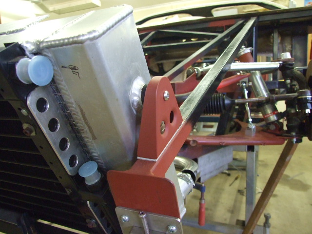

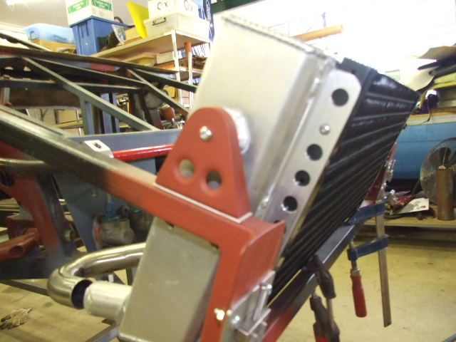

Radiator mounts
Welded a threaded block to the side tanks and used a small rubber shock mount. Fabricated the chassis mounts to suit.
Bottom mount uses the factory pin into the floor panel through a rubber grommet.
Clayton

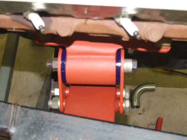

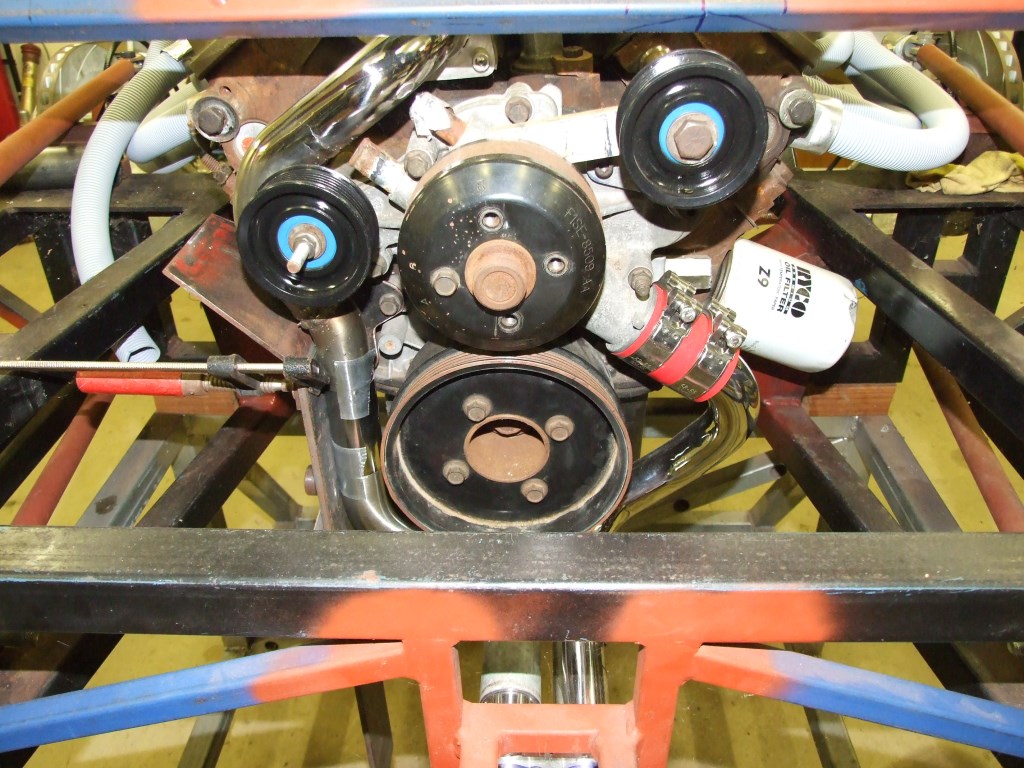

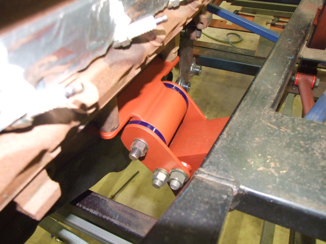

Replaced the std engine mounts with a more rigid shackle bush style.
Added an extra tube in the chassis mount to stop any chance of the engine rocking sideways.
Clayton

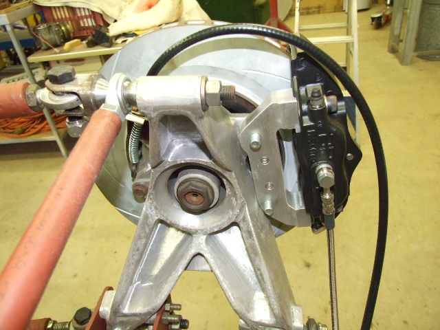

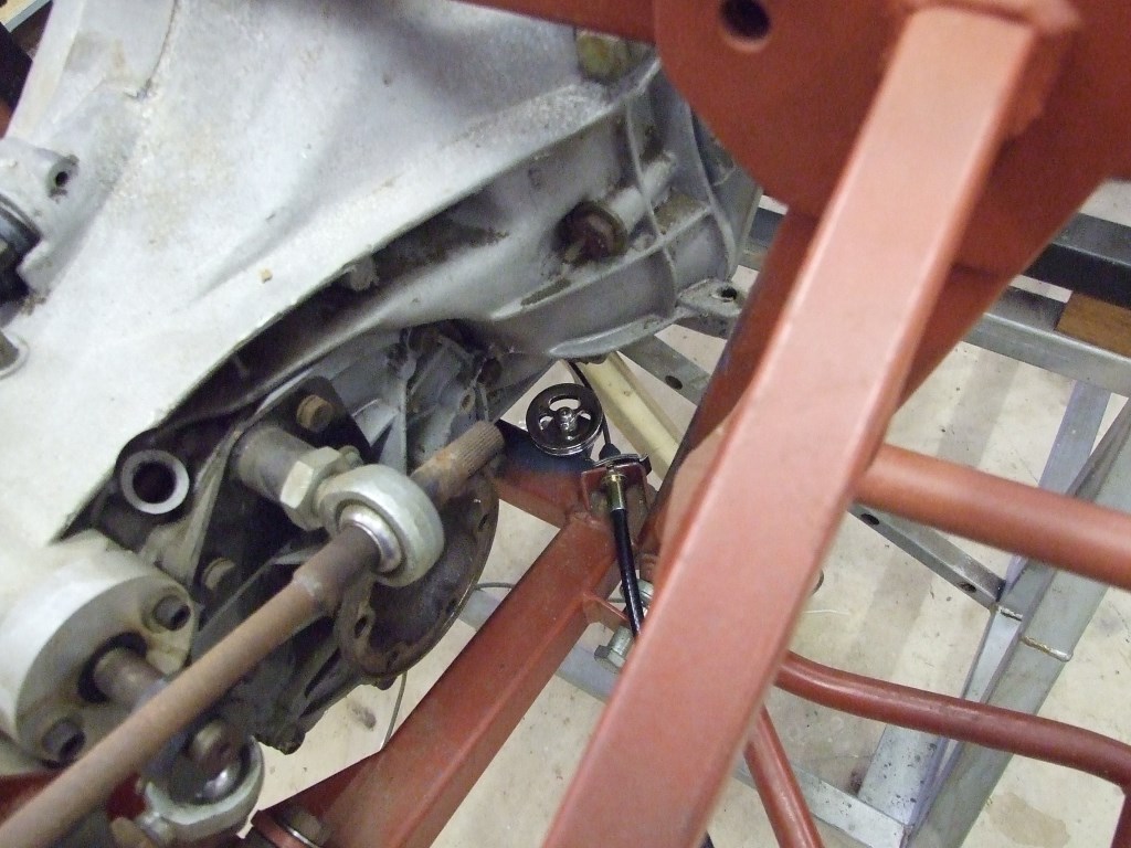

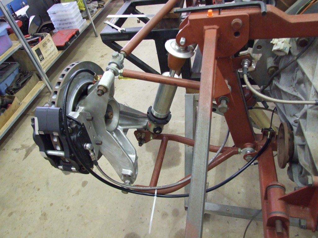

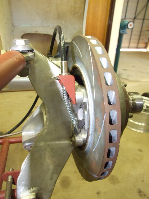

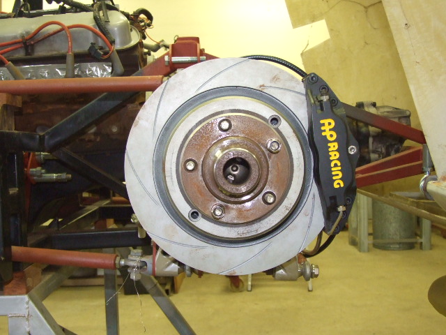

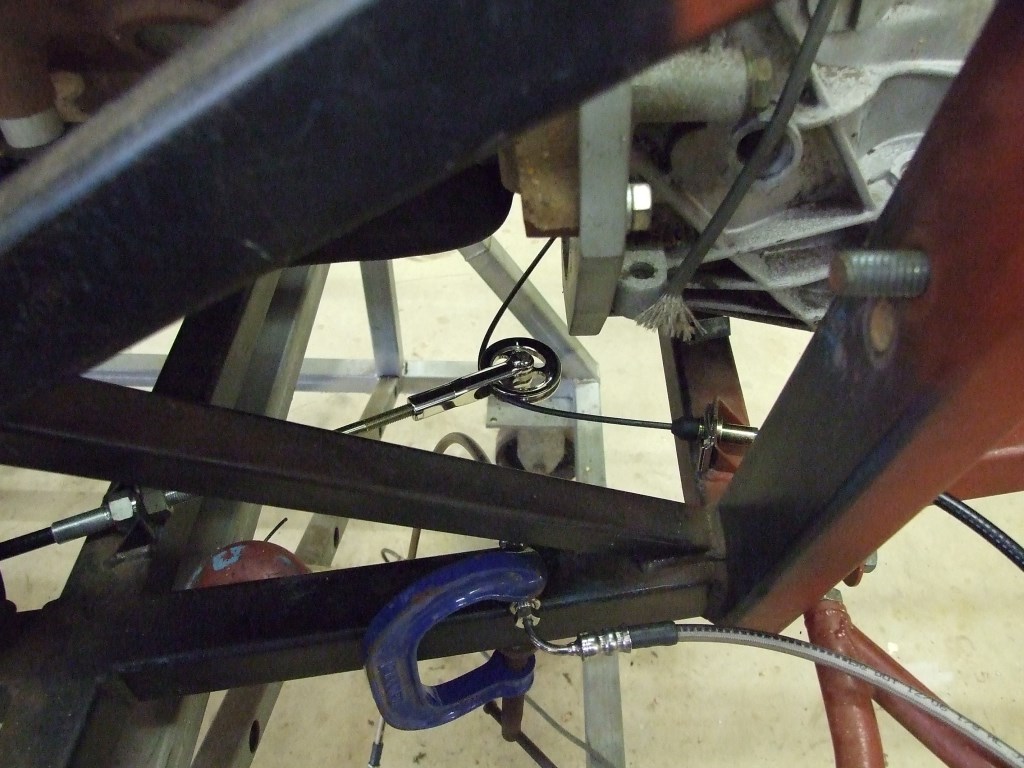

Park brake
I don't like the look of the twin calipers on the rear (extra park brake caliper)
So I used a late model (back then it was....) Holden HSV disc with integral drum park brake.
Had heaps of fun with cable routing and the drag it produced. With extra return springs and a massage here and there, it worked.
Clayton

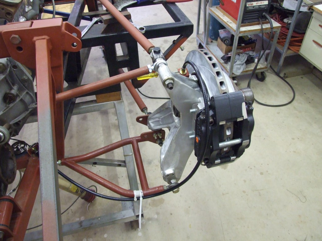

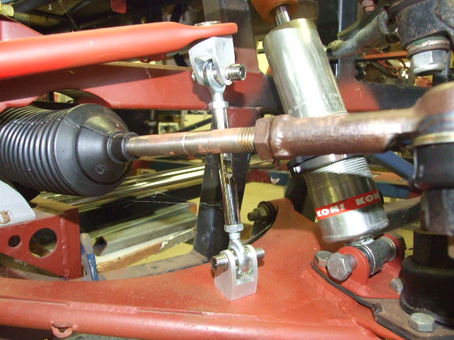

Upgraded the sway bar mounts and drop links for a bit of bling...
Clayton

Hi Clayton, your rear brake set up looks very much like my "race" Set up on my gt#27. Nice.
Dave is yours the same?
Cheers, Gus.
Thanks Gus
Are you running 17" rims ?
Clayton
