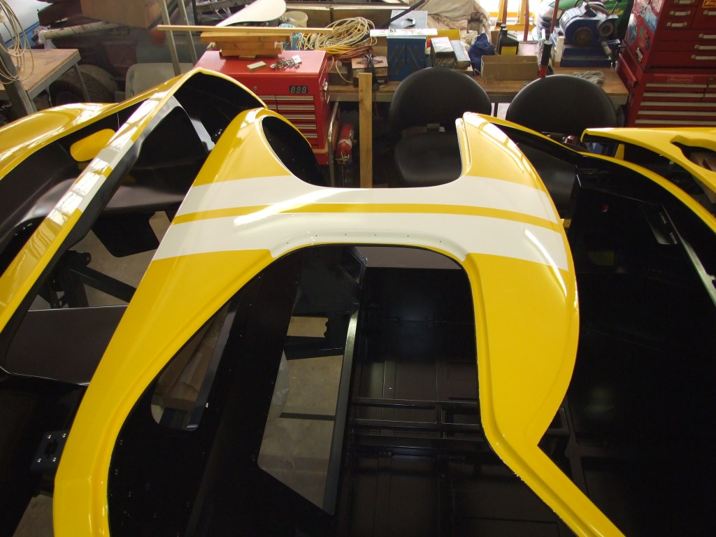

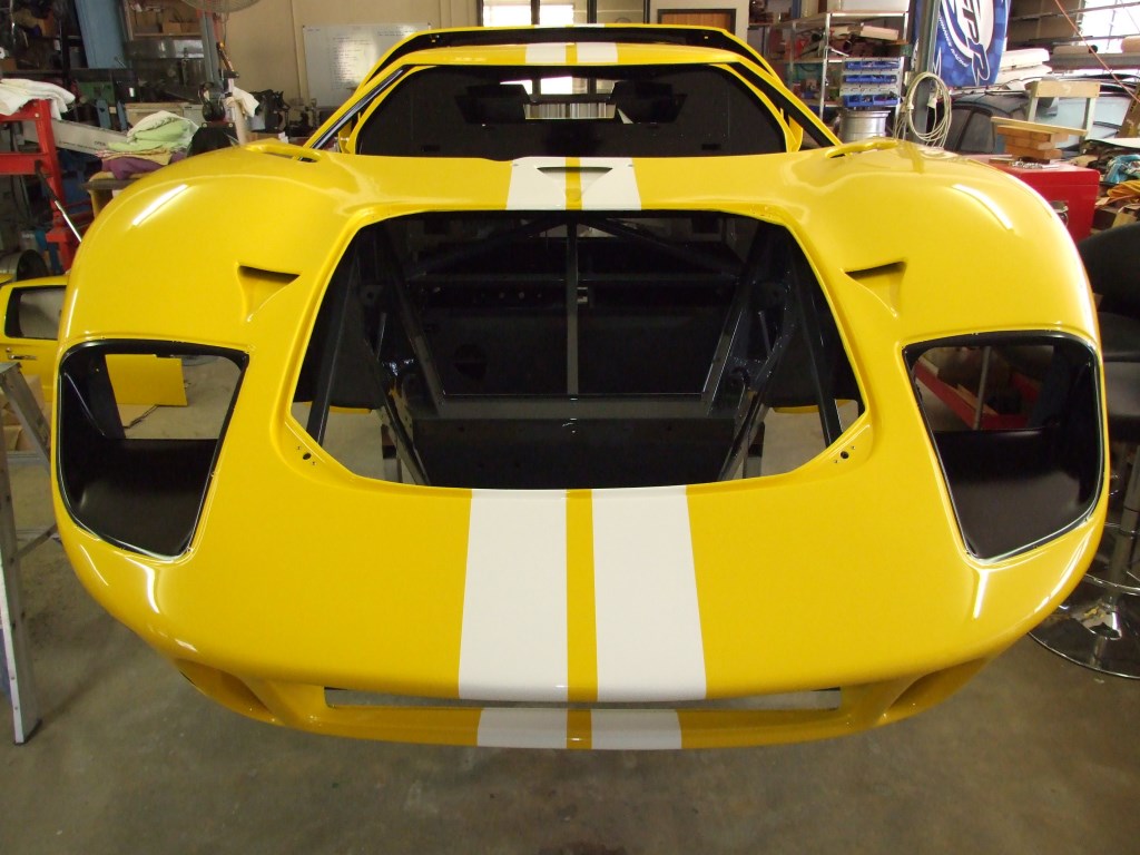

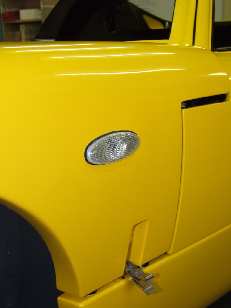

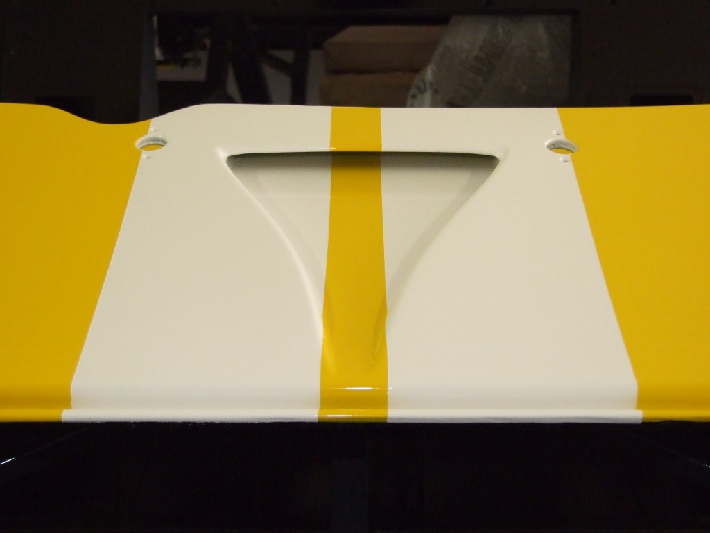

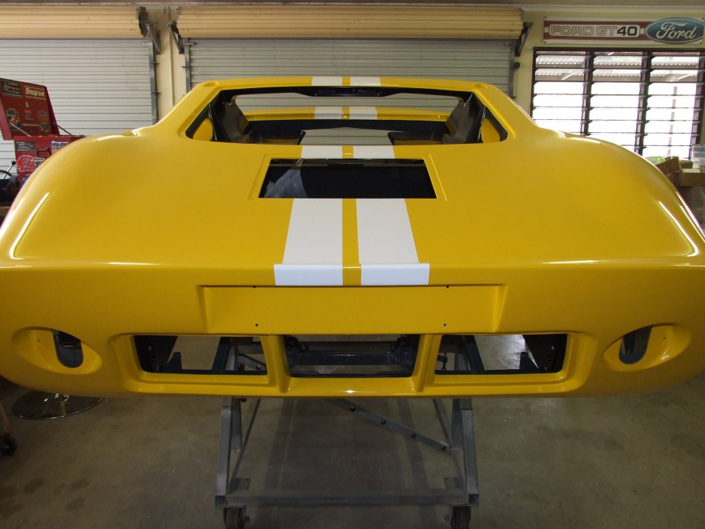

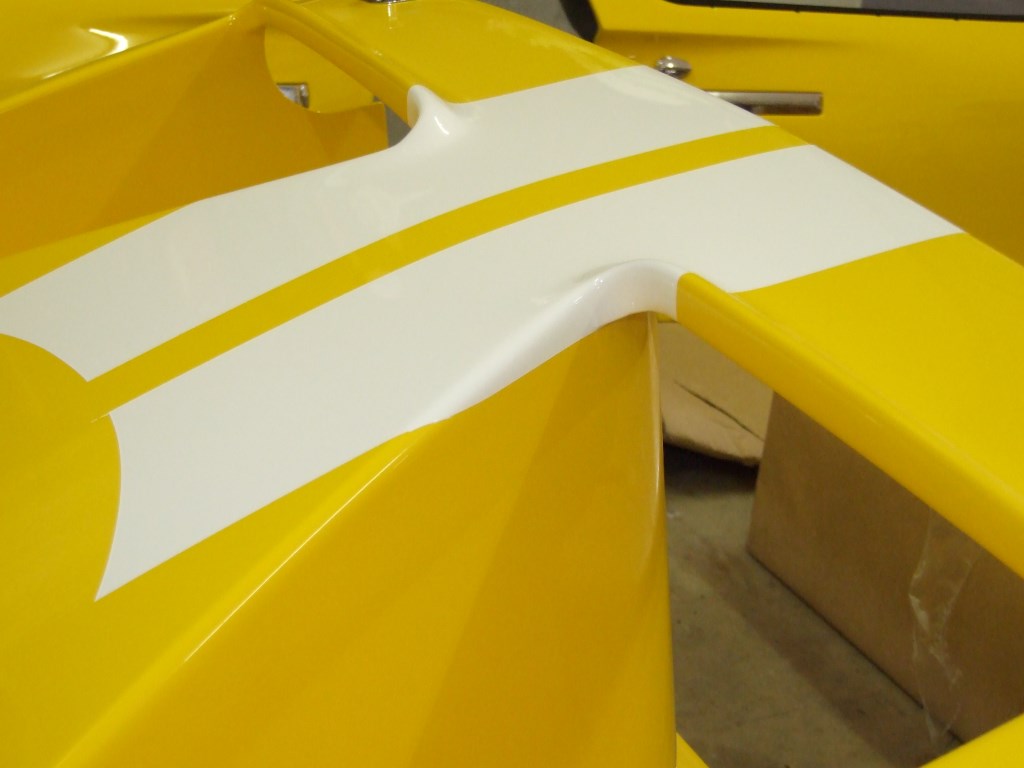

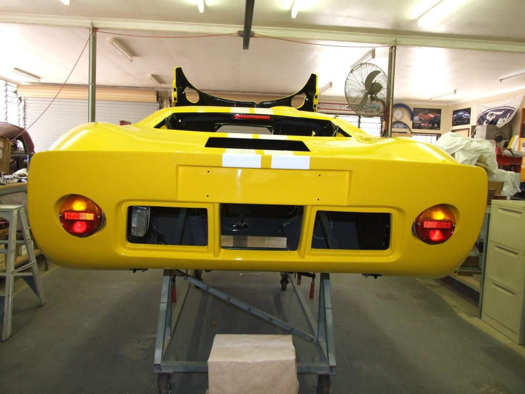

Stripes painted and removed from the booth for the last time :thumbsup:
Had great pleasure in ripping down the booth.
Clayton

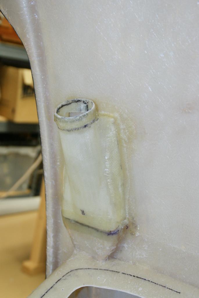

Your work on the small NACA ducts (post #107) inspired me to make one with a round outlet.
See my post #103 on page 6 of "Tornado GT40 in Texas".

Clayton
Kudos to you Clayton. Your shut lines are very impressive.
Thanks Brian
That definitely took some time to get right.

Thanks Bob
Your ducts look great.

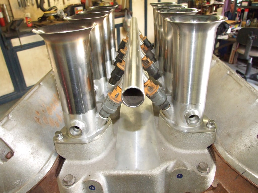

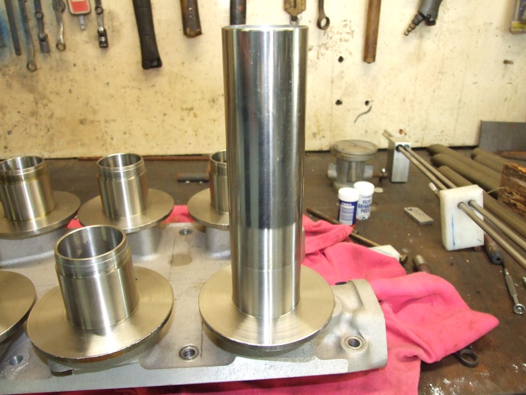

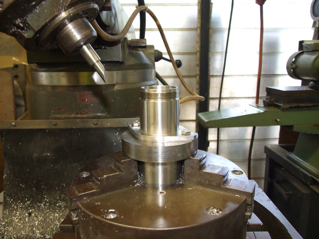

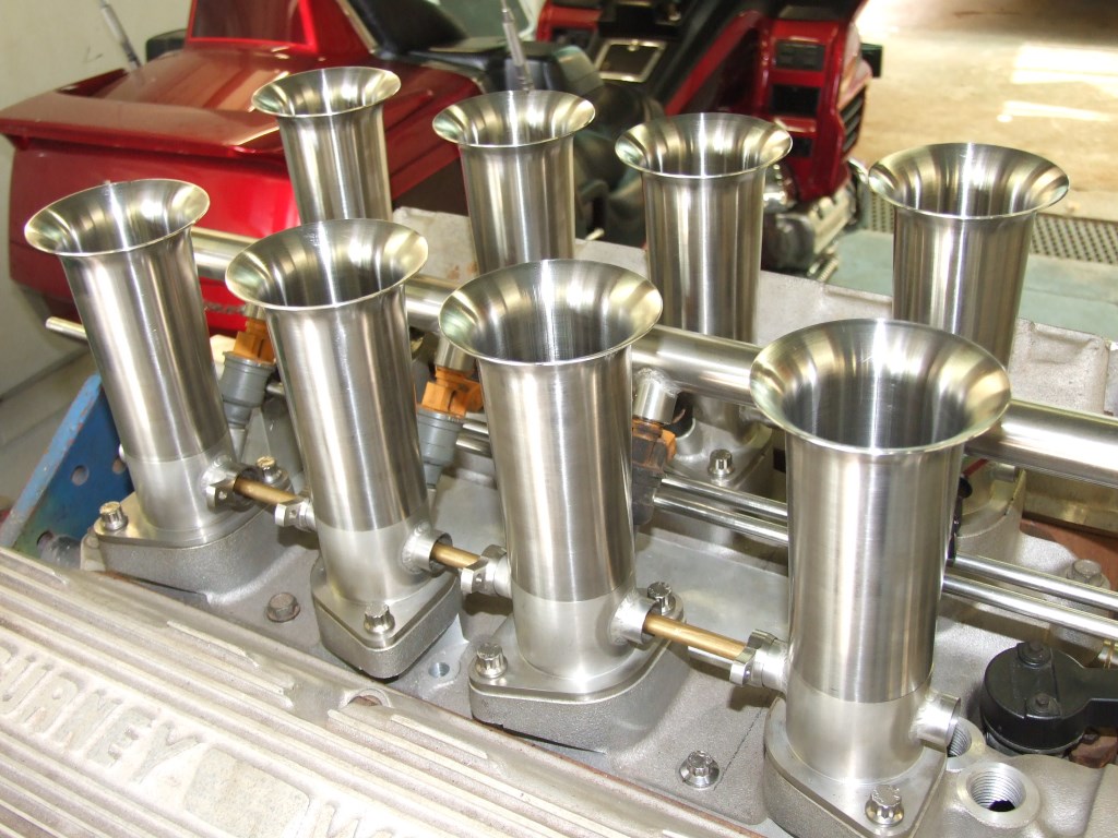

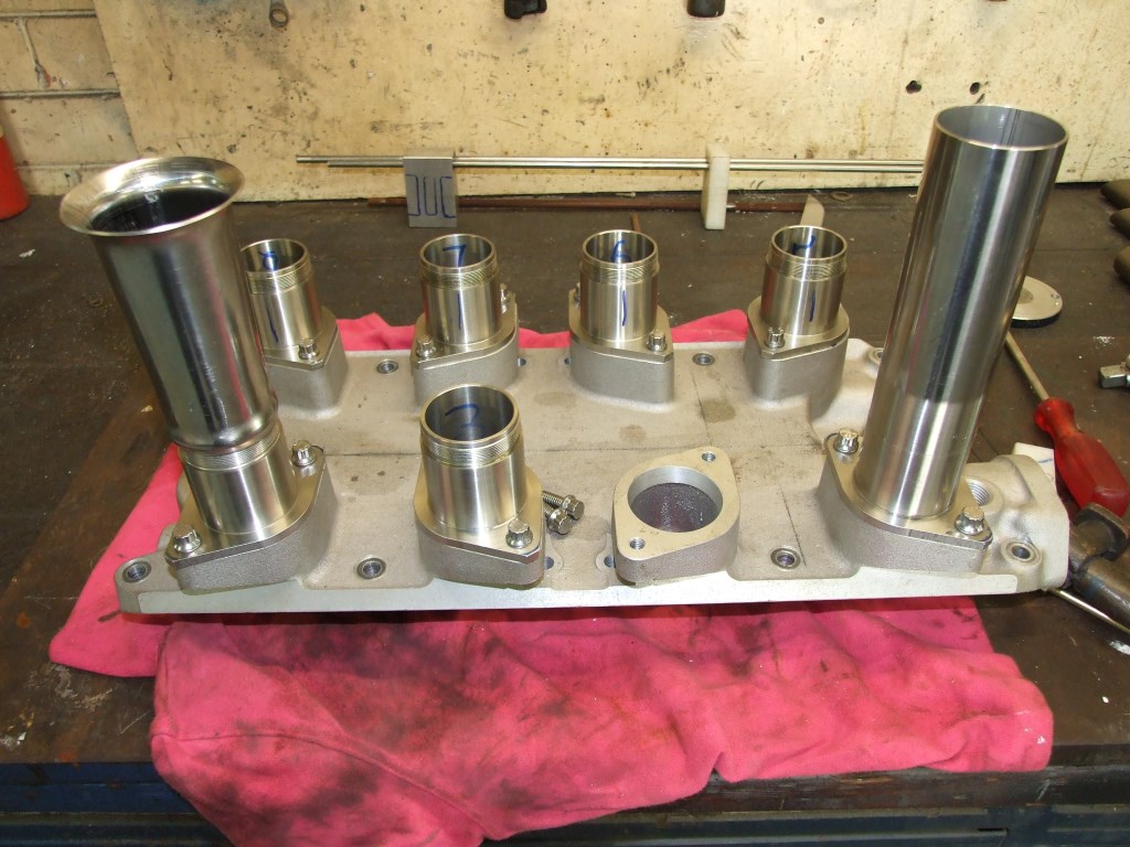

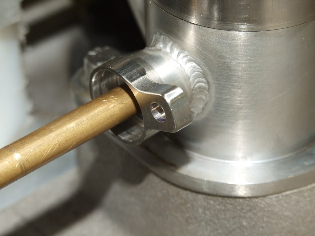

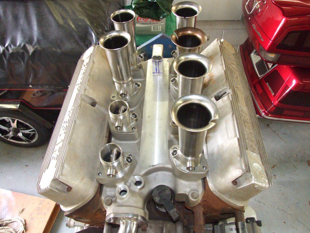

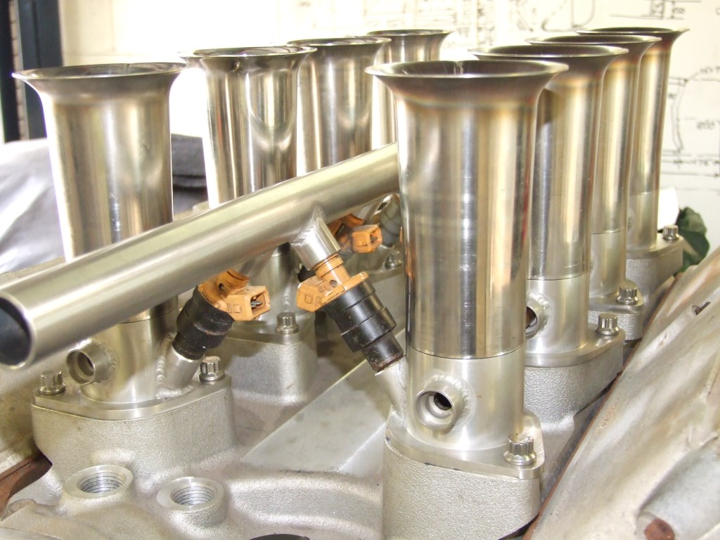

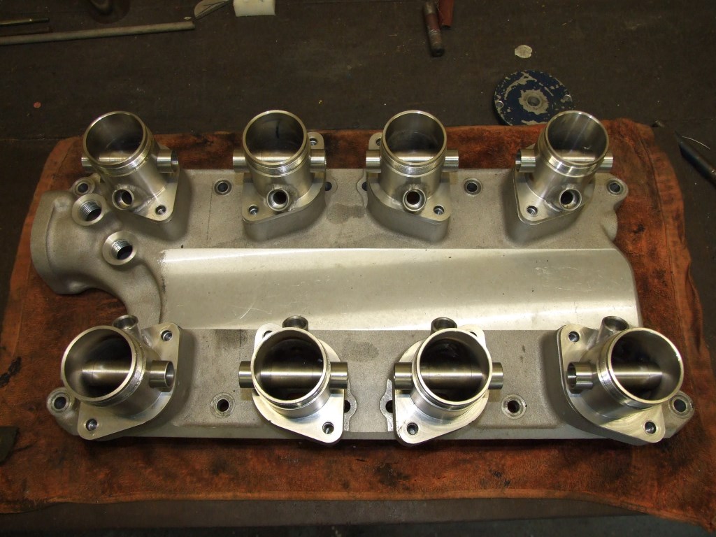

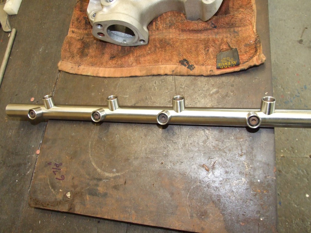

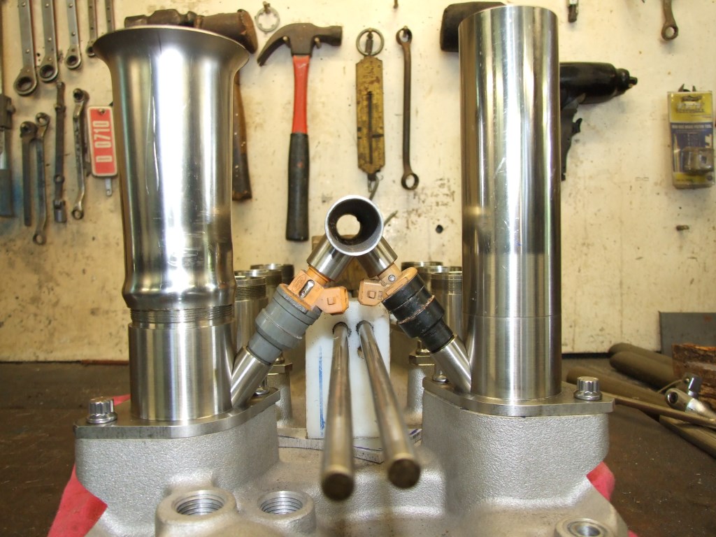

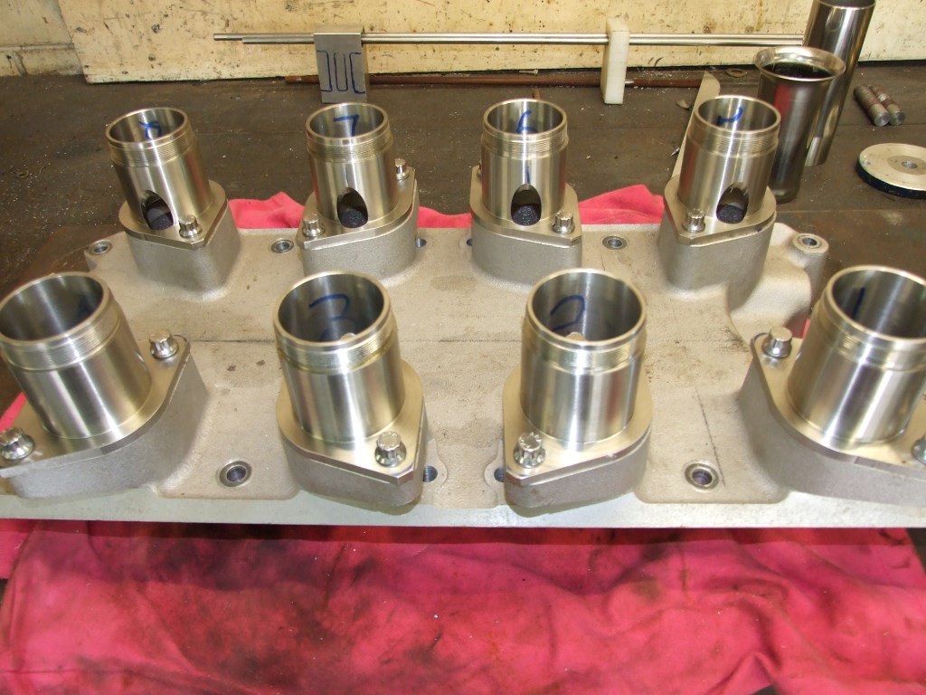

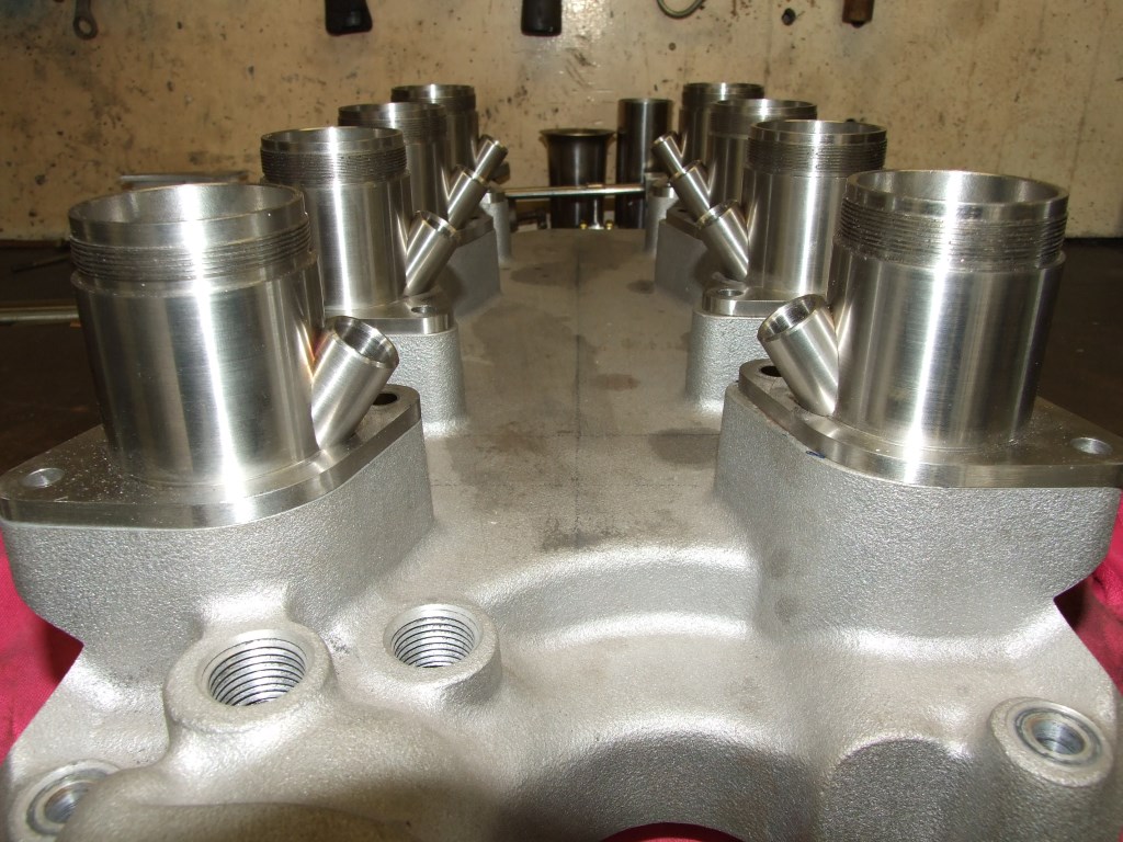

Before I continue with the final assy, the old man and myself had started building an eight barrel injection for the next engine. Its still not finished, but here's a few photos of it so far.
Started with a weber manifold and decided to go for a clean look.
Each TB started as a billet of S/S, it will have the injector and throttle shaft housings welded in.
The ram tube is threaded to the TB.
Clayton
Clayton

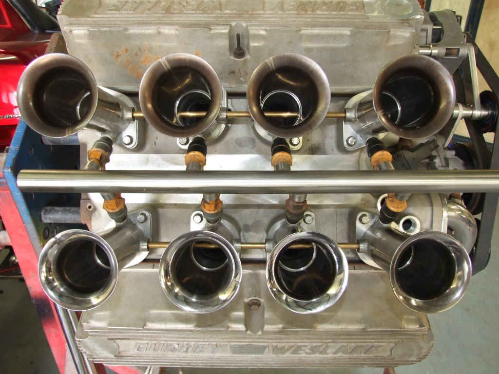

Also wanted to run a single fuel rail down the centre.
Took a lot of time to get the angles and heights right.
The twin rods under the fuel rail will be the throttle linkages, both pulling inwards.
Clayton

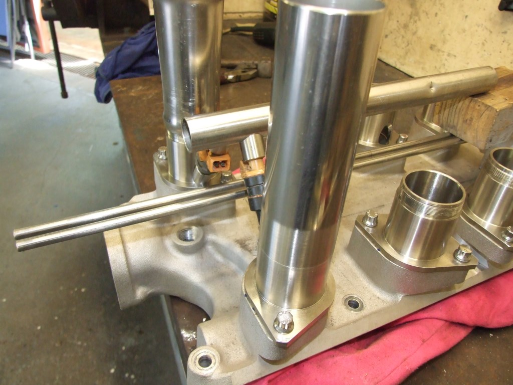

Clayton
Throttle bearing housings tacked in place, they will be bored out once welded. Fuel rail ready for welding.
Clayton

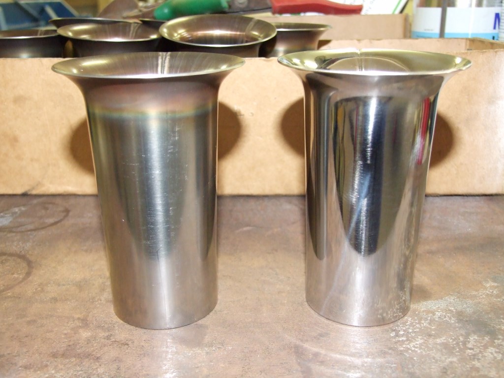

Clayton

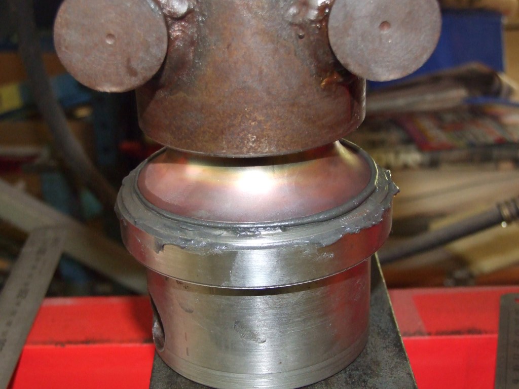

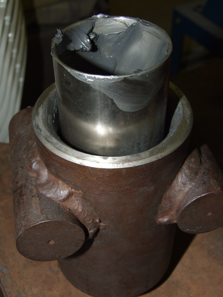

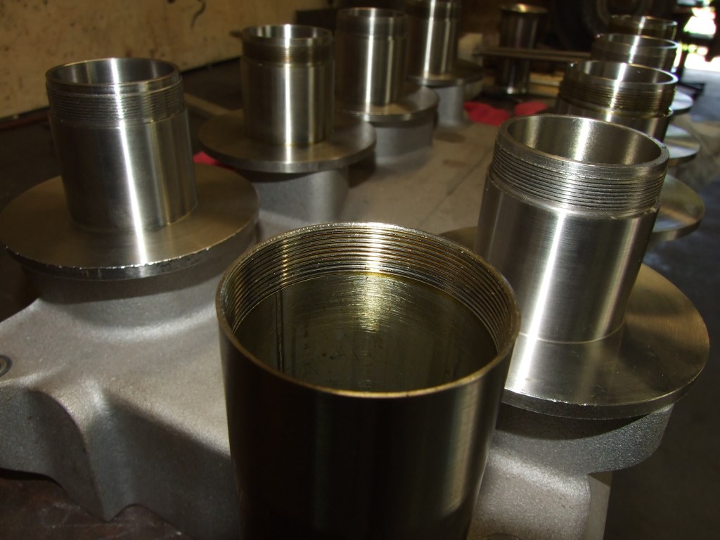

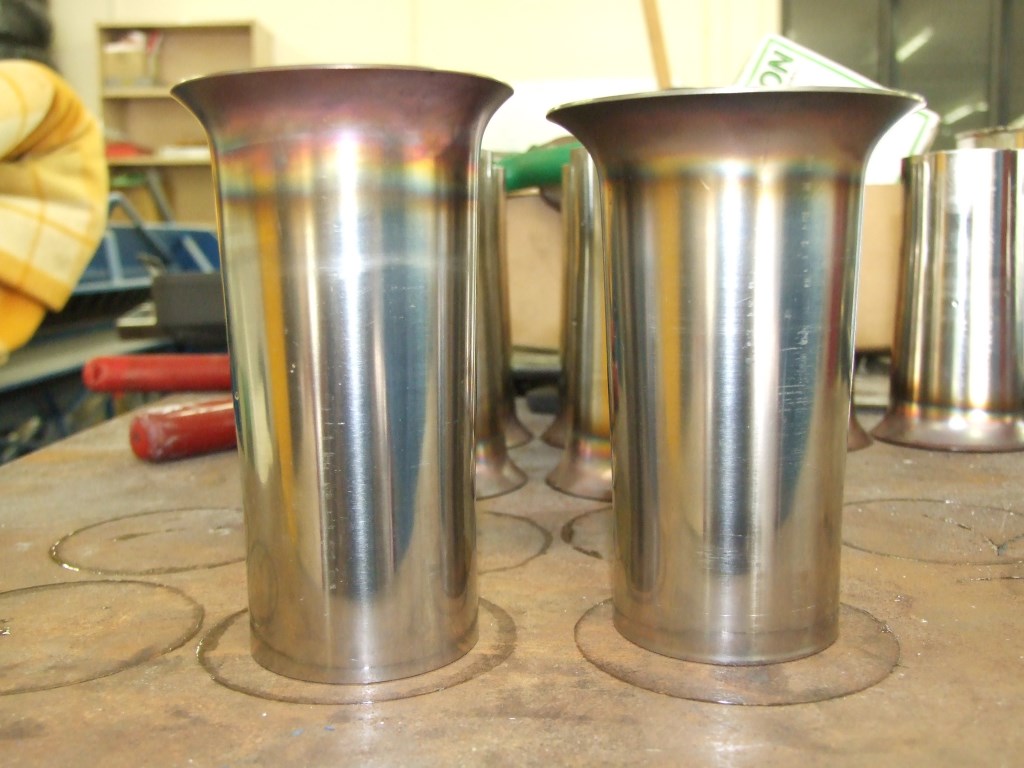

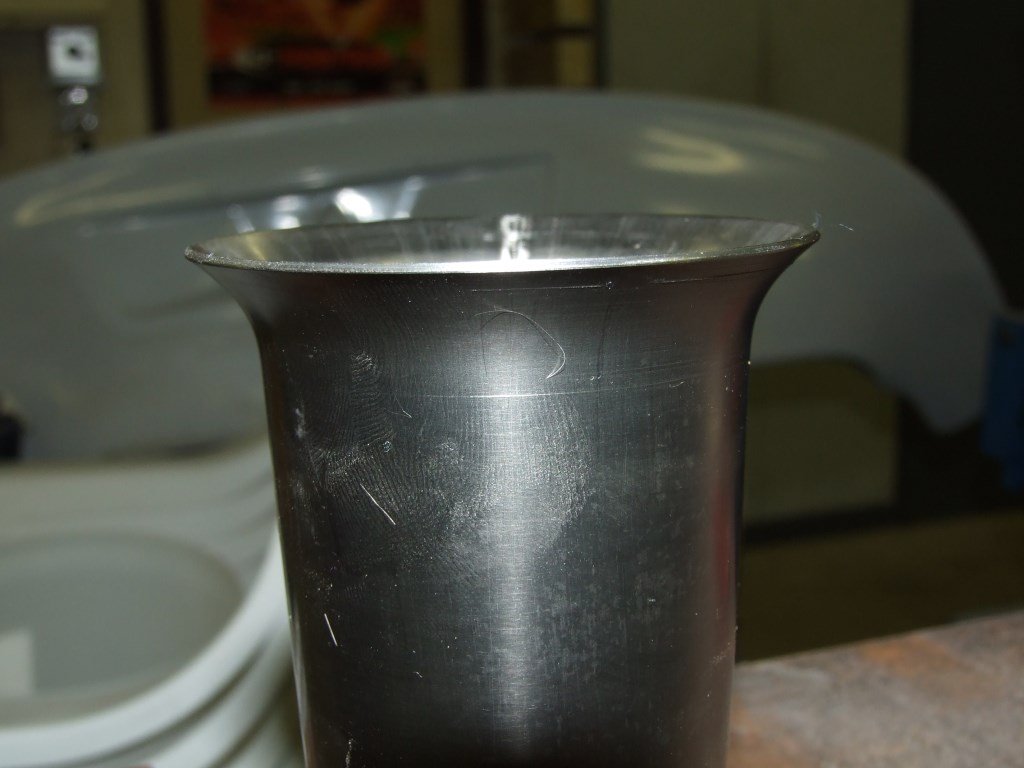

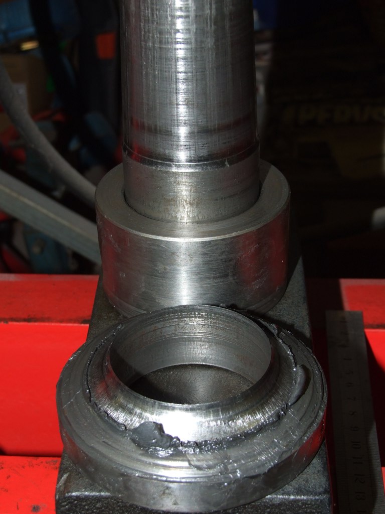

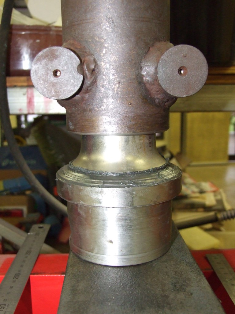

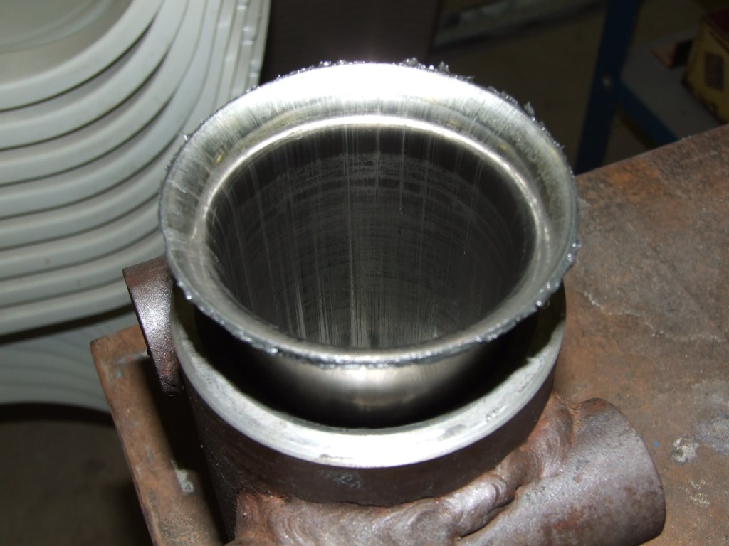

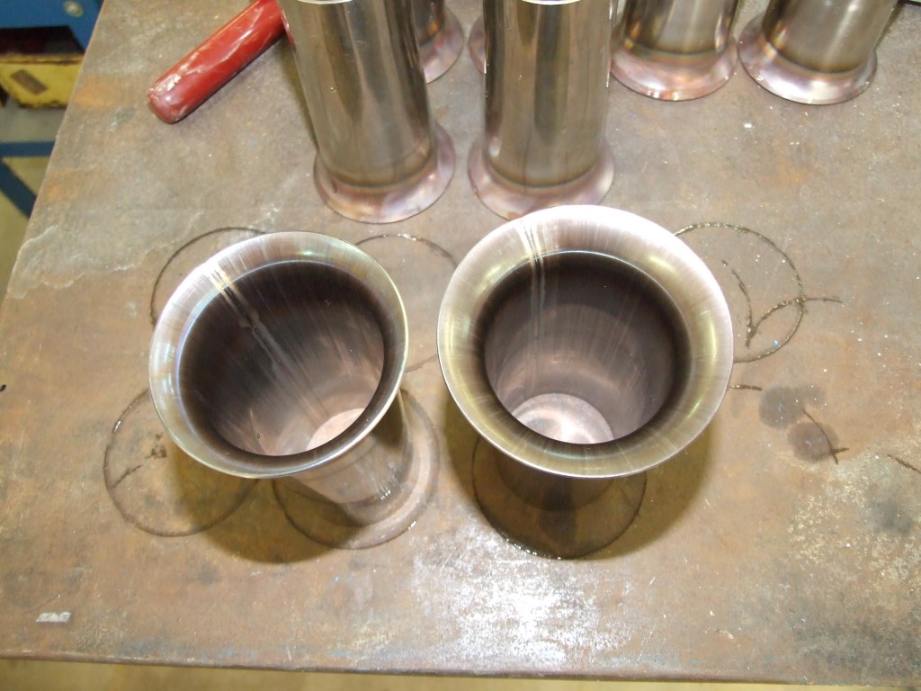

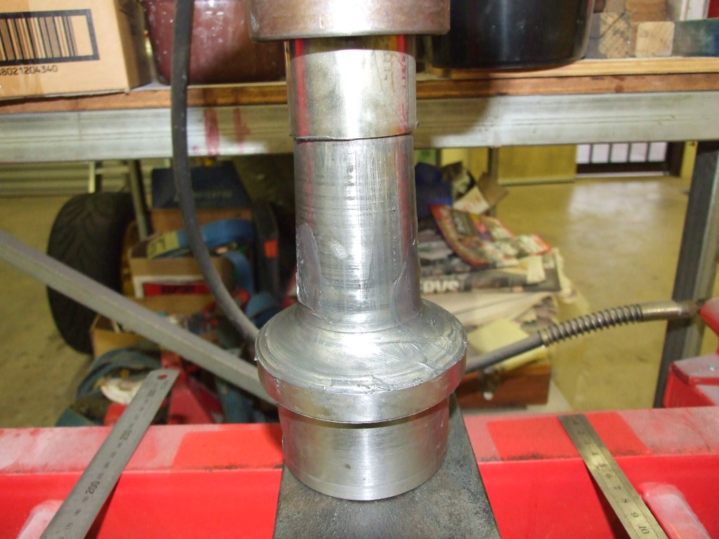

As you can see from the previous posts, we had quite a lot of failures with pressing the ram tubes.
We had done this before, but not as long or in S/S.
The tubes are 2" 316 s/s and wanted to put in a taper over its length with the largest bell as possible.
Had to put them into a sleeve with the same taper so the tube wouldn't bulge under all the pressure.
Clayton

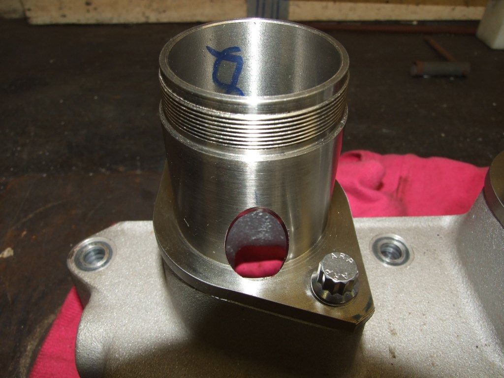

Clayton

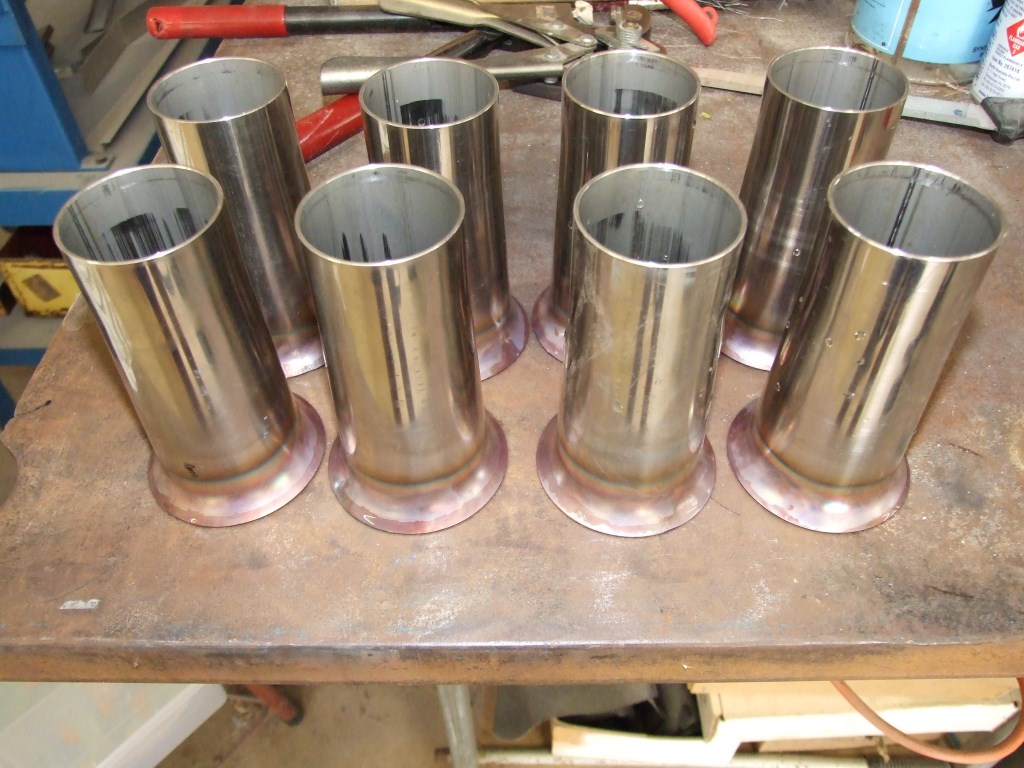

To stop the bell from splitting, we ended up annealing the tube and pressed it a bit more.
This is the maximum we could get out of them. We tried lots of other ideas, but nothing worked.
Tubes were then internally threaded to suit the TB.
Clayton

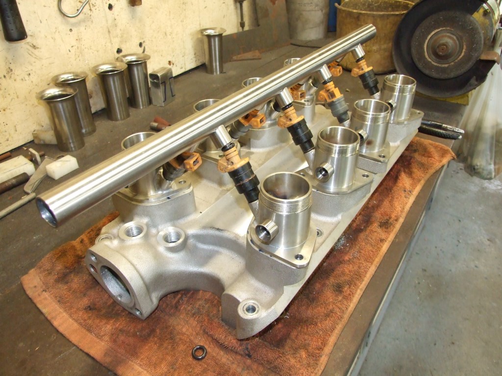

Clayton
Ram tubes and fuel rail fitted.

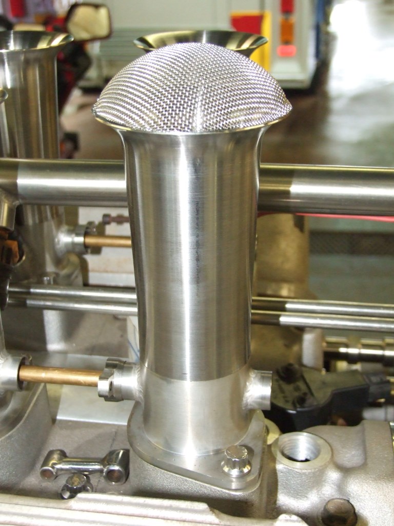

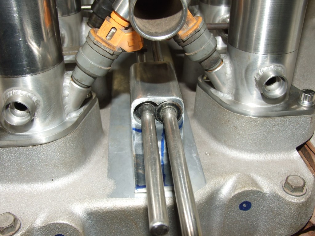

Start of the linkage system. The alloy block has two small gears so that the shafts rotate opposite to each other.
Part of the idle stop bracket, each TB will have a separate linkage to the centre shafts.
Playing around with some mesh screens for the look.....
Have made some more progress with the linkages, but no pictures on hand.
Clayton

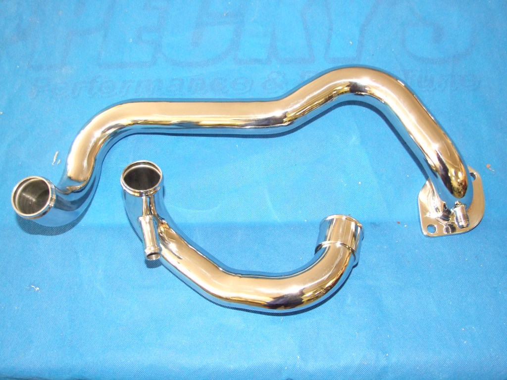

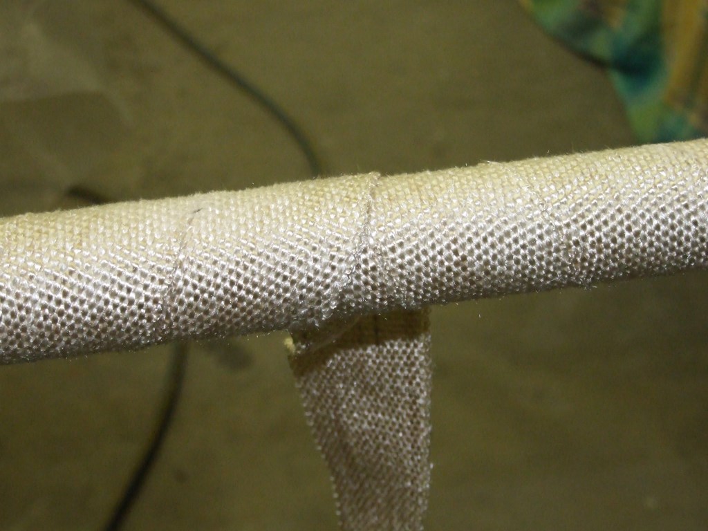

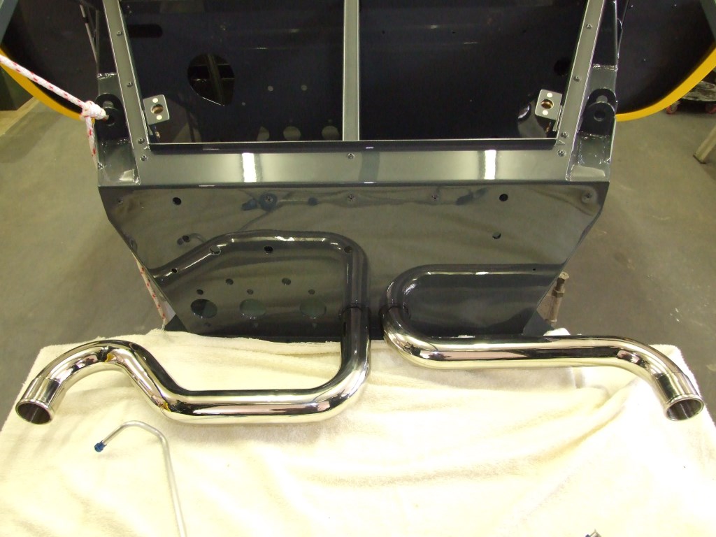

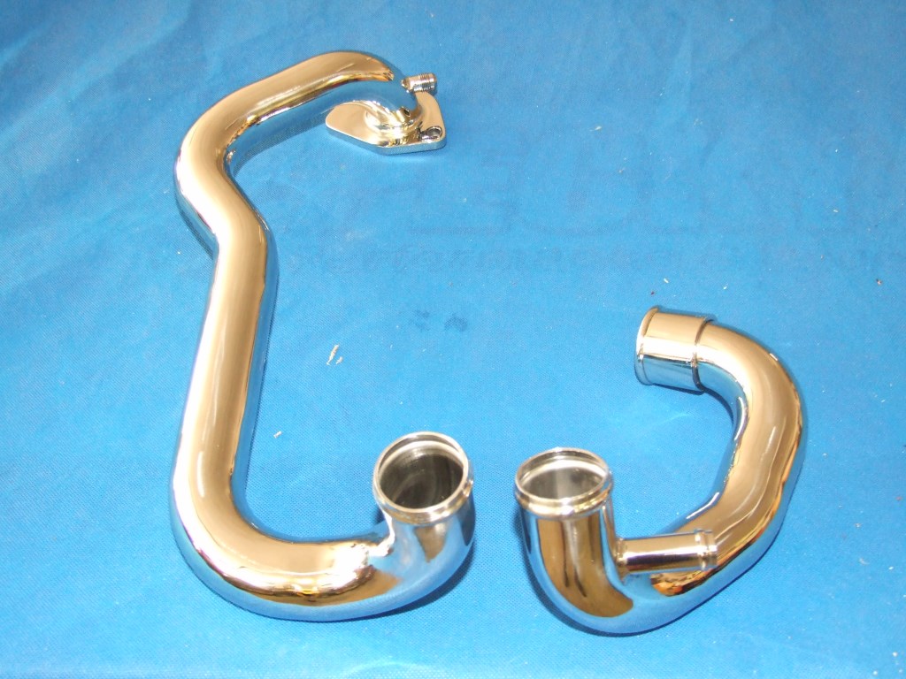

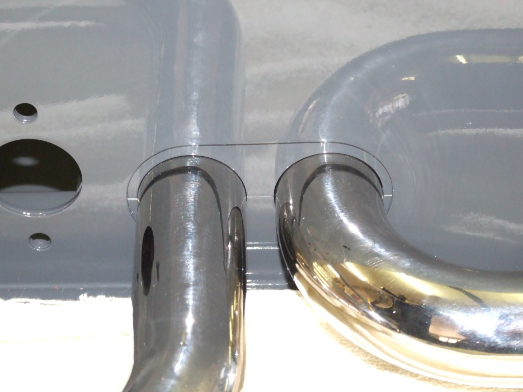

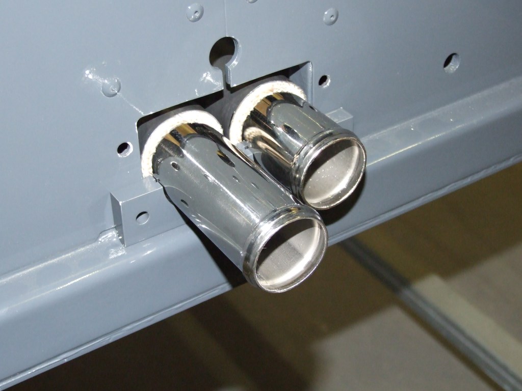

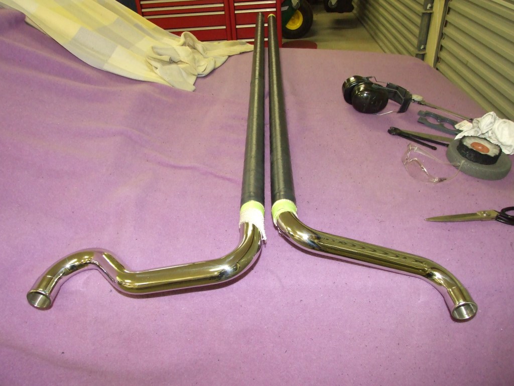

Now back to the final assy.
The water pipes were covered in two layers of exhaust heat wrap. (Tried three, but wouldn't fit)
Wound one way then the other to try and keep air gaps to a minimum.
Then used some large heat shrink to hold it all together.
Engine pipes finished as well.
Clayton

Clayton
Main water pipes fitted.
There's an O-Ring around the tube which slots into a groove in the bracket.
Helps to seal and reduce rattles.

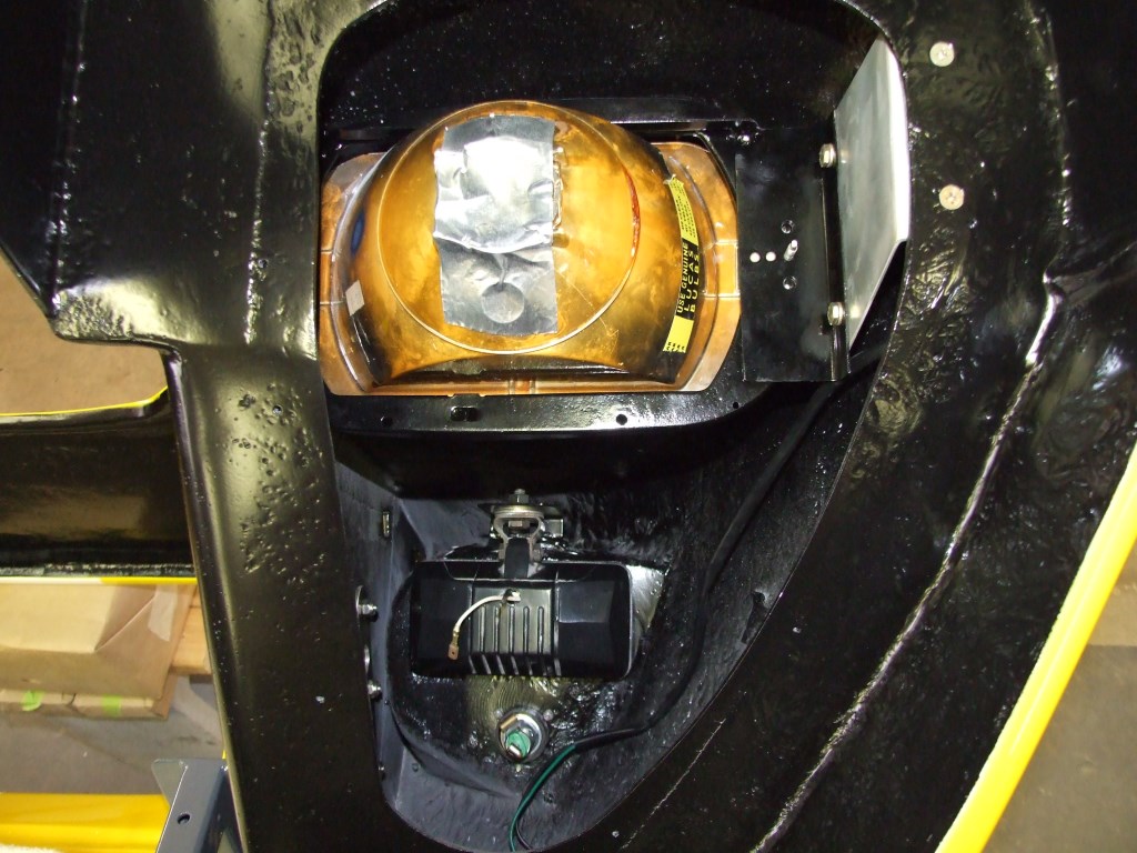

Clayton
Lights fitted, ready for wirings.
