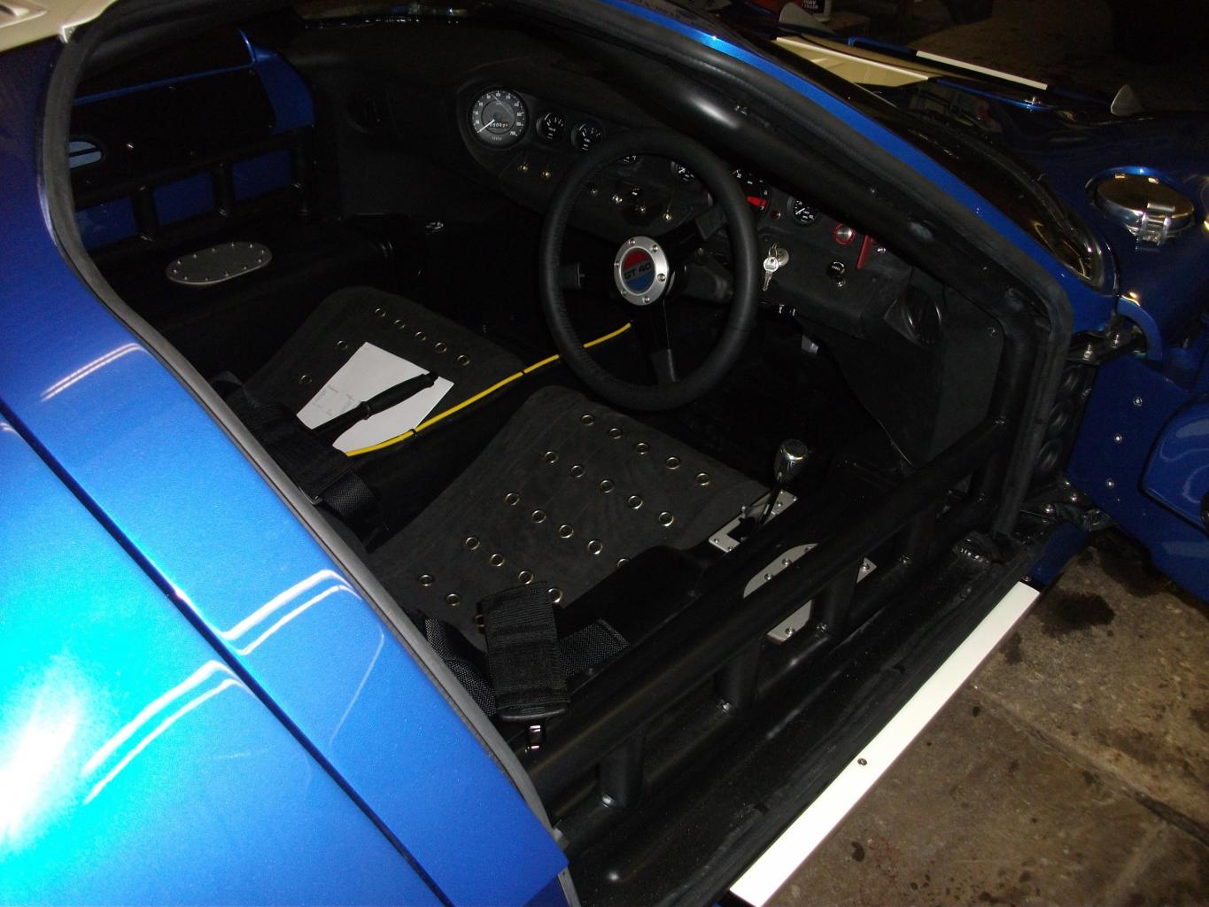

Are there maybe any pics, specs or drawings available of these two types of roll cages?

You'll find more than enough folks on the forum who can help you out. My T70 replica is fully caged for SCCA/NASA events, has race log books to boot, and wears a license plate and road registration. So it can be done but it does take a lot of planning and communication with your racing sanctioning body.
Many of the time trial road events like the Silver State Challenge etc. don't have as strict a requirements for cages as SCCA rules for wheel to wheel racing. This is also true for the historical bodies as well. So sort out who you want to race with and then get their cage requirements.

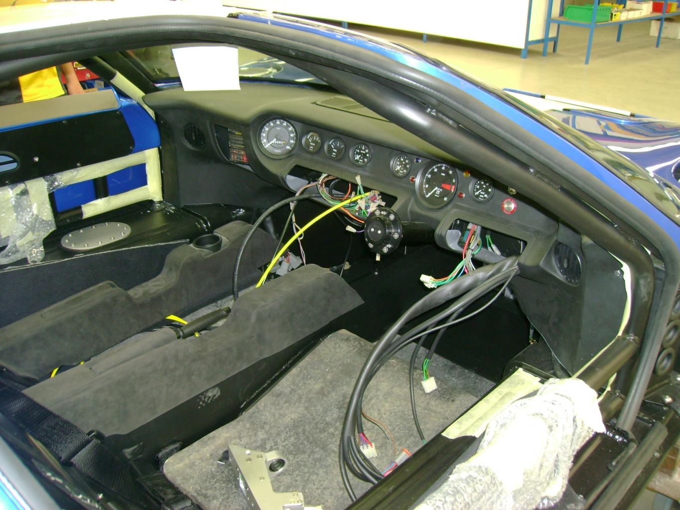

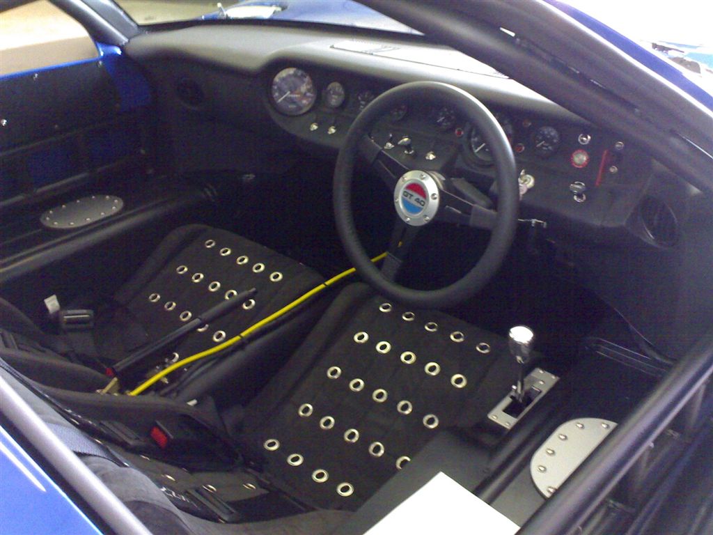

opps...too quick on the button.

Thanks for posting pics. I believe this is the SPF GT40R?
Side impact bars are not a requirement in open road racing like the Silver State Classic Challenge etc.
Yes,
That is the "R" cage. I can't get the non "R" four point cage picture to post.
As stated you can get the cage in most anything. Some of the cars like the RCRs can have the spyder removed fairly easily. So adding a cage is not such a big problem. Mine is a DRB and the spyder is not ever going to come off due to the way it was constructed with bonding, bolting and welding. It is a space frame. I think you will fine the monos the hardest to "add" a cage to during construction(culd be wrong). Some will mount in front of the dash, some have to cut the dash to fit. Then you have to decide if you want the rear hoop to be inside the cabin or outside in the engine bay. A lot depends on the motor selection and what options you plan to add to the setup. A drysump for instance can take up a lot of room in the rear bay. Eventually it adds up to space.
