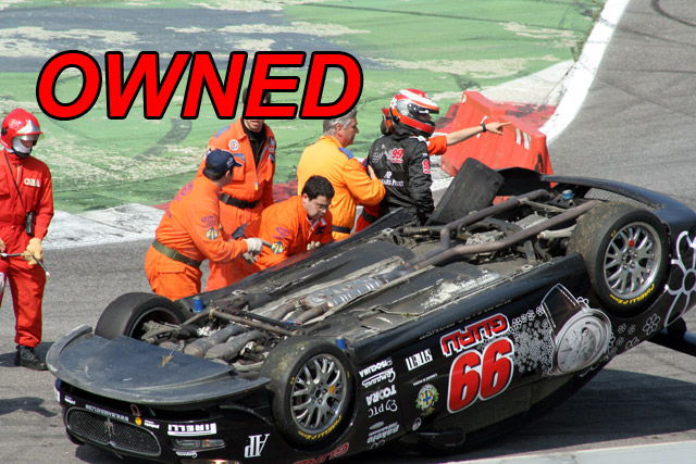

unknown italian driver.
Just we know Maserati (at least THAT Maserati) pilots are not so good, neither at home.
This picture I get in "prima variante a monza" last year.
Wheels to the sky, all happened in yellow flag lap..and at less than 30 km/h.:quirk:
The laugh from people reduced to silence engine noise...for 10 minutes, and all finished with a colossal LOOSER scream.
ONLY LOL....

Hate to see that stuff, good driver or bad.
Having been on the receiving end of a lot race happenings like wrecks, fires, and explosions I know how much work goes into getting a race car on track and racing it. And I know why so few of us do it - it is damn hard to do and takes a phenominal amount of effort and time. Hope that fellow is okay.

nono Ron, this is really different.
maserati and ferrari challenge here is just a rich expensive way to (try??) race.
Usually actors, singer,soubrettes, pin ups.....rich puppy and so on drives in those cathegory (and thats why I support my aussie ones).
Nobody makes as u guys there...preparing by yourself the car..checking all details and feeling real race.
Here they just call..pay 10k euros and make a race, without knowing the track also.
Is just a show cathegory.
I've also seen how are done the cars under the skin..thpse are miles and miles far away from a real racecar (only a rollcage inside and some stickers).
To give an idea..Lap times in monza of such cars are 30 seconds higher than 2000 cc cars from wtcc (around 2.02..they ran in 2.40 as best time..and with 200 hp more eh...)
When the cars is that way, the team usually is happy, and a lot, cause they only earn a lot from insurances.
