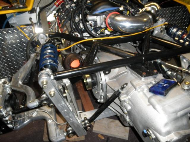

Got the engine started, Fuel is now up to 60psi. The LS won't idle unless I choke about 85% of the air intake. The i get a rough idle but it's the only way to get any idle.
When i give it some gas, i need to choke less, say around 50% and it runs smooth at 3K rpm. I put my MAF sensor exactly 10" off the intake.
Anyone have any ideas? Will i have to reflash my ECU to change up the air/fuel ratio?

Stupid question, but you said your cats were glowing red before - doesn't that usually mean a crapload of raw unburnt fuel is exiting out the exhaust ..... either really rich a/f, clogged injectors, valve/ring problems, etc.... - I'd imagine one of those would be responsible for your idle problem? Probably a/f and need to get on the dyno to get it tuned properly?

uhh, ok i'm stupid. Mass air flow 180 degrees out. redrilled holes, stuck it back in runs like a FRICKIN CHAMP! Thanks craig for the hint on powerheads. i needed to make sure the maf air intake faced the input. big dif.
The blue flames coming out the back was kind's fun! Do you mean to say you had the MAF on backwards?

Had a similar problem with my car. After market ECU (Autronic) and toyota V8. Problem was the ECU needed a manifold vaccum sense to it to map correctly and no-one told me. ECU had a small input spigot (which I thought was a static air pressure sense, but it wasn't. It wouldn't idle unless the throttle was held open and the CAT's glowed RED.

Mesa, yup, the tiny scoops were faced toward the engine, not the air filter. I could only get it to run if the air was swirling around in the intake. Didn't see a word about it being directional in the crate engine paperwork. It sounds like there are a few dozen people that had the same problem out on blogs so i don't feel that bad.
