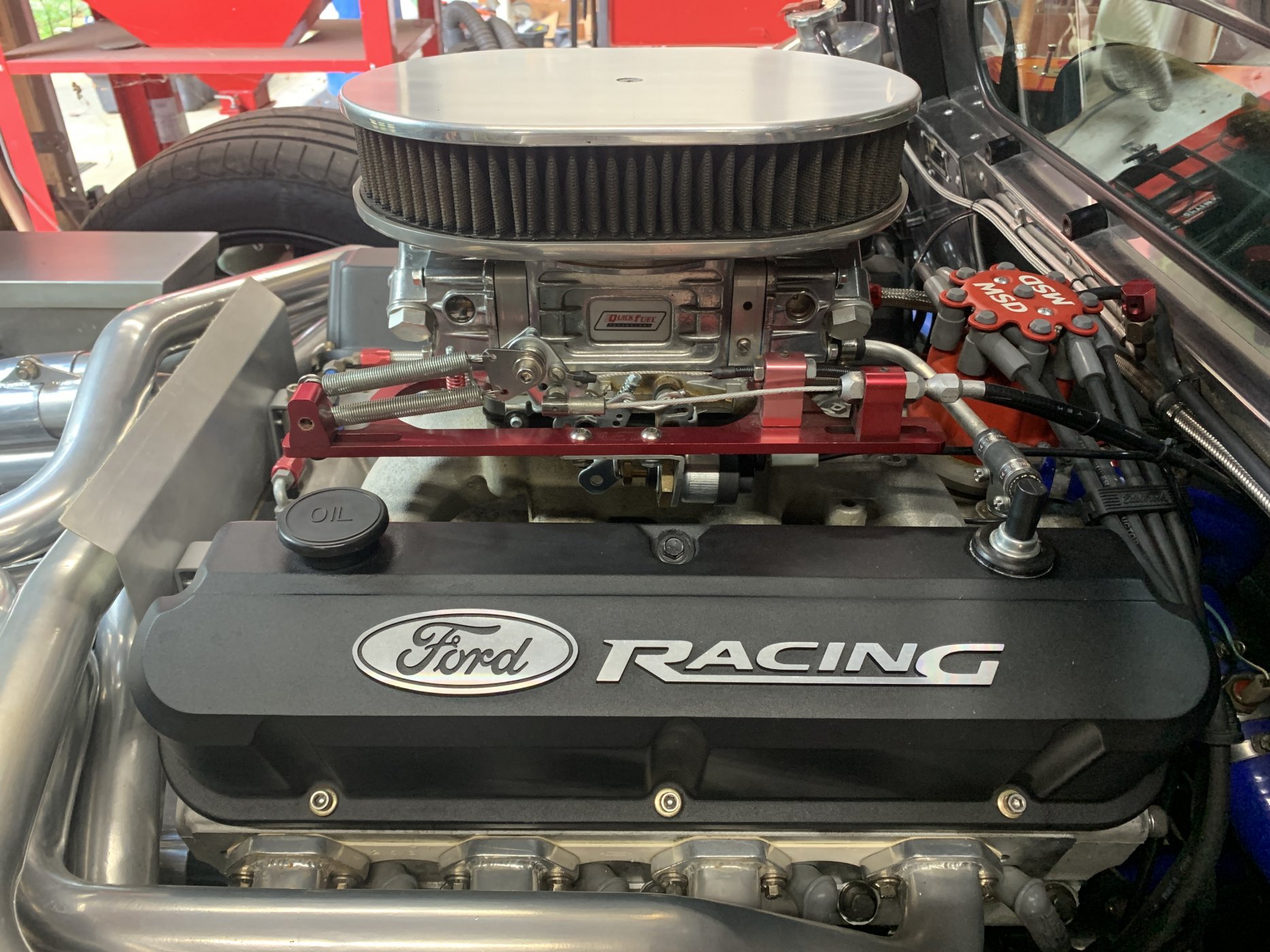

I have for 16 years run my 4150 double pumper carb backwards on a Edelbrock RPM Airgap Performer intake manifold. It’s simply easier to run the throttle cable instead of fabricating a bell crank. I have never been satisfied with the idle quality and wonder if this might be the problem.
Opinions greatly appreciated!

Orientation on the carburetor can be in either direction without a problem.

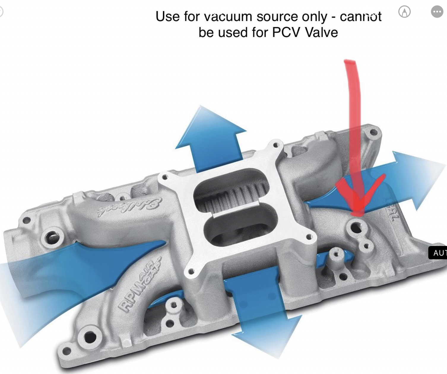

Having recently fought with dragons over poor idle quality on a similar situation, I found that the PCV line had been plumbed to the vacuum port on the intake. This caused the cylinder on that intake channel to run so lean as to misfire. I re-plumbed the vacuum lines and the car now idles fine. I also routed the vacuum advance on the distributor to the manifold vacuum port on the carb and it’s like a brand new car. I can’t tell how all your lines are oriented from your picture - so just offering this advice somewhat blind..

I do not agree on this one, and most manufacturers will advice against running a carb backwards and most carb related books do say also.
Primary bowl always up front, cause when accelerating the fuel sloshes to the back, and so on into the primary metring system with the most importance, it keeps the emulsion tubes filled. (main jet - emulsion tube - air correction jet)
Running a carb backwards, on accelerating will slosh the fuel from the primary system to the back of the float chamber... out of the carbs fuel system, lowering the fuel level of the emulsion tubes, creating a lean mixture. (flat spot, hesitation, bogging, misfire, etc).
These issues won't show up on the dyno as the car stands still.
For fast accelerating cars Holley offers jet extensions for the secondary float chamber to keep the jets fueled. But thats for the secondary float chamber only.
I made myself a long enough throttle cable ( & a spare one ) to run the carb the right way around.

Thanks guys for you response. I spoke with Edelbrock today and they confirmed what Paul said, I may have problems with hard acceleration as Paul stated but not in many cases. This problem has not occurred for me probably because of my driving style.
I tend to agree with the comments above (re:fuel slosh), but have seen many run “backwards” with no apparent ill effect - even on track cars and many boats. I would retract that recommendation for cars that are used in high-G acceleration runs like very fast Drag cars. However - food for thought - The secondary metering blocks of the Holley carbs would also suffer the same fate when oriented properly…
