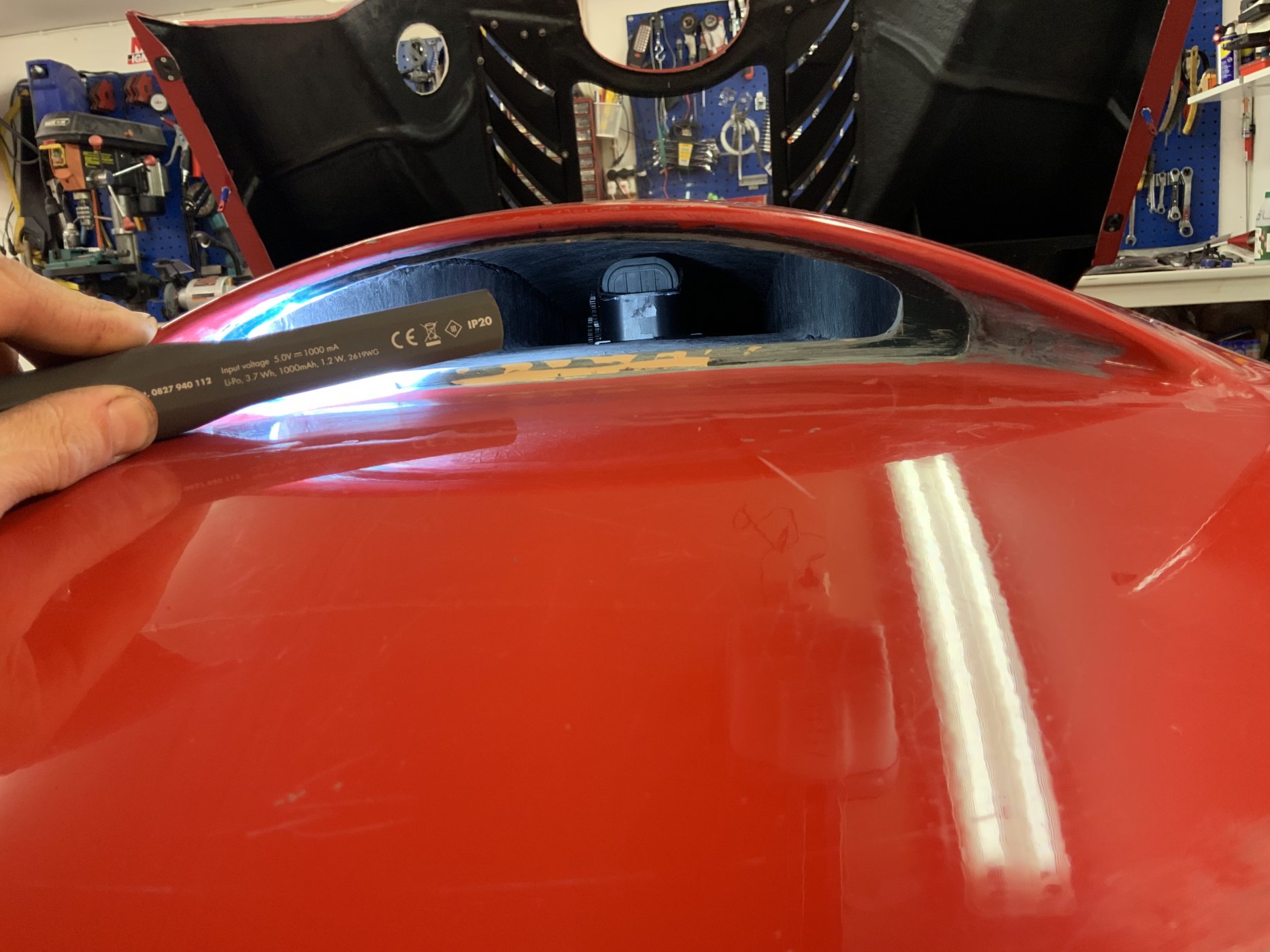

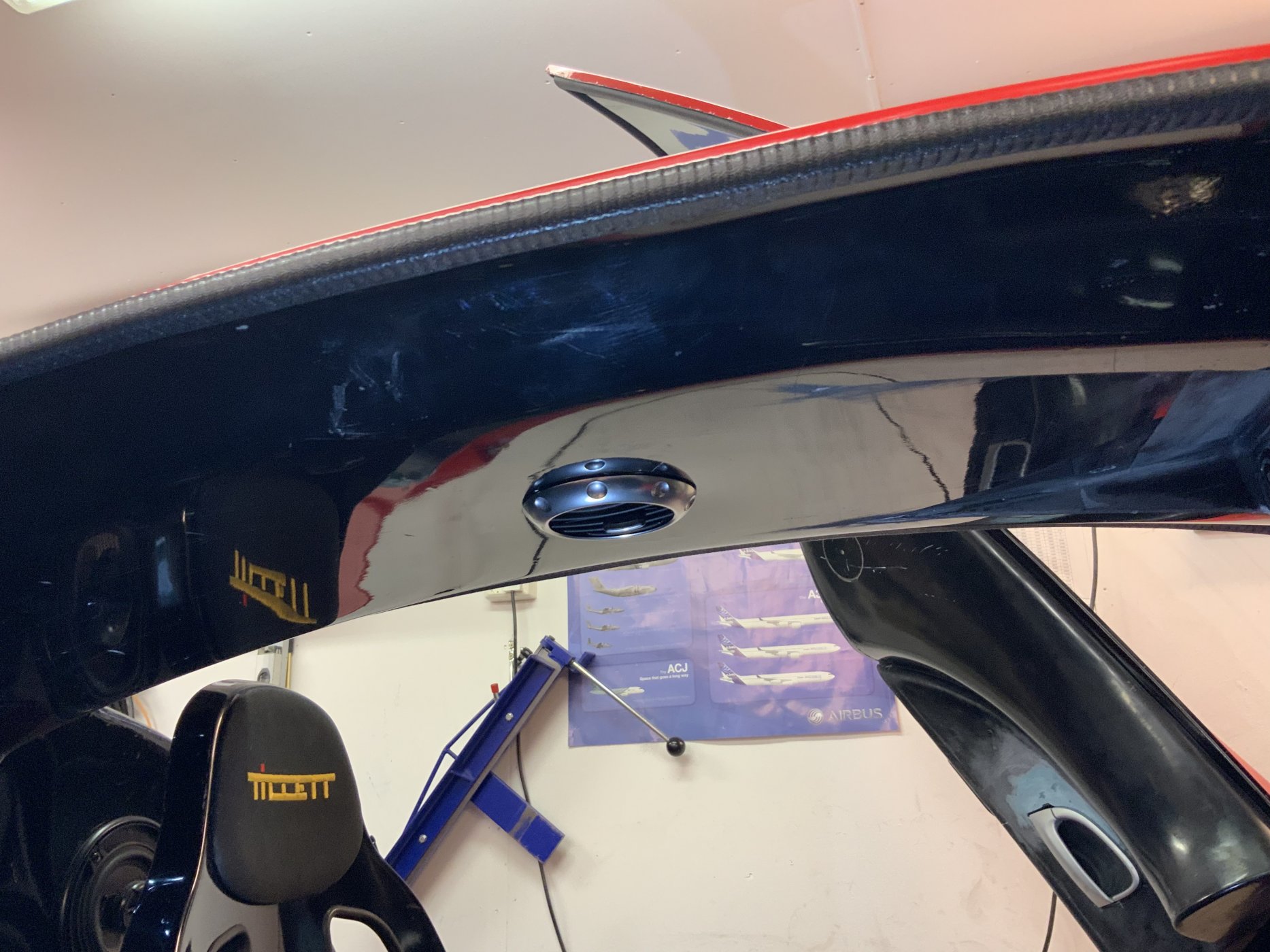

Next thing was exhaust fumes in the cabin. Since the cabin/canopy of the car is shaped like an airfoil it will most likely be an area of low pressure on top of the car. I didn’t pay too much attention when installing my weather stripping since I’ll ripp it off again in a month or two when painting.
So small leaks in the seals around the door most likely create a lower pressure in the cockpit, that together with a not 100% tight aft bulkhead it will draw engine compartment air into the cabin.
The remedy was to install a roof vent, I had one of the Audi TT left over. It works great and seems to equalize the pressure diff inside/outside.
I guess you need a fresh air intake anyway if you seal up everything.

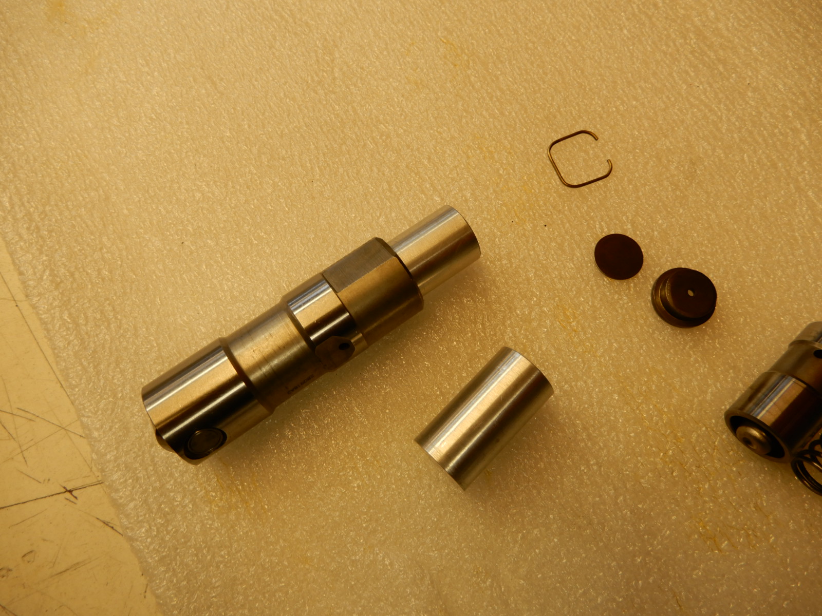

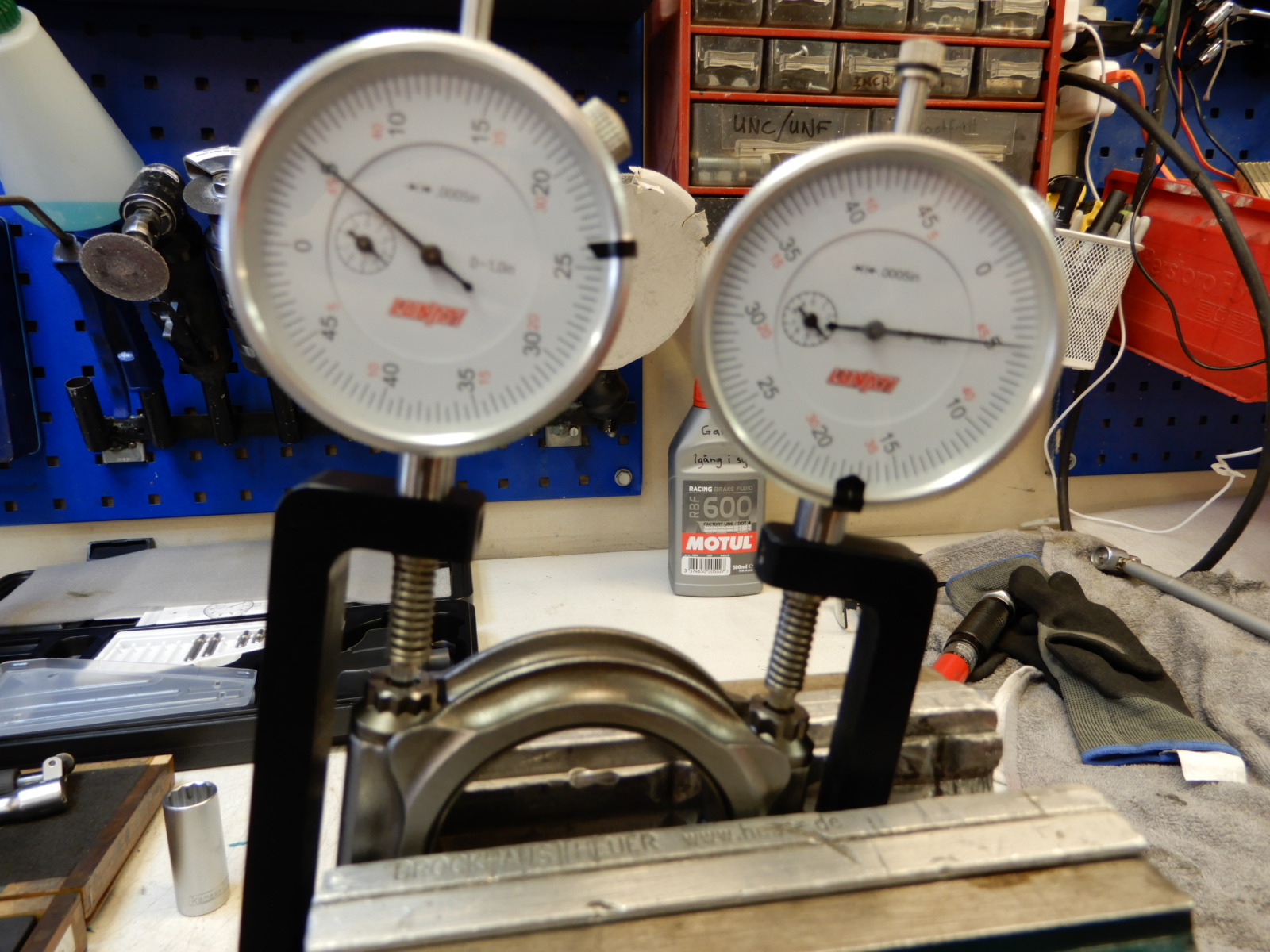

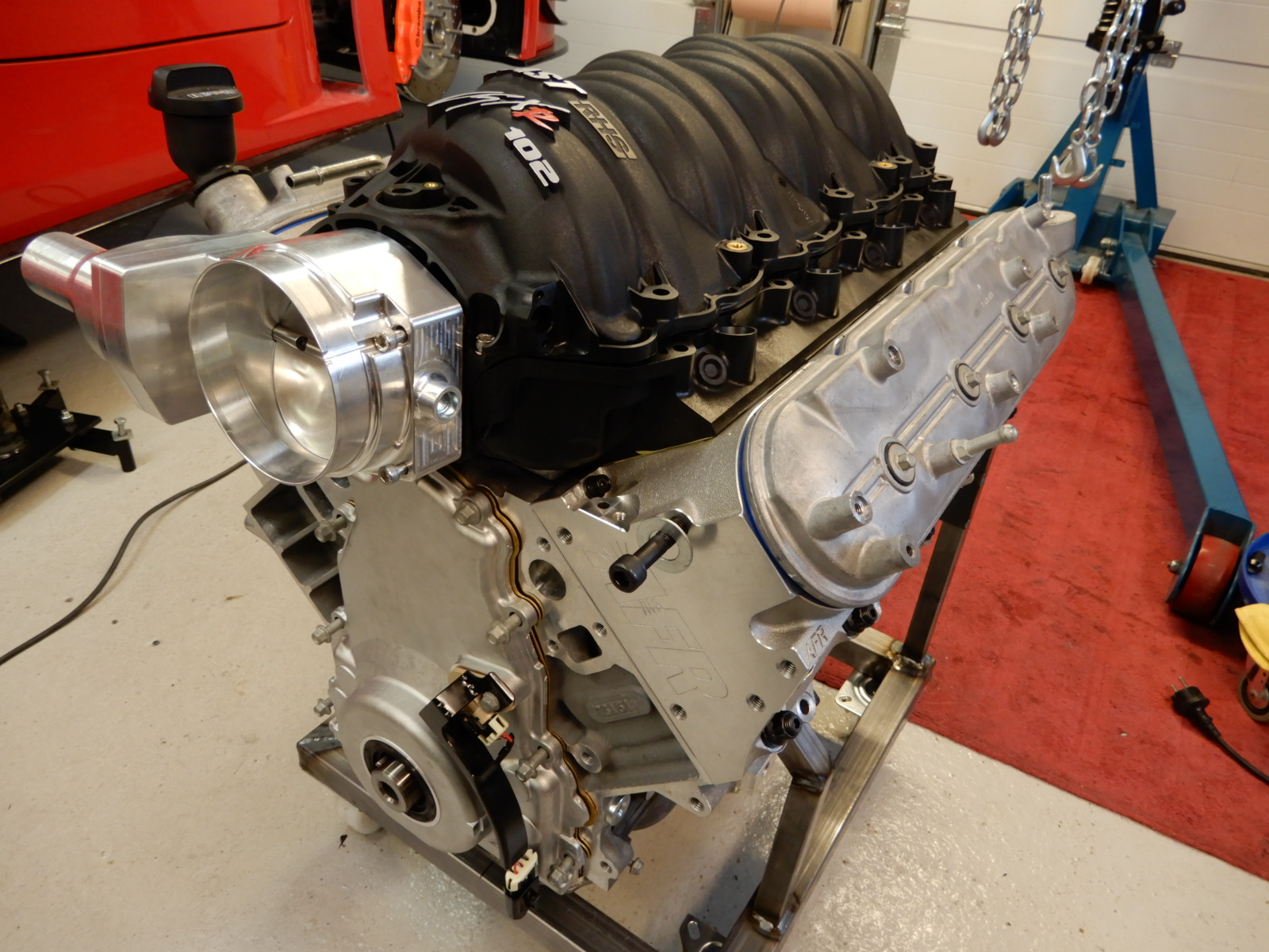

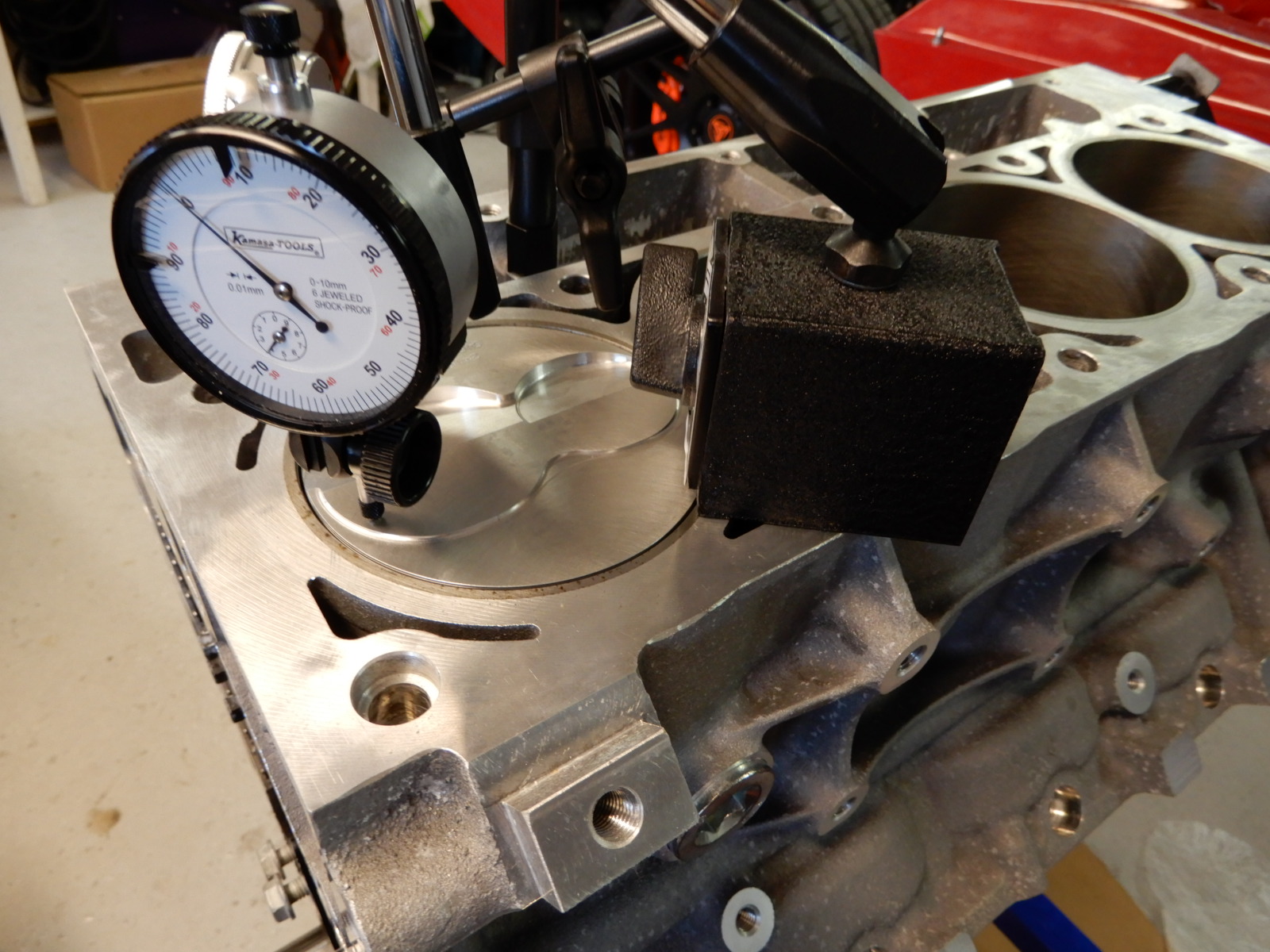

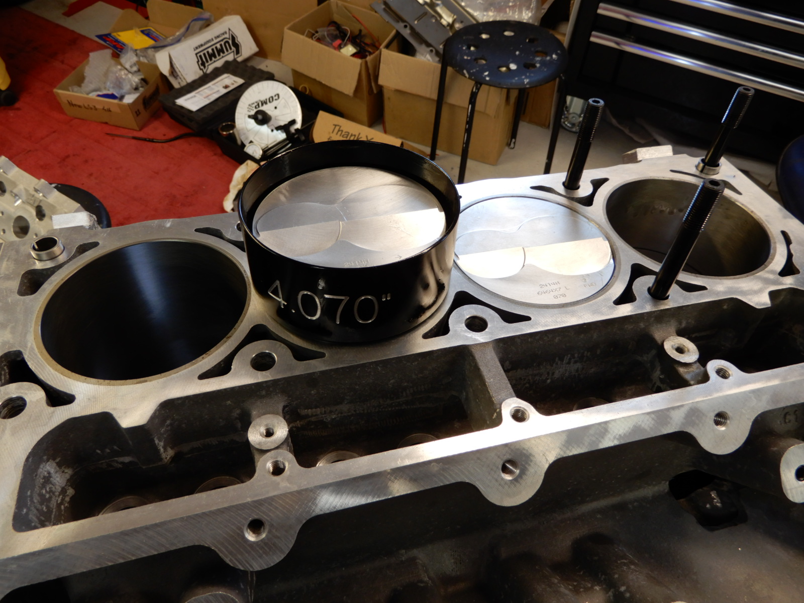

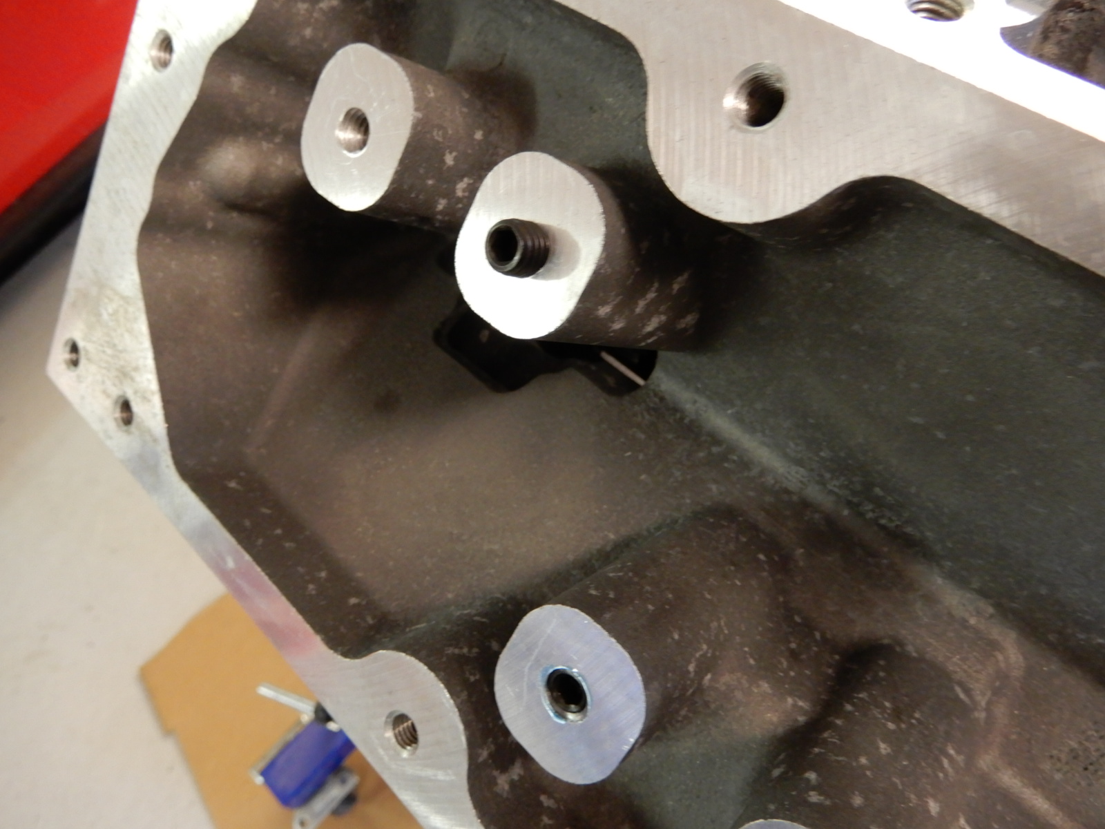

Being Covid-bored I decided to build my 416", I've had the parts for a year and now was a goood time to start. After weight matching rods and pistons a buddy of mine balanced the rotating assy and also honed the block to 4.070". I made two alu plunges to make solid lifters out of two hydrualic ones nessessary for degreeing the camshaft and determining pushrod lenghts. Don't know why most rod manufaturers gives stretch values in stead of torque.(it's supposed to be more accurate) As it turned out I got the correct amount of stretch with exactly 108Nm on all 8 rods.
Since it happens from time to time that the o-rings leak and you get bad oil pressure I plugged the oil towers (VVT) under the valley cover. Tapped with UNC 3/8" and a hex plugg. I didn't touch the AFR 260 heads other than checking the spring install height. On top it's a Fast LSXR 102 manifold and a Nick Williams 102mm throttle body. Camshaft is a Comp 54-469-11 , a tuneable/driveable medium sized cam.
I've seen Richard Holdener dyno two identical engines and they make 630-640HP to the flywheel without accessories and elec waterpump so I think that will be on the upper limit to what I want.
The motor is in the car now and runs very good after two weeks of tuning. Later on I'll take it to a professional tuner once the engine and clutch is broken in.

Yes I know it’s more accurate, but the last three motors I’ve assembled the stretch has been dead on with the same torque on all rods. Just have to figure out the torque numbers if the manufacturer doesn’t include it in the instructions. It might help that I always use the same ARP assembly lub and clean the threads before.

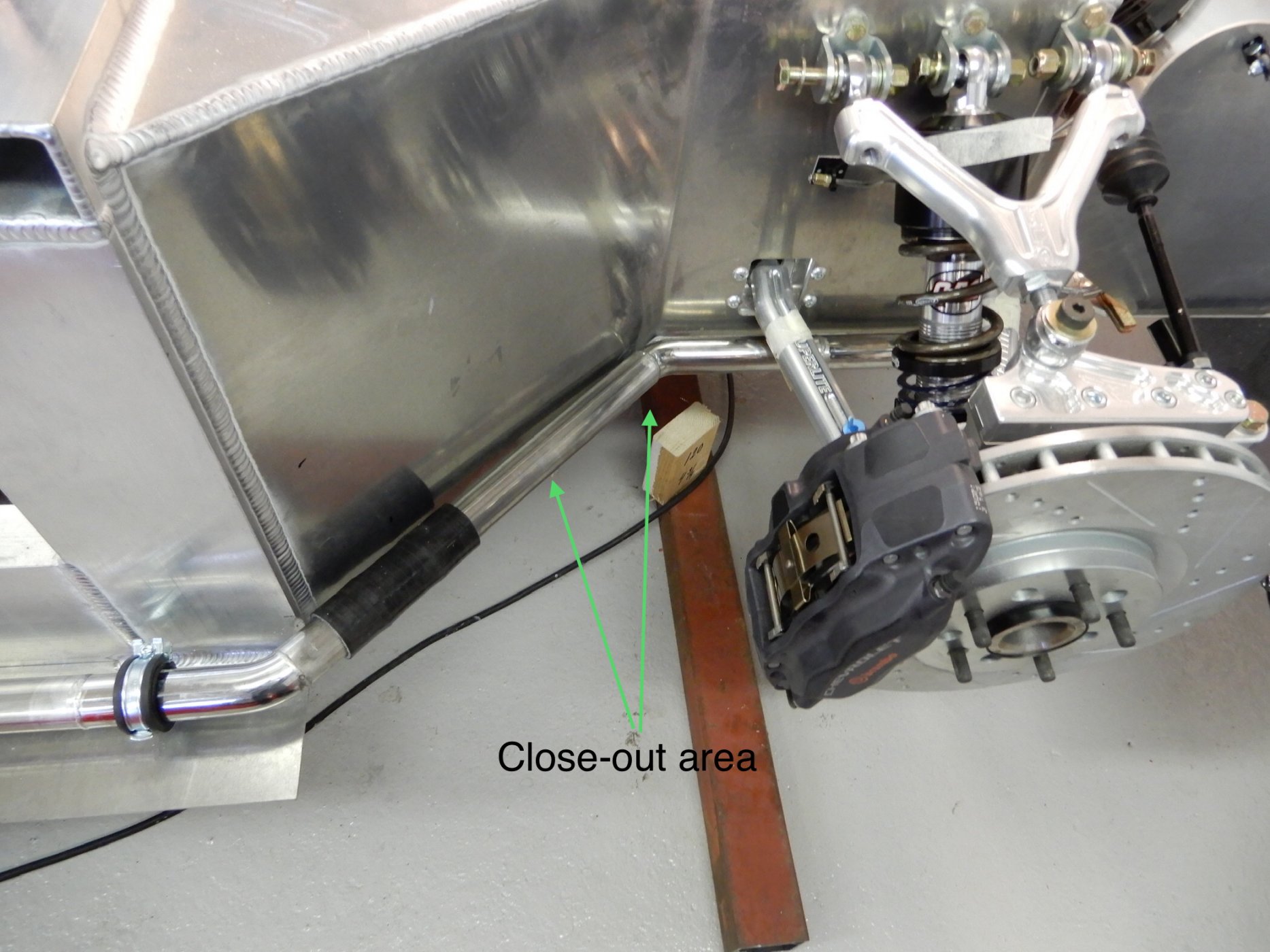

Hi Johan,
I am in the process of designing the cooling tubes. Wondering if you were happy with were you put this union. Can you get to this area with the body on? Thinking either I would put it where you have it or further inboard behind the close out panel that has to be fabricated.
Johan
Joel, that close out panel you have to fabricate will extend all the way to the extended floor panel. That is if you fab it to cover the bottom as well.
To answer your question, yes I’m happy with the union position, it’s accessible from below, just remove the close out panel before.
I’ll try to remember to take a picture of it tomorrow and post.
I also added a coolant drain plug just ahead of the union on both sides.

Thanks Johan, appreciate the help.

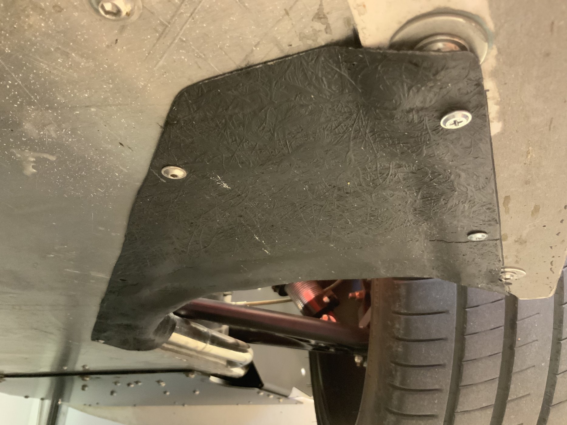

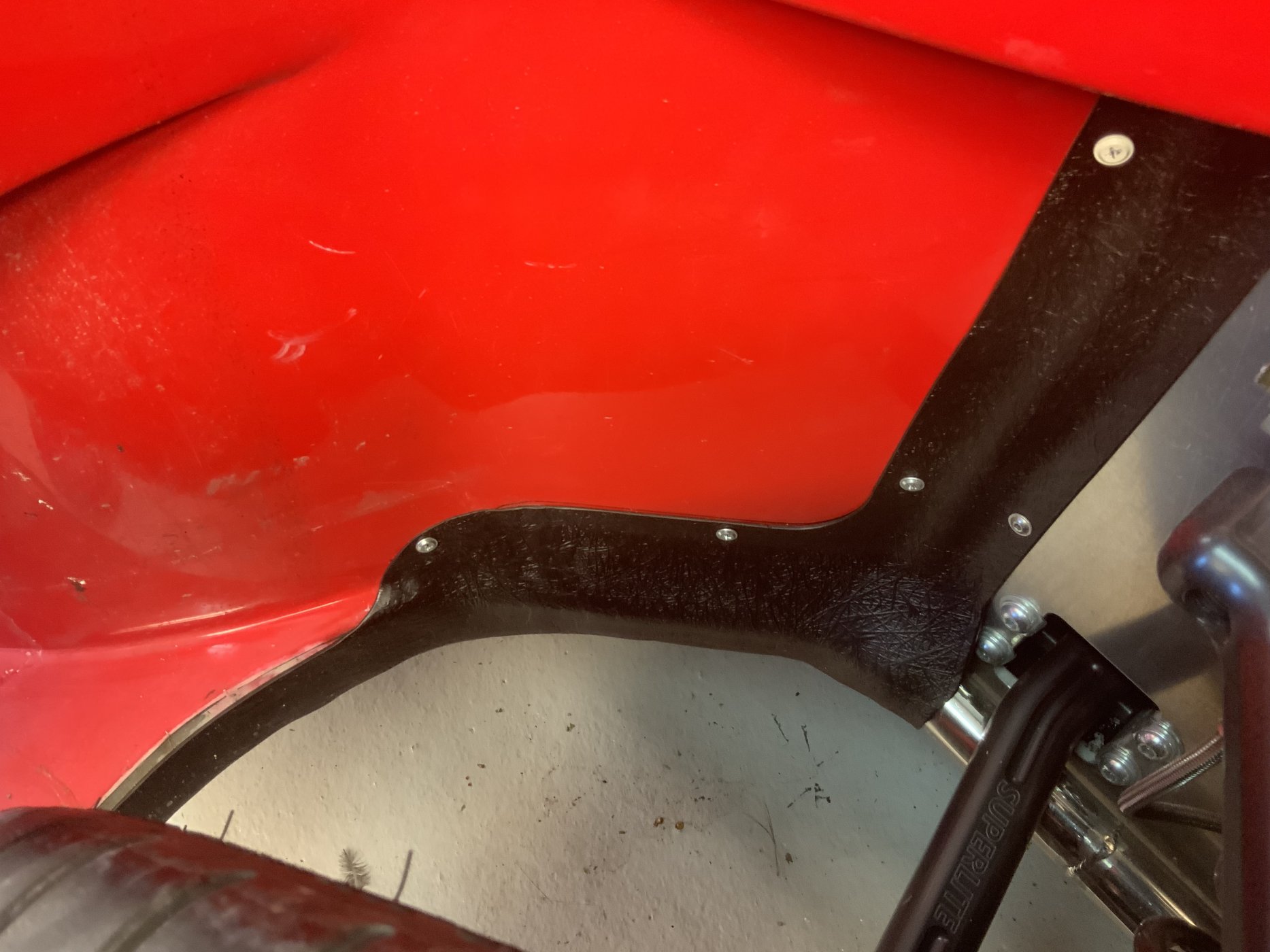

Joel, I forgot about the pictures but here they are.
I put one layer of 5mm thick tape on the coolant tube then filled the cavities between the tube and body with clay and smoothed it. From below I temporarely glue a piece of 3mm plexi from the extended floor panel to meet with the body then a layer of aluminium tape and fiberglassed over it.
If you put some effort to smooth the clay the outcome will be pretty good.

Pardon my ignorance, but the tubes that came from the factory do not have a union at that location, is a solid tube all the way through the side of the car. Also why would you need a drain plug on both sides of the union at that location? I just have a drain plug next to the radiator. Beautiful close out panel Johan.
