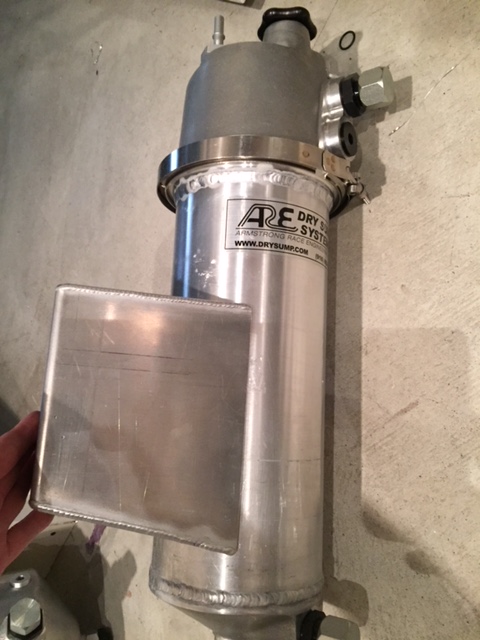

Johan if you are planning on tracking your SLC then I'd suggest a minimum dry sump tank size of 2 1/2 gallons for a LS engine. Your picture looks like a 2 gallon tank.
The C6 Z06 Corvettes from 2006 to 2008 had a 2 gallon tank and it proved to be problematic with owners who installed stickier tires and coil over shocks. GM upgraded the tanks the next year (2009 and up) to hold about 2 1/2 gallons and that seemed to help stop the engine failures. They still use this expanded tank in the C7 Corvettes.
You can add a piggyback section to your tank as shown in the picture.

Ken, that piggyback lookes like a good idea, I will definetly consider it. However I believe the problem you’re talking about is mainly the Z06 ”semi drysump” .
I have the Bill Dailey system and he recommends 2 or 2,5 gallon tank so I think I’m good. It will be none or very little track driving.
