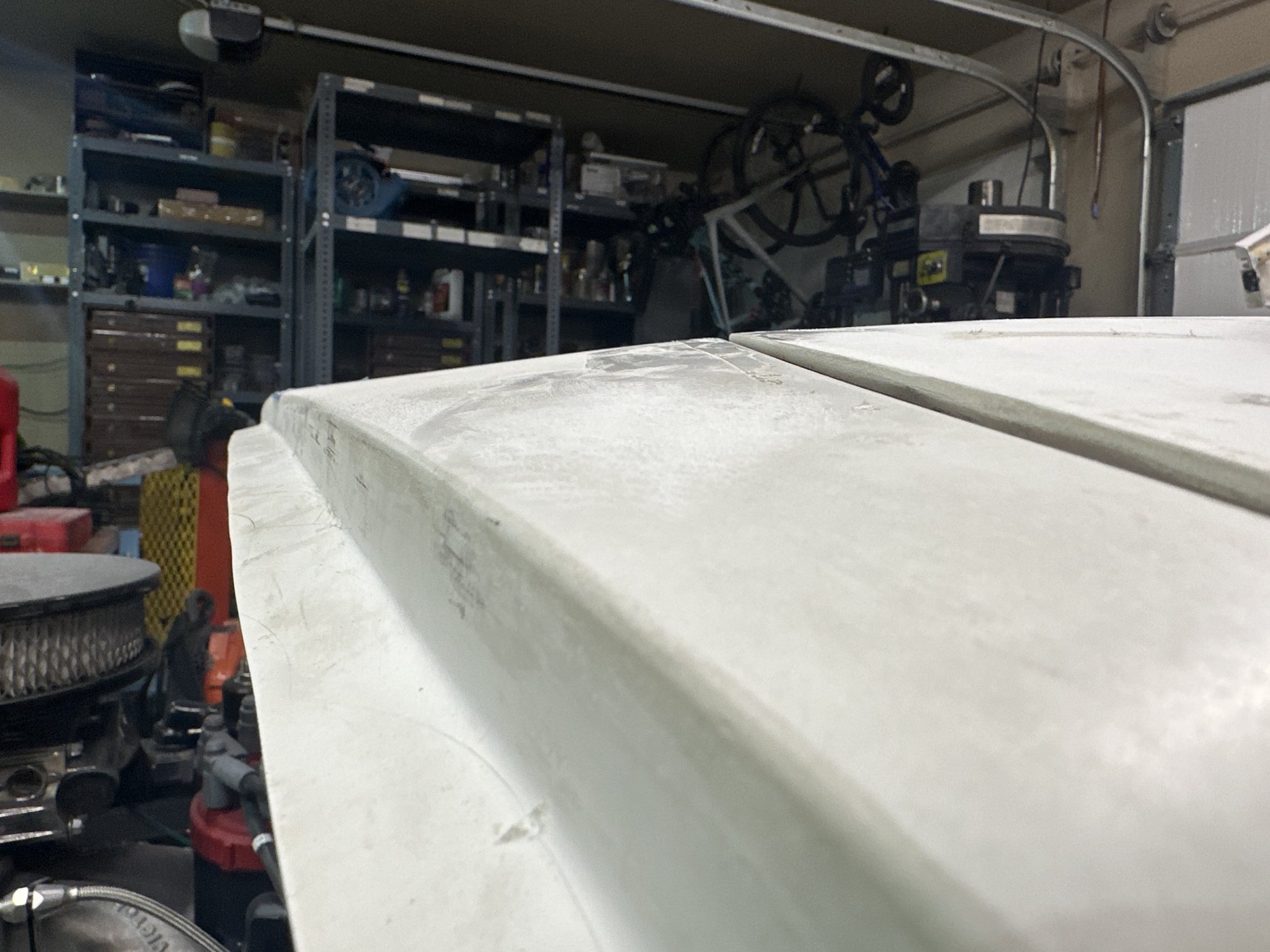

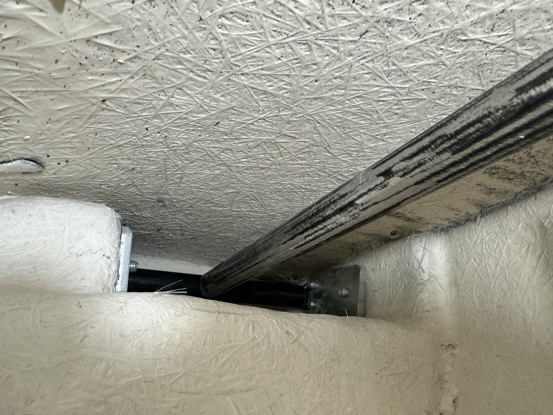

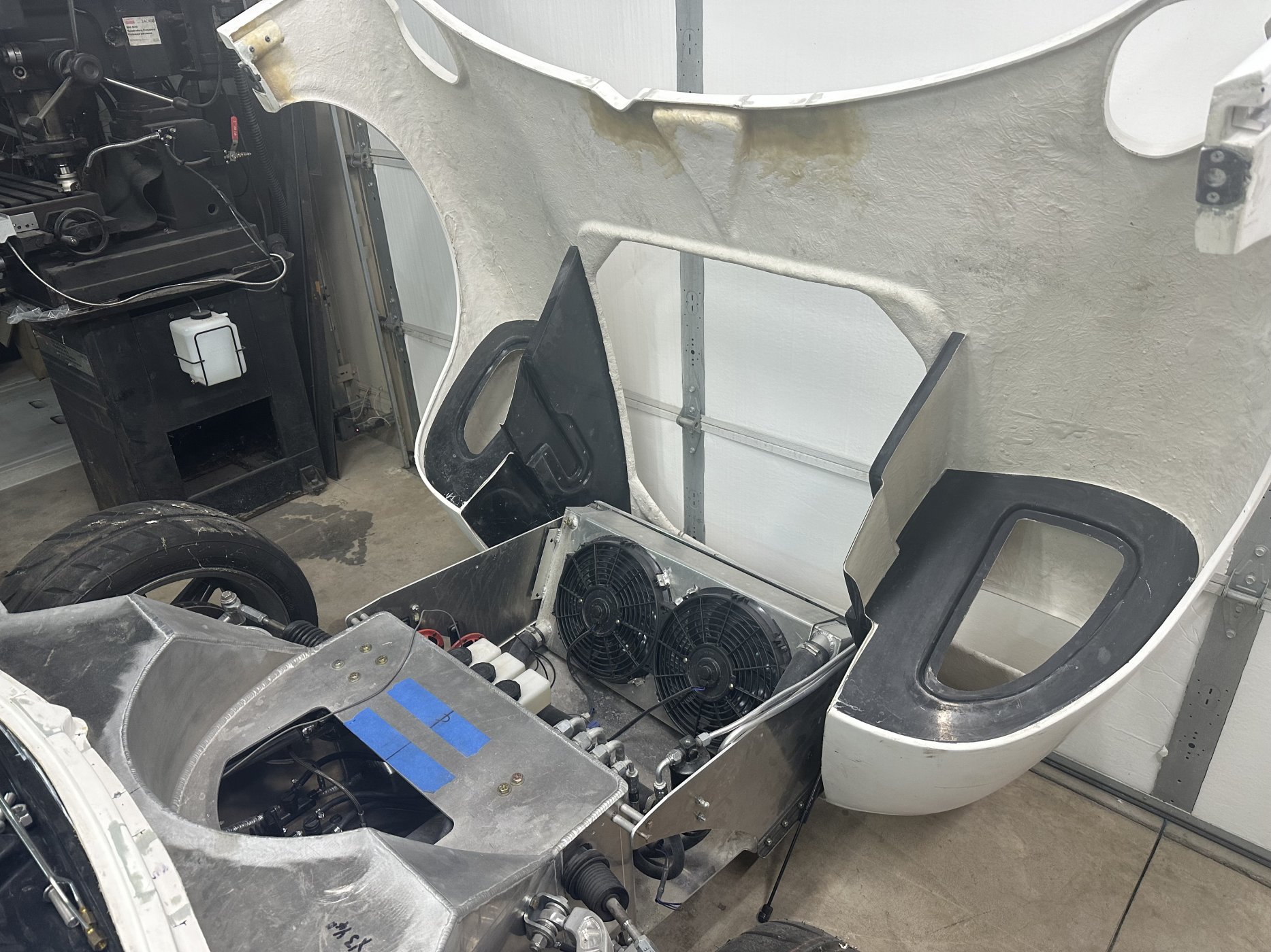

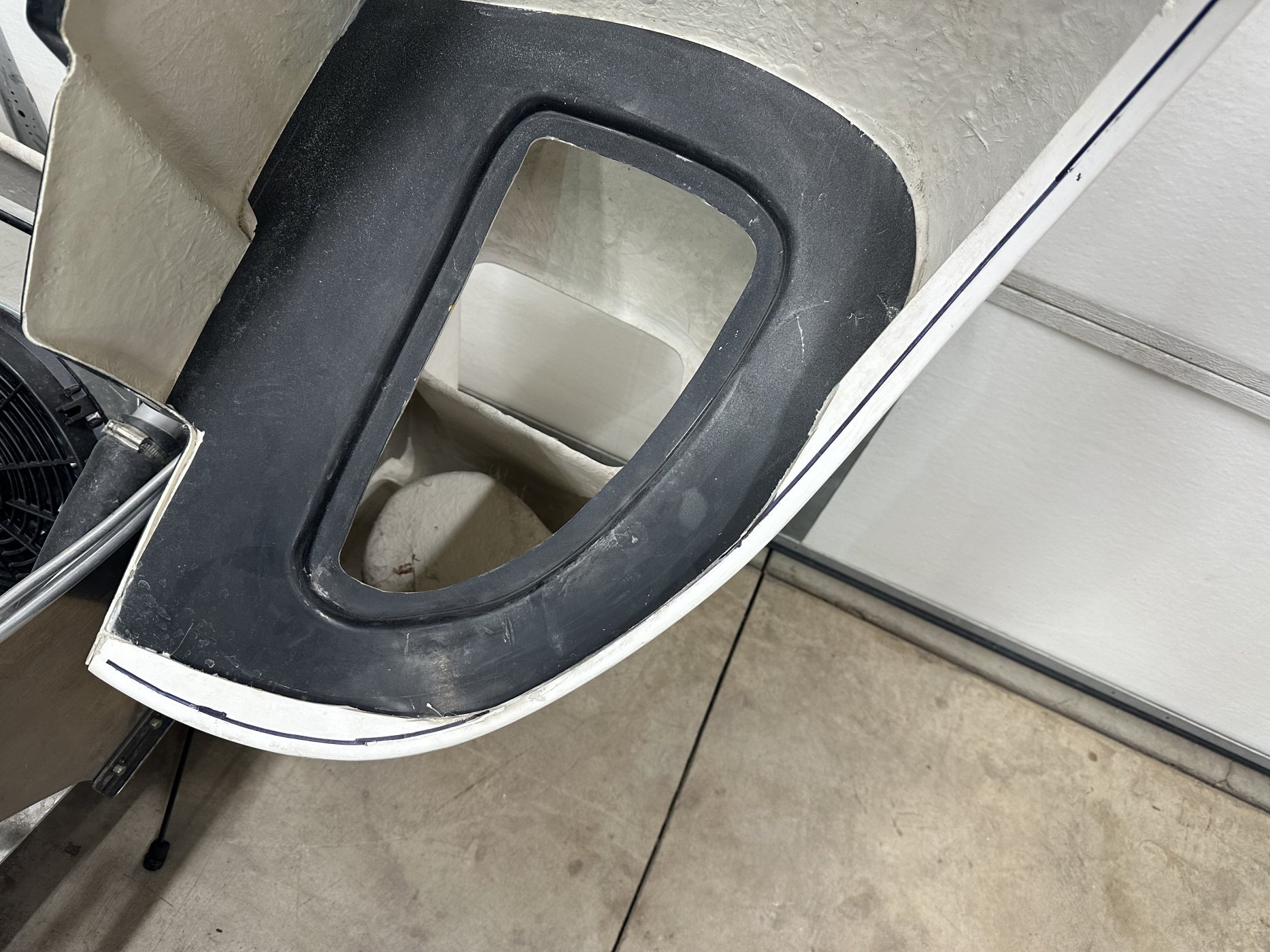

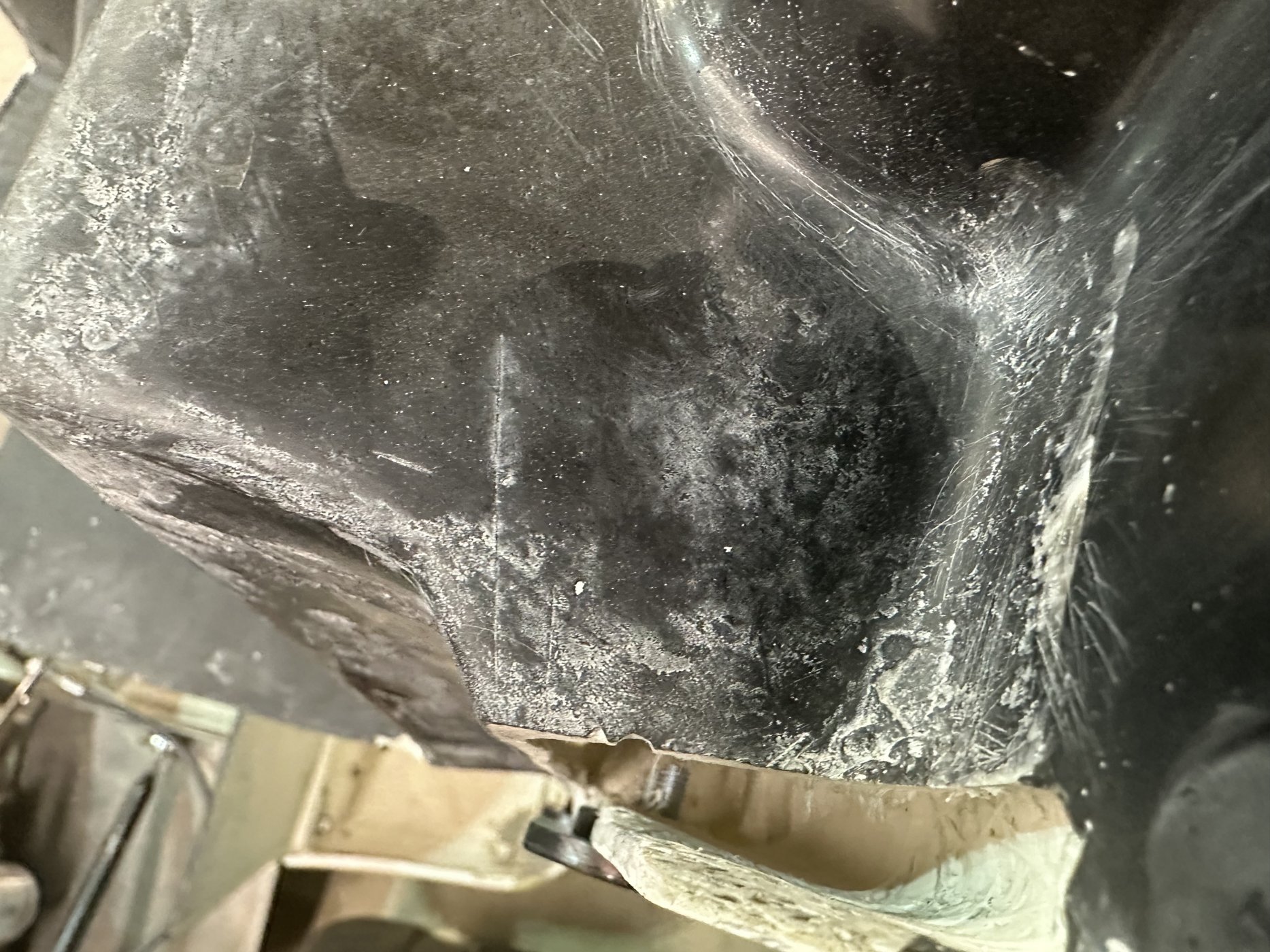

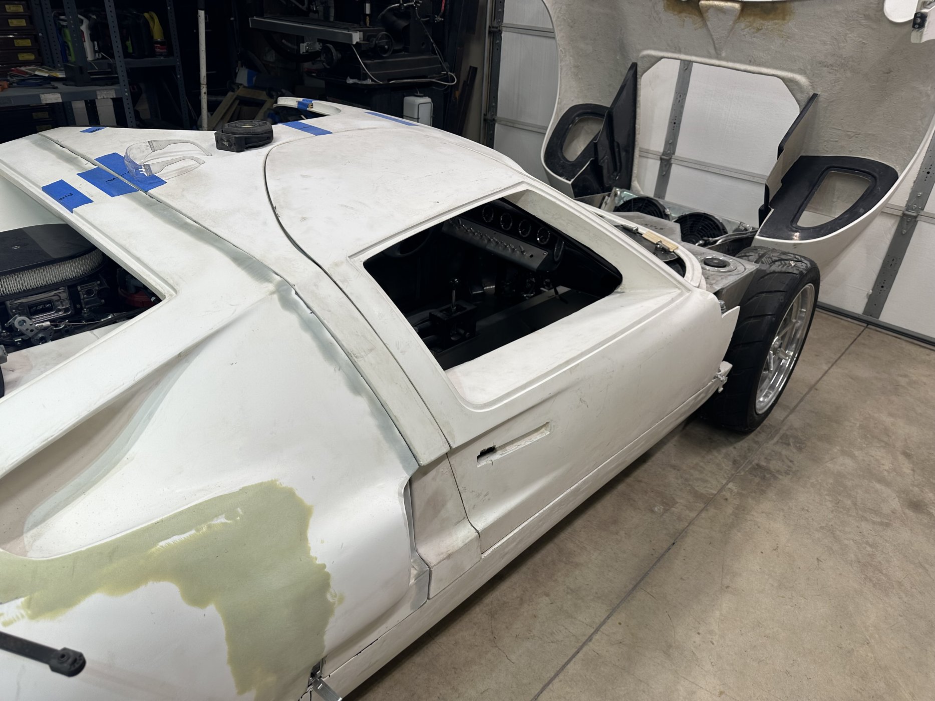

Been working on getting the body fitted lately. I was able to get the front end straightened out where the wheels were rubbing the inner fenders. All I needed to do was trim the lip out of the wheel well, this made the front panels on the car look a lot cleaner at the same time.

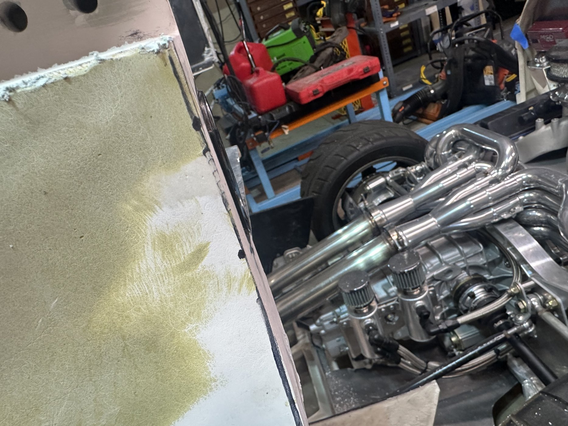

I also went back to door fitment, I found the spider needs to come up a bit on the passenger side at the firewall. I haven't worked out exactly what the permanent fix will be just yet, just that it needs to go up a little to make the body lines work. I also put one bolt in the door hinge as discussed in earlier posts. I haven’t made the anti intrusion bars yet, but that one step made a huge difference in how solid the door feels. I definitely suggest this for anyone building an RCR car.

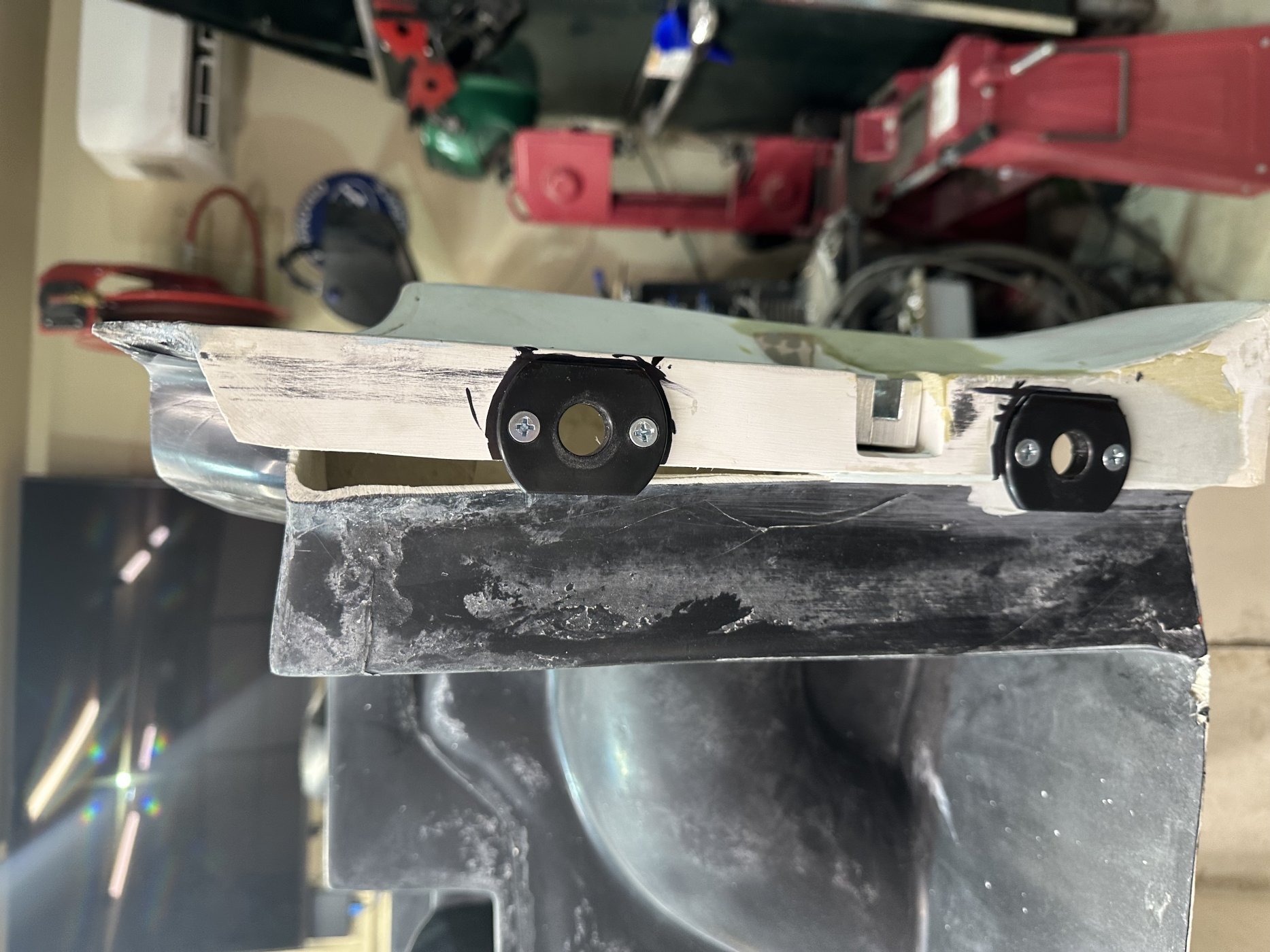

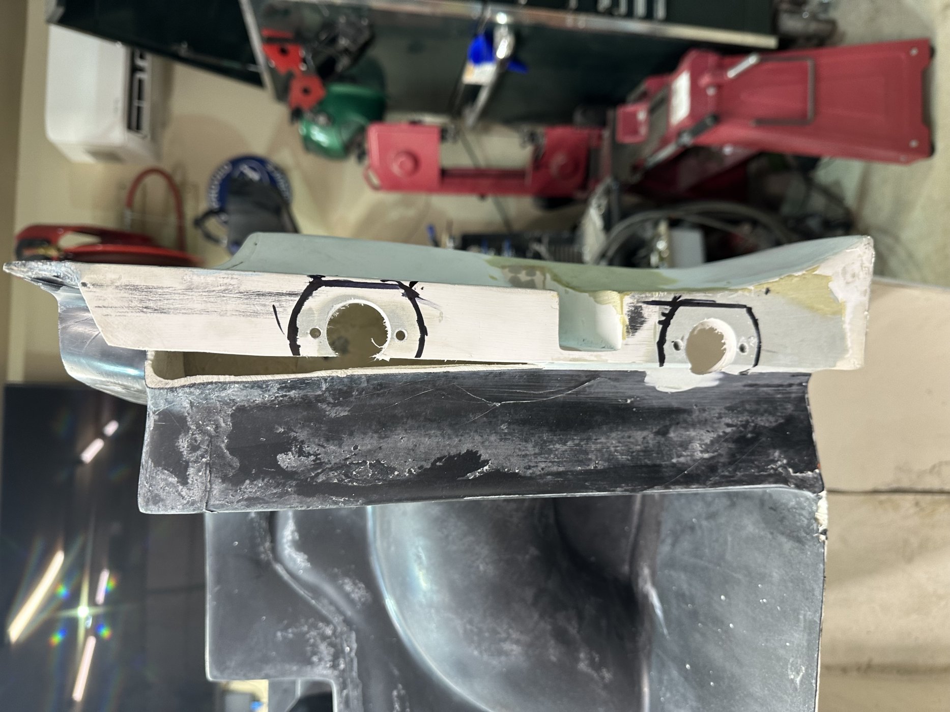

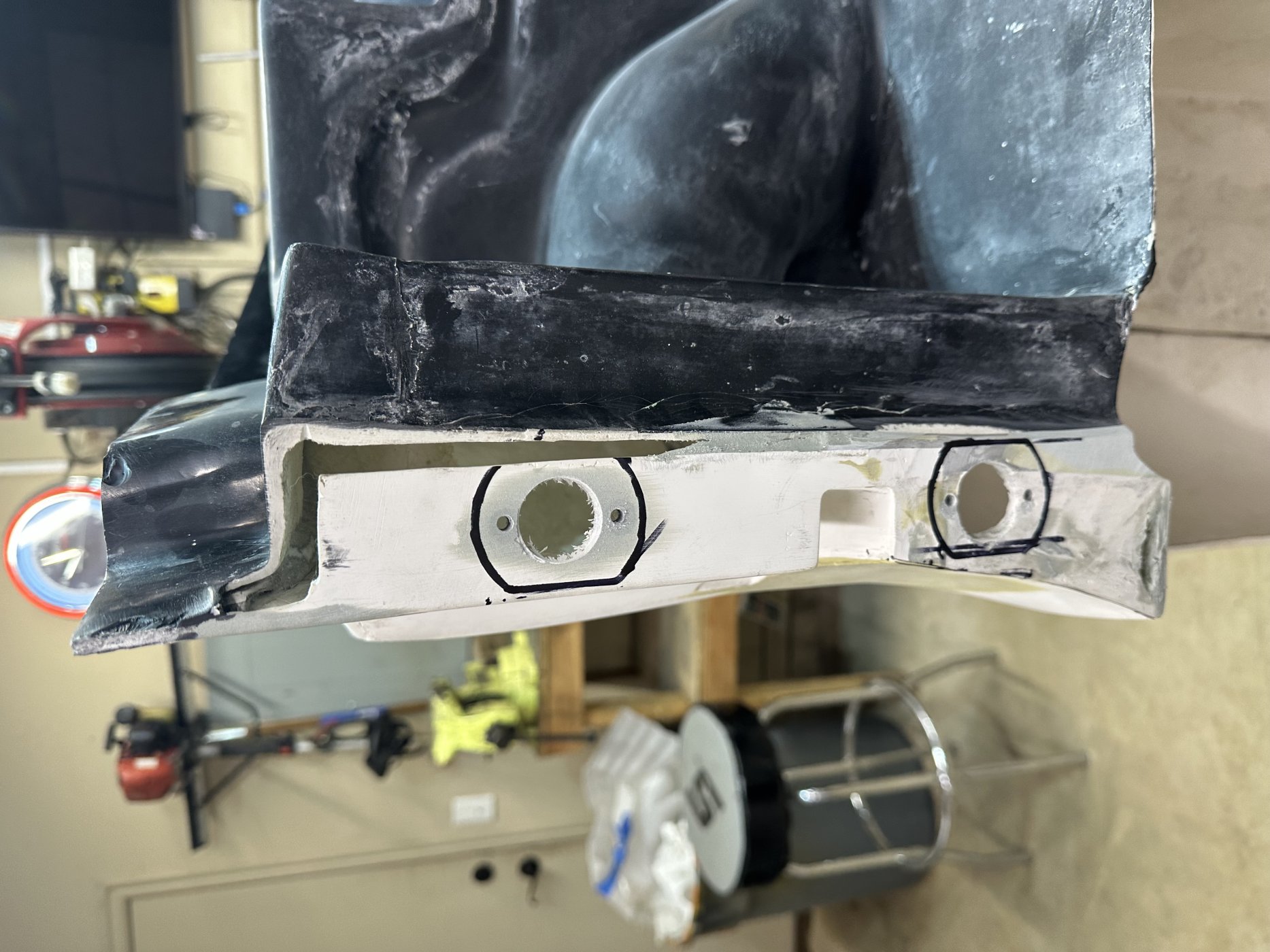

Sean Starkey

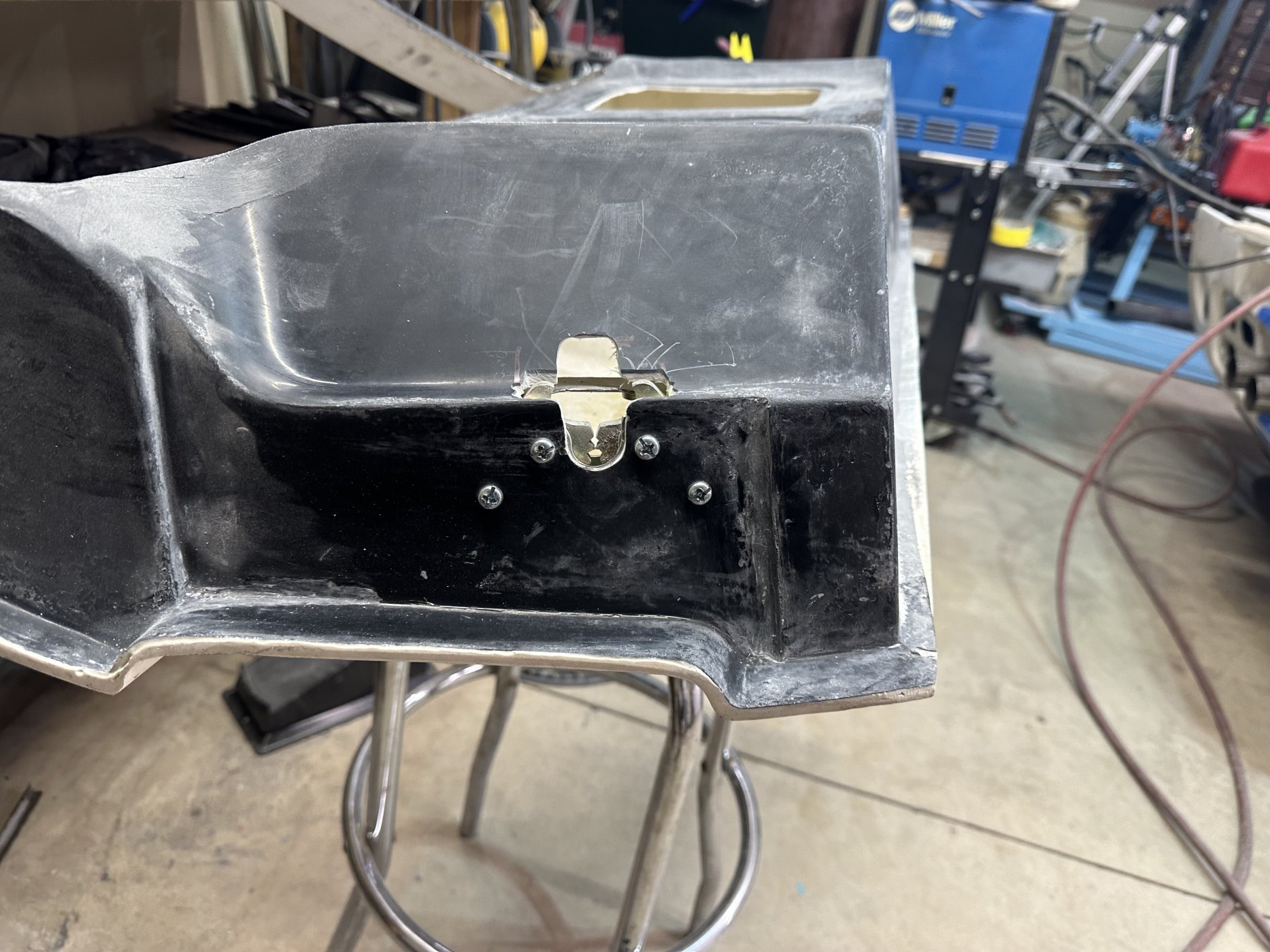

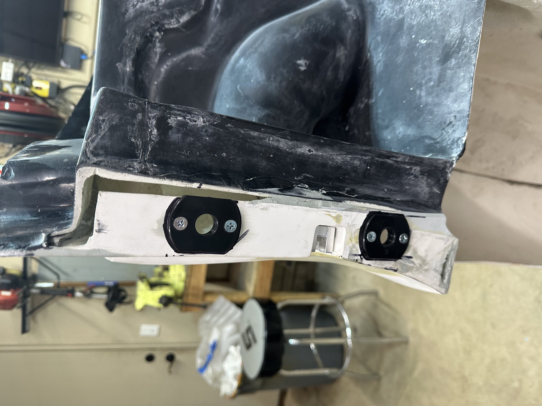

Working on the body pins for the clamshell. Needed a bit of fiberglass to build up a good starting point for the mounts for the pins. I opted to recess the body pins in the clamshell with only 1/8” sticking out. I did this by tracing where they needed to be and used a router to allow for the recess. They came out pretty good and work to hold an 1/8” gap for the body lines.

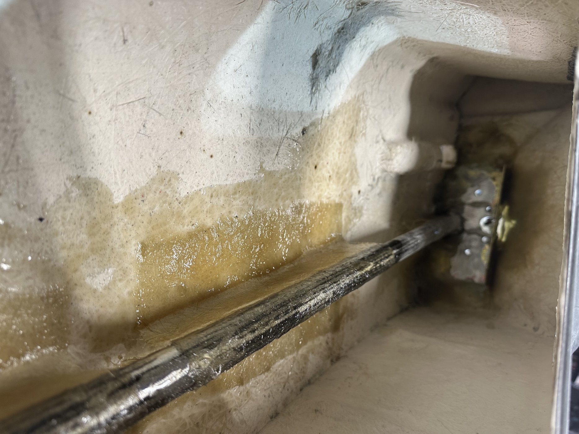

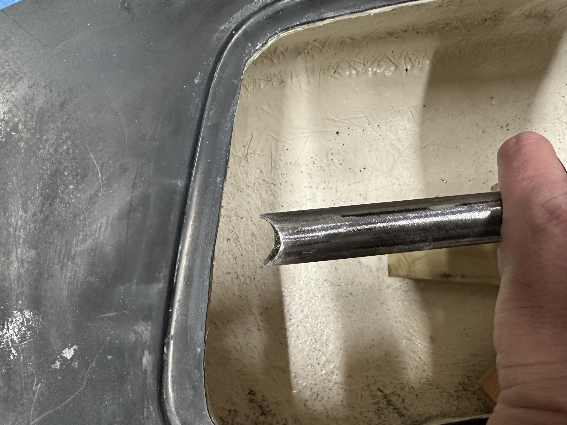

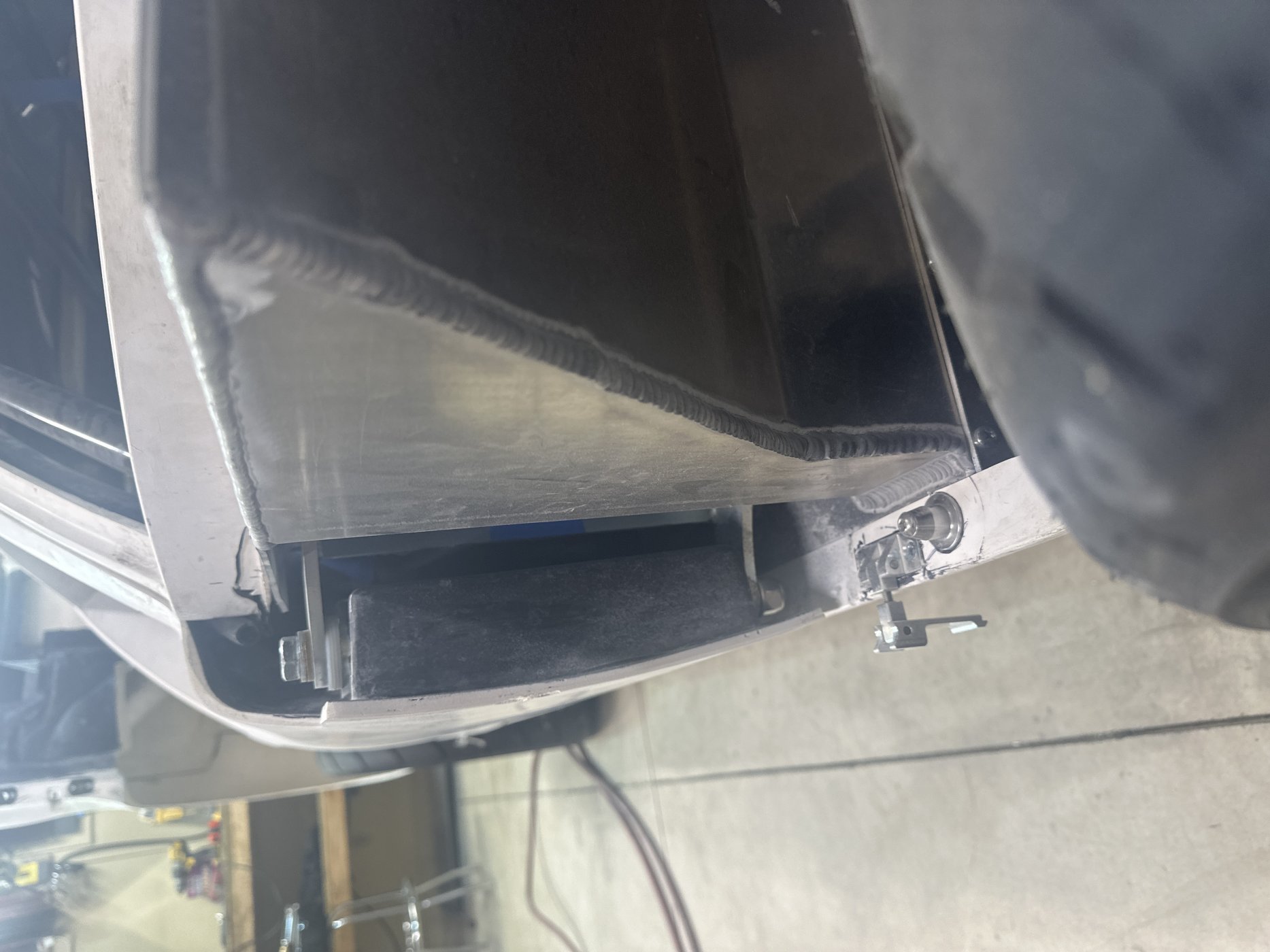

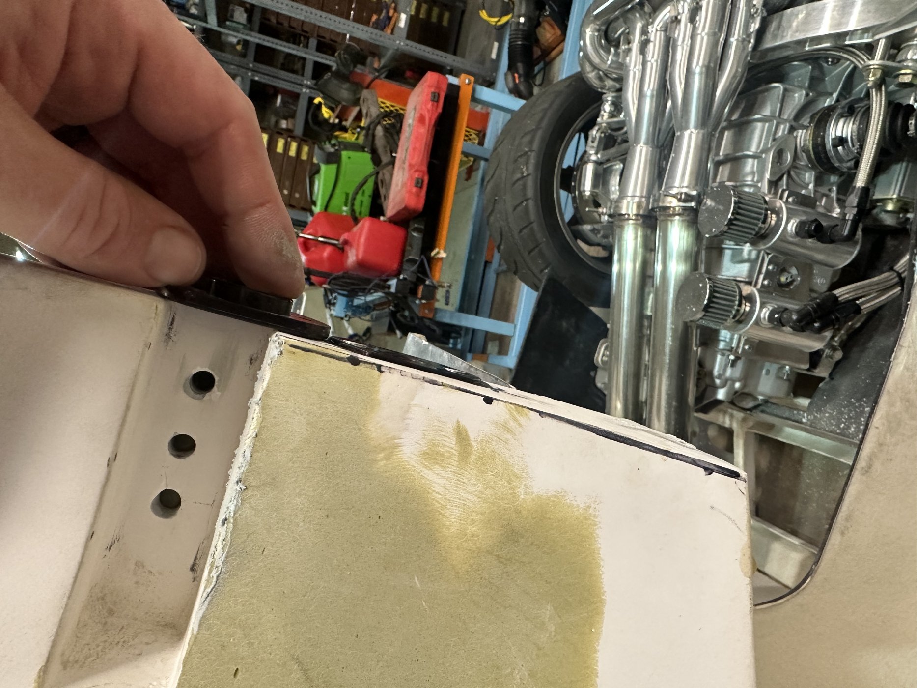

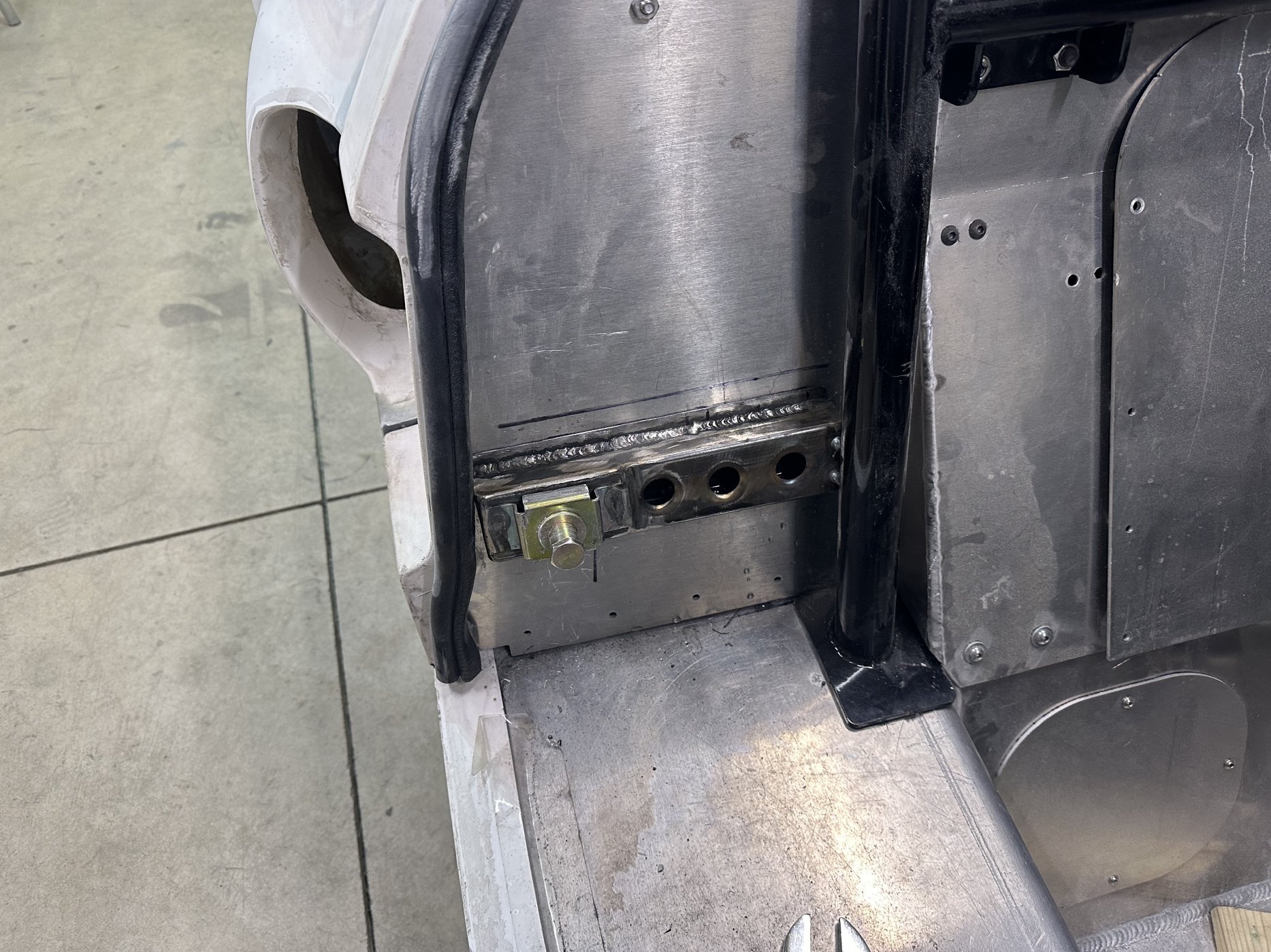

Sean Starkey

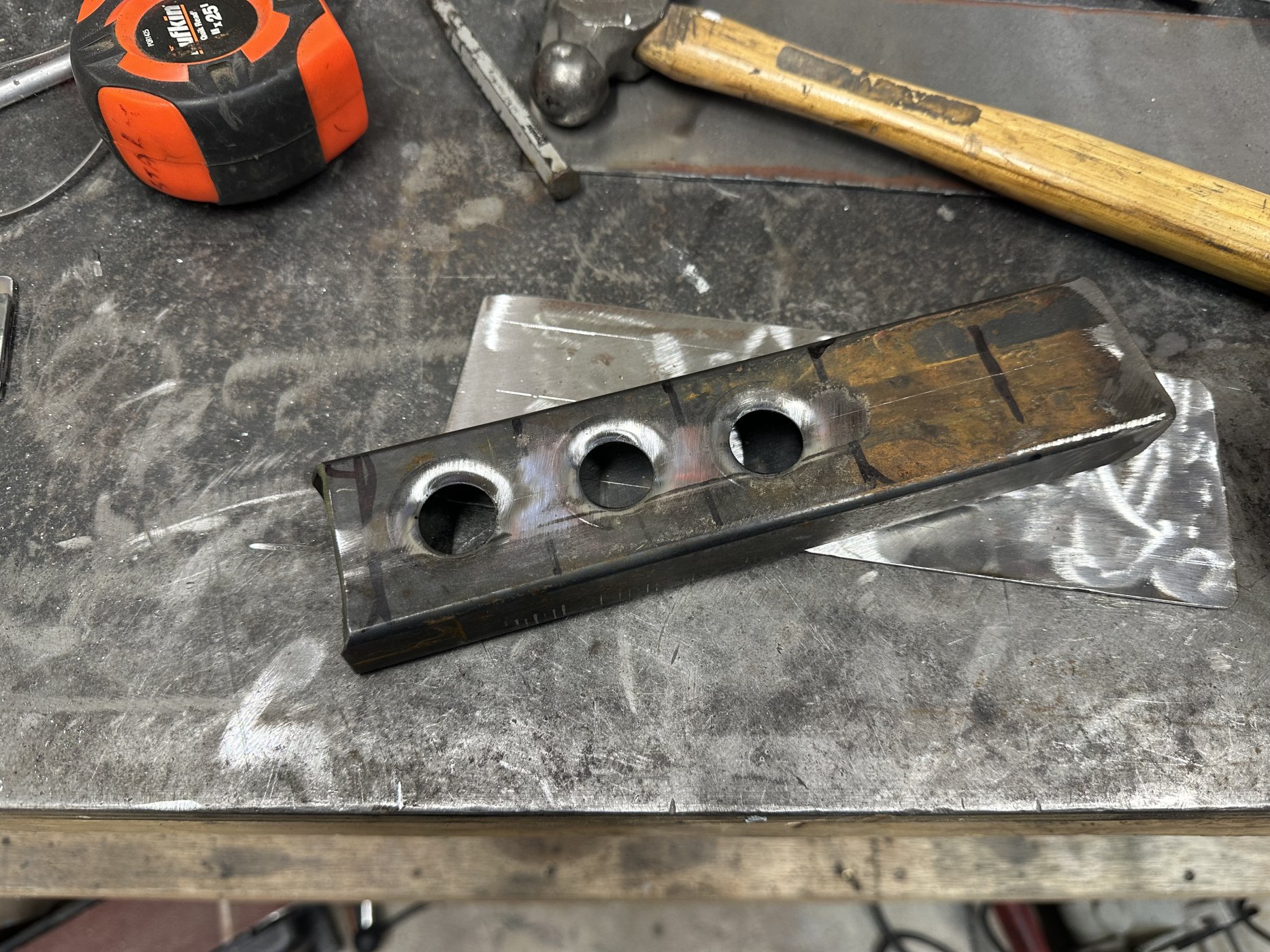

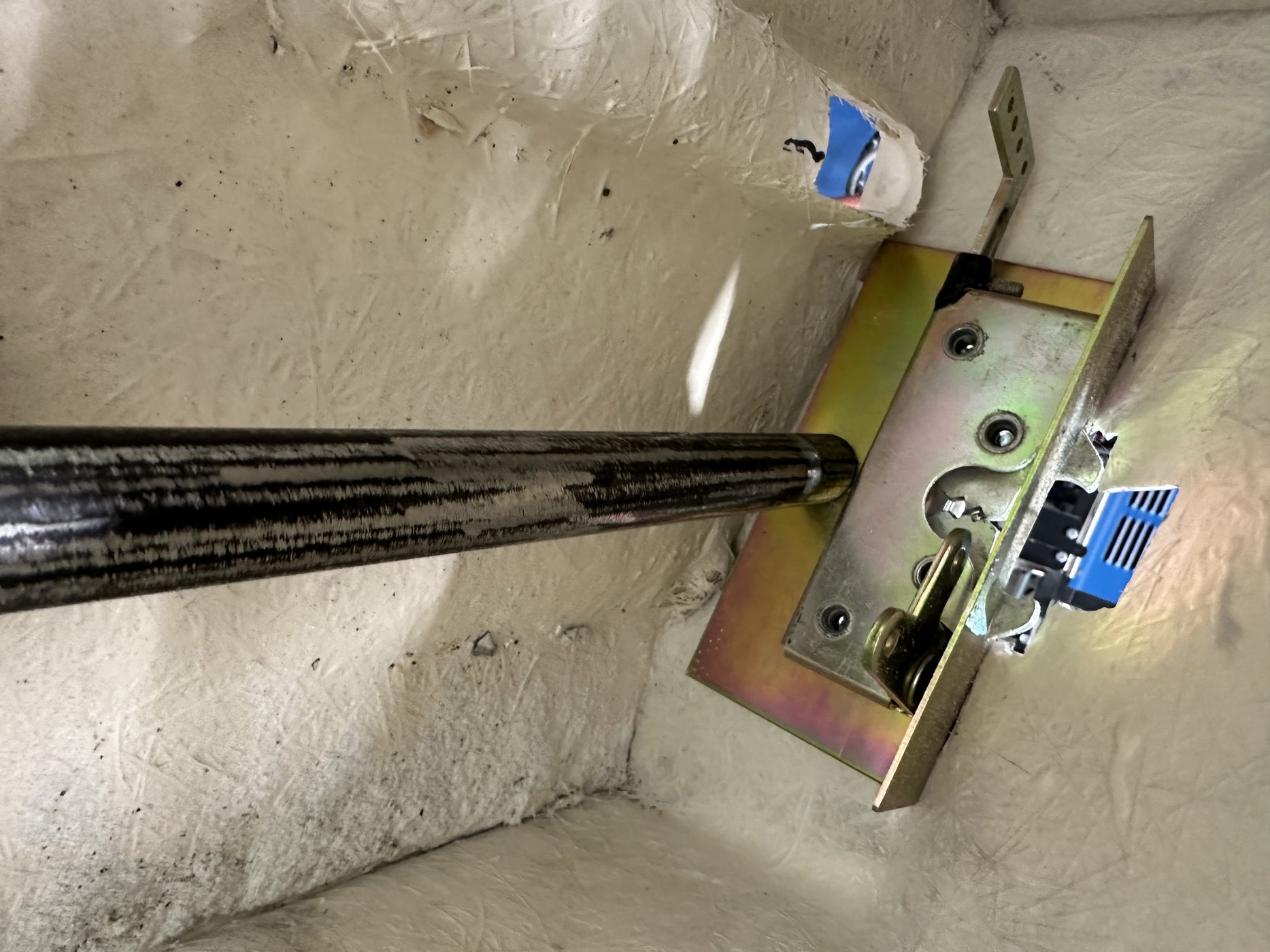

I’ve made the anti intrusion bars for the door. I tied it into the hinges and to the door latch assembly. I also glassed every thing to the door skin as well. Every thing is very solid on it now. I also fabricated a bar to hold the striker that is welded into the rear roll bar. I also plan to bolt it to the firewall as well. With these additions, the doors close more like a regular car door vs a fiberglass car door. I’m very happy how this turned out.

Sean Starkey

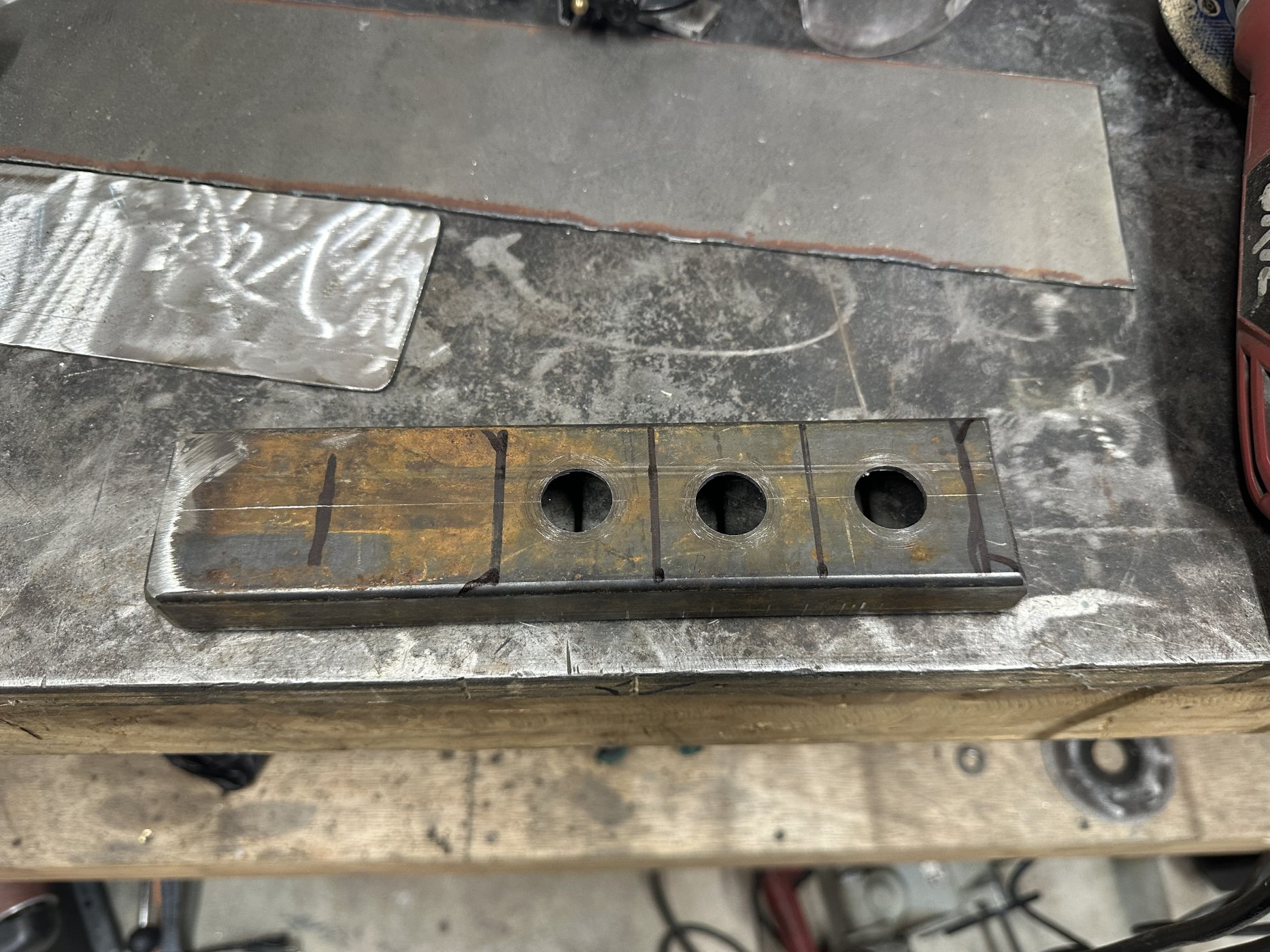

What sort of sorcery am I looking at here. Did you figure a way to weld steel to aluminum? Pic 2194
Hi Brian,
The weld is to a steel plate. I added the plate to give me a spot to attach some bolts to the firewall to help lock it all in place, I haven’t installed the bolts yet, as I need to move the fuel surge tank to drill the holes.
Sean

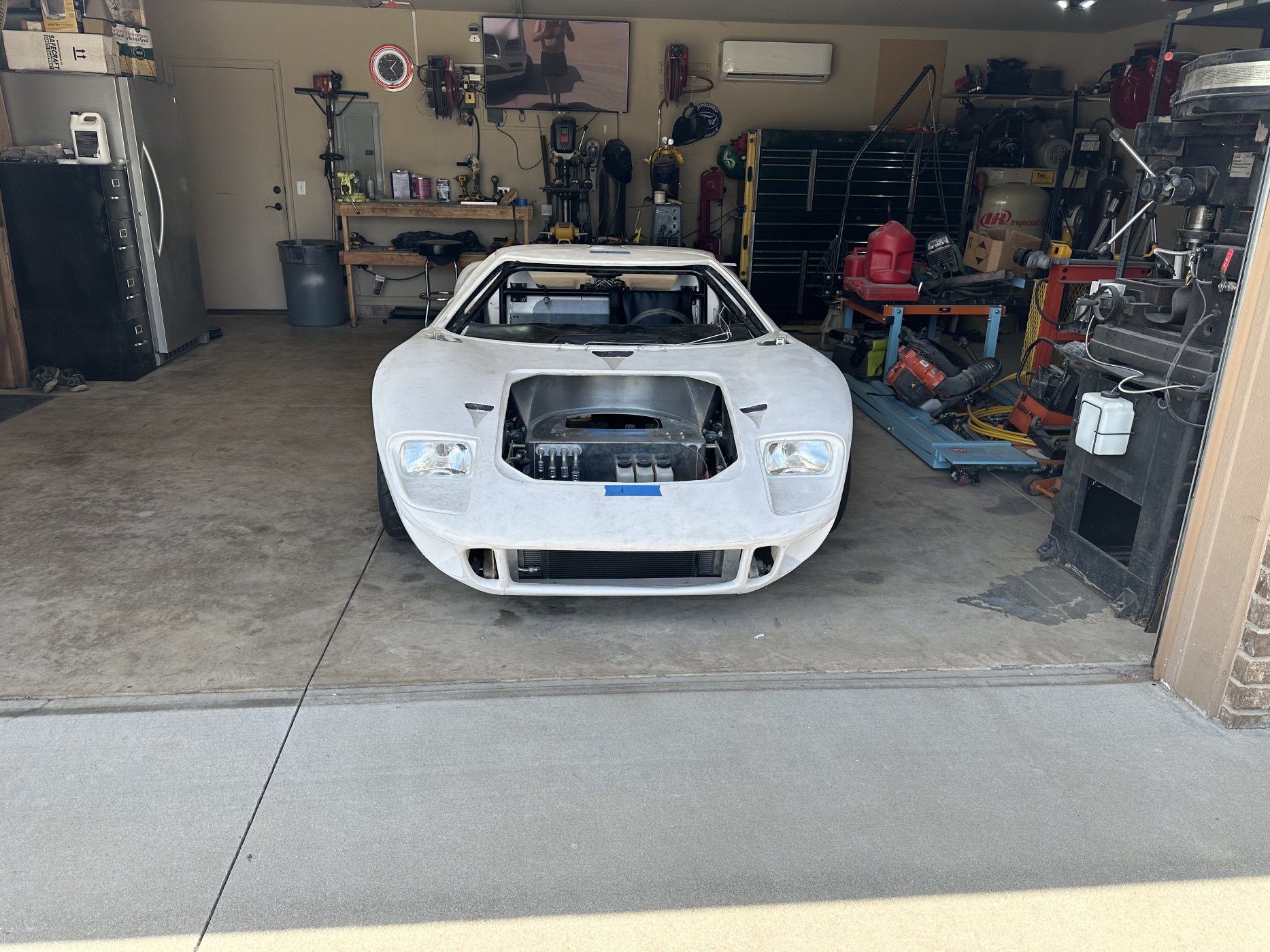

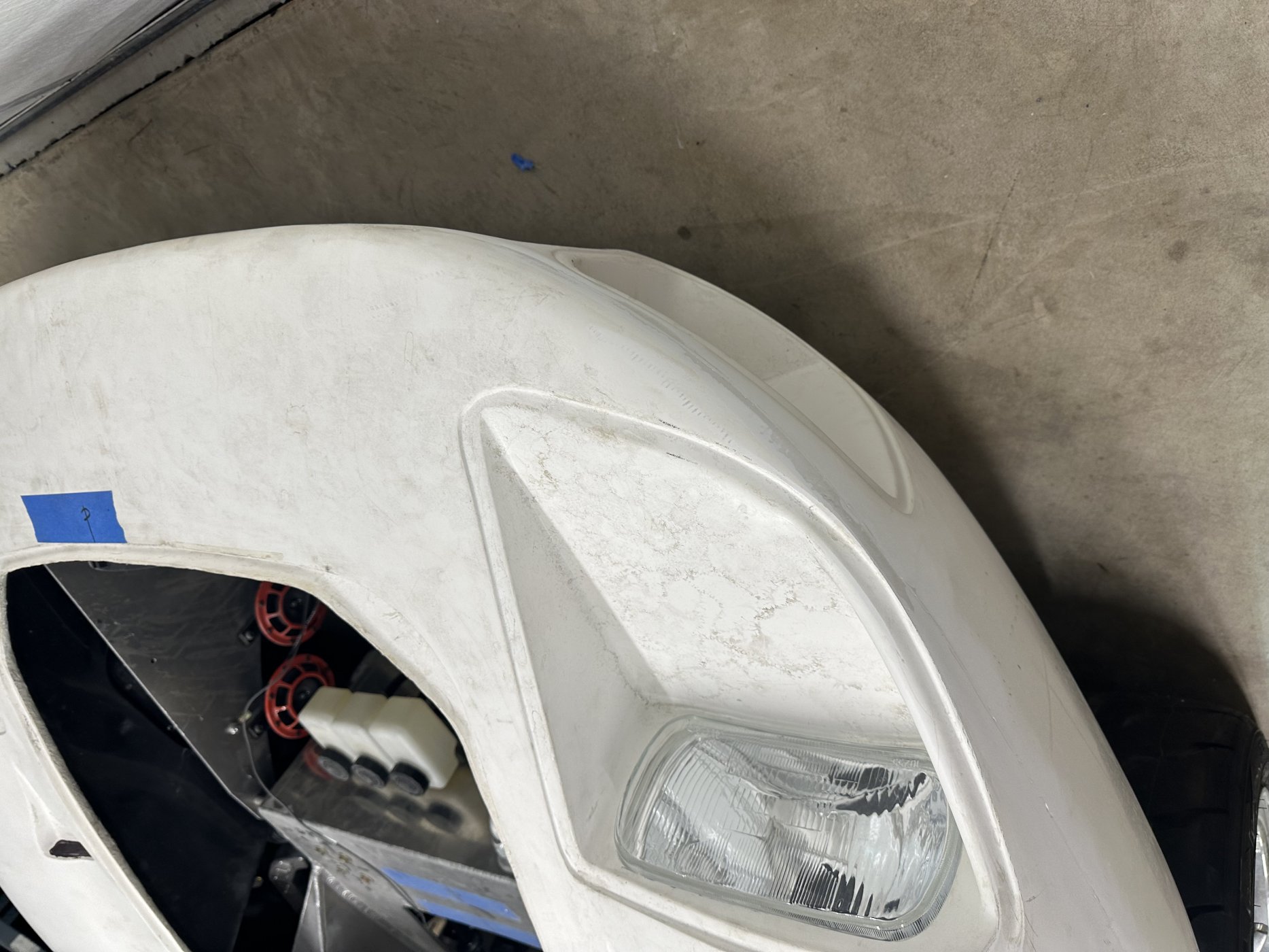

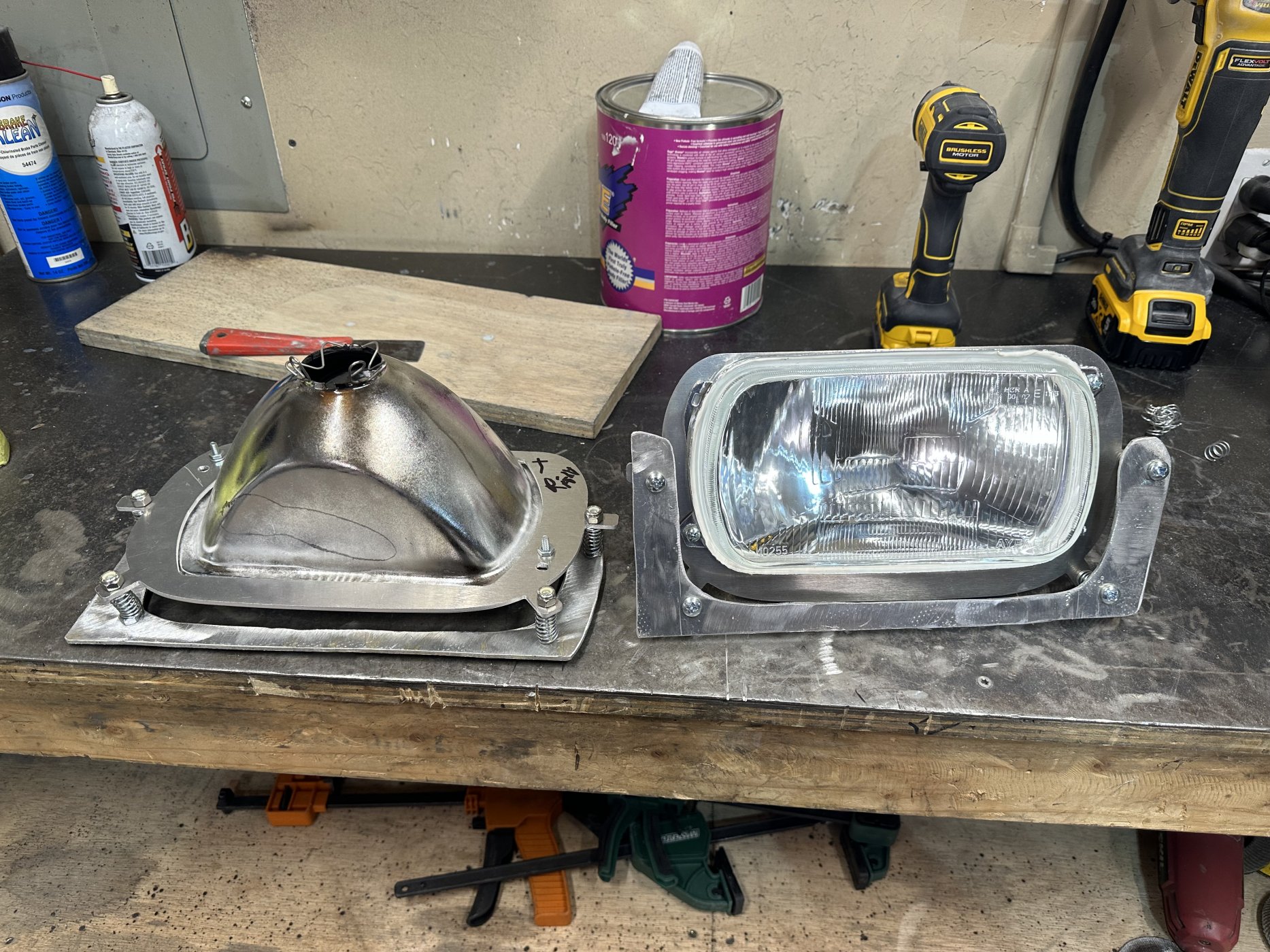

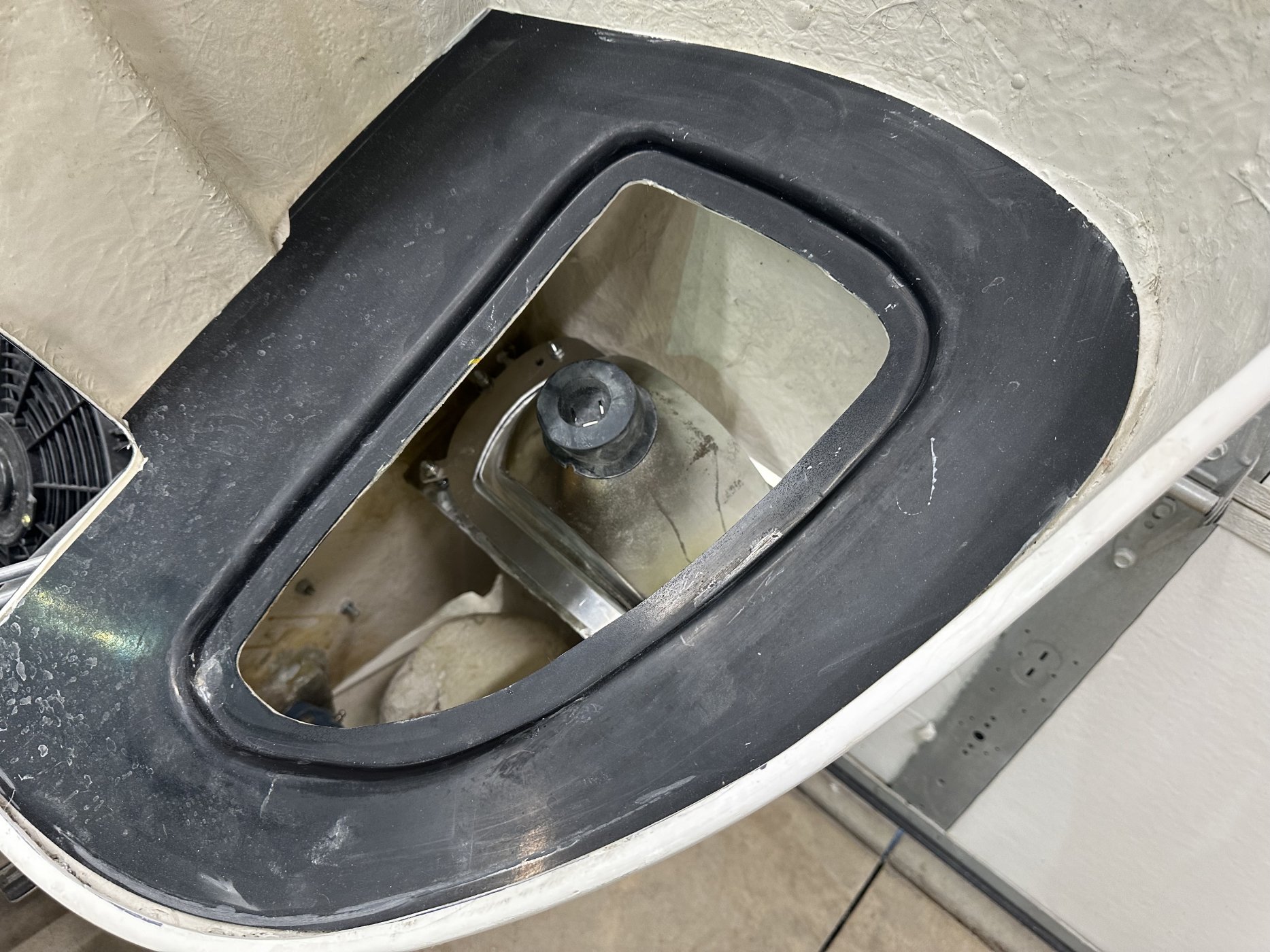

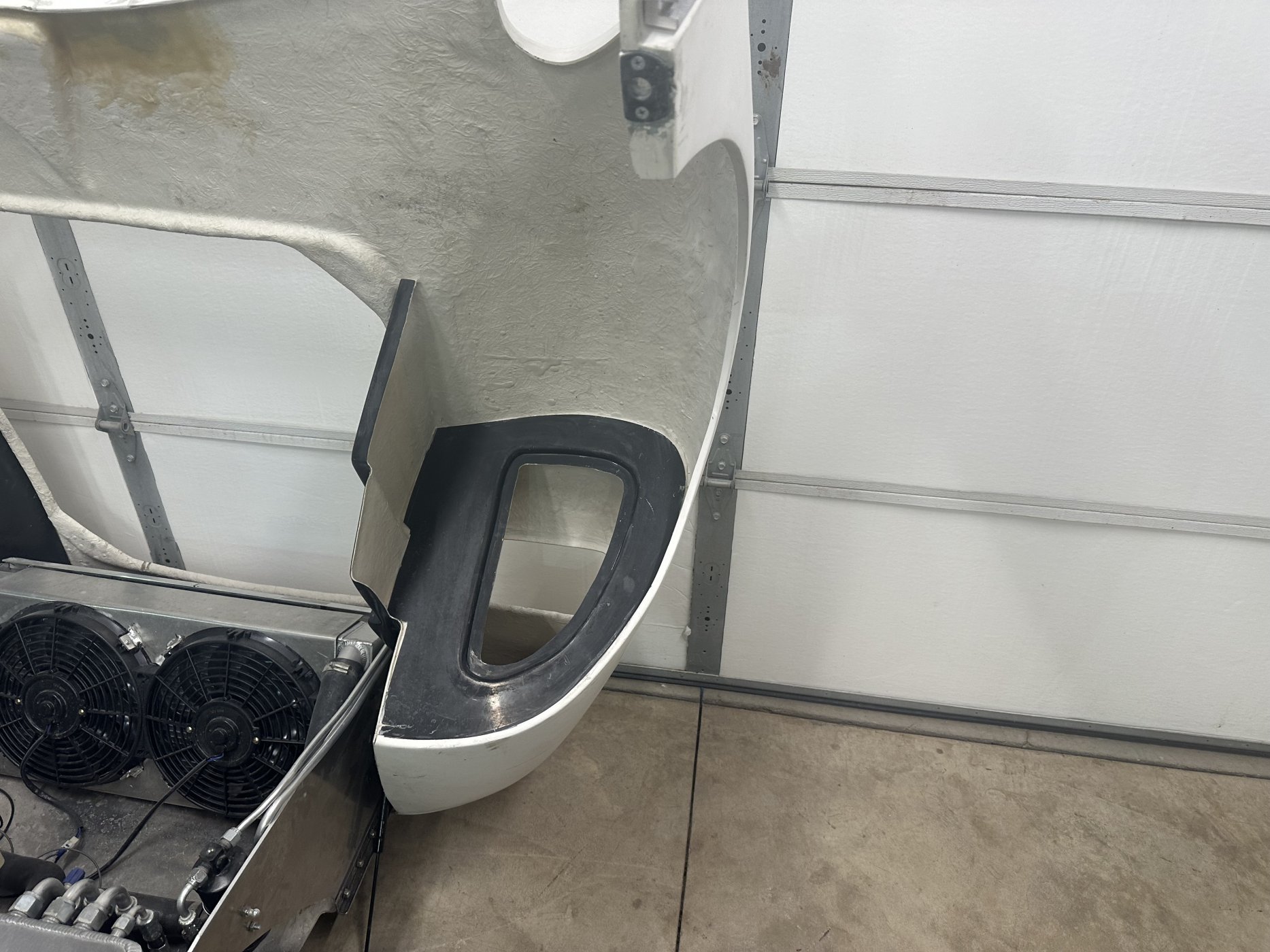

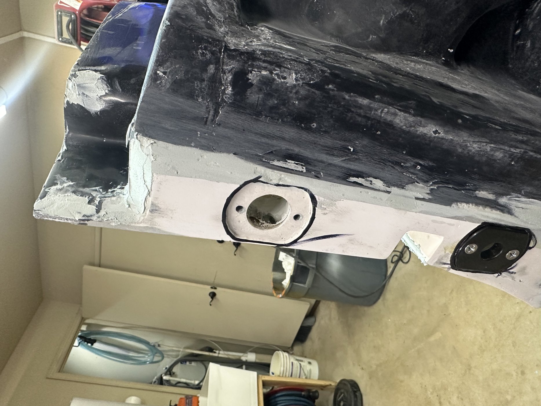

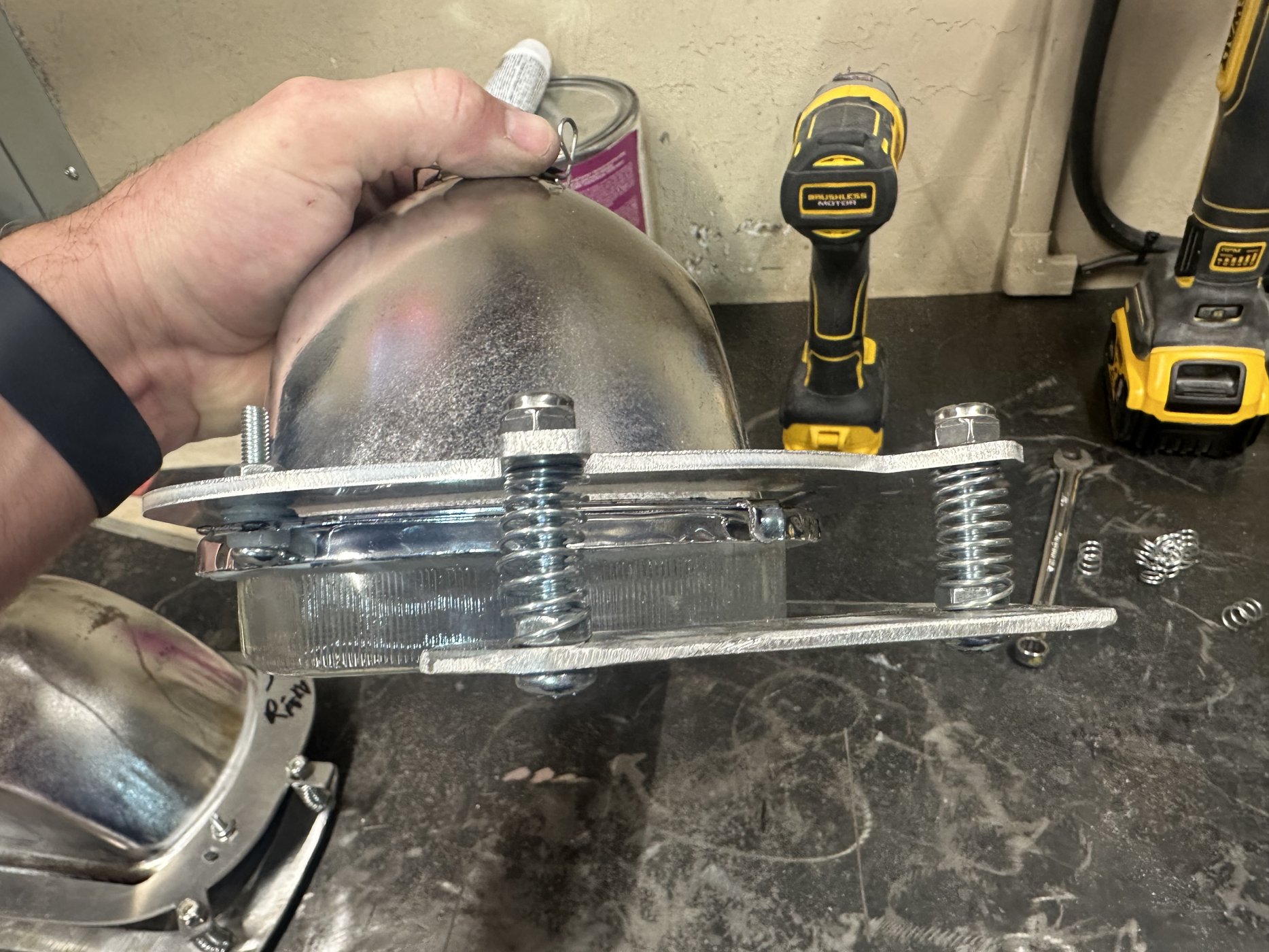

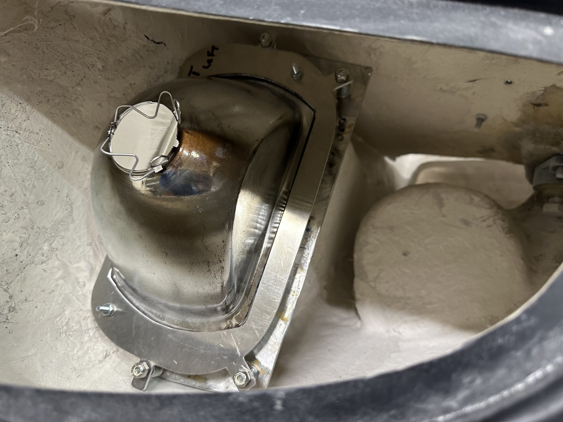

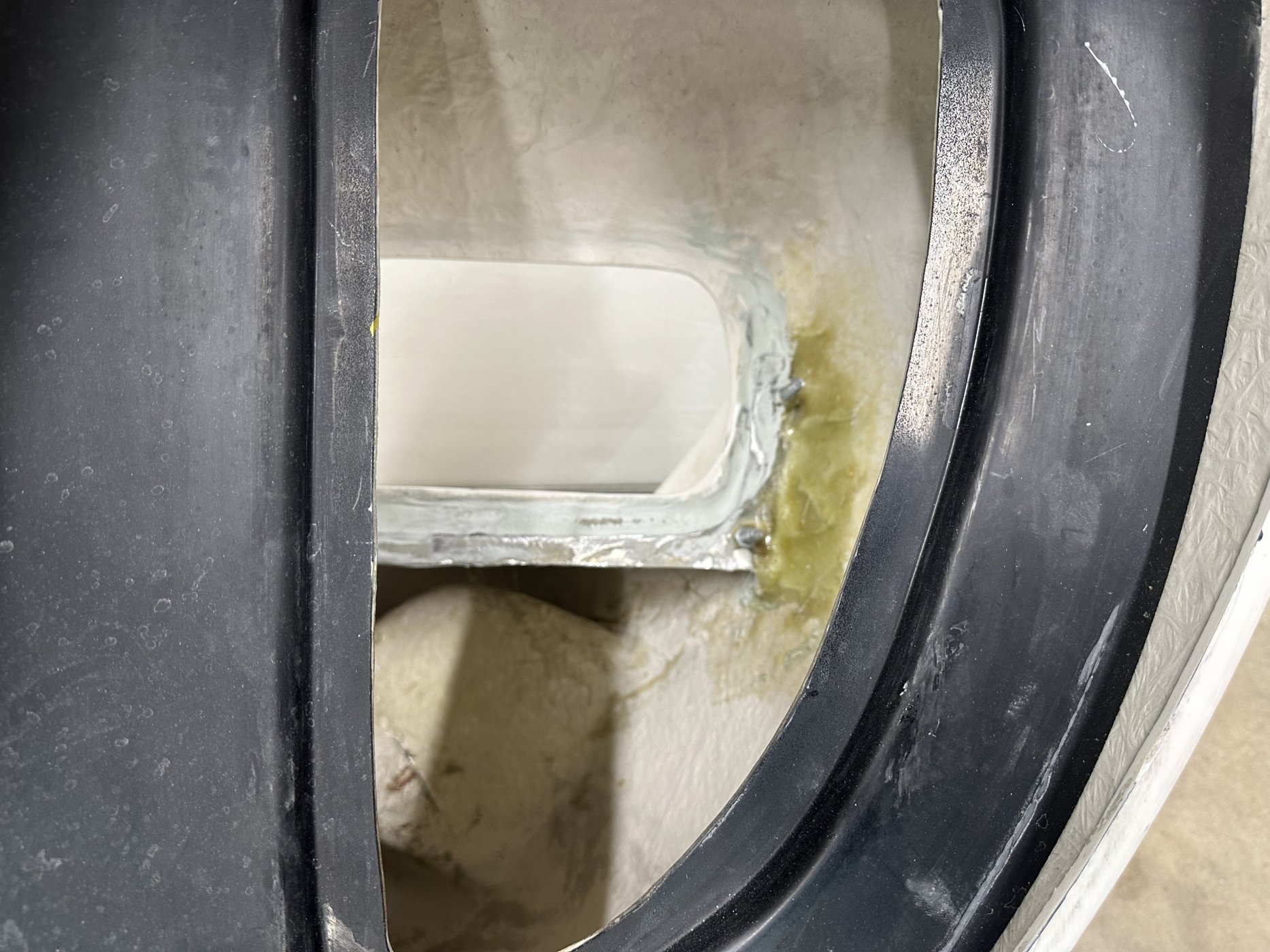

Sean Starkey

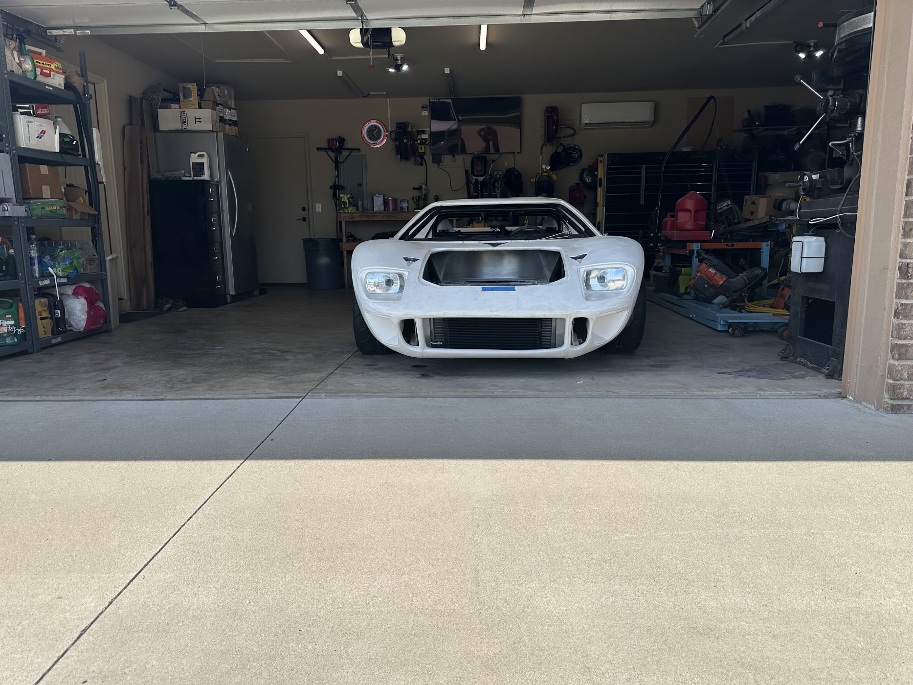

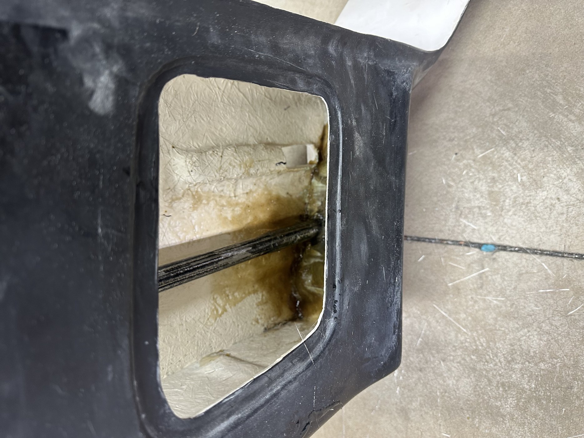

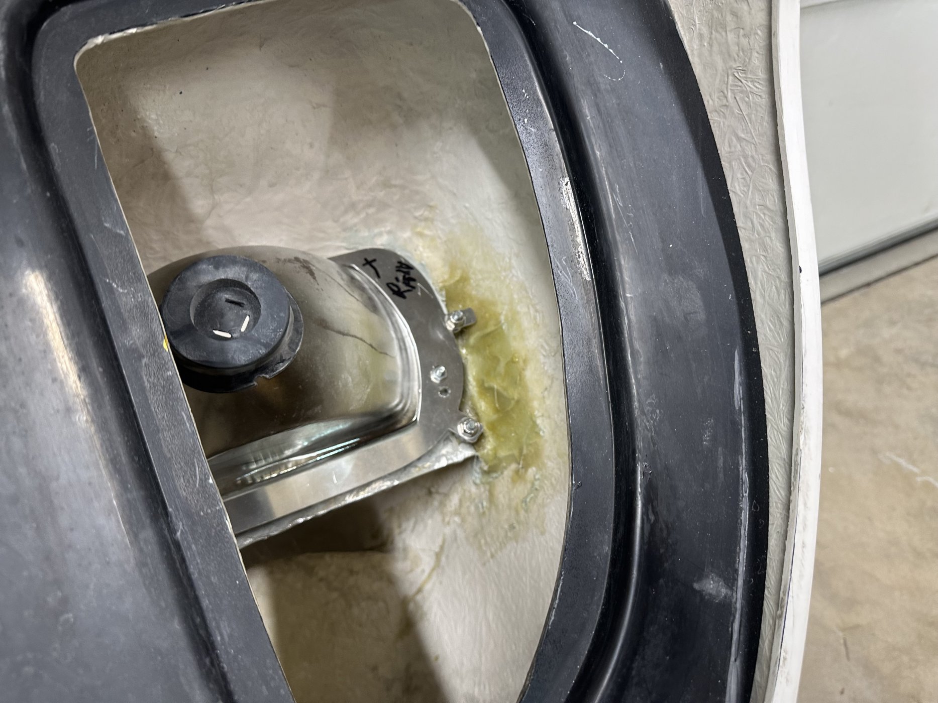

Fabricated the adjustable head light mounts and got them glassed in. Everything came out looking pretty good.

Lee Patterson
Curious what headlights you are using. They look directional meaning for left or right hand traffic but not both. Were they sourced for right hand drive (traffic) pattern?
Sean Starkey
Hi Lee.
I got the headlights supplied with the kit from RCR, but after googling the ayfar part number 10255 I found this below as the what they fit.
headlight to fit Renault 12 LHD models as well as Renault 10 , 15,16,17 models with rectangular headlights
Sean
Lee Patterson
I believe that implies cars that drive on the left hand side of the road (LHD), not where the steering wheel is located. People tend to confuse this. You should light them to ensure they are focused to the right side of your car. The Renault R12 headlight is typically a source for replacement headlights for GTs, but you have to be careful as to what traffic pattern they are designed for. I can't make out the E code on the light but that also determines what country the light is certified for.
