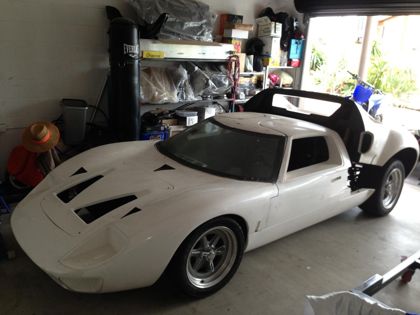

Just had to ask, what are you going to do with a DRB with 700 HP? is it a race car or road/race or just road. I would be looking to pay attention any time the throttle was moved, looking forward to seeing some more of the project.

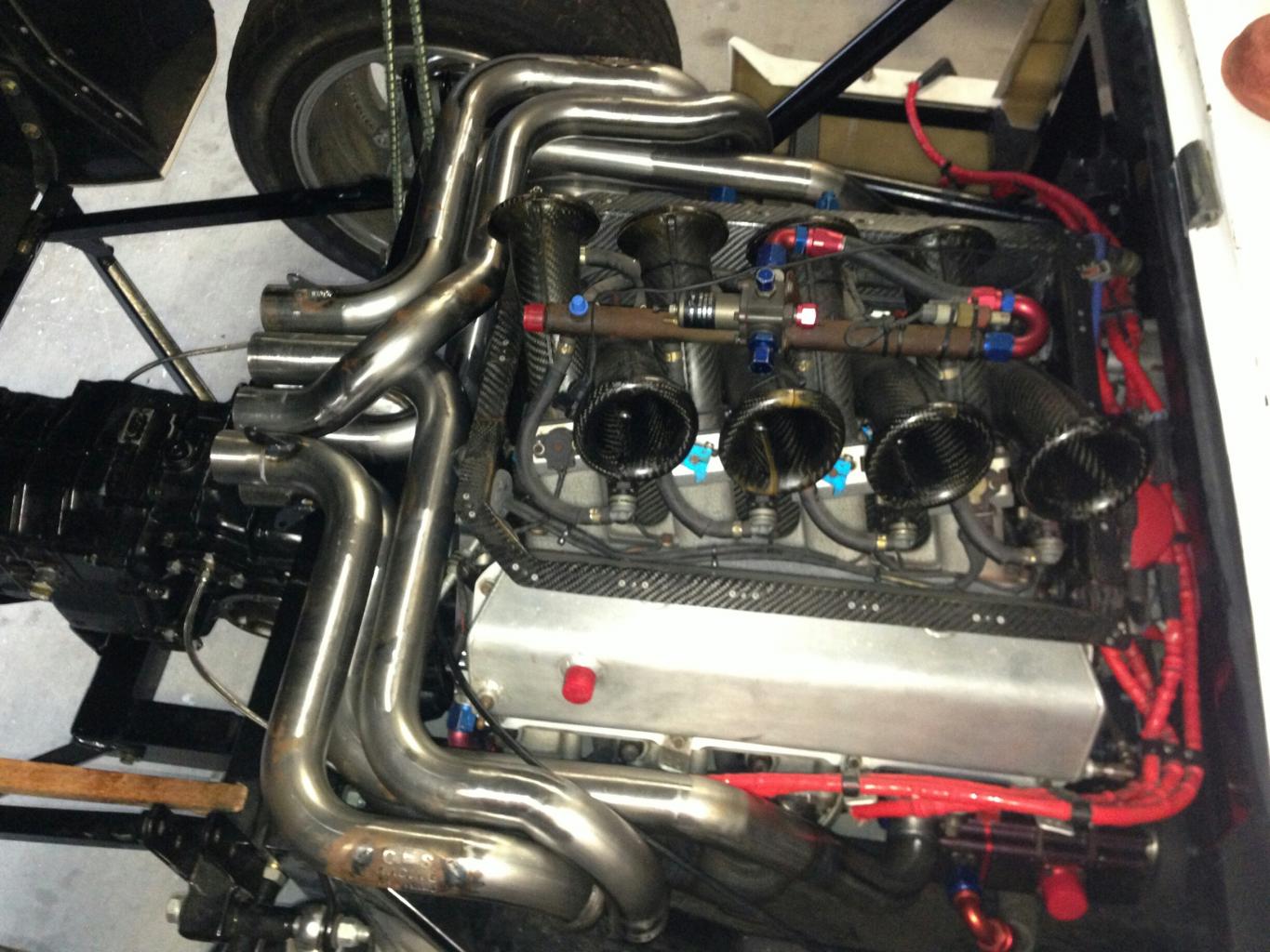

attached a few pics

As a matter of interest, if that is an ex Supercar lump, aren't the primaries a little small in diameter? I could be wrong but they look around 1 5/8ths when I would have thought 1 3/4 would be the order of the day..
The pipes are 1.3/4” stepped 1.7/8”

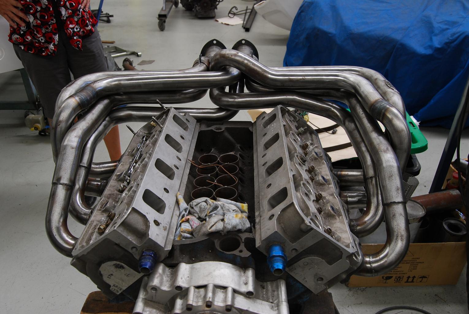

The pipes have been modified since and now 1.3/4” stepped 1.7/8”
