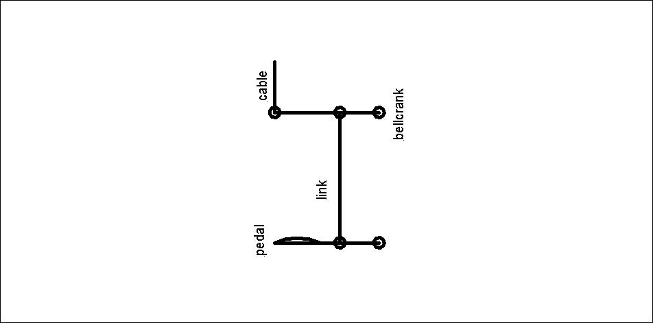

Fred I dont know what a GTD pedal set looks like but I fixed a similar
problem on another GT40.
I made a bellcrank & linked the pedal to the bellcrank via a rod.
The swivels & ball sockets i used 3/16 cable ends from morse cables.
The throttle cable then attached to the bellcrank.
By moving the cable or the link on the bellcrank changed the pedal ratio.
All the circles on the drawing are pivot points.
hope it gives you an idea.
jim

Fred, do I understand that you are happy with your throttle ratios, but only want to reposition the pedal so you can heel and toe? i.e. have both pedals about the same level?
If so, have you considered using a threaded rod (like in Olivier's drawing above) with Heim joints to connect the pedal to the floor?/bulkhead? mounted bellcrank? Simply screwing the joints in or out changes the position of the pedal, allowing you to adjust it any way you like without affecting throttle ratio. Not sure how your pedal linkage works, but if the pedal connects to a bellcrank that in turn pulls on the throttle cable, this is an easy way to go. It works great for me.
