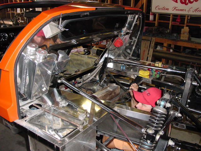

Mike,
I had an MSD billet distributor on my 302 that interfered with the chassis. The previous owner nothced out the cross member if you look closly at the picture. I can get a closer picture later if you'd like.
Tim Kay
As you can see it's getting lot's of 'brain' power. And with the pea brains around here were tapping every cubic inch /ubbthreads/images/graemlins/grin.gif
