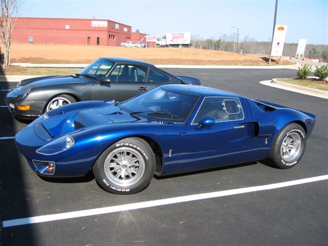

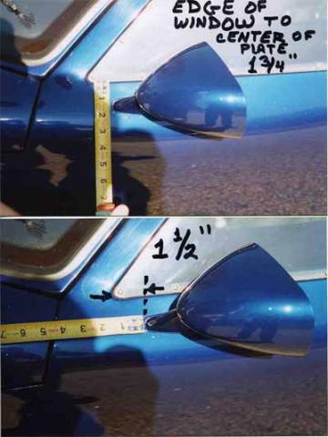

I found an old post that I made about the mirrors I put on my "BLUE BEAUTY".
http://www.gt40s.com/forum/gt40-tech-engines-induction-exhaust/13692-box-full-nothing.html
I didn't mention that I used a piece of inner tube for the gasket between the door and the mirror. I cut it to the edge of the mirror with an X-acto knife without going all the way through to the paint except one small point which allowed me to pull the inner tube off which followed the cut all around the mirror. After tightening the mirrors to the doors with a steel bar about 1/16" thick by 1" wide & about 6" long on the inside of the door they never vibrated at all while driving down the road.
I also used a hand held drill with a 6" disk sander to grind down the plate that goes against the doors. I ground about 1/16" off the high side of that plate making it flat to the bottom side without grinding off the bottom side. If that makes any sense?? This angles the mirrors up so that they are parrel to the ground and won't look like they are drooping.
This turned out to be a very easy thing to do even for a guy that has trouble turning a screw driver.
Hope this helps someone that might want to use these mirrors.
JOSEPH
