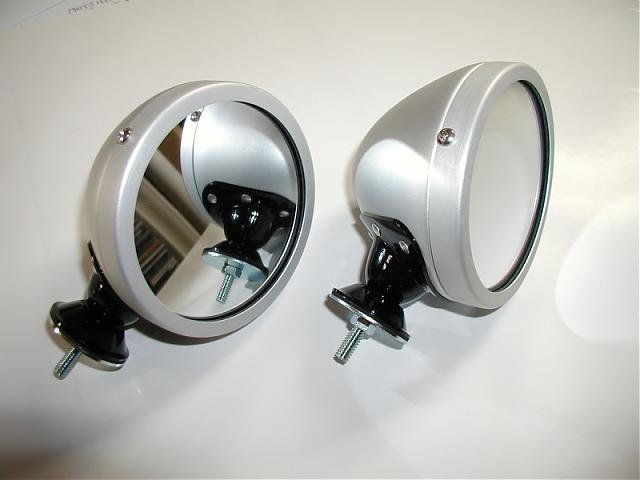

I have a pair of Ray Dots, not original but have seen them on a few GT's.
Chris

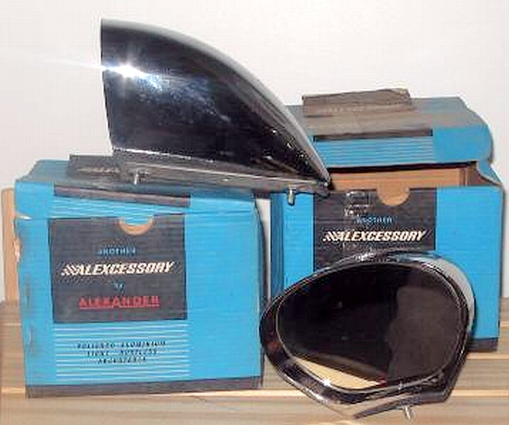

Plastic versions were also made in the 60's by Alexander

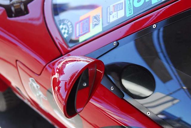

An idea I was really taken with (and will blatantly plagiarize) was this mounting of Vitaloni Californian mirrors on GT40P 1083... attached to brackets that use the side window mounting holes.

i like this setup.
im not sure if i wanted to drill holes into the fenders of my car to mount mirrors. this setup allows you to remove them if you change ur mind abt location.
are the mounts custom made, or does someone sell them with mirrors?

Julian, That looks like a very neat setup indeed. Maybe I'll go that route instead.
Funny enough, I clearly liked the idea when I saw it at Laguna Seca last year. You'd have thought I'd remember... duh.

The California mirror may not have enough adjustablility out of the box to allow you to see properly. However, it is a very simple job to remove the mirror from the housing (two screws secure it from the underside). Then it's very easy to enlarge the opening that the mirror boss passes through, which will afford much more freedom of movement. It may be an iterative process (remove from car, dismantle, remove material, assemble, install on car, :furious:, remove from car, dismantle, remove material, assemble, install on car, :furious: again...) but once you've got it right, you'll be very happy with them.

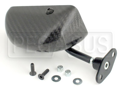

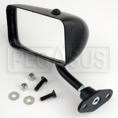

I saw these mirors on the Pegasus Motorsports website. I wonder if I made the "boomerang" window piece and added these mirrors from Pegasus, if that would work? They look like they have LOTS of adjustability.

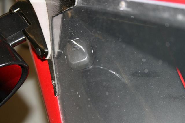

I opted to just mill a wedge for my California mirrors. Here is a picture of the wedge and the support bracket that screws into the original holes for the window. The picture was not intended to be for the mirror but the XM radio ant, but you will get a general idea of what I did. I have meant to paint them but I haven't taken them off to do so yet.

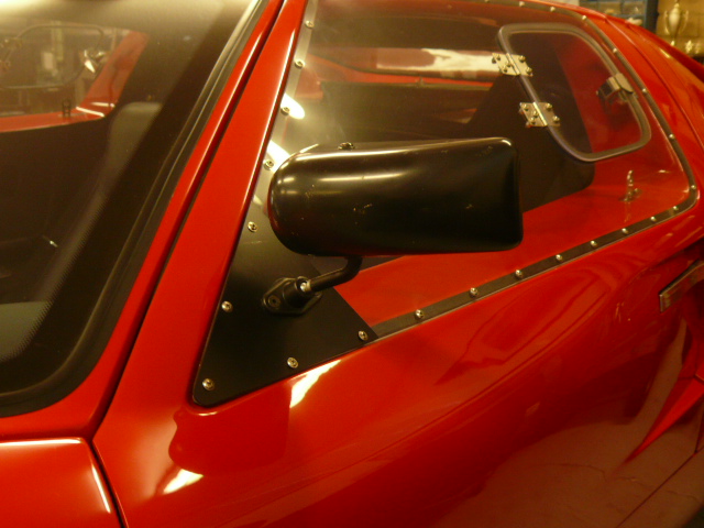

Those are the ones I used on my CAV......they are adjustable and work well. I made the piece they bolt onto myself....

Pat, which mirror (convex or flat) did you use for the driver side and passenger side? Does the backside of the mirror bolts touch the window?

You guys comfortable with 5 (Pat) or 3 (Jack) little (8-32?) screws holding your mirrors on? I like the idea, but at speed, there are some pretty serious aerodynamic loads transferred from the mirror to the door frame.
Pat. That is exactly what I planned for my car. I have the mirrors in the garage!
What did you make the plate from?

1. I used flat mirrors on both sides. I drilled 3 holes in the side windows in order to tighten and mount the mirrors.

I used some .060 aluminum.
Mark -
These are the same mirrors that are used on racecars of most types and are probably mounted as securely as on any racecar.

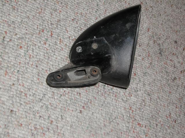

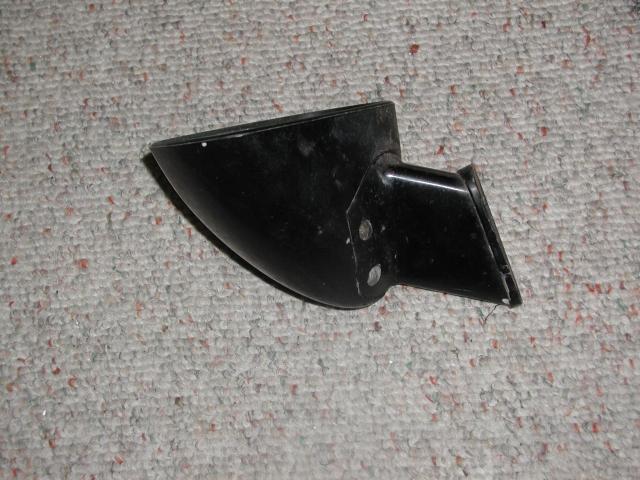

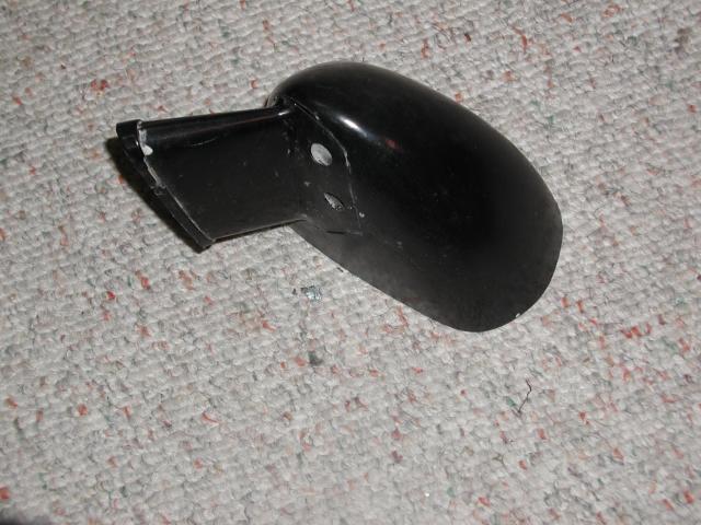

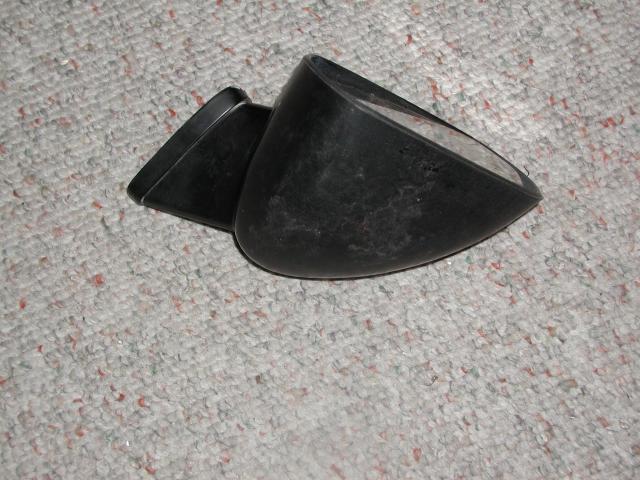

Early on on my build I was searching for a set of mirrors. I didn't want side mirrors, but the sanctioning bodies at most of the tracks won't let you run without them. They say that the back up cameras aren't enough. I wanted to use a stereo with popup 7" screen and one of the better cameras like Chase Cam or the like(which I will anyway). They still say I have to have mirrors. So I found these on an old 280 Z I believe(long time ago/dead brain cells). What I liked about them were two things. One is the base. It fits the shape of the side of the car very well and with some rubber gasket material will work with little alteration. This would work well with the removable options talked about on this thread. The second thing I like is the important one fo me. These were originally electric mirrors. After pulling them from a junker(had 3 to choose from) I checked them out to see if they would work. You guessed it, they didn't. Several of the functions were shorted out. So I pulled the wiring. What I noticed was that the mirrors are adjustable manually to four positions horizontally and four vertically. This makes positioning a little easier without having to trim or add pieces to get the correct angle. They have the two screw mounting and are both flat mirrors. Something to consider!!
