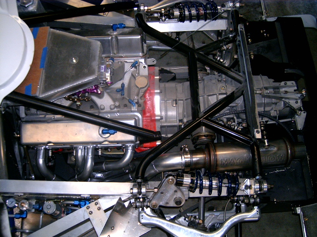

Early on I was playing with a side exit system in which I used a header that would be pretty close to a stock manifold in layout. If you run the exhaust pipe from the manifold exit, straight outboard through the chassis , turn it forward 90 degrees as soon as you clear the chassis tubing, then make a 180 and come back towards the rear you will have quite a bit of length to put a fairly large muffler in the aft side pod in front the tire. The exit can be to the rear or through another 90 degrees out the side. If you went out the back from there another smaller muffler could be added up along side the shock.
I didn't do it this way because of all the work and heat in the side pod but it can be done with a pretty big flowmaster. I think I mocked up one of the super 50's (5"X10"X17") in cardboard and got it to fit. make some cardboard pieces and see what you come up with.
There is enough room to make a quite system, just don't get stuck on straight through.
Here's a pretty standard out the back setup that I just finished (one side)
