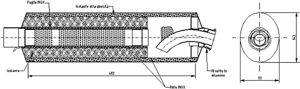

I'm not an engineer, but would something like is used on motorcycle exhaust work on our cars?
It is a db-killer you put in your end pipe and one screw to hold it in place.
So it's loud or quite when you want it to be.
It works on a / my motorcycle, so why not a car?

Last week I went to my motorcycle dealer/tuner and asked him about the thought of a DB-killer for the GT40.
He actually also suggested a removable hemisphere. He offered me to produce one as a prototype. If it works, he is interested in producing more if there is enough interest in them.
So, just lets wait and see if it works.
