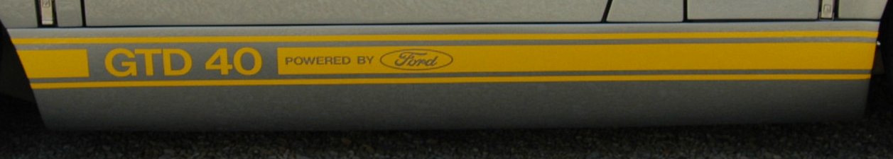

Simon,
This is the standard decal that the GTD factory supplied.
Coincidentally, when I was researching my body colour yesterday I spoke to the shop that used to paint cars for GTD. They painted the main body colour, the stripe(s) down the centre and the nose colour, but GTD did the sills using a silk-screened decal.
Now is there anyone in the present GTD world in UK who does silk screen printing? /ubbthreads/images/graemlins/smirk.gif

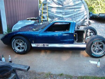

I went to a local Sign Shop and had the stripes made from pictures out of one of my old Ford Muscle Car Magazines. The shop made the stripes from Vinyl and he had a huge color selection.
Vic /ubbthreads/images/graemlins/smile.gif

Vic,
Cool, Thanks!
One guy I talked to asked me if I wanted vinyl or static cling. I really don't know what the difference is, but since you chose vinyl I am assuming that is the way to go.
Lynn
I would not use static cling. They are great for the gumballs where you want them on and off, but since I assume the sill stripes are to be permanent, they would not be my choice.
Brian Magee
Lynn
Static cling or self cling adheres by the removal of air between the vinyl and the material it is applied to, normally glass. It is not suitable for sill stripes.
Self adhesive vinyl comes in various grades and different adhesives. You need a cast vinyl with a permanent adhesive.
Brian.
I have static cling on mine. John Shneider (SPEAK UP John), made several differnt colors for me to try out and see which color looked best. It is a good way to go before actually painting the sills.
I was cheap and ended up leaving the static cling color I liked on the sill.
Actualy, I have driven it in rain once, no problem.
But again, that was california rain, "ENGLISH" rain I am sure is different /ubbthreads/images/graemlins/smirk.gif Good point though!
