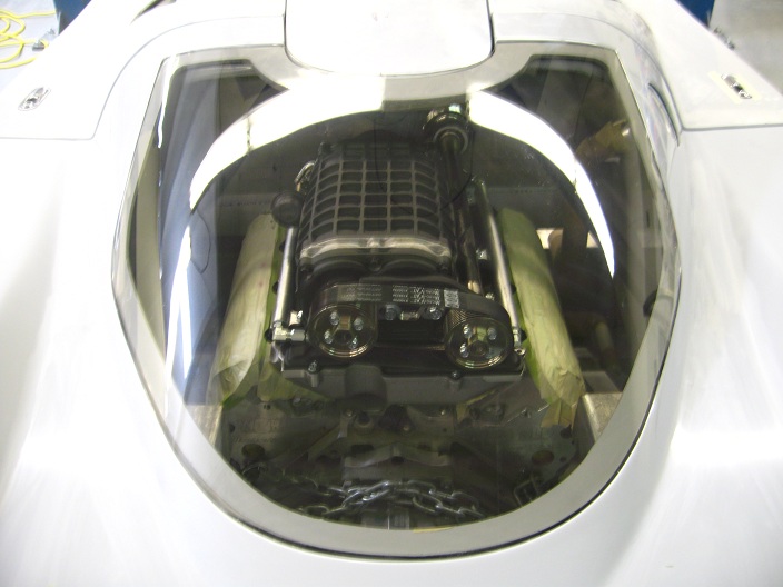

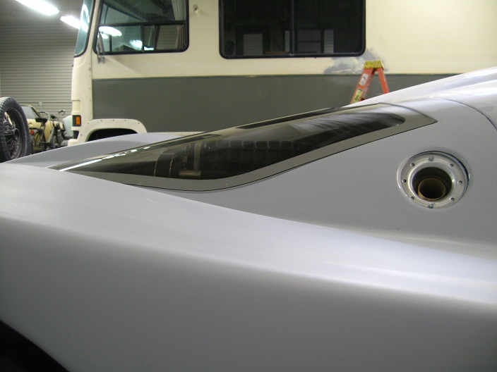

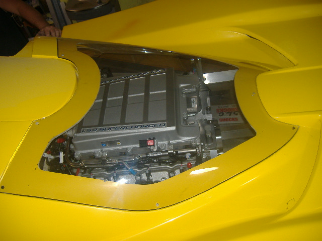

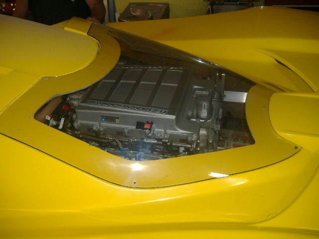

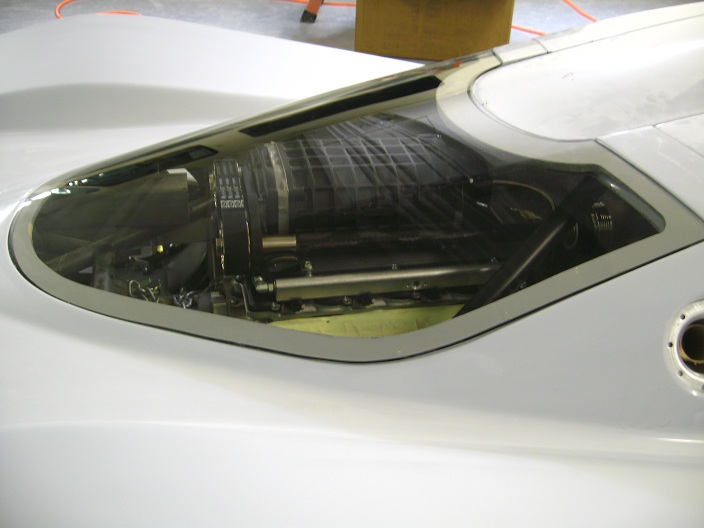

Well I have not had much to contribute lately....so here is a little eye candy to wake up the thread. Only a mock-up at this point that JUST barely fits under glass.
Fun.

That answers a question I'm sure I would be asking a few years from now. Is that an LS-based engine in basically a stock location? In other words, if I go LS3, can I drop in a supercharger a few yrs down the road without having to cut and reweld the entire engine bay?
One of my goals in this was to be able to change the boost without changing pulleys on the front of the engine (for obvious reasons). Therefore this is a custom pars bin set-up that has a forward facing intake and exposed interchangeable rear pulleys that will allow boost adjustments. This configuration does not relate well to most of the SLC builds out there as most are rear facing intake tracts. I'd say you would be able to install a rear intake SC in a stock bodied SLC, but it will take a little skill and patence to communicate to a SC manufacturer in order to get the tract correct for the space limitations behind the SC. The street tail would be the best way to go for the extra room it provides.
No repositioning of the engine would be needed and with some parts bin engineering a rear intake SC should fit fine under a stock height rear glass. (My back glass is actually about 1.5 inches higher in the rear than stock).
You're not kidding about it being a tight fit under the glass. Looks great through.
How many litres is the SC? What's your boost/HP target that you're shooting for?

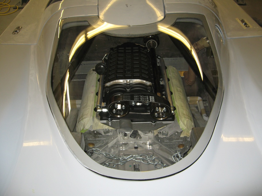

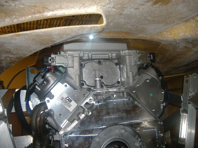

Here is an LS9 in the stock location...requires the RCR intake tube and a custom cal. that we have tuned on the dyno..

The engine was built with forced induction in mind, the builder says it should make about 900 at 15 lbs of boost. I don't know, and I don't really care if it can produce that much power as it will only see that tune on track days. The rest of the time it will be at a low boost setting for street use.
Fran, I like the look of the LS9 under glass, fits nice. Do you have a shot of the intake tract? Based on the location of the TB on the engine it probably took some effort to get the intake and filter packaged.
No... not too bad really..we made a custom throttle body mount and an intake tube ...similar in style to the LS3 unit...but pointing in a different direction abviously...we made a couple more HP on the dyno during the tuning....BUT lots more to come with the pulley/cal. swap...should we feel a little left behind by the big gun brigade here on the forum...

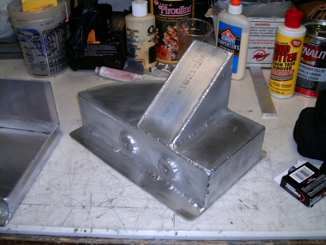

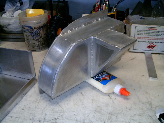

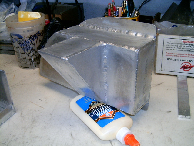

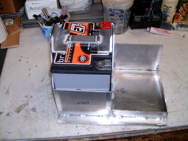

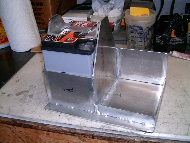

:) Howard's doing a little surrogate fab work for me
We are doing a little horse trading between us. In the pictures you see Howard's rendition in aluminum (al-oo-minIUM for you old english speakers) of cardboard mock ups I made. First is the battery and hydraulic pump mount platform. This will go in the forward passenger foot box area and be hidden behind a foot rest wall. The second is the surge tank for the coolant system. This tank will go on the upper driver side firewall.
Howard -
I like your solution for the battery hold down bracket, that will work well in the space available.
