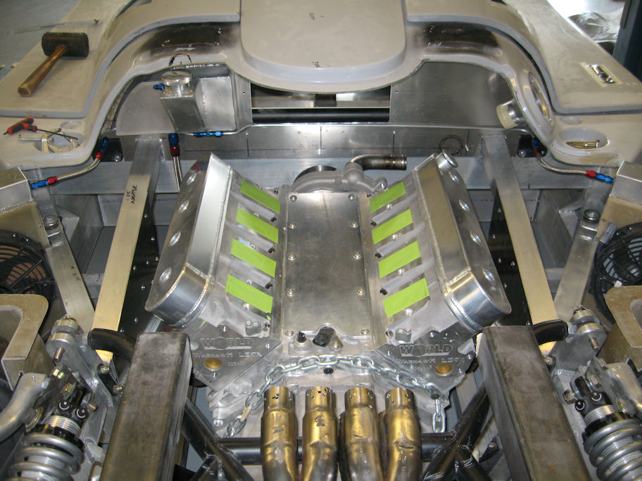

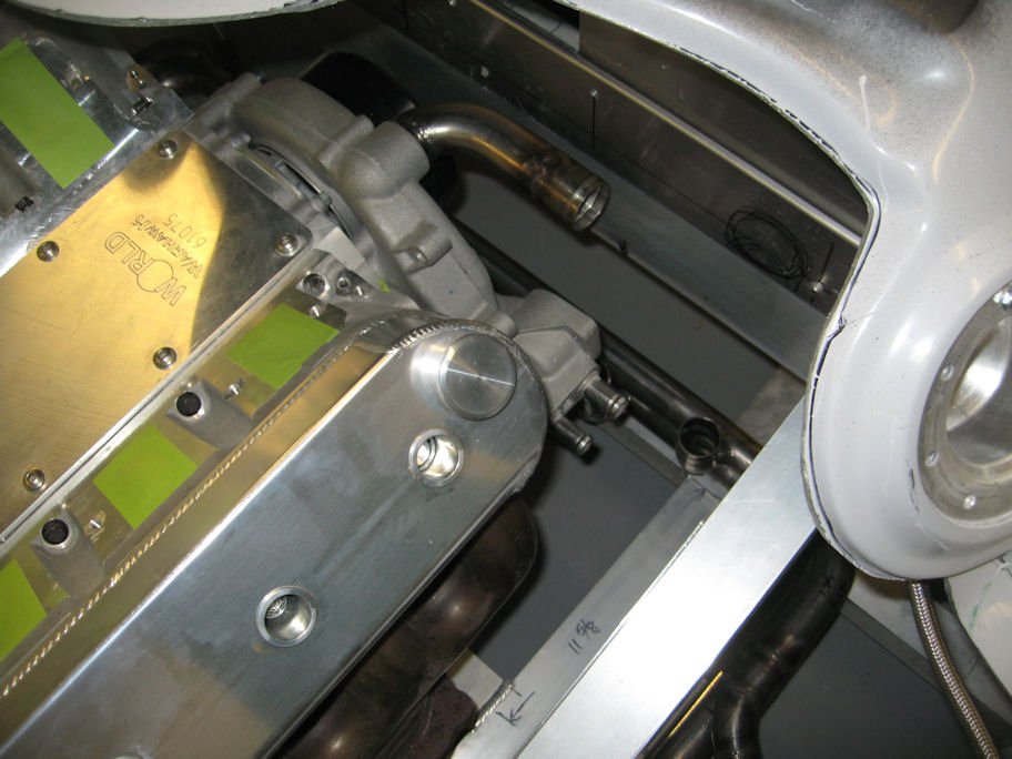

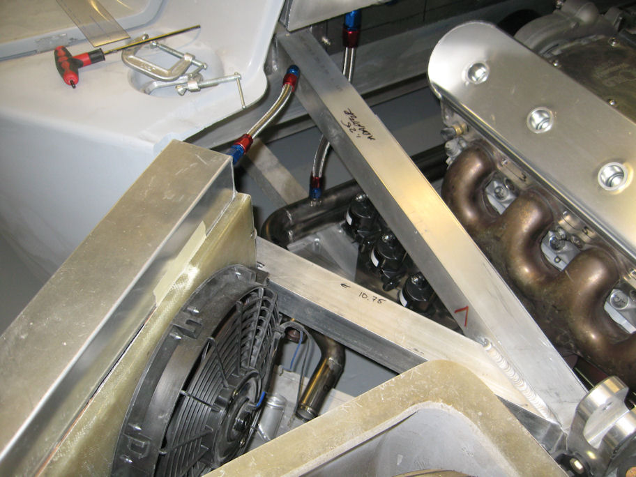

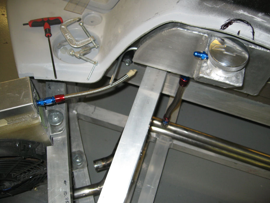

Got Howard's latest handywork installed. In these shots you can also see the panels that insulate the radiators from some of the header heat, the panels double as the remote coil mount surface. May not be much to some of you guys, but this is my first attempt at making hard and soft lines. A new skill set aquired.

Doc - The panels are aluminum, to be covered with some heat reflecting material later. The reflections must be the cause of the color effect.

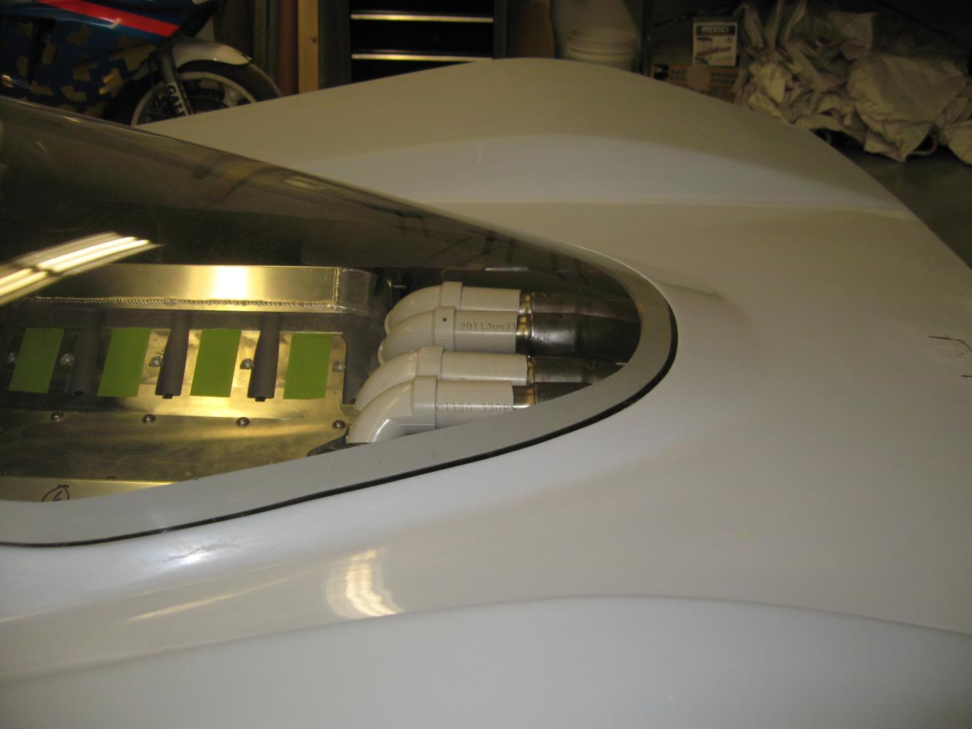

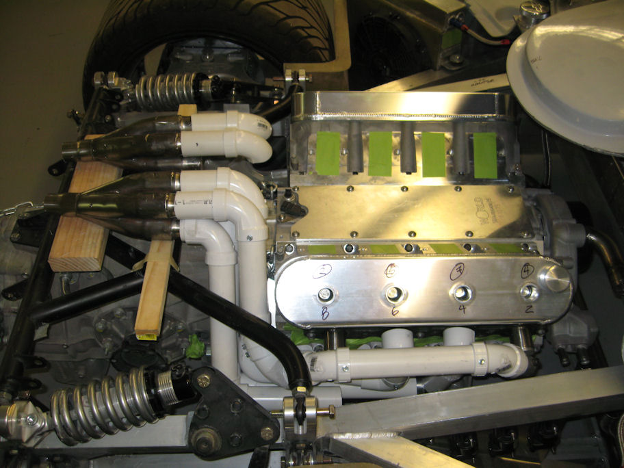

RM- This is the erector set from the Stainless Header guys in Fargo. I will be fiddling with various ideas for the exhaust system using this kit. I had got a couple local header makers to give a rough quote on the system I have in mind. One, just not the right guys. The other just too much dough.... So on my own I go...

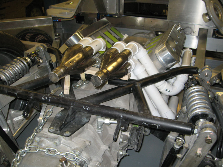

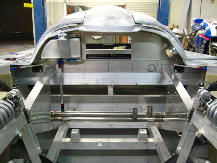

Some fiddling done. One thing for sure there is no way to do even a simple (non-sequential collector firing order) example of a 'bundle of snakes'. The restriction posed by the sub frame is the roadblock here. I have not paid any attention to the routing of each primary for equal length yet, but I did get the feel of how this 'works' in general.

Nice work. Go for the 180 crossover! Your car will sound like a scalded hornets nest...
Ian Anderson
How about using some flat merge collectors - like seen on Page 5 of the attached?
Front and rear cylinders from both banks into one and middle to cylinders from each bank into another.
Are you planning to route your exhaust like that? It looks like it would be coming right through the rear clip, unless you ran it underneath the transaxle cage?

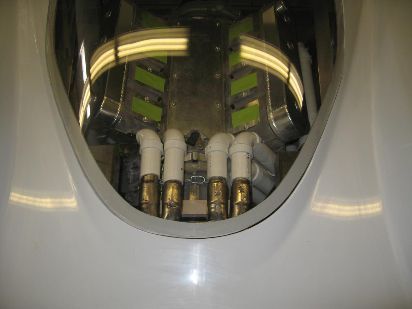

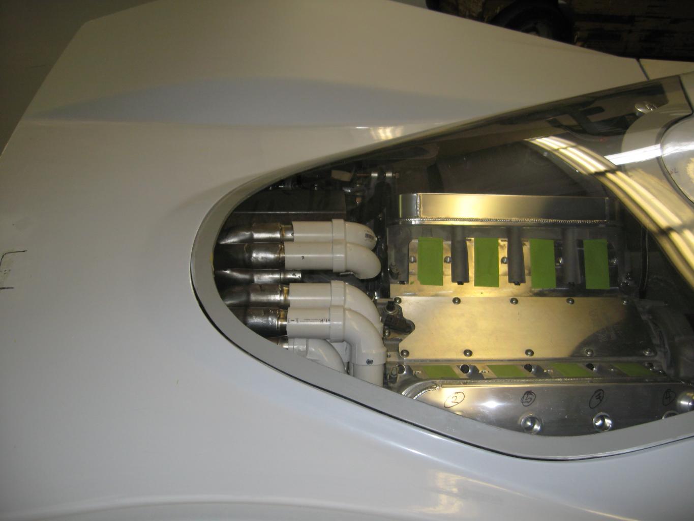

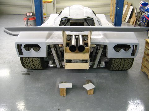

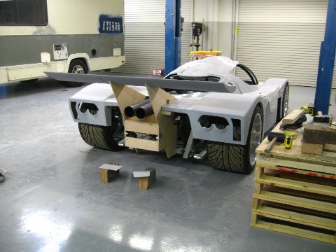

Needed some help to install the deck to check clearances Clarence. Working out way better than I thought it might. Cool, well maybe not cool..if I use this design I'll need to slot the back glass ala F40 to vent the heat off the pipes. Fun. The plan is to have the mufflers exposed or at least screen covered, so no it will not burn down the fiberglass cover. Like I said before I like to make problems to solve.

Wow, I'm surprised it fits .... interesting.
However, with the pipes that close to the fibrglass, can't that cause problems over time? My body guy was telling me how he's seen heater hoses from the waterpump that travel close to a fiberglass hood cause the hood to distort over time? If that's true, I'd imagine the heat from the pipes would cook the rear clip quickly?

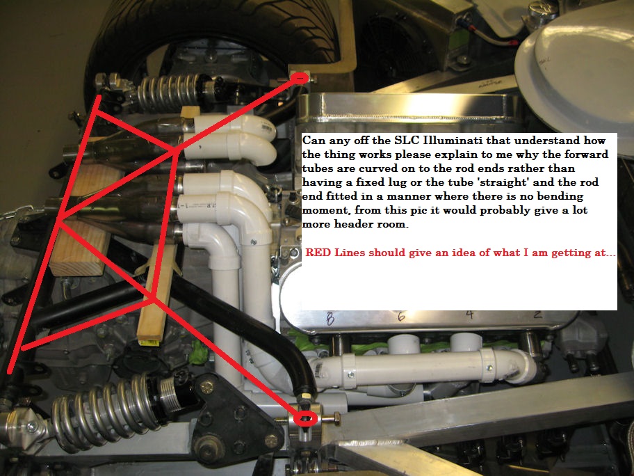

Why not modify the 'sub-frame' first for clearance & more strength, triangles are only strong when they have straight sides.
