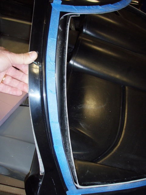

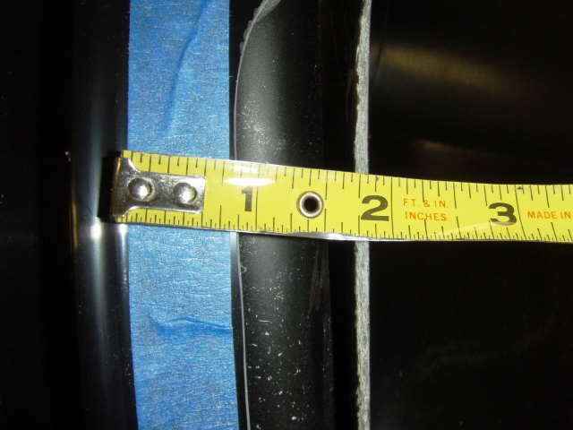

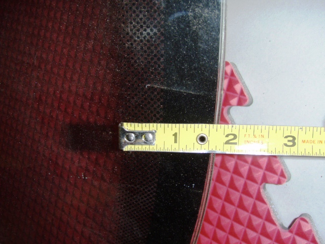

Fran - I'm not fretting, anything done in fiberglass is relatively easy to fix. As a good friend says "it's arts and crafts". By the way, I appreciate the way you designed the A-pillar cover to fit into the dash - very nice.

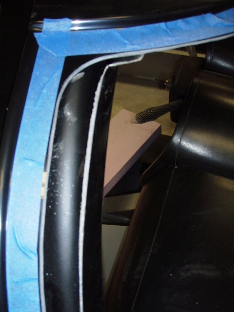

My point is that if I had known the A-pillar cover extended that far into the windshield opening I would have left a larger flange in that area - both to allow an attachment point for the A-pillar cover and to "hide" the flange behind the windshield. Obviously, this is only an issue for anyone wanting to trim out the interior of their SLC - it wouldn't matter at all for a track car. Shame on me for not fully checking the fitment and gaps prior to cutting the opening.
I've attached some pictures of what I'm talking about.......
Dave L

Dave,
If the windscreen mounting flange is not trimmed to 3/4 -1 inch then the fit of the glass is compromised...the dot matrix will cover and disguise the inner panels once the glass is installed....the windscreen has a 2mm window of error , from the glass manufacturer , this is the same as any OEM tolerance, so the mounting flange has to be adjusted to make the glass fit as tight as possible..
The A pillar and interior components were overseen by a 30 year veteran of interior design and a senior member of the Chrysler design department and approved by me...so it was not an oversight, at least not on his or my part.

no offense taken..Once you have everything in place and you finish the backside of the A pillar panel with trim black or flat black it will be essentially invisible to anyone that does not know to actually look for it...

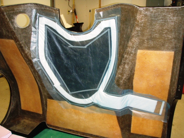

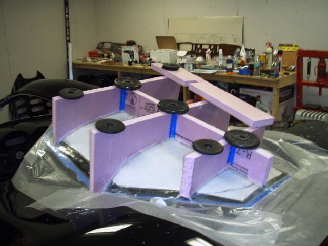

As I've mentioned I'm considering vacuum bagging some foam core to the underside of the rear clip of the SLC to provide more rigidity. Carriage House Customs was kind enough to allow me to try the process on Lotus Europa project they are working on for me. They were very understanding given they had already primed the deck lids and I had to sand it all off! Here is my very amateur video of how it went:
[ame=http://www.youtube.com/watch?v=mro_vgnFWLA]Foam Core Project - YouTube[/ame] .
Please forgive the lack of sound - I was going to use a soundtrack but YouTube doesn't allow it and I figured a voice-over would put people to sleep.
The results of adding the foam core are phenomenal! It added about 2-lbs to the front deck lid shown in the video and the difference in rigidity is nothing short of amazing. I see more foam core projects in my future........

Nice Vid Dave! A little masking tape or even tacky tape on the bottom of the weights will keep them from sliding. Thanks for posting a good instructional video.

( just some 30 years of building carbon fiber and composite stuff behind me)
I suppose you are using epoxy resin ? so what kind of matt have you used ???? there is no matt stuff able to be correctly melted by resin epoxy ( matt is to be used more with polyester and vynilester
In between peel ply an breather cloth you need to use a special very light film named breather film and manufactured to prevent the white " coton" breather to absorbe resin and to stick to peel play ( what a work to undo !!)
It is only the peel ply who works as a regulator
when pouring resin never pour all your entire cup as you did because that area will absorb all and even with your brusches you can not distribute correctly on the total surface ( normally with clothes like the first you used resin is applied more with plactic cards and not brushes)
Apologise for all these advises but as am doing composite school now being retired all these advises are the one i try to explain to all composite students
who wants to achieve racing or flying vacuum molded parts
If you feel these are not for a use feel free to tell and I will cancel my post
Hope this helps
Have a good day and keep on your nice and good work:thumbsup:

Michel - Thank you very much for your input - no need to apologize or cancel your post at all, I appreciate your experience and your feedback! I used vinylester resin so no worries with the mat. It's interesting you mentioned the breather film because the lady in the video mentioned something similar. She did advanced composites for Nothwest/Delta Airlines. My fiberglass supplier recommended the materials I used and they came off the lay-up fine but point well taken. Another good point on pouring the resin too. We didn't appear to have any pooling of resin but what you are saying makes perfect sense.

You where very luky t do vacuum process using vynilester because normally with 5 per cent catalyser the work start to cure so using peel ply and vacuum process taking time it's very difficult to proceed enought quickly !!
In this case I take my hat twice on the work you did !! Bravo again !!!
I have been on the net and the real english name for that film is :
"Perforated release vacuum film"
And it's very very cheap to buy ( this prevent to stick the "coton white stuff" and save it so you can reuse it twice

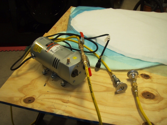

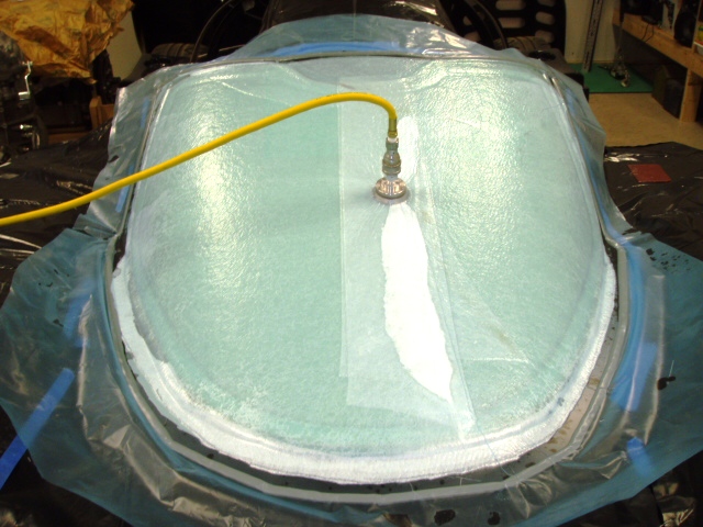

So my first attempt at making a mold for the rear window was a semi-success. The mold turned out OK but since it wasn't a vacuum bagged lay-up it ended up with air pockets in the surface. While I could theoretically repair the defects I bit the bullet and decided to make a new mold.
I'm using a race tail that doesn't have the rear window cut out and the stock plexiglass window. One of the challenges is how to ensure the plexiglass retains the correct shape of the body opening. It tends to spread or lift off the body at the outer edges. In my first mold attempt I tried using double sided tape to hold it down with reasonable success but I wanted to try something different because trying to remove the tape was a pain.
I drilled 1/4" holes around the perimeter of the race tail window opening about an inch or two inside the edge, set-up a vacuum bag on the underside of the clam, layed two layers breather fabric in the window opening then placed the plexiglass window on top of the breather. I then layed heavy duty bag film over the plexiglass and applied vacuum. It drew the plexiglass down hard onto the body - perfect!
I then did the lay-up starting with a light weight mat then 3 layers of heavy mat and vacuum bagged it and that's where I'm at right now. The next step is to lay on foam core then 3 more layers of heavy mat all under vacuum. This should result in a very stout, smooth mold.
