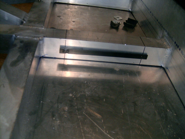

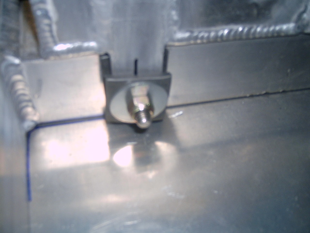

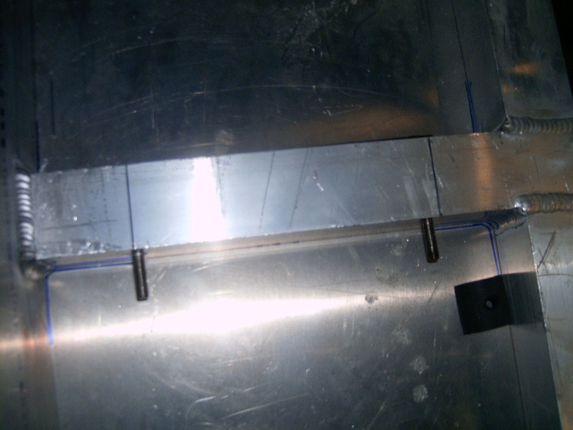

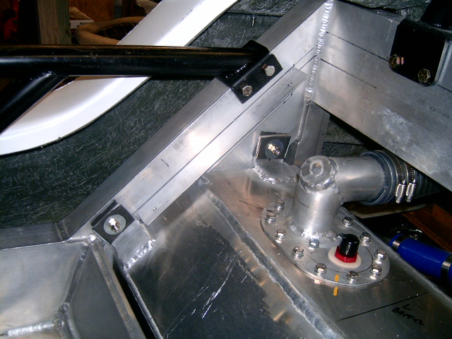

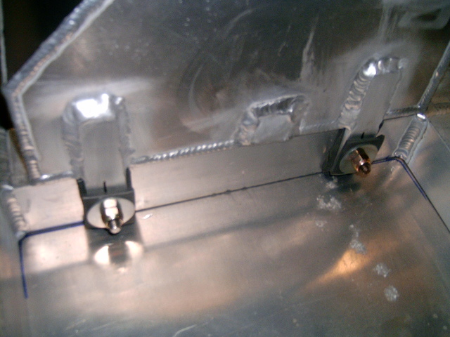

So anyway I don't know exactly how much the fuel tank will grow but here's how I am mounting it. The first one is a shot of the two bolts that are through the chassis under the tank behind the driver. If you just run bolt through the chassis tubing there isn't anyway to hold the head of the bolt. Here's how I do it. Now the bolts can't turn and all is necessary to remove the tank is to take off the nuts an pull it out.
I think that spending a little time figuring out how to take the car apart later really is worth the effort. This is an example.
The rubber squares will provide a little vibration absorbtion and I think it is enough to prevent the tabs from cracking. The tank can move around a little and that's what I was going for.

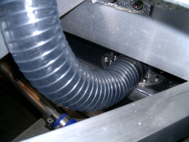

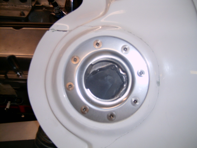

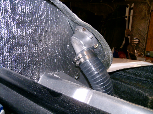

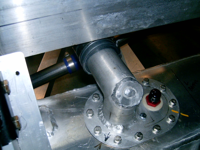

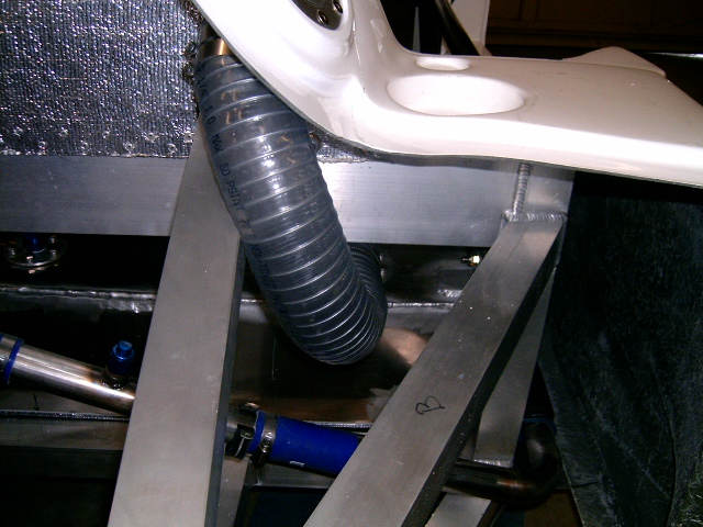

So here's how the fuel fill works. Out of the way, and in a good protected place. If you copy this, use a smaller diameter hose. 1 1/2" would be fine. This is 2 1/4 and is pretty hard to bend. I had to soak it in very hot water to get it to bend this much. The smaller diameter hoses are cheaper by the foot also.
I also include a last mount picture. This one is the passenger side of the tank.

Wow, that's some heavy duty hose! I didn't think about heating it. I used that Ultra flex 2" from the UK that Alex found. You could bend it into a 4 to 5" radius with steel reinforcement.

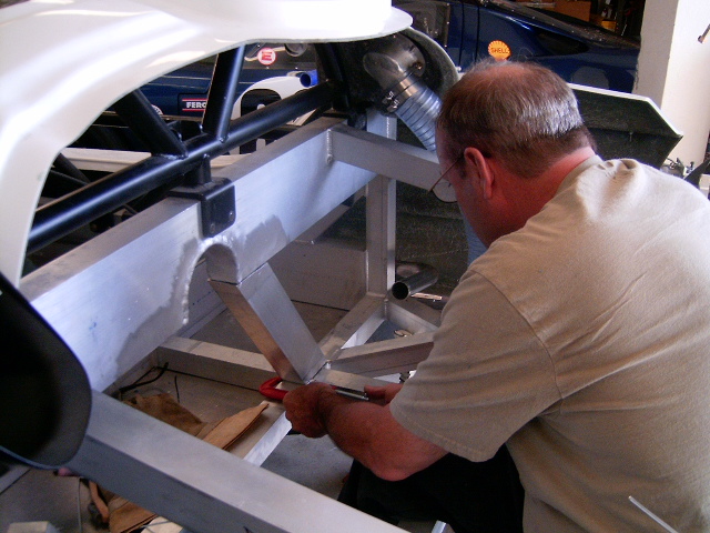

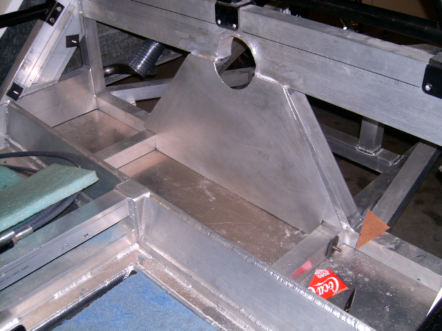

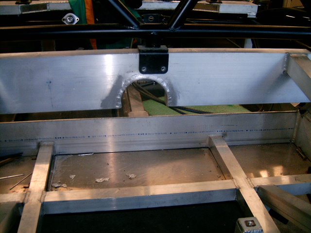

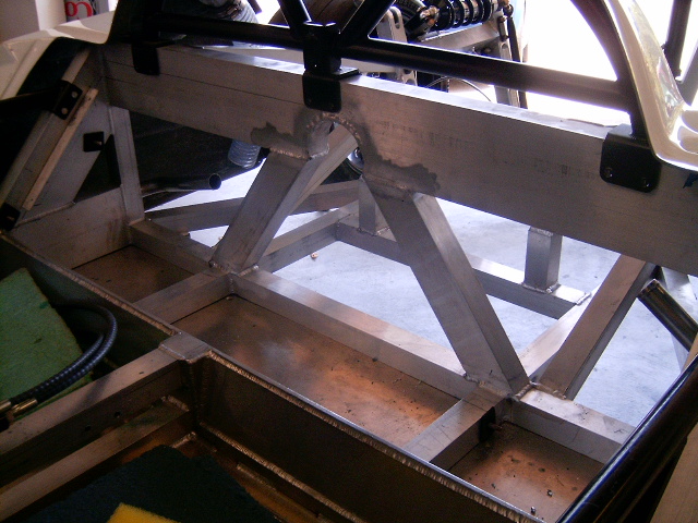

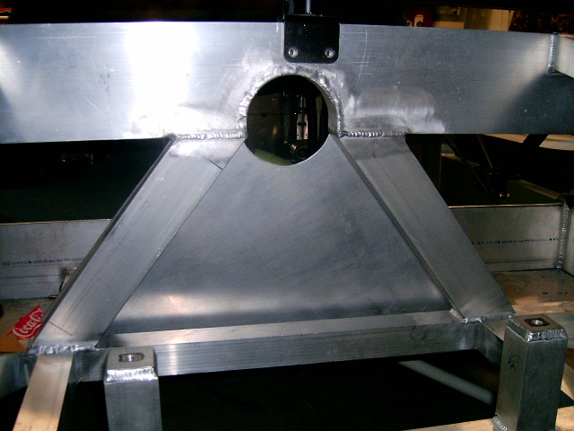

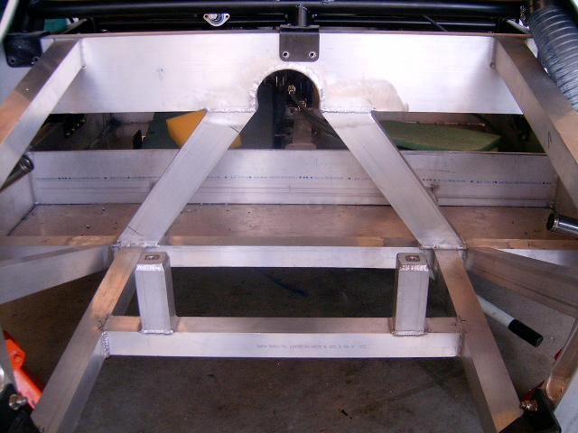

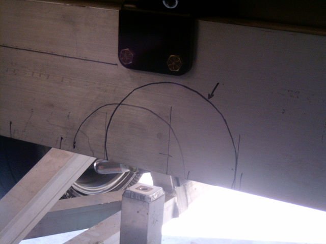

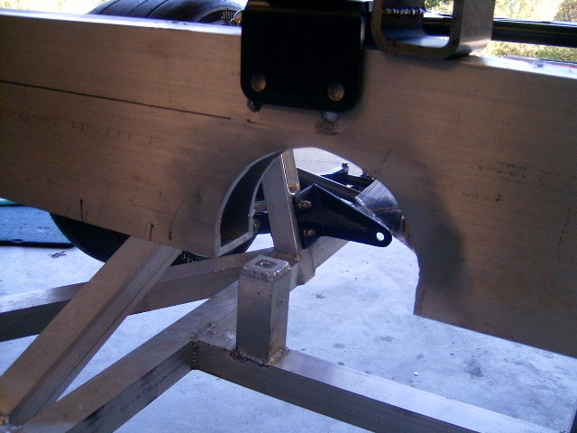

Started to do something about the water-pump pulley clearance issue. I couldn't just leave it because I would not been able to change a belt if I had to. Not to mention that it was just too close for comfort.

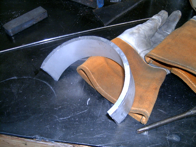

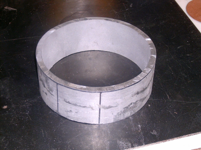

I found a big 6061 pipe that was 1/4 wall and 6 inch OD and I cut out a slice 2 inches wide. Then I opened up the big chassis cross tubing. It too is 1/4 wall. After I welded it in I called a buddy of mine and had him finish the welding of the diagonal pieces. The angle I had to work in was just beyond my skill level. It looks like a lot of room and good access but once I began I found I just couldn't keep my hand steady so I had my buddy do it for me.
The idea is to stiffen up the center section of chassis where the material was removed with the diagonal tubing I added and then box it all in with 1/8" thick 6061 plate. This will not only seal the engine room from the fuel tank compartment but add some more stiffness.
You can see that I have finished making the center plate and I'll post some more pictures as I complete the two side plates and rivet them all in place.

From what little welding we've done on the GT40 chassis I can tell you that it took a HECKUVA lot of current (heat) to weld that sucker and get good penetration.
Welding stooped over like that can't be fun either. Of course it would beat laying flat on your back and welding overhead (which I have a really tough time doing)..
Howard Jones
I have a new Lincond 225 tig machine. Very nice machine. I think I am about even with what it cost me and what I would have spent on getting things welded up for me if I had to pay someone.
The real benifit is being able to just try something without any labor cost. Material as a rule is pretty cheap and a lot of stuff like this job can be had for nearly nothing. I bought the alum from a metal outfit locally. They have a cuttoff barrel and everything is sold by the pound. By the time I am done maybe a hundred bucks including the gas and filler rod.
Not to mention, I like the hobby.
By the way we were at about 160 - nearly 200 amps.
