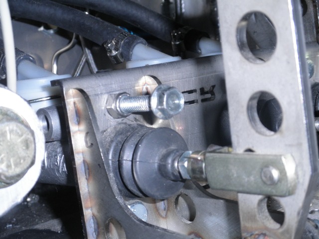

Here is a pic of where i finally adjusted the clutch to. Took a little back and forth and this might help if you're running a ricardo with stock clutch

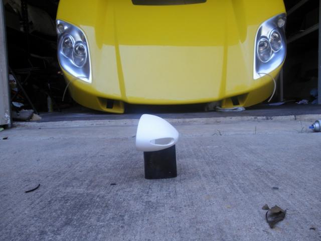

Here are the new style FG headligh mounts. The swiss cheese did a nice job of holding resin. I had a little collision and didn't want to pull the HL too far back so cut chopped the 2 low beams up a bit.

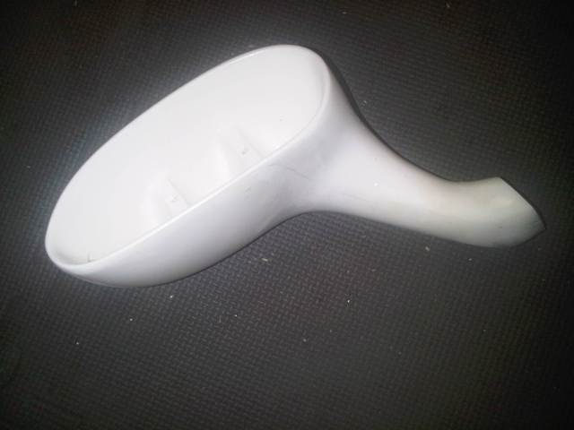

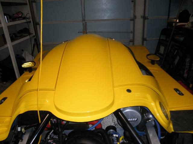

I took frans stock side mirrors to the grinding wheel and went to town. I was a little worried about the long stalks transferring vibration. Made the new bases out of boiled PVc. Thanks for the tip Jack! Covered them in Carbon Fiber stick on. OK, I'm a GTP wanna be but couldn't afford the $2500 that Riley wanted...
They are now stout...

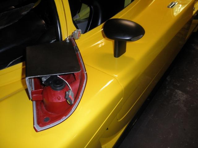

Here is part of the new tail light mount from RCR plus another shot of the side mirrors.

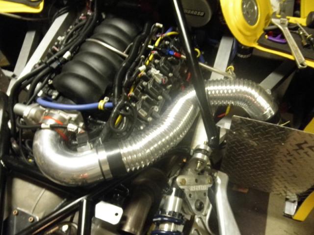

Another shot of induction. I stuffed a 15" K&N cone in front of induction. Once i get it on the road I plan to make an airbox and replace the flex hose with welded ovaled Al. Right now I just want to get it driving.
Hi Cam,
Does your engine run ok with that intake? I ask because when I was researching possible engine options for a GTM build, the GM LS manual suggested the Mass Airflow Sensor be located in a 10" straight section of pipe at least 6" from the throttle body. If yours works, that's great. More options that way.

The GM aftermarket/Hotrod ECU only requires a straight section of 6 inches at least 4 inches from the Throttle body ( if possible)...but we have found that the the pre-maf straight section is the more important spec. to function within the cal. range...now if you start playing with the cal. and trying to sqeeze more out of it ....its a potential crapshoot.
There is also an aftermarket MAF that can be fitted almost anywhere and tuned to accept most airflow conditions...its used in DP where the airbox has a 90-180 degree elbow turned upwards into the air plenum.

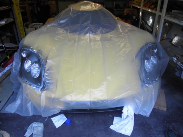

Which treatment did you use to get the chrome look in the HL enclosures? Can we get a close-up of that work?
Cheers,
Ruth
Ya, runs great. it doesn't have to be straight, i just measure 10" the centerline of this Al elbow. like in this photo. The ls376 has got a nice lope to it. It wants to be wide open all the time...:drunk:
Mesa, the pics don't do it justice. The Duplicolor Chrome looks way more like metal than what you see in these pics.
Scuffed it up with 320 then a scotchbrite, Hope it doens't peel in the greenhouse under the polycarbonate next summer!.
