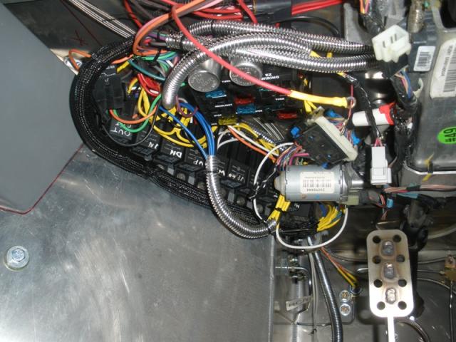

I haven't posted in a while, wiring is moving along nicely. Thats an old shot of the fusebox area. I've since ripped it out. I'm adding heads up display, rear view camera and had to switch the headlights. Turns out pin C3 on the 40 way connector is driving lights not head lights. C2 is actually driving lights.

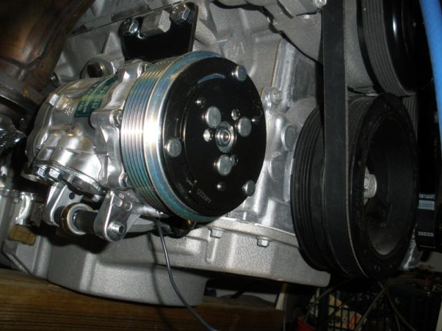

Got the A/C compressor on and found that a 38.5" belt fit best. the stock 40.5" was too big.

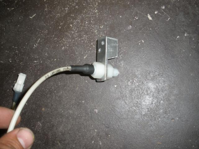

Took a piece of 1" Al square tubing and made a holder for the speed sensor to keep it 1mm form the front hub.

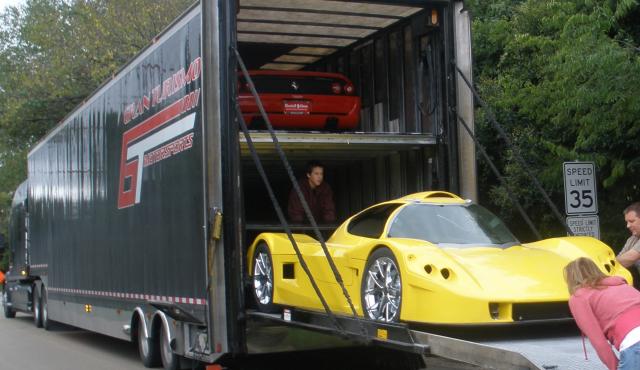

I also had to stick one more shot form delivery on there

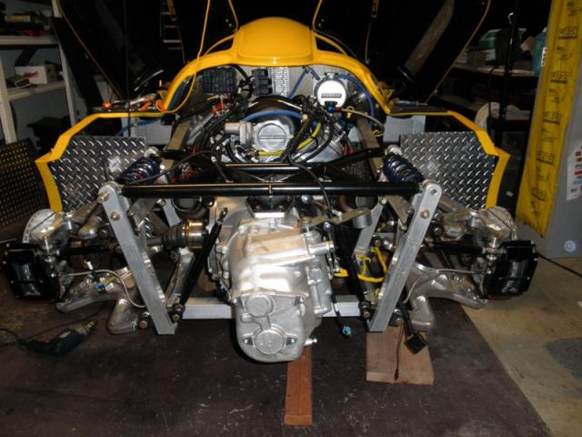

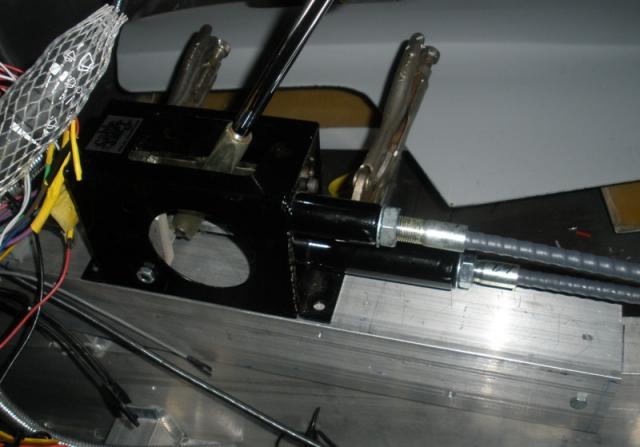

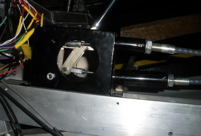

A milestone, I put power to the wirig harness on 4th of July and only 1 short! No fires! I mistakenly wired the horn to switch on power and it is actually ground switched in the EZ wiring harness. A quick snip and voila, horn. Got the engine in and another milesone, the shifter cables are now the right lenght. 102/104" works with the cables up agains the LS block. This turned out to be the most straight forward to keep them away from the cats. I traced them in heat wrap. Here is a pic of the shifter. i mounted it on some 3" x 1/4" angle to get the angle similar to the center console.

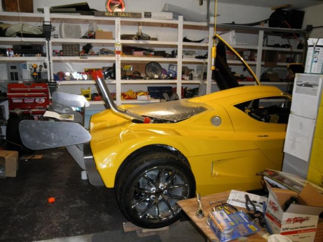

For induction i was considering cutting a hole in the back of th rear clip and putting on a scoop behind the rear glass. I'd rather not take one of the side intakes for induction, need to cool that TX air. Any opinions on that?

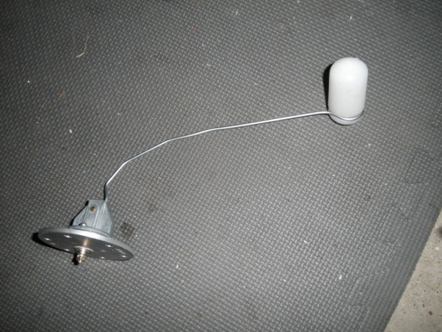

Bent the digidash fuel sender to miss the baffles in the fuel tank and side mount not top mount. By the way, ETB and Chet of Galek Motorsportshas been great supporting the Digidash. Chet even sent me an extra gasket and some magnets, N/C.

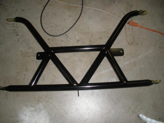

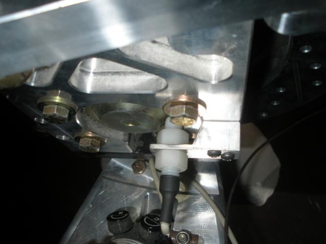

It is looking very good - the car is coming along nicely. Would it be possible for you to take a close-up photo of the rear/top Ricardo mount? I need to have the tabs welded on to the X bar and mounting plate I'd like to show the welder what the finished mount should look like.

I too have been looking into rear scoop options for induction. I believe Fran's "mule" and Ernie's car both had rear scoops. CRC has a rear NACA for induction I believe. I like the latter if I can find a suitable one.

I was looking at the Naca's but they seem to cut alot of depth. There's only a 3-4 inches to work with above the cross member from my calculation but i've had the rear clip in storage since delivery.

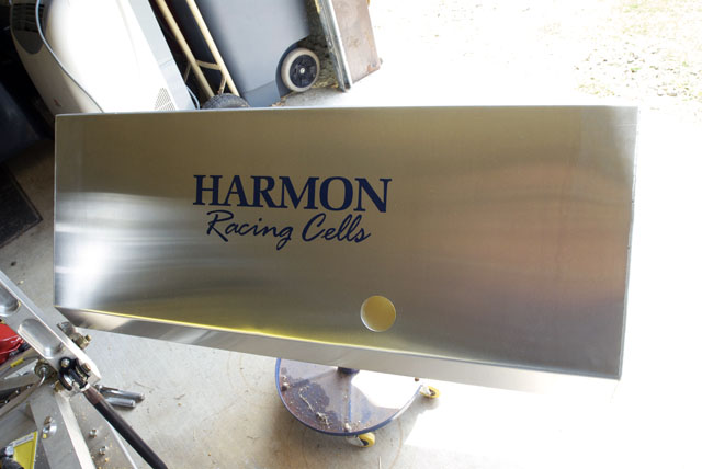

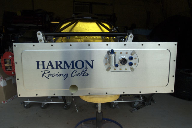

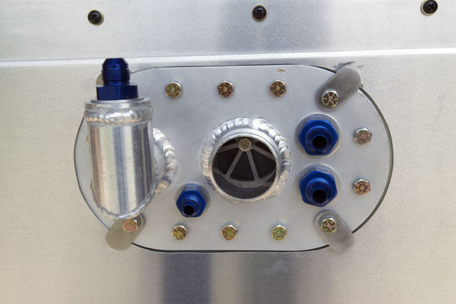

That was my quote and you're still outpacing me I believe. BTW, I got the fuel cell back from Harmon Racing and from Fran. These photos show the vent tube needing rework. Fran chopped this off and welded a bung in it's place so now the tank will fit under the cross member. Fran added a tube through the cell where there was just bladder showing....much better.

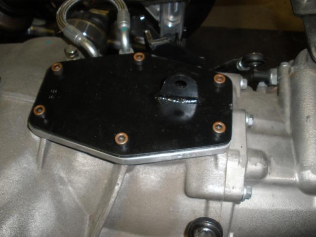

Here are a few shots of the 5th point tranny mount.
OK, i think i solved the problem of induction. Turn the SLC into a hatchback and stick the rat tail out the back...?
