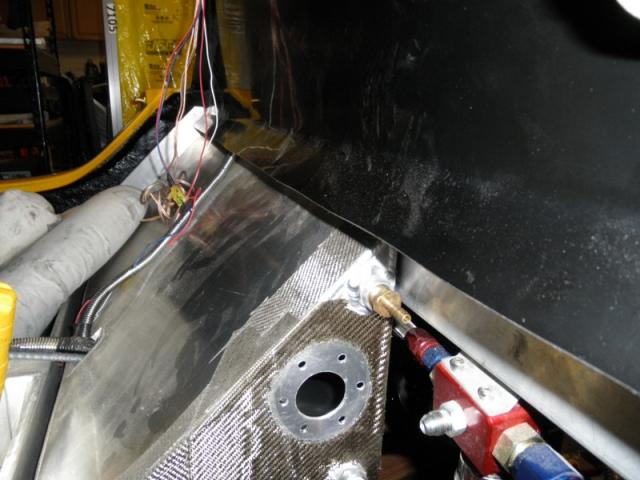

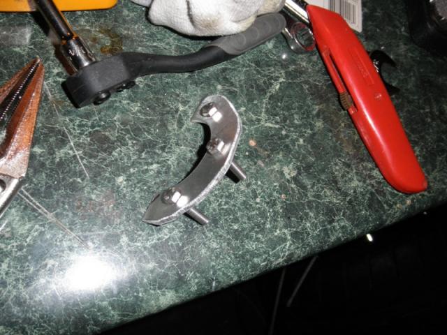

I got the fuel tank cut for the fuel sender from digidash. I got a 2nd gasket and made a Al plate for the bolt pattern. then cut the plate in half, tied a string to it and stuffed it into the 2" hole. Opened it up and aligned inside, this way i didn't have to cut a 2nd hole into the fuel tank to mount the sender bracket from the inside.

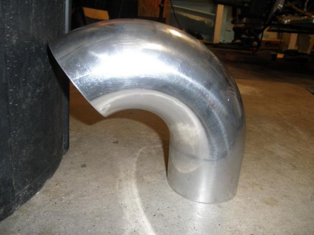

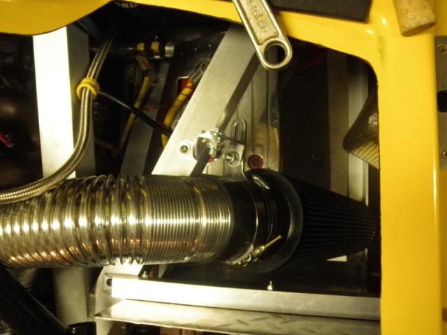

For intake, i found a 120 degree 4" Al elbow form Spectre. Nice, it has a 4" radius. I had to shave off about another 20 degrees, so it's probably 140. Then snaked Spectre flex tubing under the SLC crossmember. OK, it looks like dryer tub, but only a short lenght. Put a giant 14" K&N cone to top it off. I took measurements with the rear clip on and it should fit. I might have to oval out the 4" tube a tad

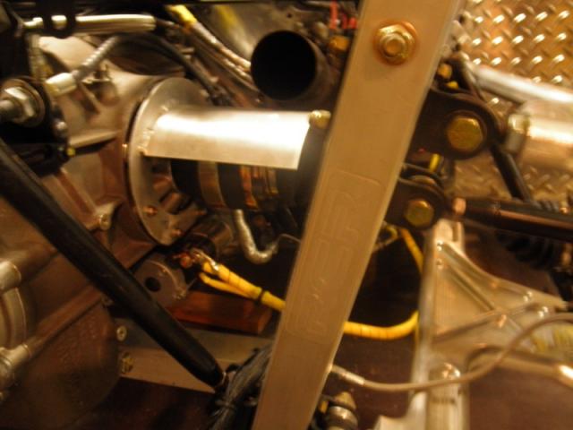

Here is a shot of the heat shields I just had welded. My cats turned out about 3 inches from my CV boot. didn't seem like a long term solution. I just used the Ford Gt mounting holes. Got the axles on with the new adapters from driveshaft solutions. They were great to work with. I'd make sure your axles have the adapter and the holes just aren;t reemed out. It takes 36 bolts instead of 24 but looks more balanced...

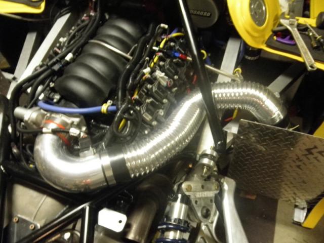

Another shot of induction. I stuffed a 15" K&N cone in front of induction. Once i get it on the road I plan to make an airbox and replace the flex hose with welded ovaled Al. Right now I just want to get it driving.
