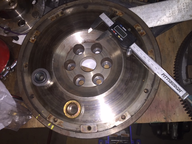

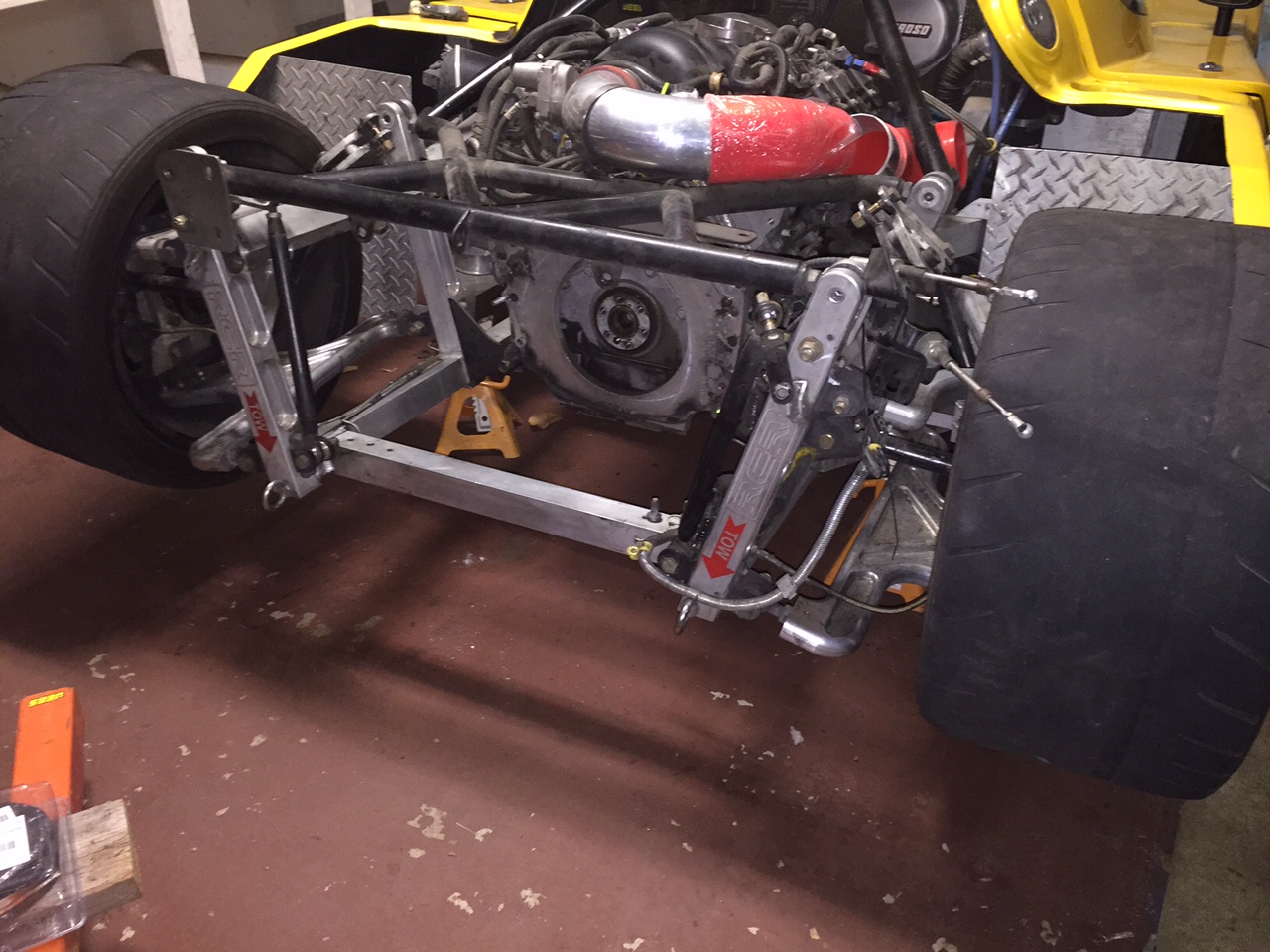

Flywheel- I got one of the earlier flywheels for the Ricardo back in 2009 that was machined about 3mm too narrow. There are probably only a handful of people on the blog that this relates to. When the twin disc clutch wore down after about 7000 miles the pressure plate started hitting on the flywheel. This slowly caused a metal on metal situation like a stage 3 clutch. It gradually got to the point where I had to slip the clutch to move. So I pulled the rear clip and tranny, leaving the engine in place by grinding down the Ricardo tranny mounts 1/8” or so. This was the First time I had the clip or tranny off since the engine has been in place since 2010. I Popped the flywheel and had 3mm ground off of the outer lip, $70 at a local machine shop. Fran offered to do it free of charge but hey, it took 1 day in DFW. Hmm, if that was my old 911 Turbo, that’d be $10k?

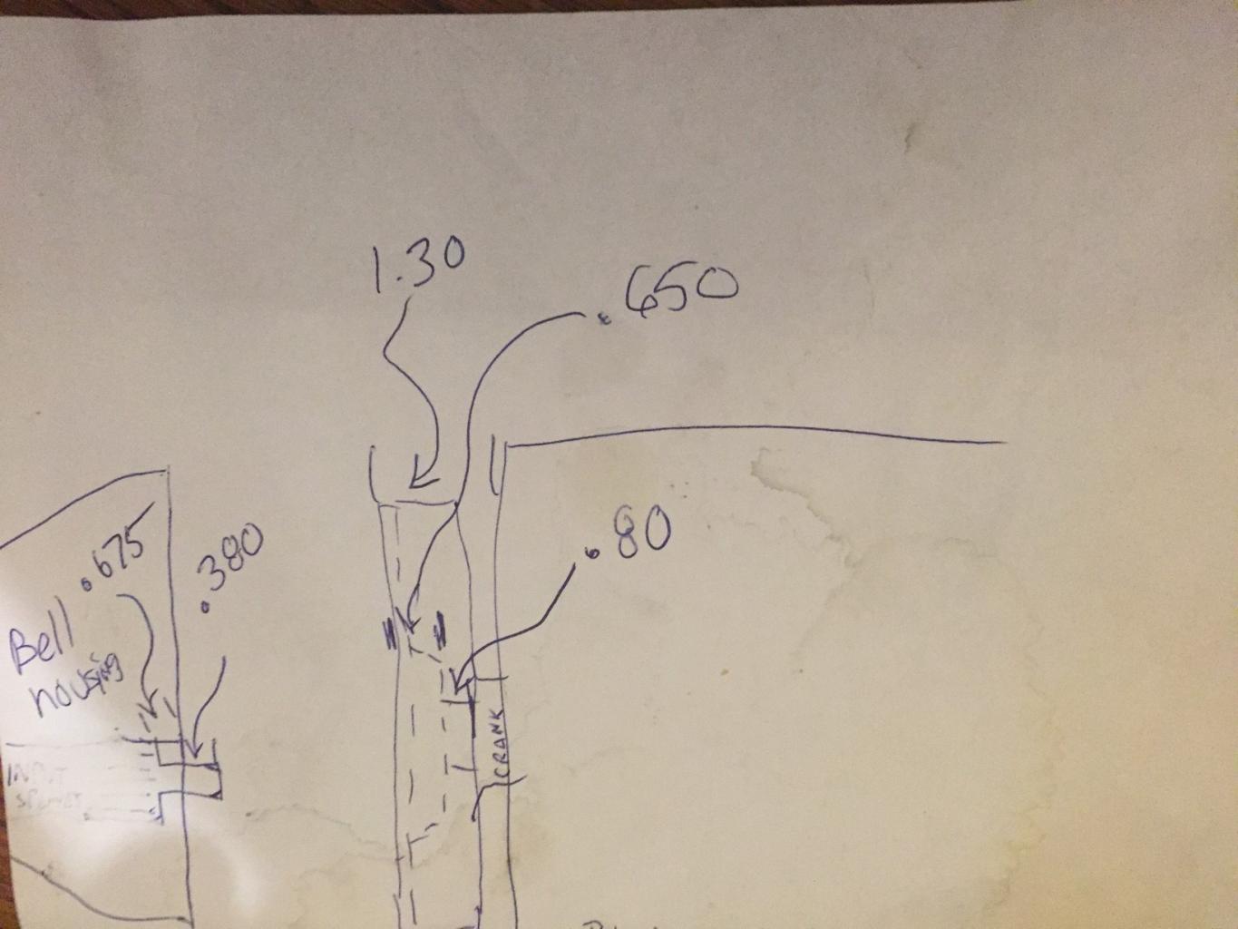

Pilot – While I had it cracked open I figured I’d go from a Brass/bronze pilot bearing to roller like the FGT. Ironically they use a Mustang roller, $12.87. Again this switch at the Porsche shop, thousands $. I took some measurements on the depth of the bearing and I had forced the bronze bearing to flush. I had the flywheel widened plus set the depth for the new roller pilot to around 3mm deeper than flush. From the measurements, I think the Ricardo would be happier with the pilot bearing inset 3mm at least on the early flywheels.

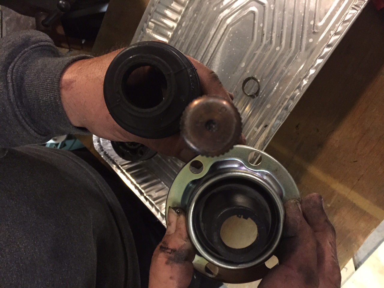

Boots - While I had the axles off, I switched to Frans new Turbo boot solution. Much thicker which is great for the Ricardo. I have about 12 degrees of drop from tranny to hubs that caused the old style turbo boots to rub on each other. The only thing I noticed with the new boot doesn’t like the hubs to be spun while jacked up. The droop goes from 12 to 20+ degrees when jacked, so with these boots careful not to spin the wheels when jacked up.

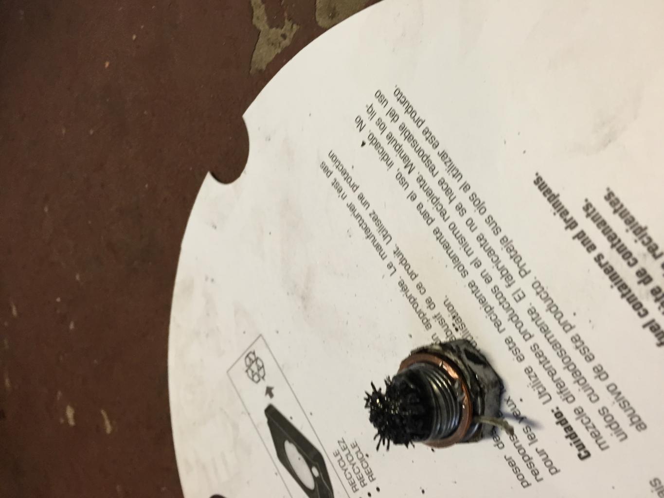

Tranny – While I had the tranny out I changed the fluid. I pulled the magnetic drain plug and it had “fuzz” on it. When you break down the fuzz, I couldn’t find a particle bigger then .5mm. I think its aging pretty well with only 500 micron particles at 16k miles.

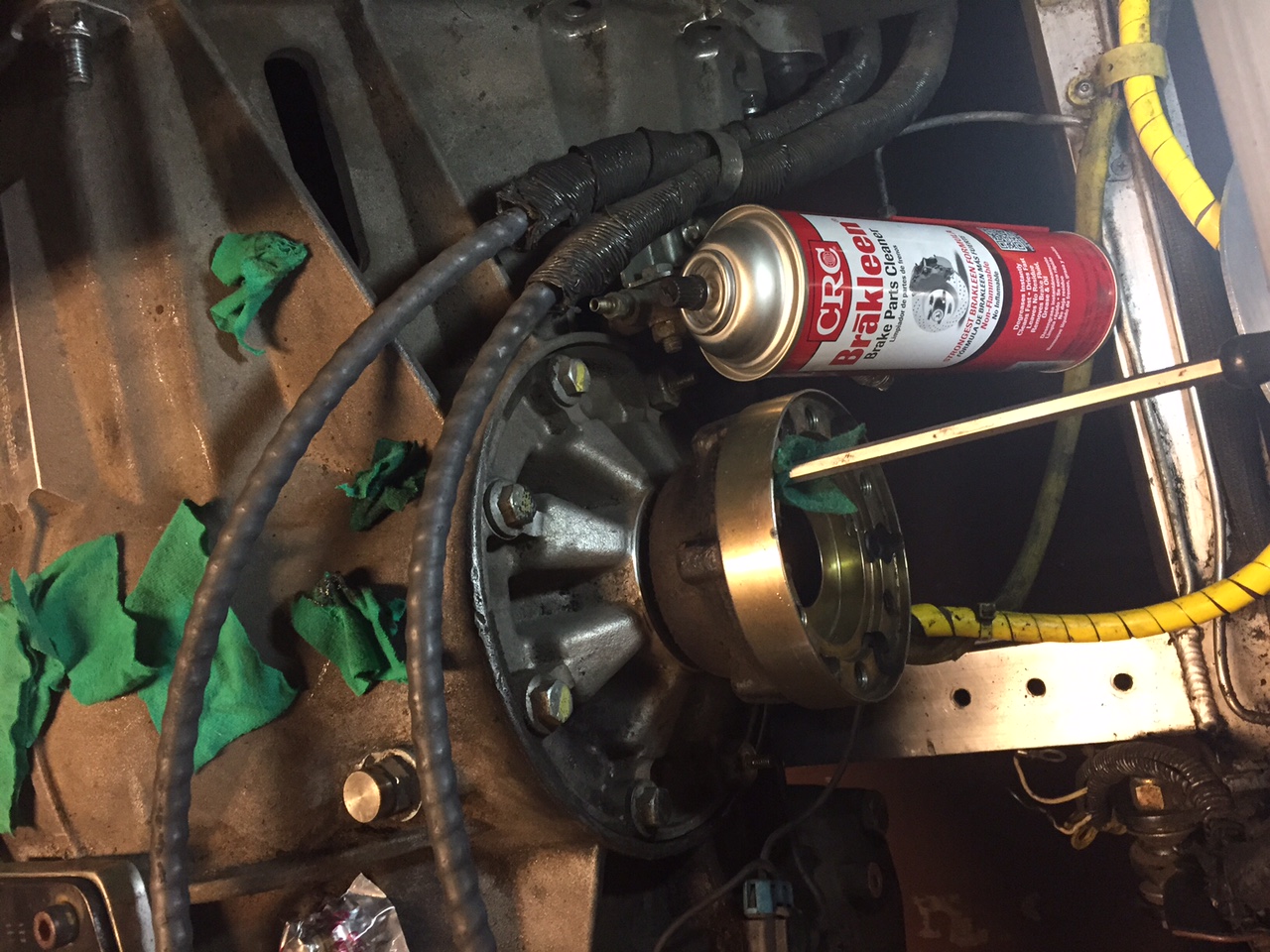

Axles – I was down for a while so I sent my axles out to the driveshaft shop. They said they would look at them and refurb for $240/axle. This is the most I’ve spent on any part in 7 years, not bad…They had a little wear but this might be due to the Ricardo having a 12 degree drop. When I got them back they were new. The steel looked to be grade 8/ yellow compared to my old axles that were straight silver. A shout out to the DriveShaft Shop and Frank! Very helpful… Also, I added a jpg for my favorite way to reassemble the CV's, surgically clean or the grease defeats the blue locktite. Again, this repair at a Porsche shop, $$$.
