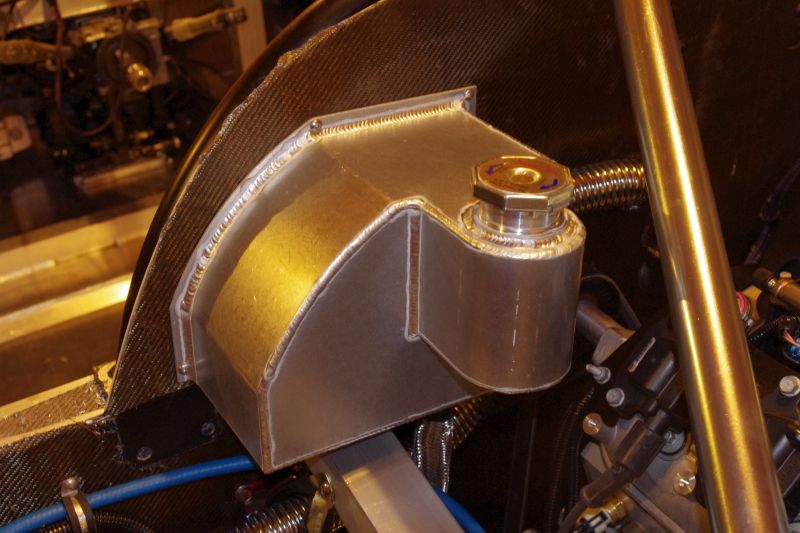

I got mine. Looks good. I will figure out which lines go where once I get my car next month and start on it. Does it just take a standard 1 bar pressure cap that I can get from Autozone/pepeboys/trackauto ? Part number anyone?
Yup, the workmanship and welding looks great!

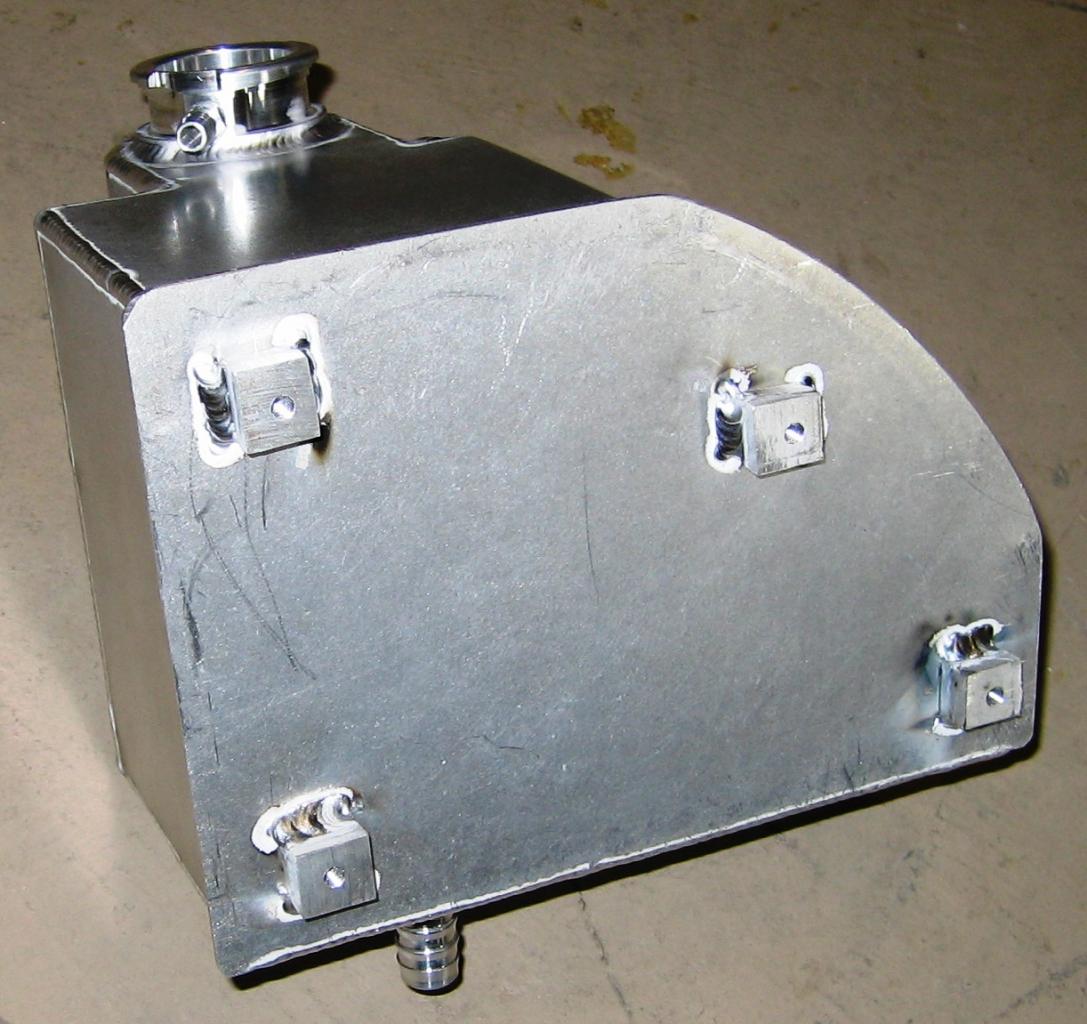

Since there are no mounting tabs, I guess it's up to us to figure that out and weld on the mounting points.
I think I'll weld threaded standoffs on the back of the tank. That will keep the clean look and provide a small air space to reduce the thermal transfer thru the firewall and into the back of my head.:sunny:

Yup, that's what I assumed as well. However, on the tank I received, there is not enough flange around the edges to drill even a small mounting hole.
So I welded these threaded standoffs on the firewall side of the tank. I figured that would look better than trying to weld some addition aluminum flange material along the sides so flush mount holes could be drilled.

Allan - That looks great! Thanks for posting the mounting photo.
Folks, remember there's very little stress on the mounting screws other than the weight of the tank and coolant. The screws can be relatively small and 4 or 5 should be plenty.
Bill - Your tank won't go anywhere!
Dave L
10-32 bolts in 5 places fit on the flange without hitting the weld.

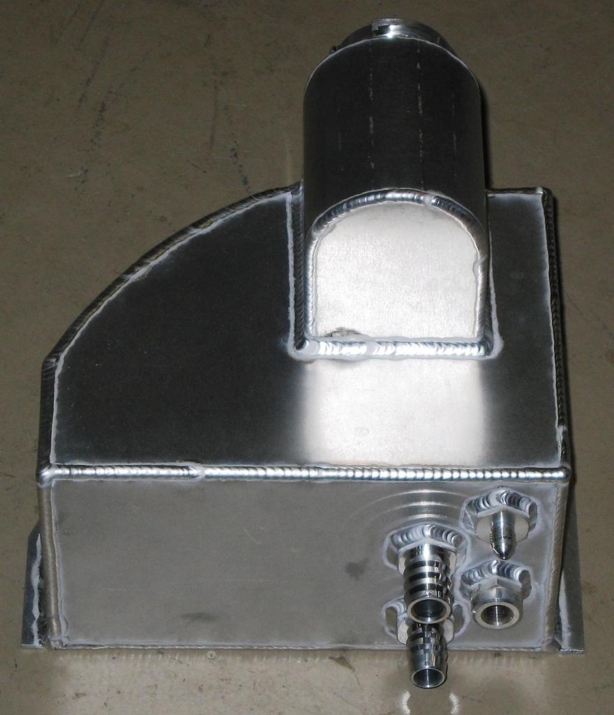

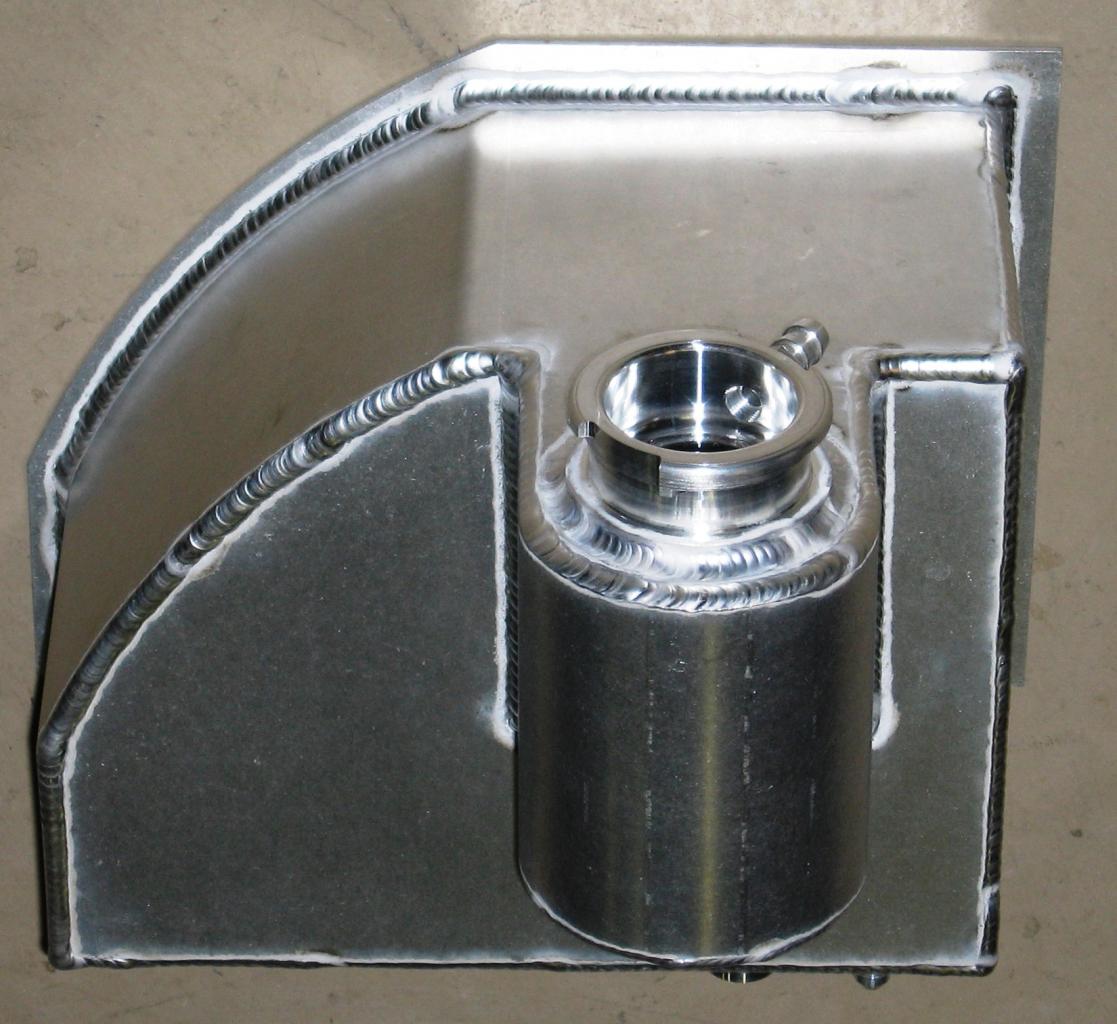

I've been intending to post this for some time now - I apologize for the delay. Here are the parts and the process of having the coolant tanks fabricated:
Tank fittings -
summitracing.com
Billet aluminum filler neck: CTR-80-092 $19.95
1/4 NPT Female Weld Fitting: EAR-996702ERL $5.95
-4 Male Weld Fitting: EAR- 997104ERL $7.99
3/4 Barb Fitting: MEZ-WPM34U $18.79
5/8 Barb Fitting: MEZ-WPM58U $18.79
Aluminum (water jet cut):
emachineshop.com
Material = 5052 aluminum, .093" thickness
$650.89 or $43.39/tank (15 tanks) NOTE - Price varies by quantity.
Welding
(Metals Joining Lab (952-881-5118)
$75/tank
Metal forming = $26.67/tank (15 tanks) (through Metals Joining Lab)
Shipping
$5.92/tank (components + aluminum)
Total = $222.45/tank
I'm unable to upload the .ems file for the aluminum tank components - if you want the file please pm me and I'll send it to you. Be aware - the cost for a single tank is high.
Dave L
