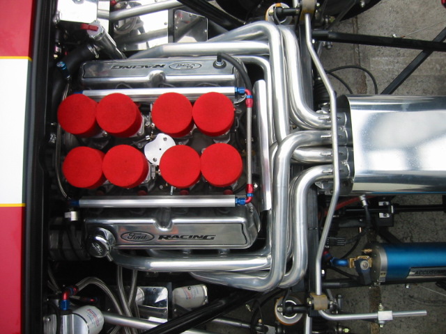

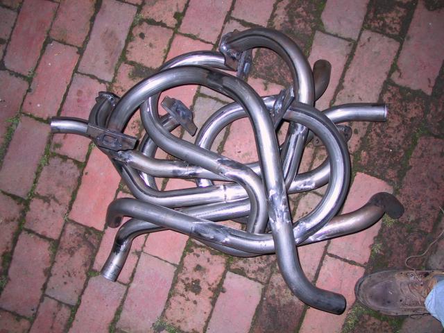

There you are Bob, sort that lot out ! Frank
Pete McCluskey.

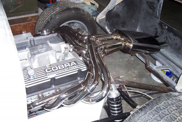

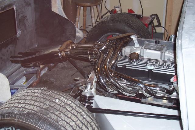

These may help.

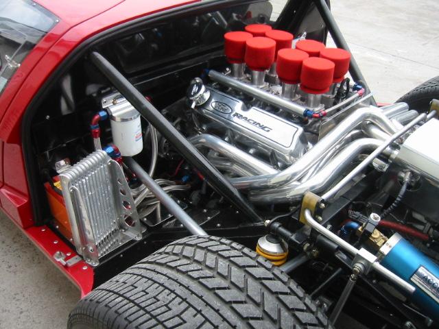

Bob,
Here are mine on a 351 Windsor
You will have to excuse the color difference on the last one. The butterflys were not set and very little air was getting to the right bank of cylinders, thus no heat and no "aging" of the stainless pipes.

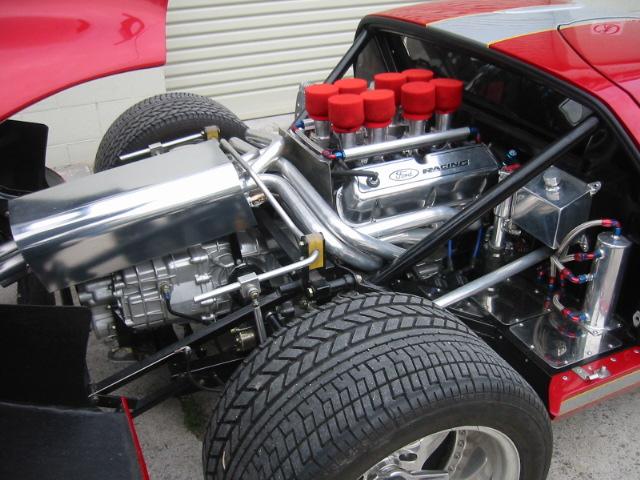

Gelscoe Motorsport is the only outfit I know of that builds a proper GT40 exhaust. Here's some images:
Even the hack-and-splice exhausts are extremely expensive, and no doubt quite labor-intensive to build; I'm filled with respect for any owner who chooses to tackle that job on his own! :stunned:
I can only imagine how much the proper sand-bent version costs! :shocked:
But for me, there's no substitute for the real thing! :thumbsup:
