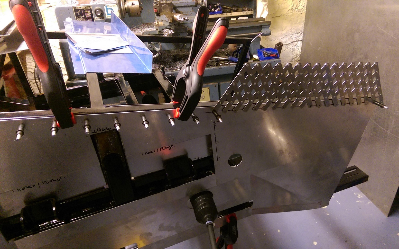

Nothing to report yet! Have been buying rivets...2000-odd sealed end 4mm rivets in a couple of different grip lengths
A pack of Presto 4.1mm drills (these are great - have a split-point tip which means they self-centre without a centre-punch mark)
and a fan-spacer tool for laying-out the rivets
Also been sorting through the bewildering array of ally panels trying to work out what goes where
Well....I say bewildering, but in fact it was pretty easy to work out. Mind you, I've been studying everyone's build logs on here for years - so much so that I think I have a 3D model of a GT40 in my head.
I think I'm going to need more Clecos....if anyone has progressed beyond panelling and would like to rent me a load of 4mm Clecos for a few months I'd like to hear from them.

Laying-out and drilling panelling. Using 50mm centres for the rivets....is this too close?
