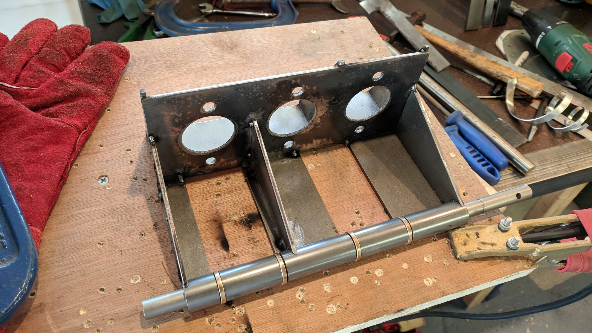

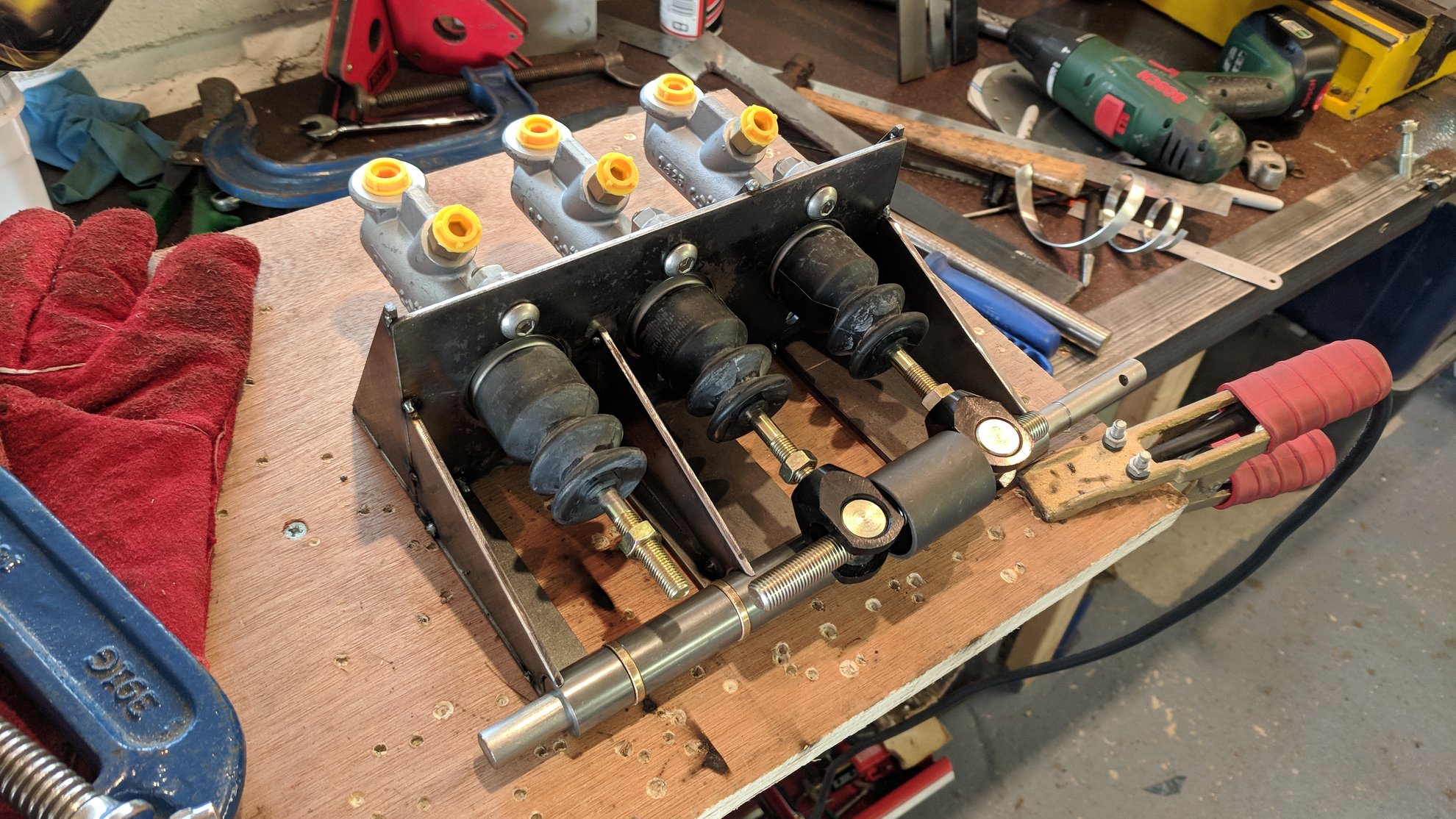

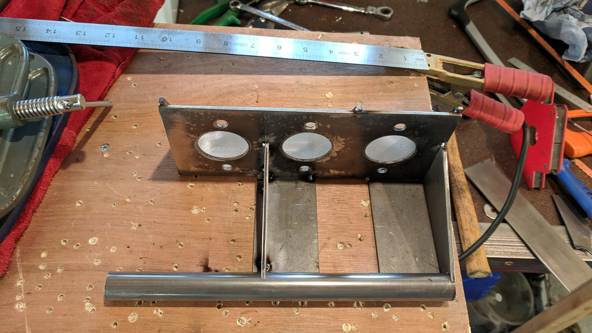

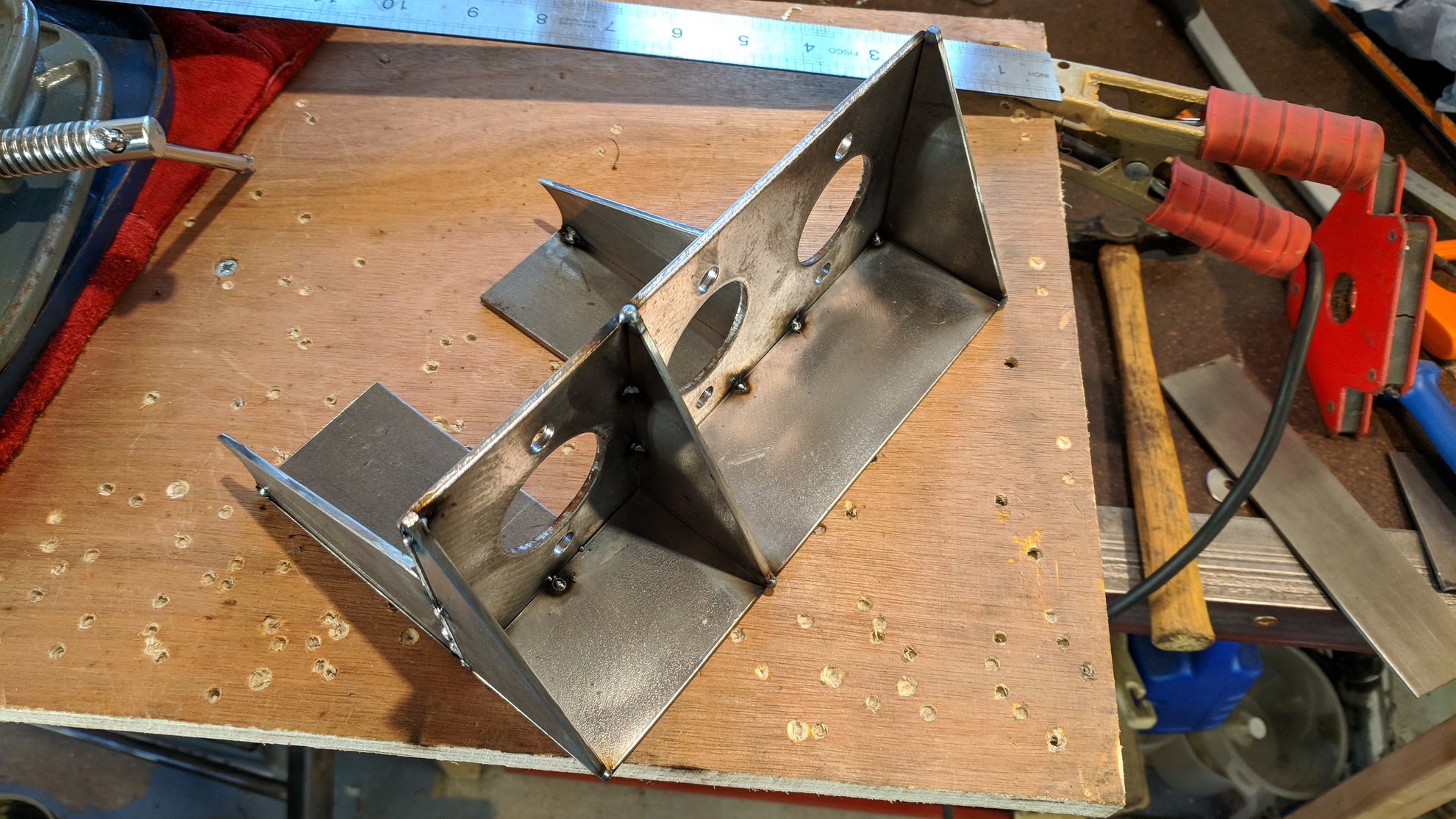

Been tacking together the pedal box and mocking-up the master cylinder position and pivot bar (with Oilite phosphor-bronze bushes for the clutch & brake pedals).
Ultimately this will be adjustable for position, but for now it'll be fixed to suit the 5' 9" driver. Please excuse the state of the workbench!

Thank you, Eddy. They look similar to The AFCO Torpedo master cylinders that I use in my build but they are no longer available.
If you are concerned about the UN-1 box look into the Chris Cole conversion to a one piece main shaft. better 1st and second gear and a limited slip.
Don’t forget to leave room for the two spacevers and Custom support bracket. Looking good eddy
