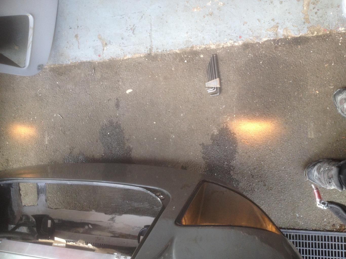

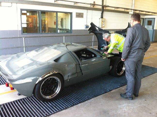

It was a roller coaster of a ride few minor fails easily sorted, and a couple of big ones that may take a couple more goes to get right as I have no easy means of testing them prior to a retest. I could not believe the number of things that have worked for literally years in some case that failed on the day. Fuel pump, instrument illumination, fog light and main beam indicator, literally both tested yesterday and working fine. Then the big one, after the tester did a couple of laps of the centre car park to check the self centring of the steering, she boiled over after he switched it off I checked the manual switch and the fan switched on, then noticed the temp gauge was off the scale. No idea why the thermo switch did not cut in, and very worried about any damage it may have done to the engine.

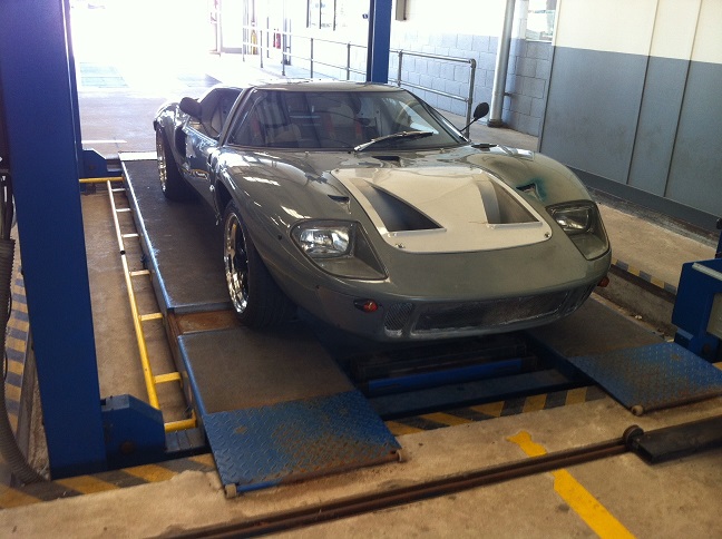

There were some funny bits, best one got in the car did all the light checks then he put the ramp up with me in to check steering etc. Was there for quite a while then heard, we will check the lights, oh well perhaps they have to check them twice. “side lights”, “headlights” “indicator” Hold on I am still on the side lights, headlights next oh bugger that’s the hazards not the heads, “brake lights” hold on I still have the hazards on what happened about the headlights, “fog lights”
Something doesn’t add up here, it was then I looked in the wing mirror and realised while I was sitting merrily in the air a taxi had come in behind me and the second tester was running through a light test with them .
Highlight of the day was when I was leaving a mono had come in I asked if I could take a pic and one of the crew spotted the GT40 and loved it the photo shows the actual moment he spotted it. Also cheered me up as they were in for a retest, so it even happens to the experts.

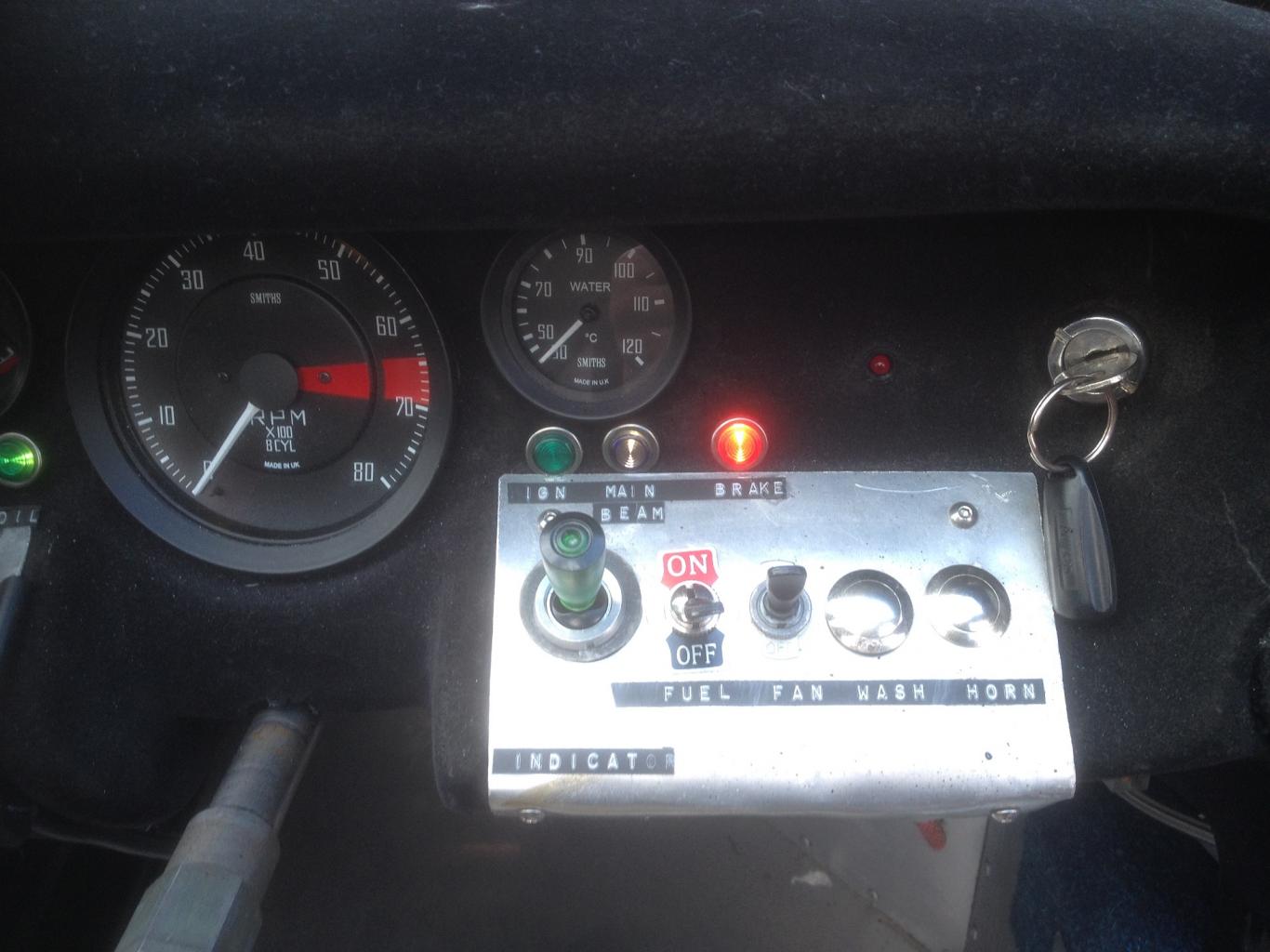

RS8: There must be a tell tale when on Main Beam

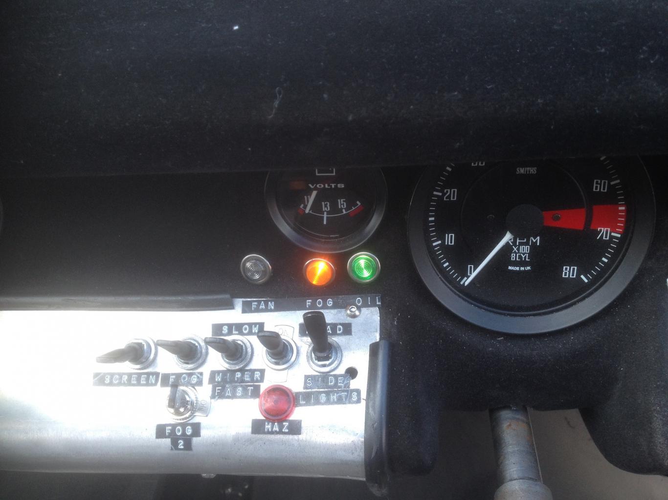

Fix put lights on main beam tell light came on. Hope it's not an intermittent fix.
Failure
28 - REAR FOG LAMPS
RS6: Rear fog lamps must be fitted with an operational 'tell-tale' lamp (non-flashing) visible from the driving position
Fix
Fog light must not come back on if you switch the lights off then on, I wired it up to achieve this but put a second switch in so you could turn the fog light off without switching the lights off if you wanted to. Unfortunately I did not realise the tester had left the 2nd switch off so the tell light was off. Restored 2nd switch to on tell lamp came on.

You may be thinking why has the idiot put up some picture of illuminated tell lights. Just for my sanity really to prove they are working....at present

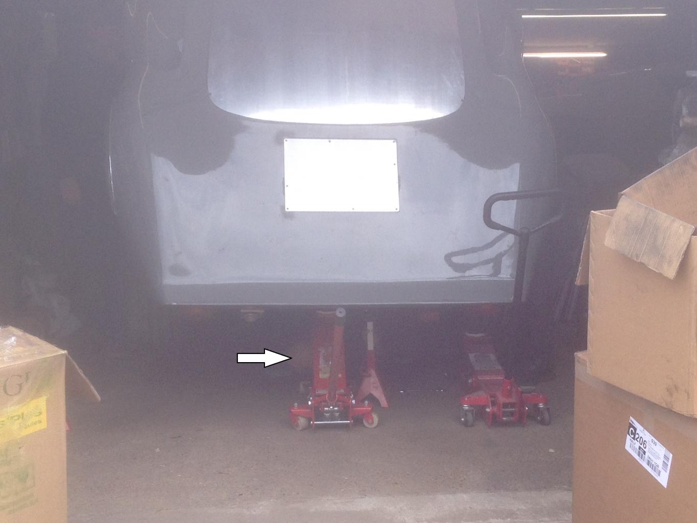

Pictures show SGT workers Nick, Keith the welder arrowed (who spent most of the day under the back of the car having various things dropped on him), Mick the maestro himself working his magic on the lathe, Mick's son Adam also popped in a few times to keep an eye on things and Mick's ever patient wife held fort in the office.
