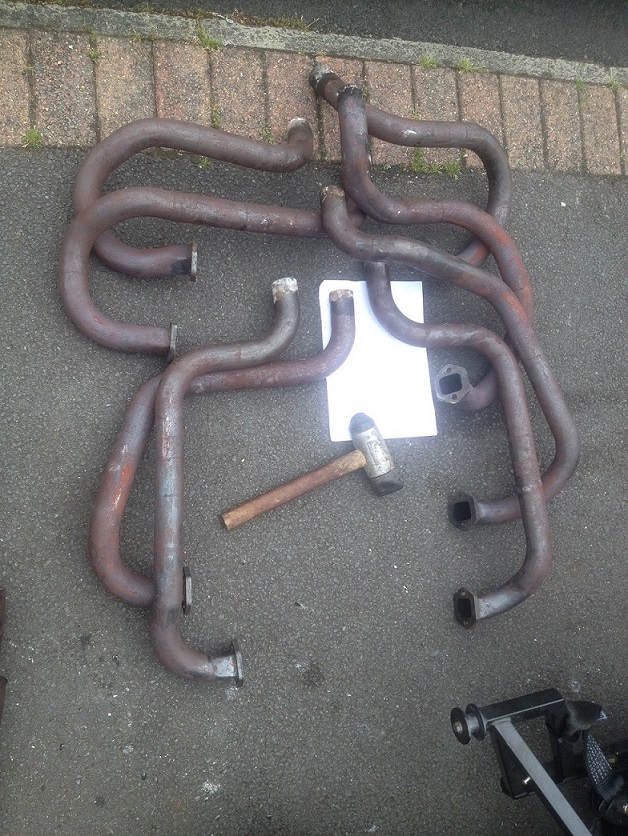

I take that back.
Isn't there a pipe missing in that first shot?
Good spot Bob very impressive, but you need to get out more :) fitted the first one before remembering Mary is away until Friday so I didn't have to rush to get them out the front room and therefore had time to take a photo.
A before photo with all 8
