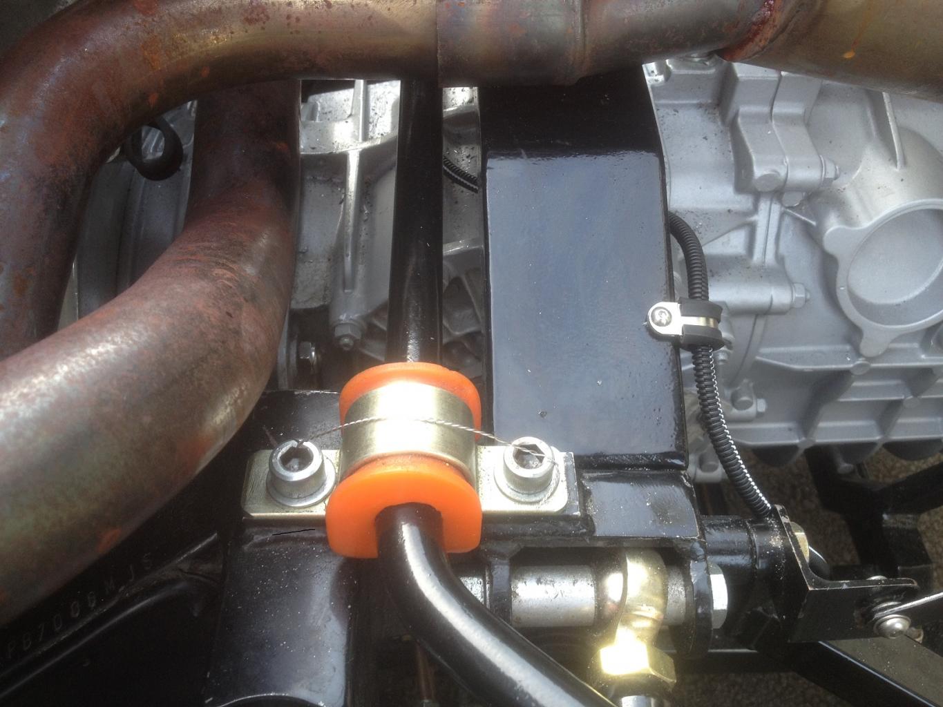

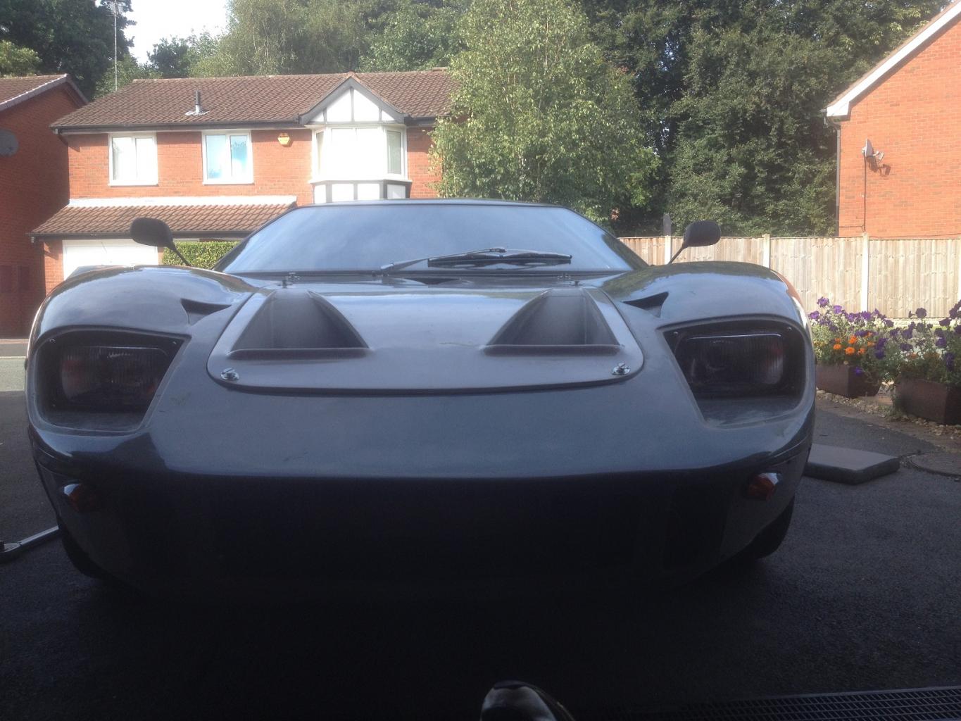

More IVA stuff done, temporary wing mirrors, front indicators, square wheel nuts, rear clip cover, and side repeater indicators, also started wire locking bolts bereft of a secondary locking device.

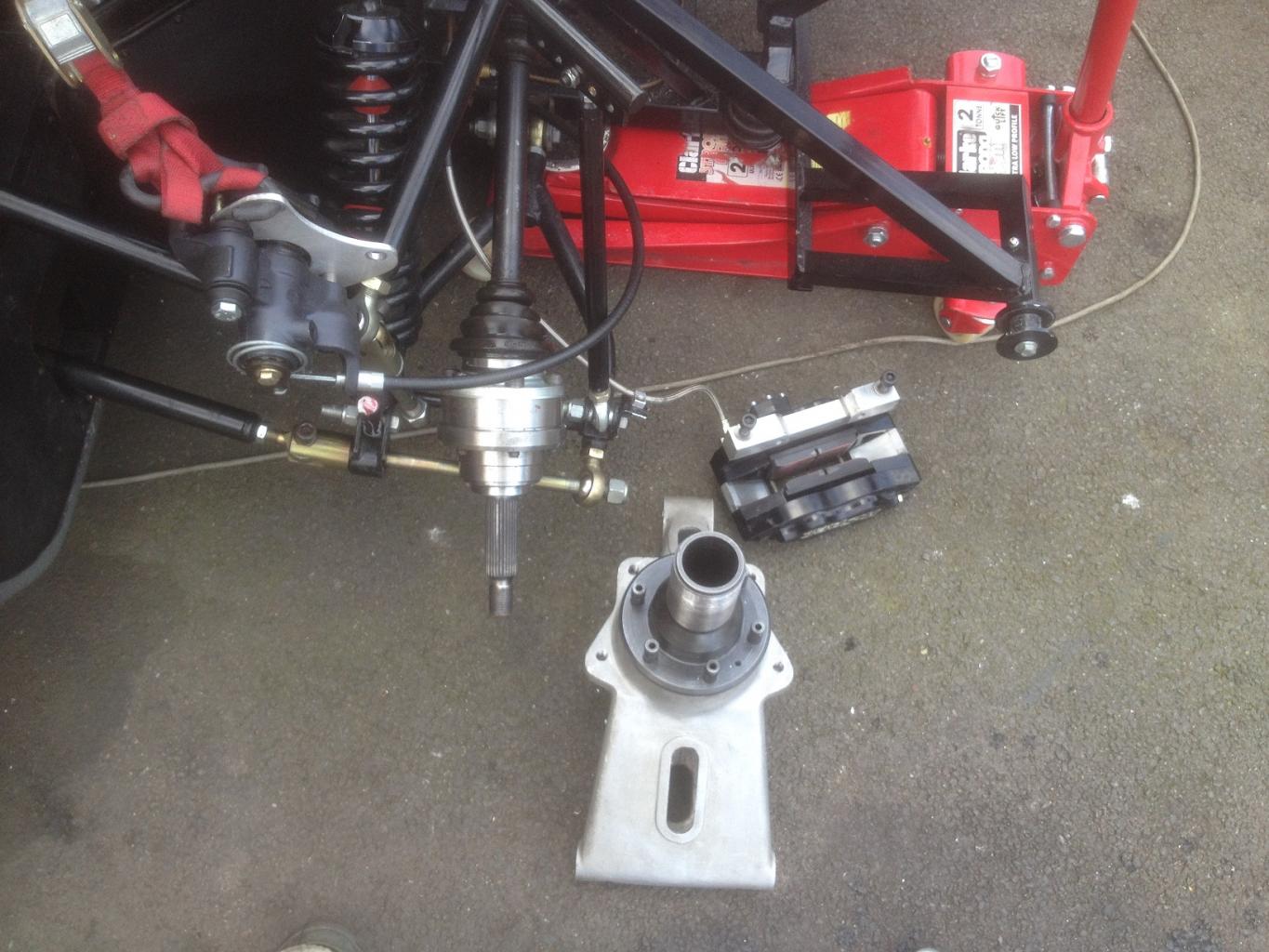

Well it's not the brake calliper as that came off with no problems, so that leaves gearbox or most likely with my limited knowledge the bearing seized.
They had a length of scaffold pole to try to get the half shaft nut off but it would not budge, hope they were turning it the right way.
So next step is to get the hub carrier, looks like with the half shaft attached back to SGT for an exchange.

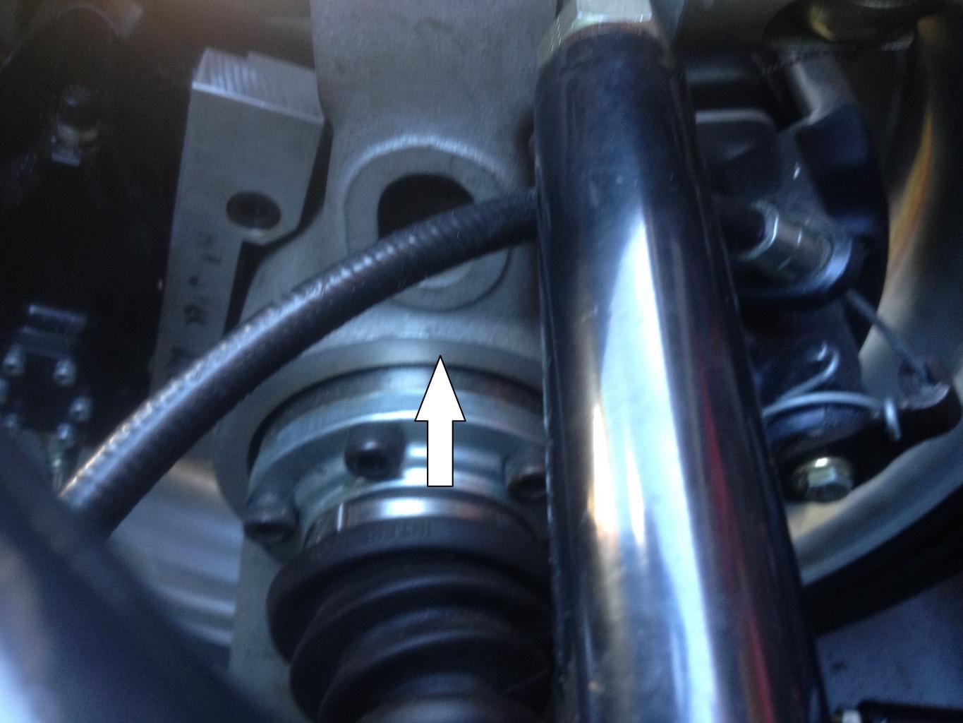

Mick at SGT solves the problem the thickness of the wall as shown on the arrow is to great and needs to be thinned down. How could this have happened I hear you cry, or not as the case may be.
Well thinking about it, I was the third owner of my chassis it had gone through 2 others without much being done. When I got it it went back to SGT to have the chassis drilled and altered for a Porsche G50 gearbox. I believe the original gearbox spec was for a Renault one.
As the uprights came with the chassis they to would have been for Renault splines bearings and halfshafts. These are not as wide as the Porsche ones so there can be more "meat" on the casting around them.
So Bob is not your auntie and the mystery is solved, as will soon be rectified. Don't know why everyone was panicking ;)

<FONT size=3>I think what Mick has offered is a plausible answer, but it doesn’t answer the question what happened when it was on the rolling road to cause it to lock up and why it was one side only? <?xml:namespace prefix = o ns = "urn:schemas-microsoft-com
P><FONT face=Calibri><P style=
Both hubs need stripping & rebuilding to gain confidence it won’t happen again. Another character building exercise!!<o:p></o:p>

Hi Andy the reason this happened was because there was no room for expansion between the outer diameter of the splined shaft and the alloy upright Both uprights are being machined to correct this and all parts will be checked and re assembled.
Regards Mick.
I had a very similar problem, self inflicted, when fitting one piece aluminium race wheels and full size AP brake calipers to a GT40. In the shop I had worked perfect clearances to get the maximum sizes inside the wheels, feeler guage checks showed everything cleared, looked good ! Until the driver had done just a few laps and complained that there was something rubbing in the hubs, 25 thou clearance is not .25 of an inch, and I had failed to appreciate just how much hot aluminium expands, particularly two adjacent parts growing together. Luckily a big file on the calipers solved the immediate problem, and I learnt yet another lesson . Frank

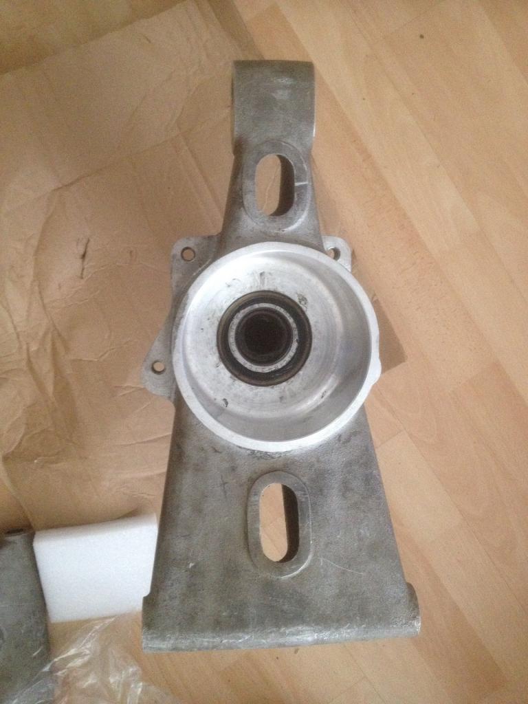

Machined parts received back from Mick and fitted. Now to try and sort out the intermittent backfire.
