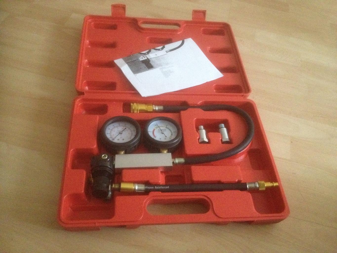

Mike Pass suggested an initial compression test, as that would show any valve not fully closing. Seemed good advice to me so I thought I would go fancy and buy a cheap leak down tester.
Got a bit suspicious of the readings the tester was giving as they all seemed good, so tried it on a cylinder with one of the valves fully open. It still gave a good reading so something with the tester or operator is not right.

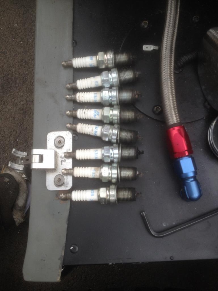

Also, cylinder 6 spark plug was very sooty, (it may show up in the picture 3rd from bottom), compared to the rest, have swapped it with 8 but had flattened the battery and my jump starter pack so unable to check today.

Can I assume you were holding throttle wide open while doing compression test?
re the leakdown tester, to get good ( low % leakdown) readings on % gauge with an open cyl something must be blocked between % gauge and spark plug adaptor. There is a restrictor between the two gauges and the % reading is of the amount of air flowing thru that restrictor, Approx 0.060" dia IIRC in an automotive application. Obviously its easier to relate % wise if you use a 100psi regulated air supply.
Quick check, with plug adaptor in open air clamp the flex line from tester to plug adaptor with pliers, reading should go from 100% to 0% as you clamp it.
Quick check, with plug adaptor in open air clamp the flex line from tester to plug adapter with pliers, reading should go from 100% to 0% as you clamp it.
Instructions recommend 45 to 100psi I had the compressor at around 60 but it has seen better days. Will try the clamp test.

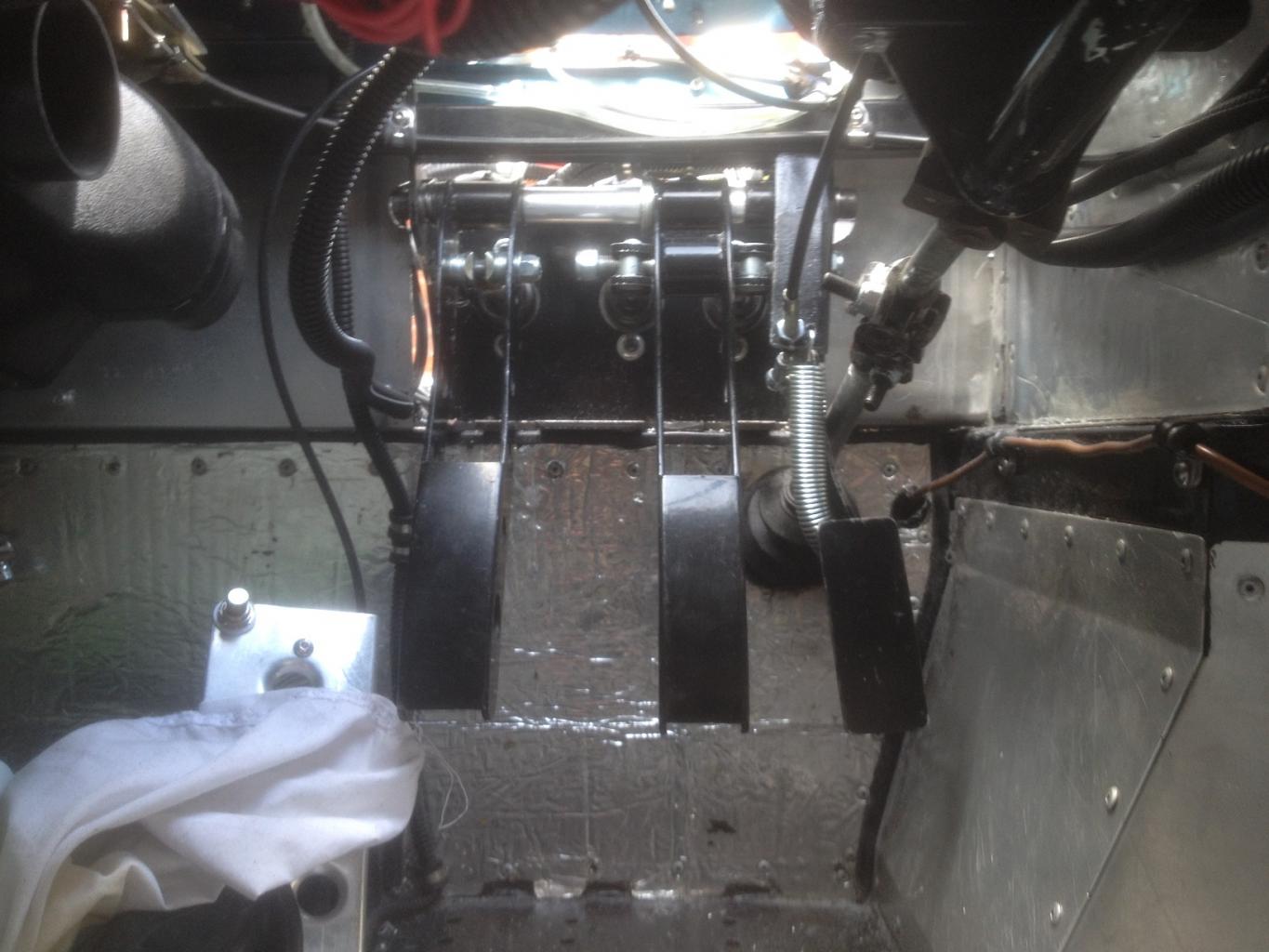

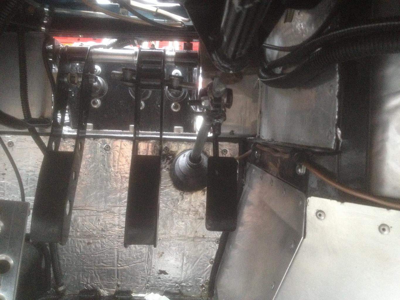

It turned out the flexing observed on the rolling road I discovered was due to play in the accelerator pedal bush.
https://www.youtube.com/watch?v=A78mEFWPDzg
A quick call to SGT and Mick said send it back and we will have a look. Pedals came back with a new improved accelerator pedal upgrade (picture one old pedal 2 new pedal).
Amazingly, even though I bought the pedal box many years ago, unlike other companies no charge from Mick for the work or upgrade.

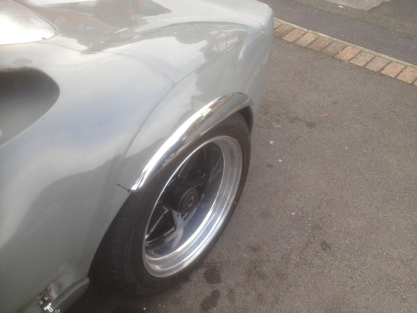

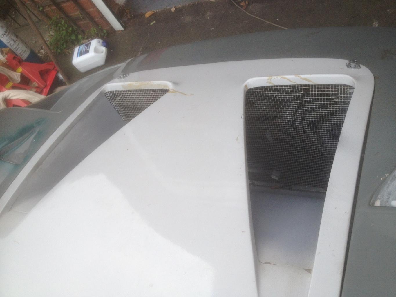

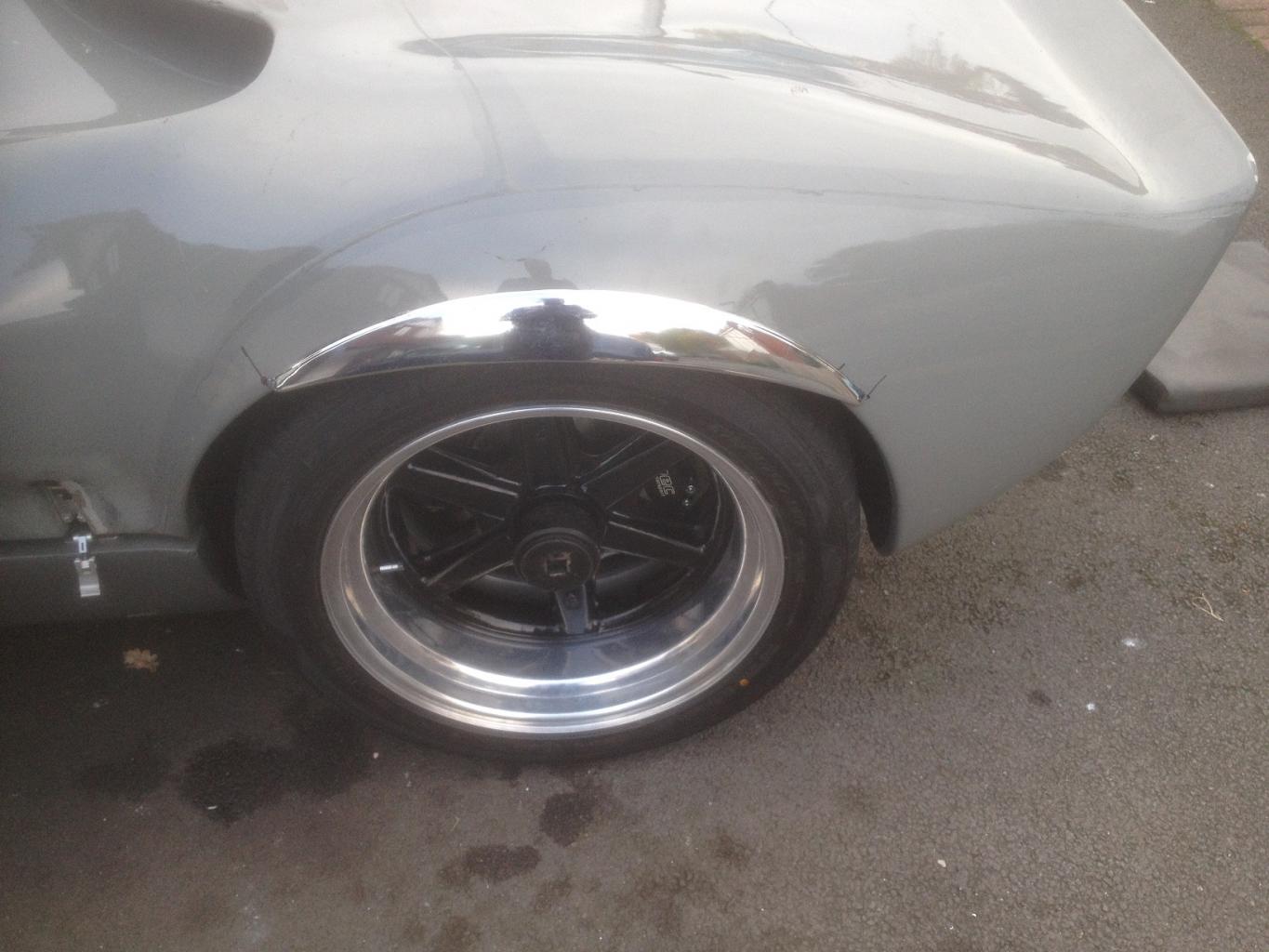

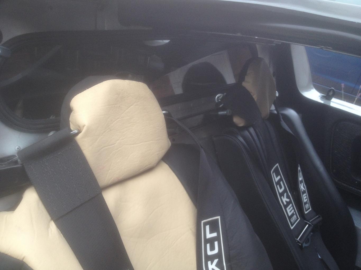

Other pictures show more IVA stuff, mesh over apertures, wheel arch extensions and headrests added.

Hi Nick,
Those are seriously bling rear arch extensions, can’t wait to see them on the finished car :laugh: :laugh:<?xml:namespace prefix = o ns = "urn:schemas-microsoft-com<img src=" /><o:p></o:p>
Can’t be far of going for it’s IVA, have you got a date yet?<o:p></o:p>

I was hoping August 2016 then, October 2016, then December 2016 so maybe early 2017 :)

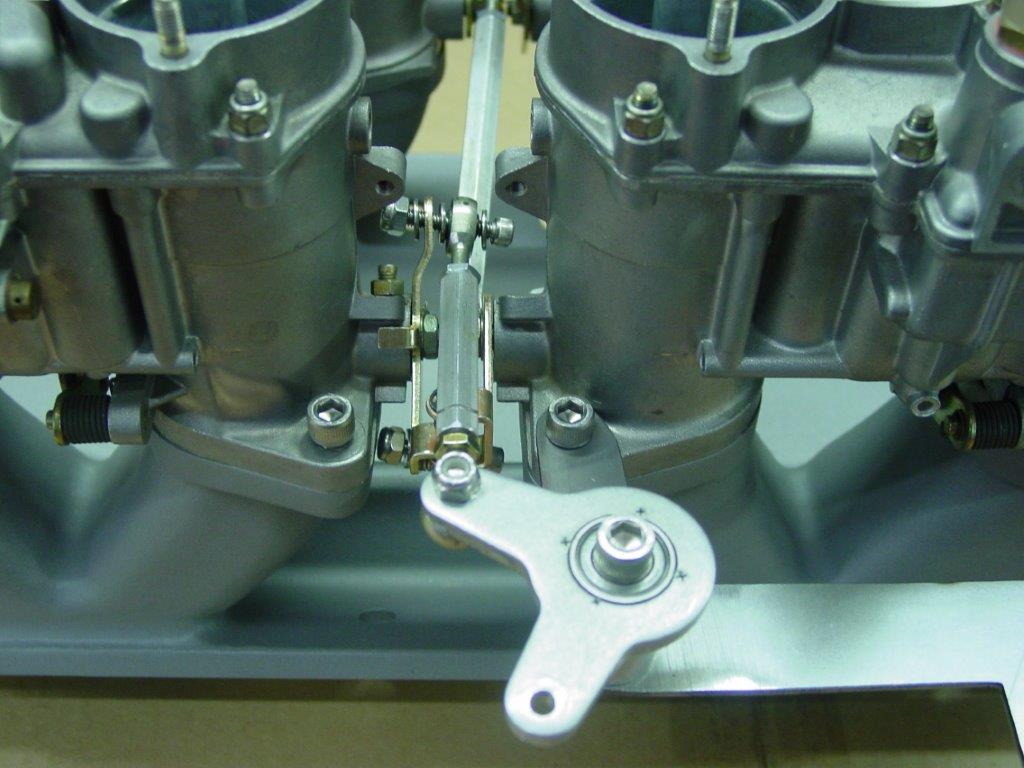

Well it has been a couple of trying months. As pointed out by Ric Wood Motorsport, my throttle cable was very stiff. I looked at my bell crank which was in the middle of the stacks and noticed the actuating bar was not straight so drilled another hole for the crank stand still no joy.
My carbs came assembled but with the old paperwork was an assembly CD with a section on the throttle / crank setup. This showed the bell crank on the outside of the throttles so I quickly cobbled up an assembly, like the one in the picture.
The throttle was lighter but still too stiff. I took the throttle cable off and realised it was binding so replaced it with my first throttle cable. Hey presto light throttle cable and pedal.

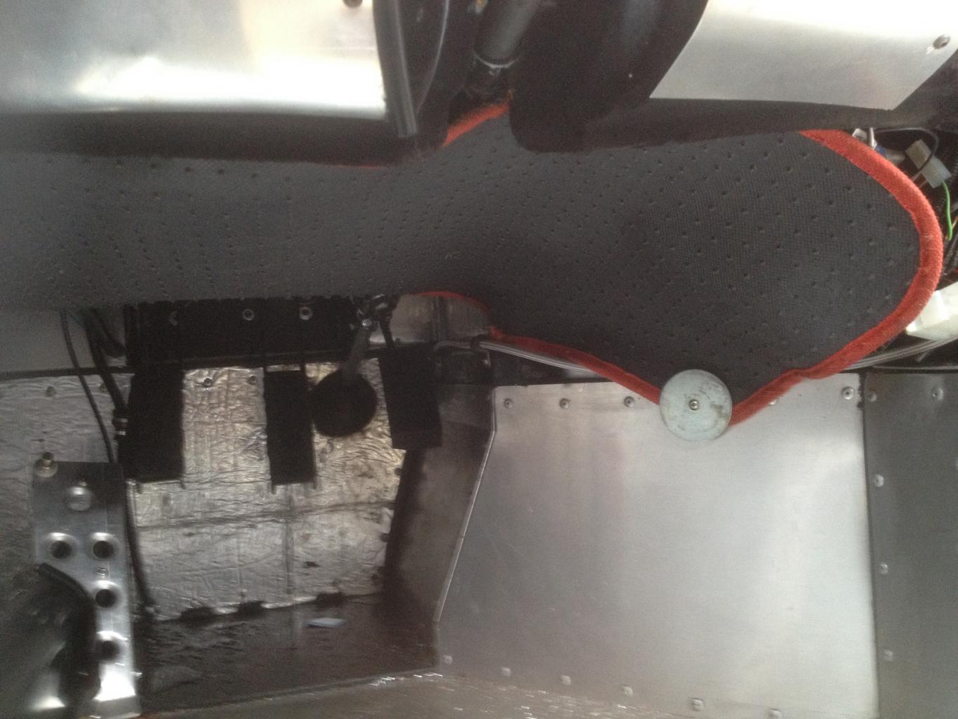

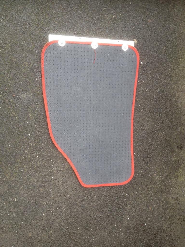

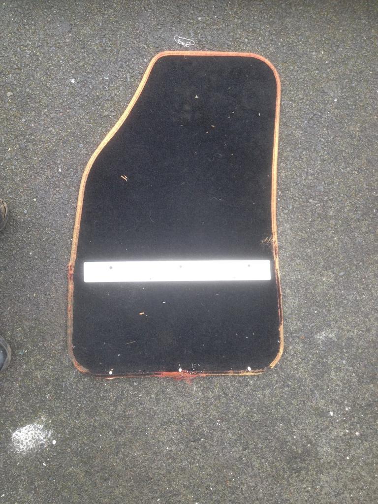

Speaking to Mick at SGT about what needs covering interior wise for IVA compliance, one of the thing he said they like to see dashboard wiring covered, as they can look behind the dash.
Luckily I had bought my wife some new genuine Ford Fiesta mats for her valentines present so pressed her old ones into service.
I think once it is through IVA I will look at sorting out a more bespoke solution as I think it looks good.

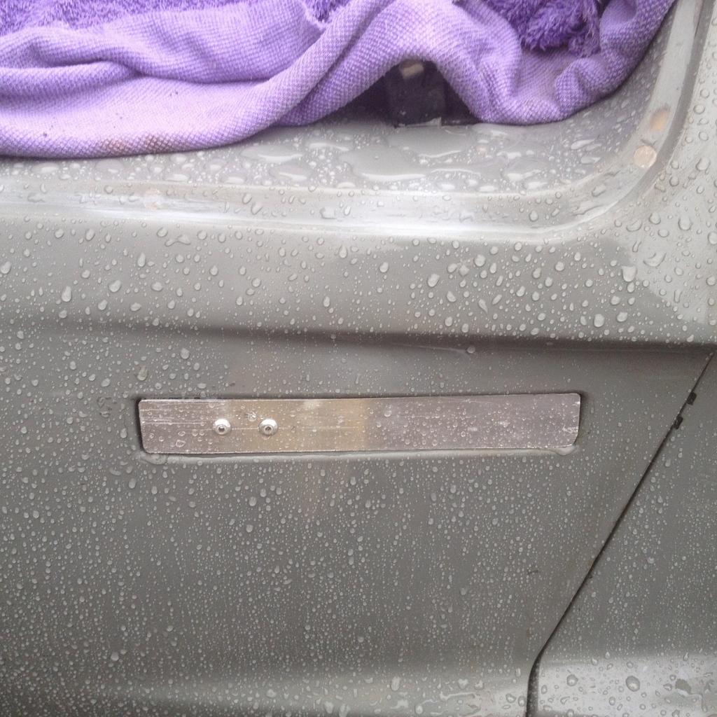

Also made some door handle aperture covers before rain stopped play :-(

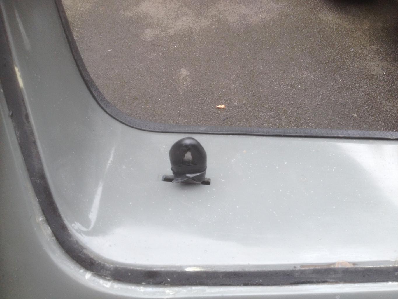

Thanks to Dan Winkworth I have put right a couple of issues put right at the eleventh hour before my IVA test.
I did have a cover trim on my inner door handle, but Dan's 3d printer produce a much nicer solution. Dan also mentioned that his IVA tester did not like fully threaded bolts through the brake cable eyes and the compensator bar.
