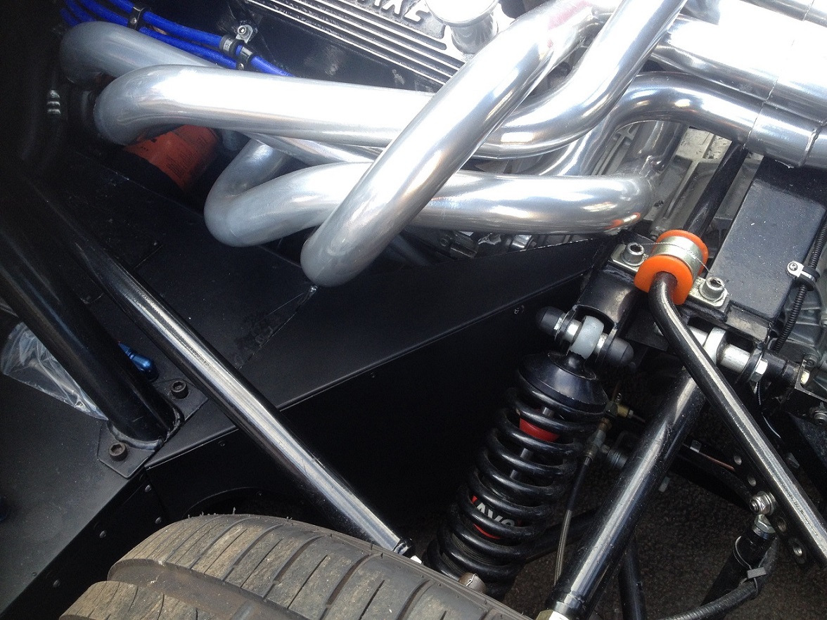

Slow progress with a few things at the moment. My car came to me third hand with only a few panels having been riveted on by the first owner, it’s only take me 10 years to get the rest done. Inevitably some panels had gone missing, namely the triangular ones at the rear to make the chassis more monocoque like in its appearance. Mick at Southern GT supplied the required missing parts at a very reason able free of charge rate. So it was out with my DIY powder coater, few blemishes in the finish but that just adds to the patina ;)

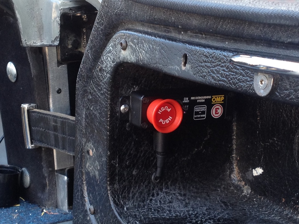

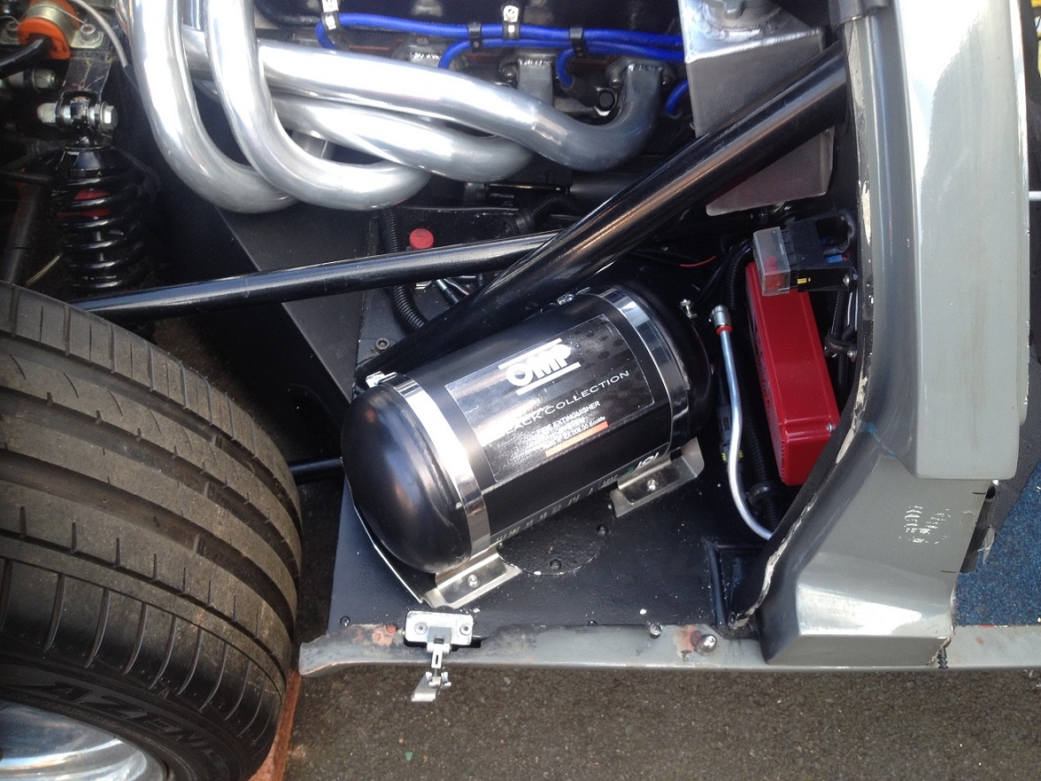

Also fitted the fire extinguisher, after a very interesting conversation with Frank Catt about fire extinguishers and cars, it is a bit of a white elephant but its looks please a little mind like mine. Feeding the wire through the door, through the access panel to seal off the fuel lines required for IVA and past the wiring loom proved problematical , but with the help of a wire coat hanger it was achieved.

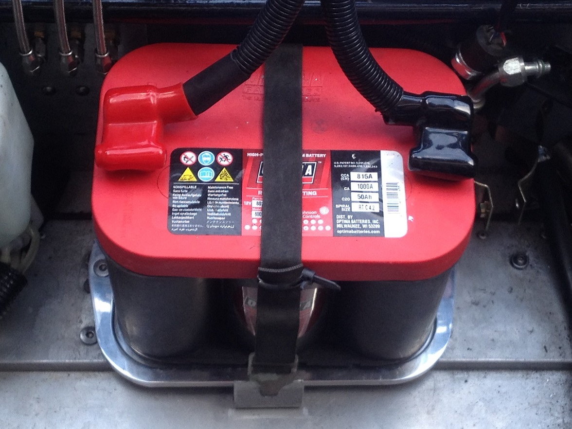

Also, having some starting issues so decided on advice to fit a larger battery, still have some starting issues ho hum :(

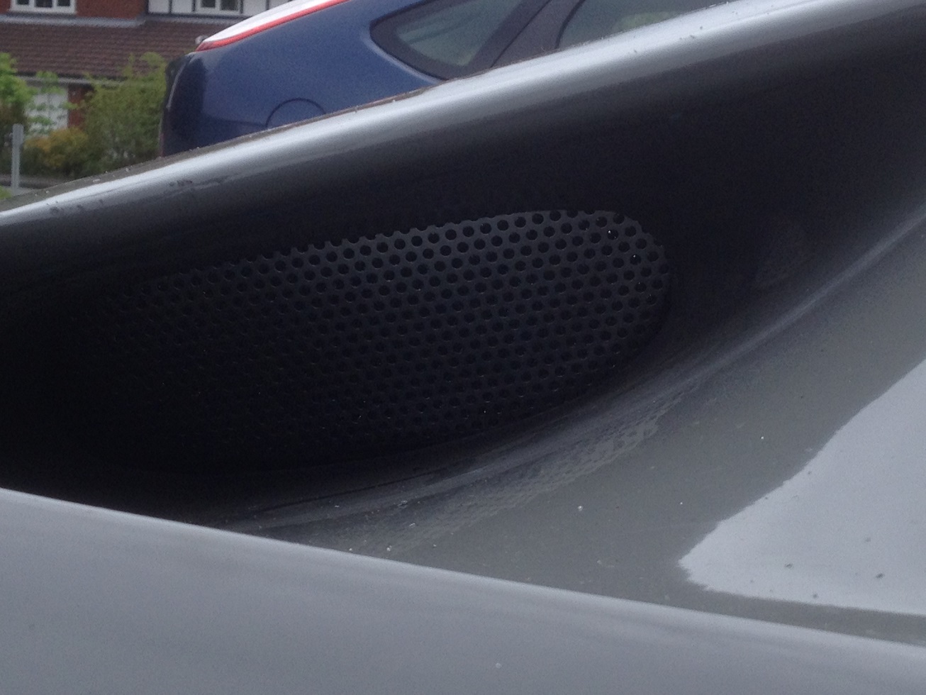

they look brilliant Nick m8 .. where did you get the pop out window edging ?
Thanks Jonny, although I can look brilliant from a distance (great distance and if you squint) :) I was dreading someone asking me as I looked at so many seals sites. I will try and track it down may take a few days as it GT40 club meeting tonight, then work until Monday morning :(

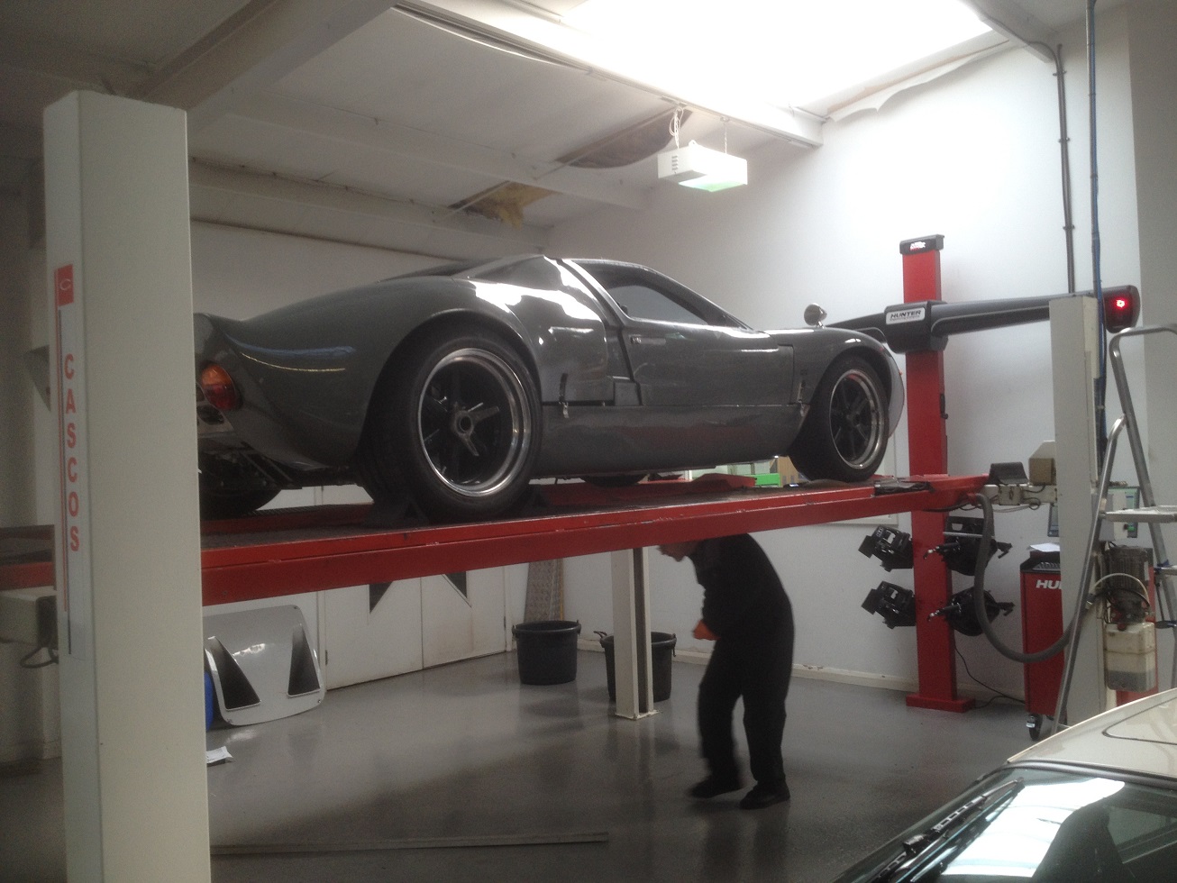

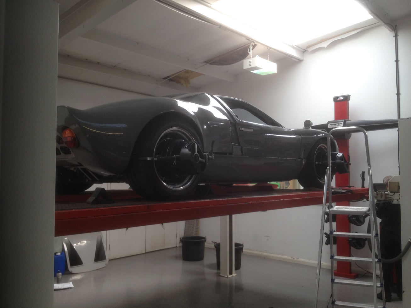

Took the 40 to our local independent Porsche garage today to get the GEO and ride height set up by Robert. Took a bit of time as being an early Southern GT (chassis NO6), some adjustments have to be made by removing wishbone bolts, then winding the rose joints in and out. SGT improved the wishbones, fairly early on in production, so that they can be adjusted in situ without having to remove the bolts.
Although GT40’s are because Porsche are for girls ;) they did have a very nice 2.7 RS Carrera replica for sale at an eye watering £125,000. The staff had to push the car in as I have a bit of an occasional starting issue at present. Interestingly to me, despite this and being surrounded by some very expensive machinery they were working on, they all came out to hear me start the car and watch it drive off.
Think Robert got a sneaky measurement in when I wasn't looking as he gleefully told me I have a GT 38 and a 1/2 :)

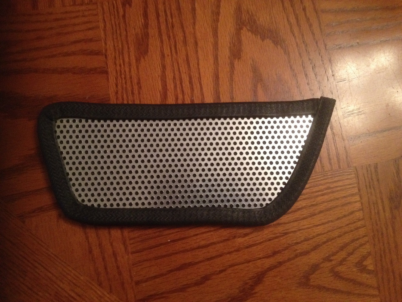

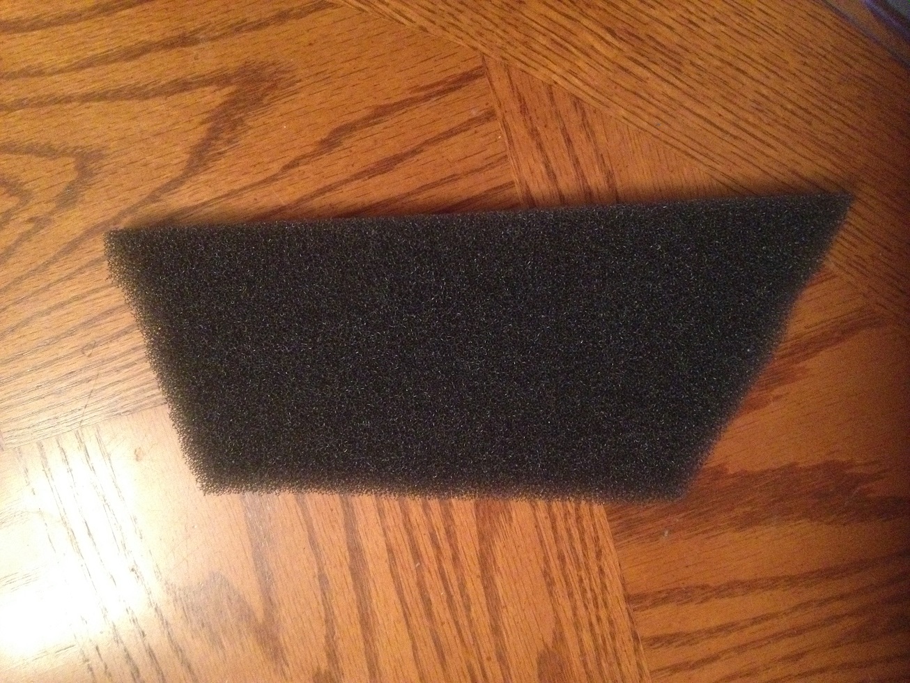

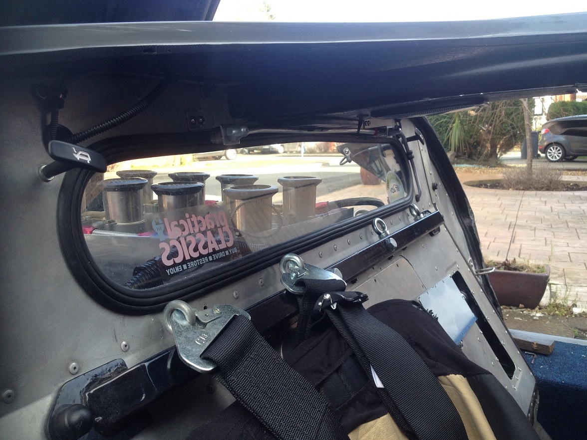

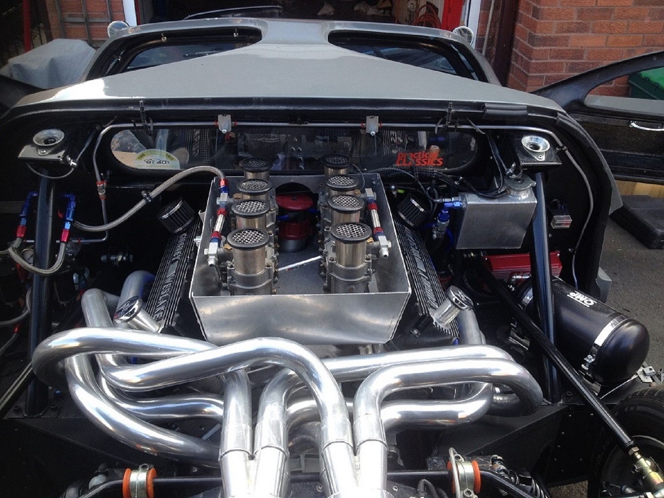

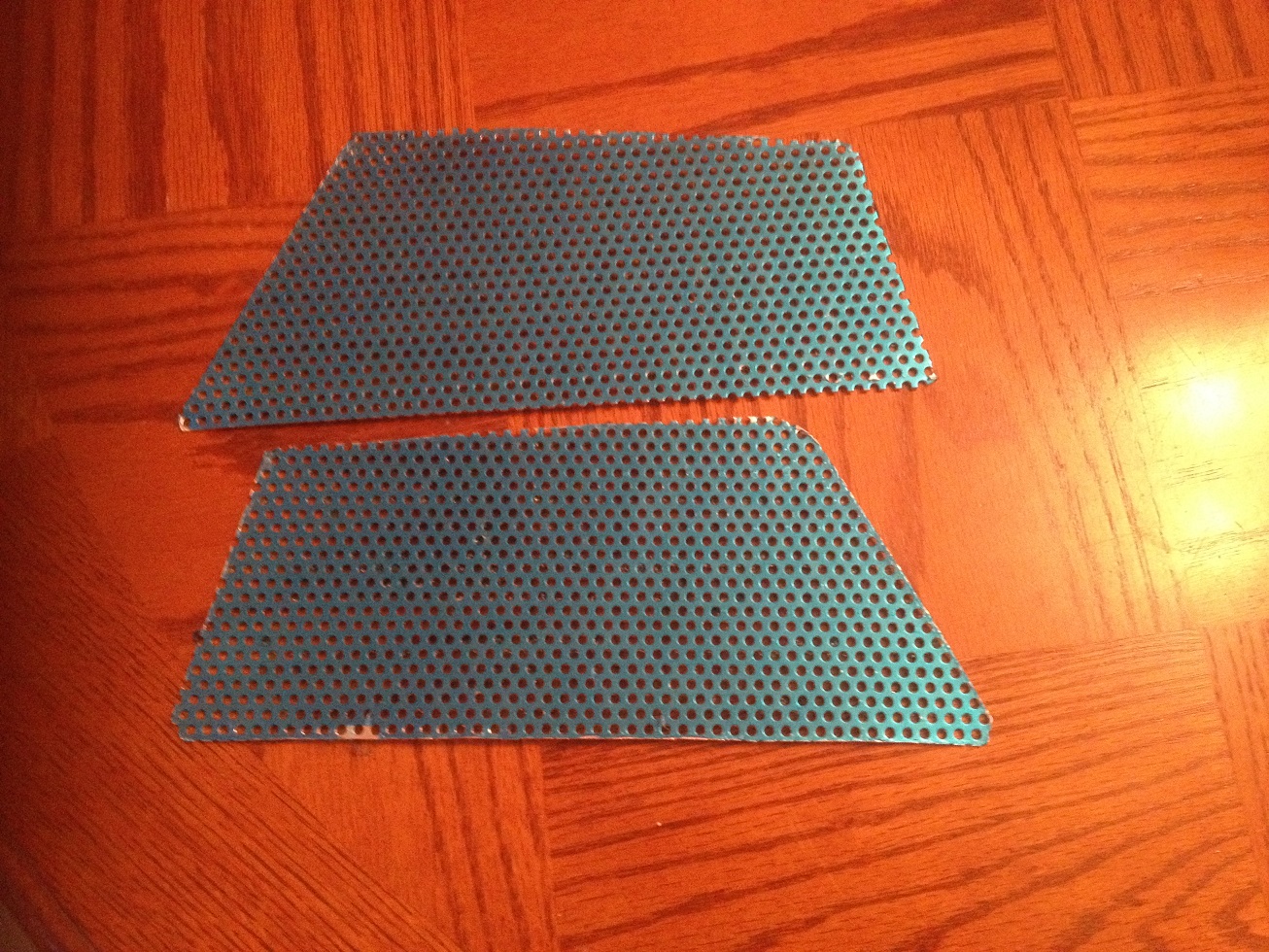

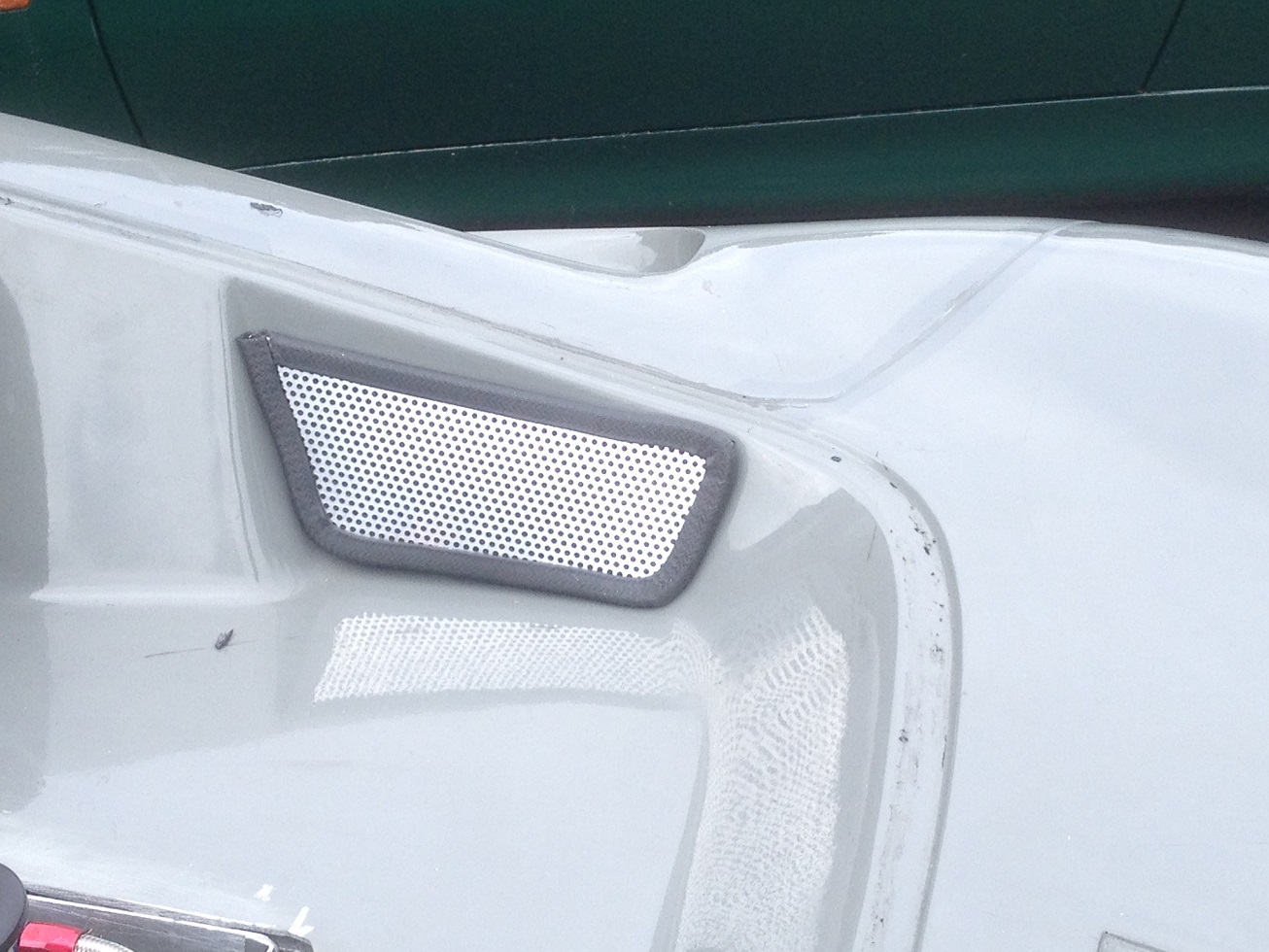

The general consensus of opinion from the weber IDA tuners I have spoken to was to "take off my stack screen filters and sling them as far as I can". With running without stack filters in mind I thought it best to make up a rear clip filter so shamelessly stole an idea from Chuck and Ryan's RCR Build.
