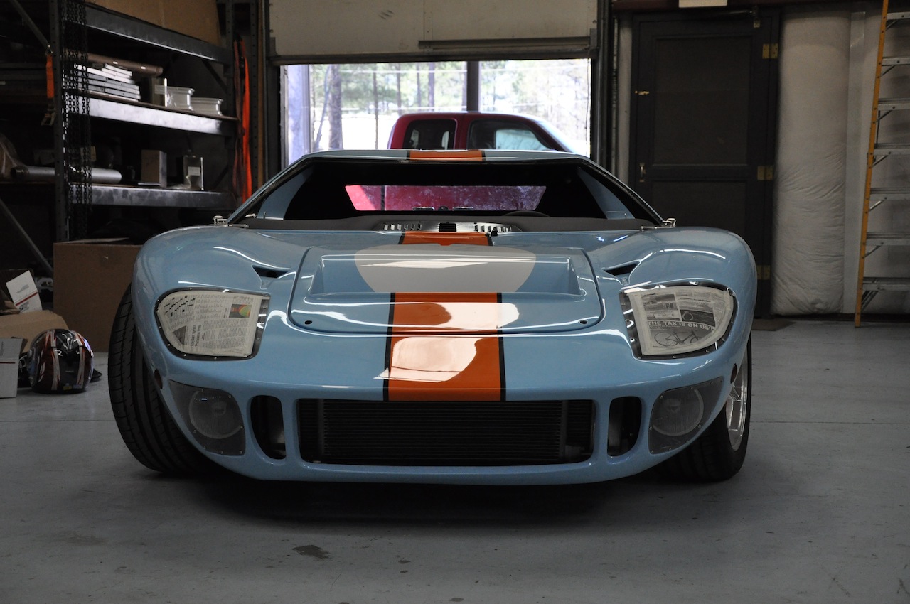

A possible way to re-do the driving lights would be to form an aluminum panel that would cover the entire vertical space where the current light/signal is, then cut your hole for the larger driving light through both. That aluminum panel could be painted flat black and look very "right" as well as competition-correct..
Auto-Loc makes a 5-1/4" headlight with a turn signal bulb embedded in the bottom of the reflector. I think that's the current plan for mine. If I ever get to work on it again that is...
I've posed a pic of how I changed it. It'd be easier IMHO just to fiberglass the holes closed than fashion an aluminum cover. The issue with the aluminum cover is how tight the fit is.

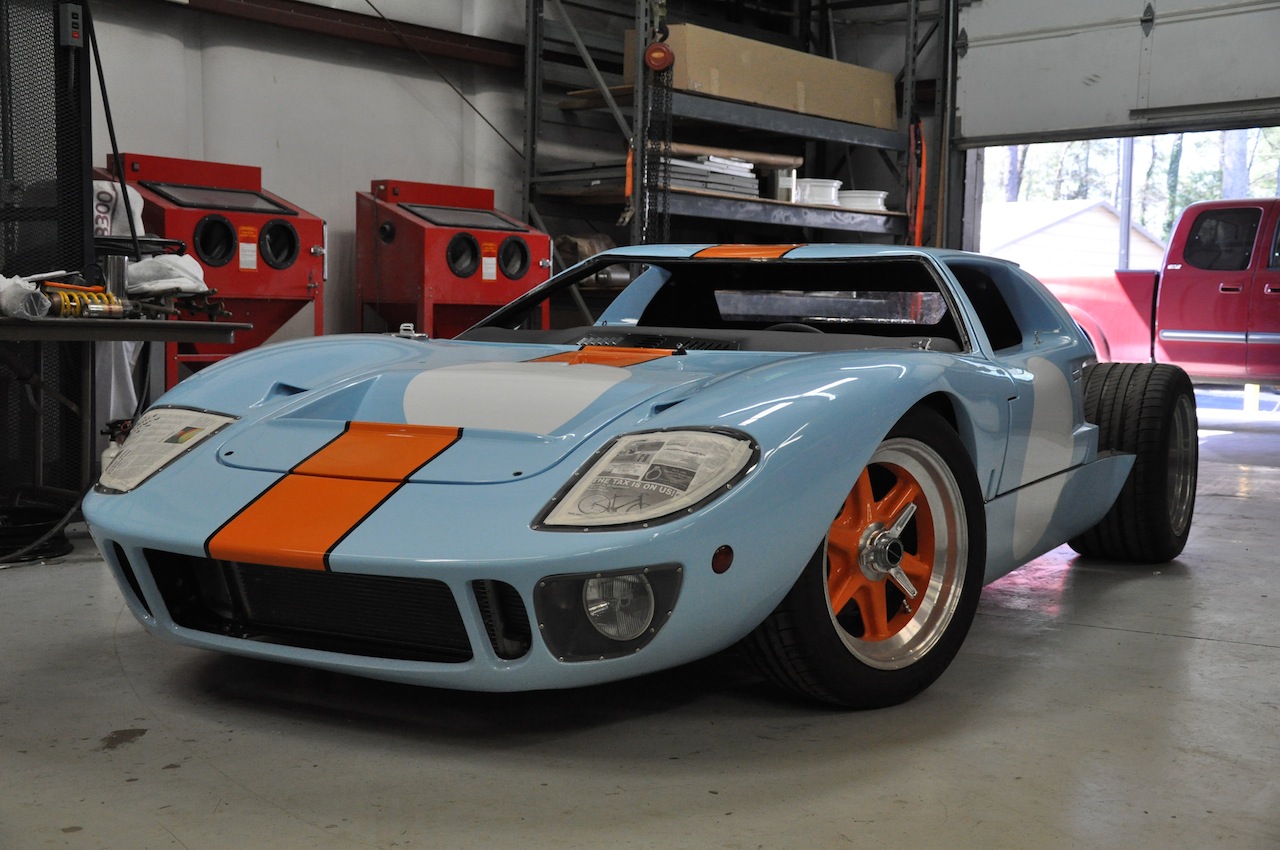

I LIKE IT! Would be very interested in more pix of fab/install, or perhaps text description. Direct my attention to the local of front turn signal lamps please - I must be blind.
Great Job. Thanks for sharing. Robert
Ron Scarboro
Dark circles between fog lamp and front wheel. You can see each in the far outside on this pic.
Robert S.
Front Turn Signal Light Mods
I did see those in your first group of photos, but at first blush assumed they were side-marker lights, as many manufactured cars are equipped with. I see in this photo that they would be visible by oncoming traffic. I guess they only appear to have red lenses because they are not well illuminated in the photo - so, I will assume they are amber or orange colored. Here in Kalifornia, those types of changes would likely cause the Highway Patrol to make an issue over them. But, I like what you achieved, and it was clever, functional, and does not compromise the style of the car. :thumbsup:

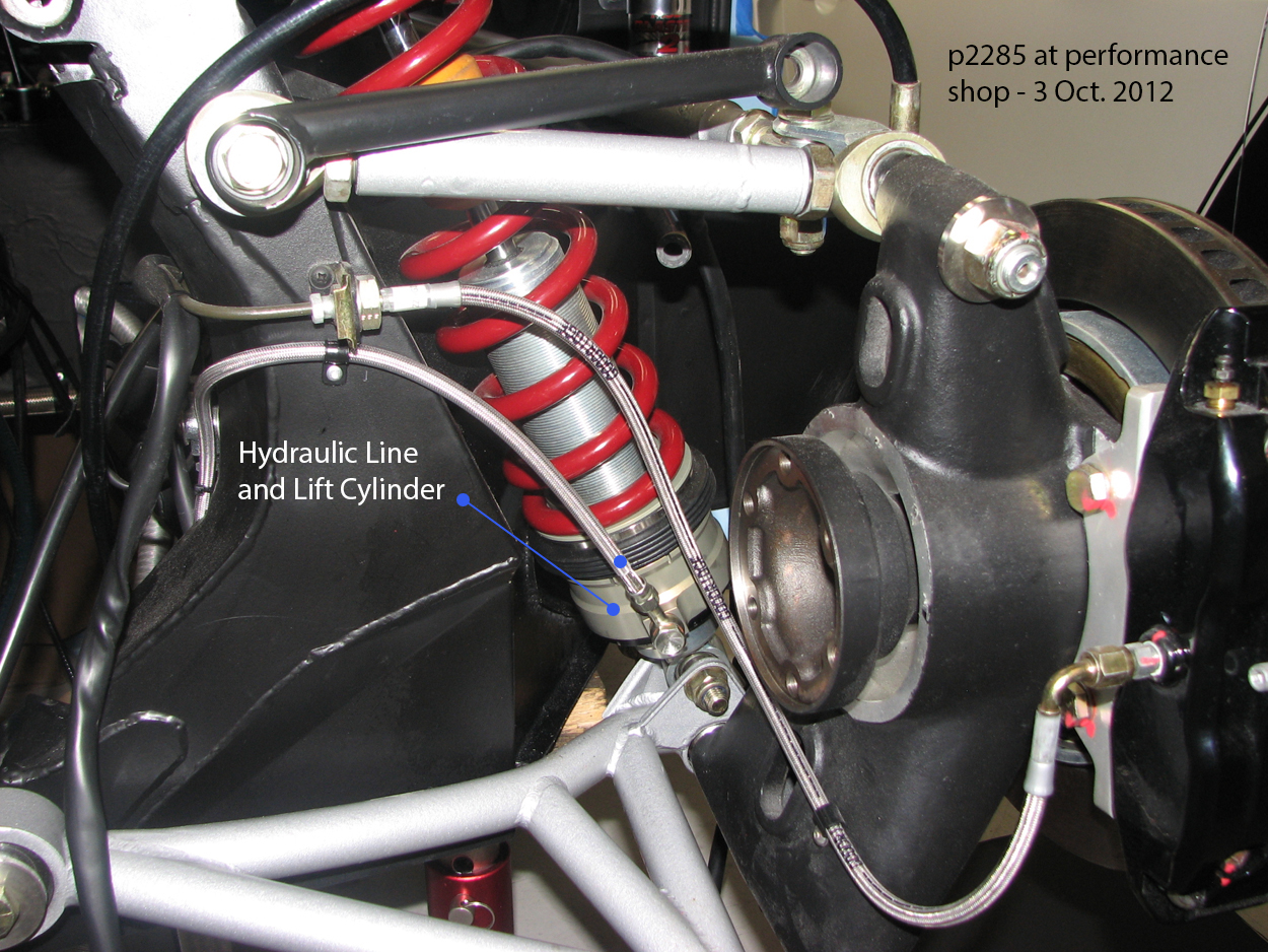

Are you making any mods to the brake/clutch reservoirs and plumbing? Do it now while the paint is still attached to the chassis...

I really like the idea of ram lift and will retro fit my car soon as I get a couple other projects out of the way. Looks like your doing it right before you put it on the road!
As for the debre chipping paint on the rear fenders I haven't had that problem but do have many road chips on the front past the 3M clear bra stuff. Also Rick made some trick little stops for the gas caps so they don't open all the way into the paint of the front bonnet which will chip the paint.
Thanks for the tip Michael. My mechanic originally mentioned a change to the brake fluid master, but not the lines. I'll suggest that to him per your recommendation. :thumbsup:

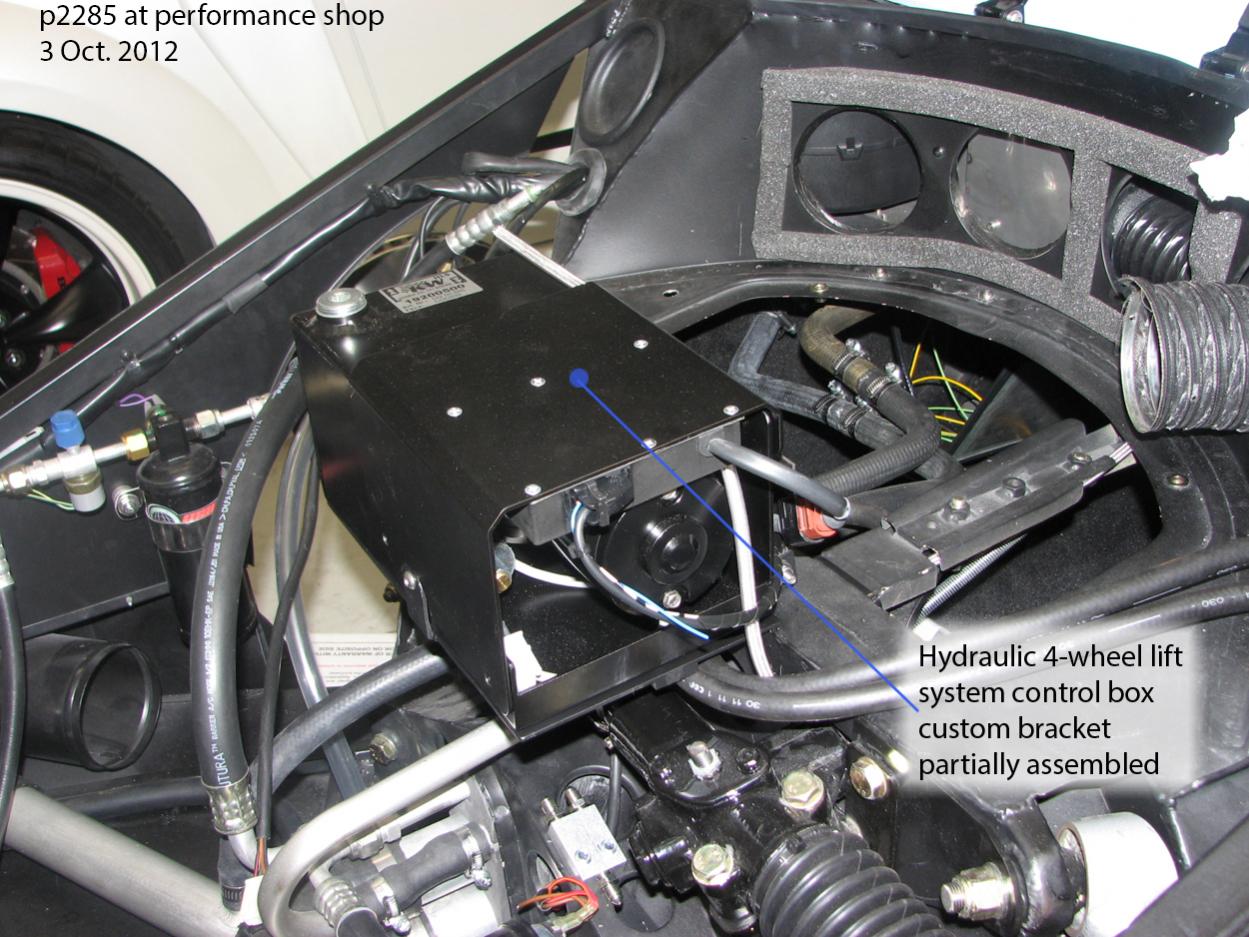

Thanks Jack. When I first questioned the folk at SPF concerning extra wide body they eMailed me a photo of yours. I made my mind up right then to have one. So, thanks for that.
RE: The lift system. I'm confident most have reasons for desiring such. My need is likely slightly different than the typical need to avoid undercarriage and front-end scraping. I'll have that benefit, but to a lesser degree. My main purpose was to be able to have a lower normal driving stance, especially for shows, and yet be able to avoid objects and navigating driveways too. I'm hopeful this device will work as advertised, and will remain duty bond to report on it.
As for the debri chipping paint on the rear fenders I haven't had that problem but do have many road chips on the front past the 3M clear bra stuff. Also Rick made some trick little stops for the gas caps so they don't open all the way into the paint of the front bonnet which will chip the paint.
