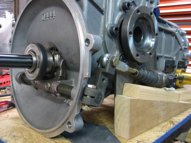

By the way your clutch parts are working out great. However if I had to do it again I would go with an internal one. Along time ago you posted picture of your slave cylinder setup on your CAV but it doesn’t show any “return” springs and I was surprised that the slave cylinder has an internal one that pushes out. Well anyway if you have a picture handy that shows the springs I would appreciate seeing one.

Hi Richard, your collectors should work.
A spring is not needed on the slave set up, when you adjust it push the piston all the way down into the slave, adjust the clevis so that you have about 1/8 inch of clearance off the clutch fingers.
The bearing that Mcleod supplies is a full run bearing, the clutch will push everything back and the bearing will sit against the fingers of clutch but that is ok.

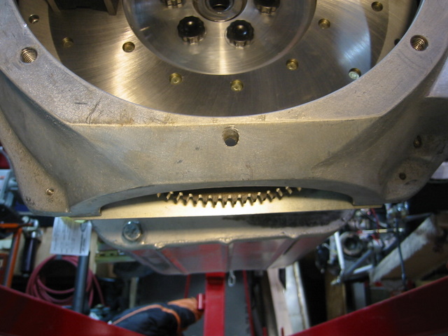

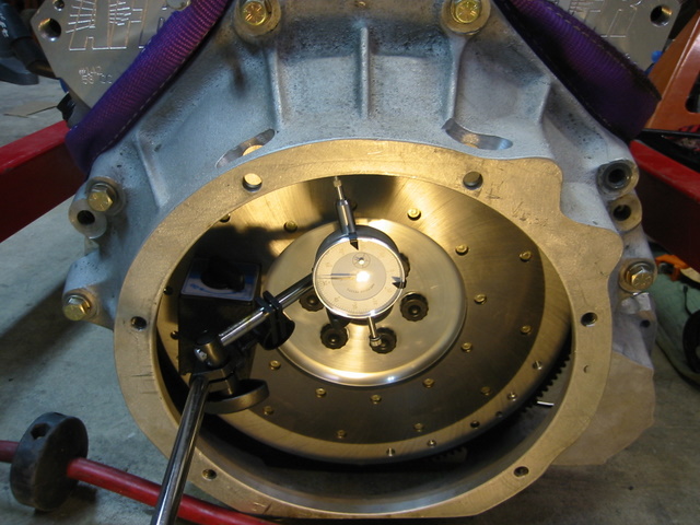

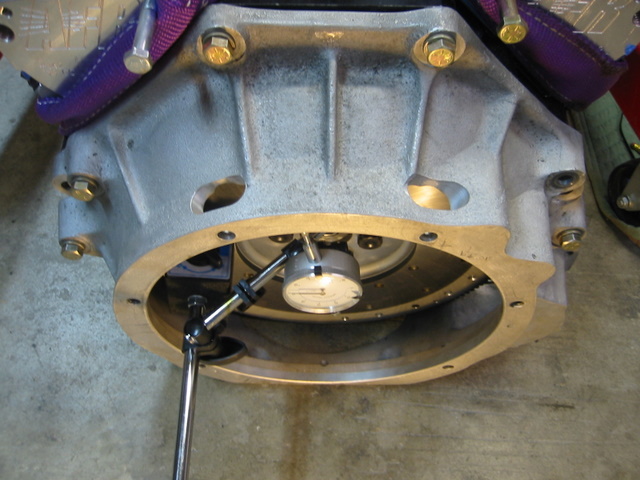

SPF says their trying to get the headers air shipped soon. Had to order offset pins today because the trans flange was .030 offset.
I've also done some additional machining on the bellhousing to work with the SPF GT40. Engine should go in this weekend to start wiring and plumbing but without the headers.
