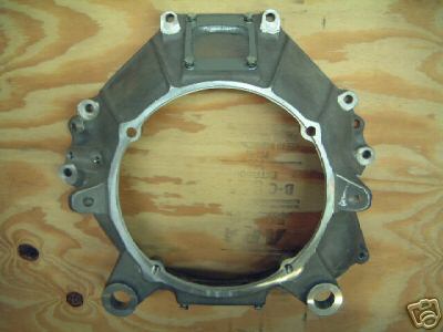

With my car, a SPF GT40 MKI about to arrive in the US on the Aug. 15th (in N.J. of all places) I'm starting to look in earnest at parts and I have some questions in think some of you can help me with. I worked with Lynn Miner installing his ZF and dropping the engine into the car. Is the lower cross member that goes under the transaxle any different on the SPF MKI’s than the MKII’s? The reason I'm asking is I have to pick a bellhousing and the one he had, had to have the lower part milled at a 45deg. angle to make fit (a Kennedy I think). I've been looking at a reproduction of the original bellhousing used on the GT40 MKI's and it has two big ears at the bottom rear that I assuming would have bolted to the lower cross member (see picture below). Would this old style bellhousing fit the SPF MKI? Can some one with a SPF GT40 MKI post some pictures of the crossmember taken from the engin side?
I also need to know if any one knows where I can get the cross shaft and parts to put in an external hydraulic clutch cylinder? Thanks for the help.

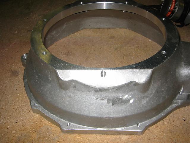

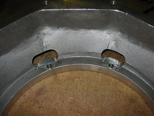

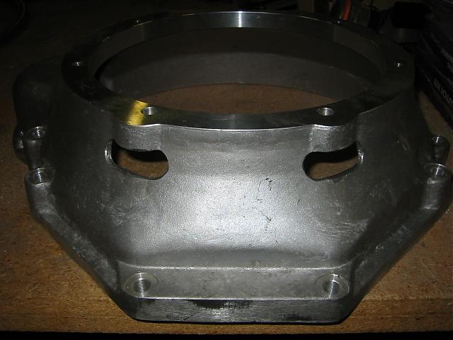

Some pictures of the Kennedy bellhousing.
Referencing the top photo in this thread--where exactly did this bellhousing come from? Unlike the Kennedy unit, it looks like a proper copy of the original. A small-diameter clutch and flywheel would also be necessary.
Source please?
Thanks!

I am Bob Wood of Safir GT40 Spares, the company that licenses the GT40 name and serial numbers to SPF. Congradulations on buying an SPF GT40! It will be a great car!
We supply original style bell housings with the ears to attach to the bottom cross member of your car. The SPF MkIs and the MkIIs are essentially the same. There might be some "clearencing" needed if one were to put a big block in rather than a small block.
We sell a package of a twin disc clutch, small flywheel and ring gear, and bell housing which requires no machining to make it fit. If an SFP GT40 is fitted with a 157 tooth flywheel and the Kennedy/ERA/etc. bell housing, the bell housing and flywheel/ring gear will hang below the bottom cross member by 1"-1.5". The bell housing will be the lowest part of the car, and any road kill larger than a snake will be collected by the hang-down. Any bottoming of the car will be the bell housing.
Our package is genuine GT40 and, we believe (of course)the only one to use.
