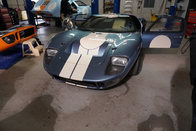

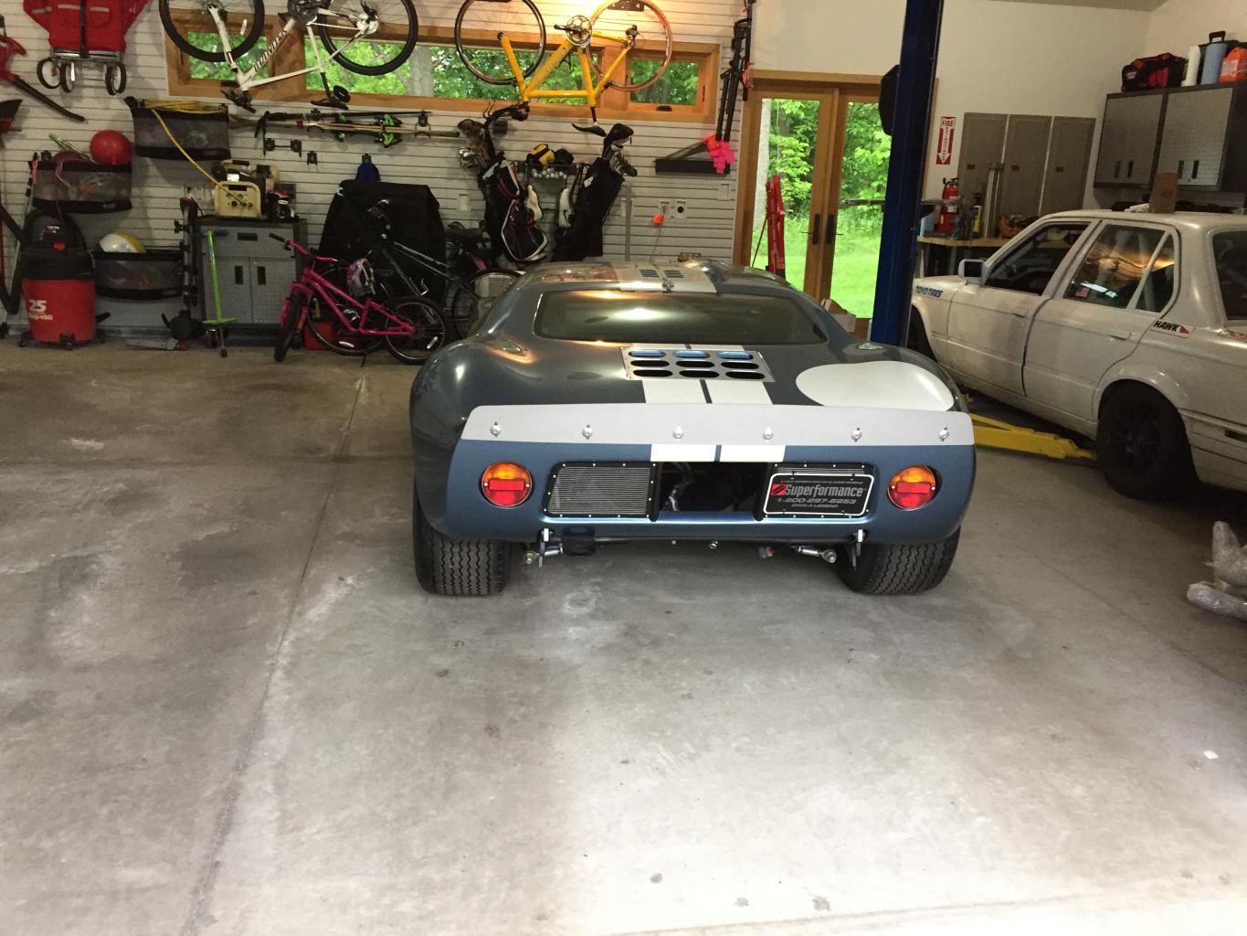

Home at last.....

Wow Steve.... Gorgeous!!!!!
I'd love a ride some day!

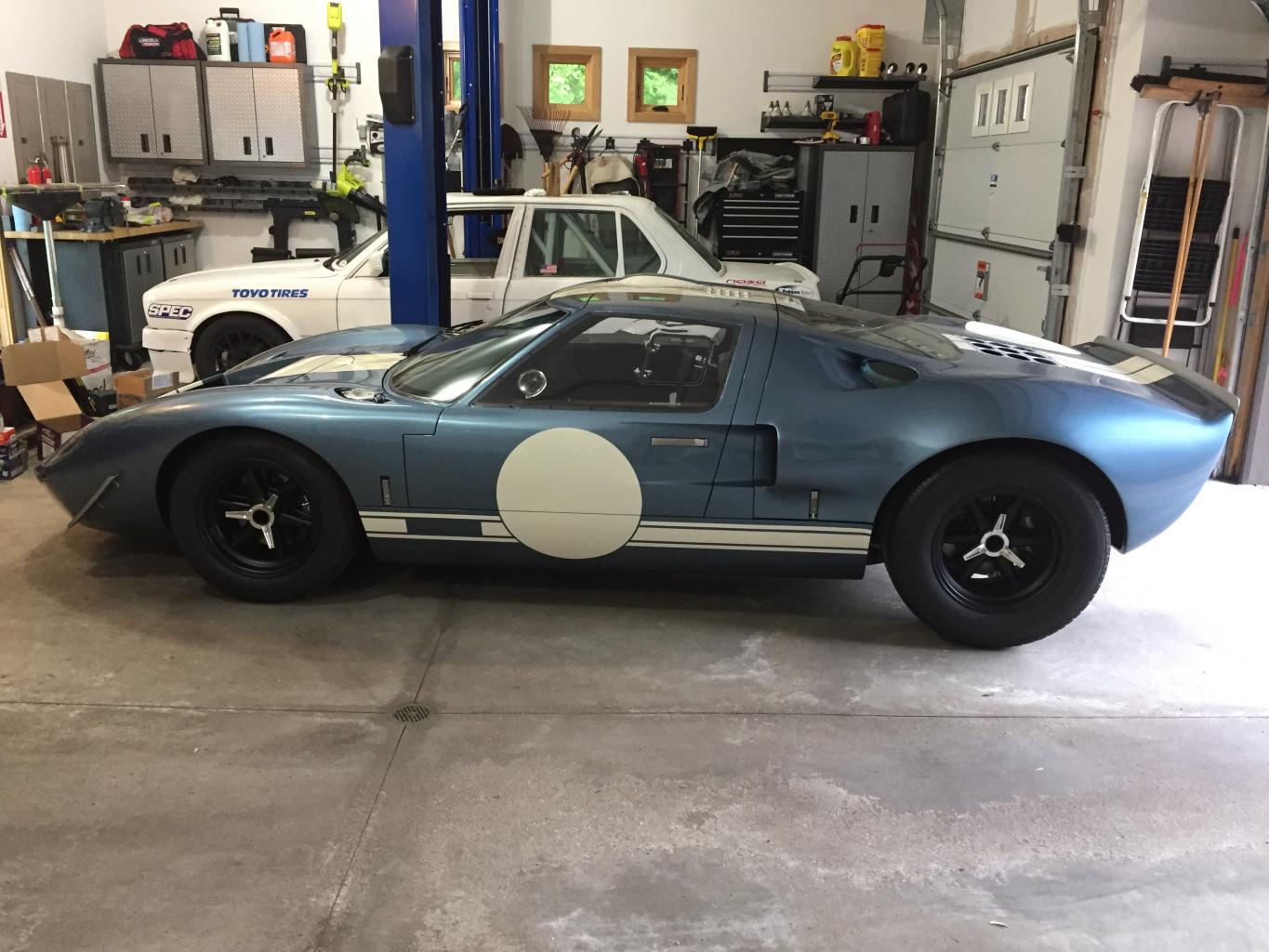

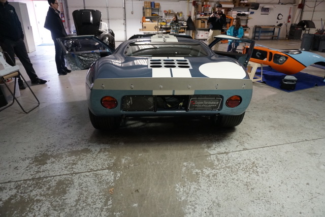

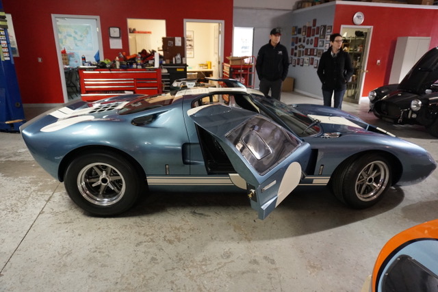

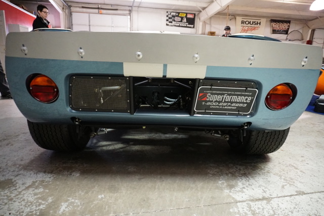

Lee, here's a few more
Steve
Re: p2348
Here's a few more

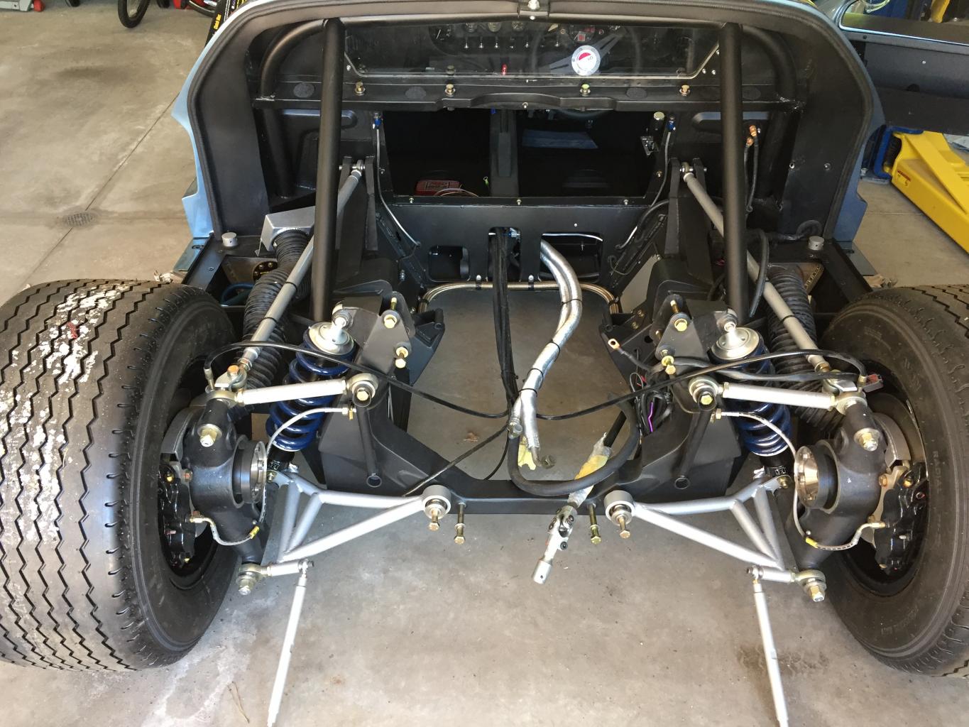

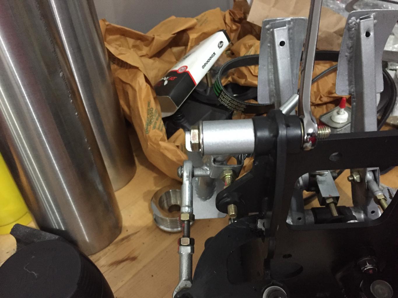

Will post more pictures in the next week or so. Right now, everything is taken apart. So far I'm:
1. Changing out a front coolant pipe for one with a petcock to make it easier to drain the coolant system. Yeah, I know, the shopvac method works great but I can't pack it in the trunk for when I'm not at home.
2. Changing out Wilwoods for Tiltons. I really don't want to deal with a leak so better now than later. I'm capping off the Girling reservoirs and will just leave them in.

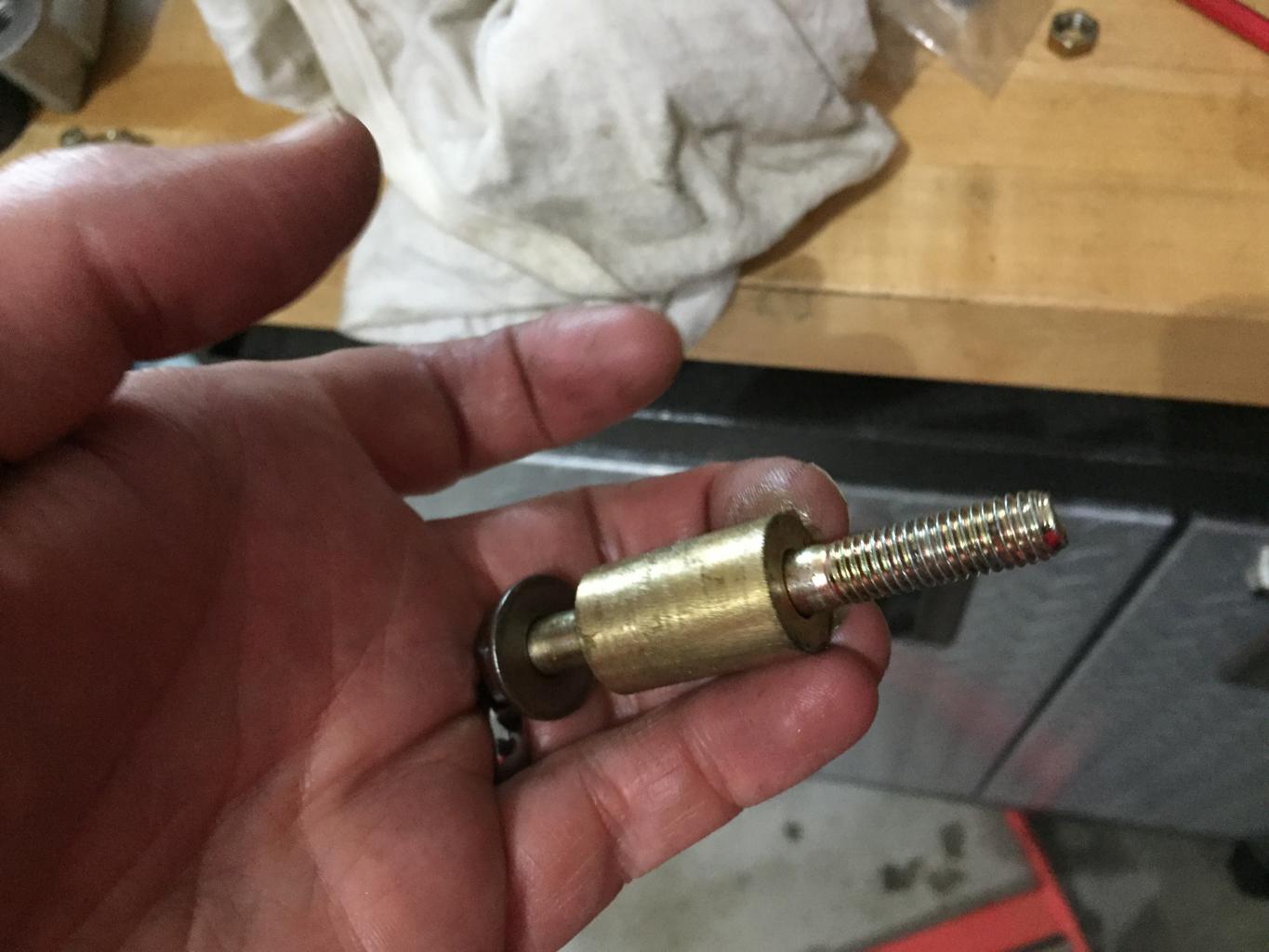

3. Changing out the bushing for the gas pedal. It's a simple brass bushing with grease on it. I agree with Mike, looks amateurish. Can't argue with how well it's worked for so many but I also wonder how many people experience a little sticking here and there. I'm having the LuftKraft boys fashion a sealed bearing version.

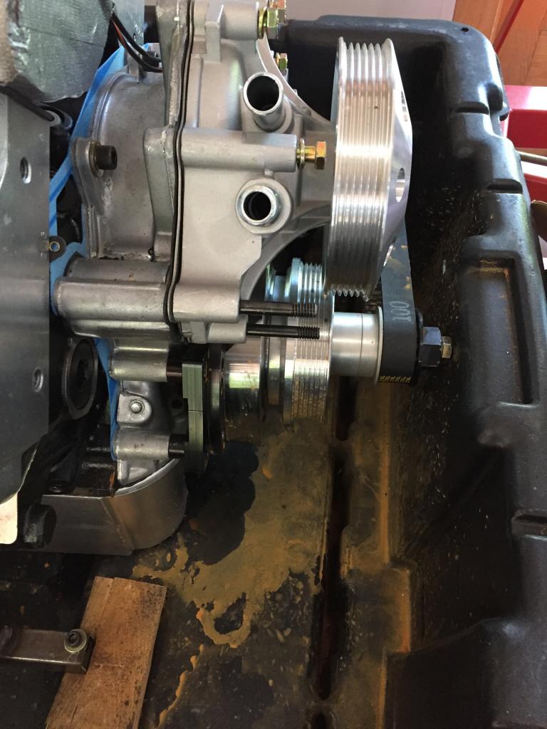

Still waiting for a few items from Olthoff. The front dress kit isn't quite right. I'm not sure why the water pump pulley and the crank pulley aren't lining up. I'm pretty sure I have the short water pump so I don't think that's it. Also, missing a bracket from the water pump to the dry sump bracket.
Interested in some ideas/viewpoints:
1. I'm planning to mount the MSD on the back of the panel behind the drivers seat. Anyone have any pictures of this? a little concerned about the lack of airflow in the battery box and the brake ducts prevent mounting on top of the box. Any special shielding needed for the wiring to the coil/distributor?

Re: p2348
Steve, I don't think mine even had the brass bushing. It just flopped around on the bolt. Lots of slop. Regarding the MSD box, I swapped out my MSD for a Pertronix. Everything is built into the distributor. No box to mount or mess with.
Re: p2348
I've seen MSD boxes perform just fine when mounted in gloveboxes. You should be fine as long as you have isolation monts (vibration) and ground connections.
Steve
Re: p2348
Any thoughts on mounting in the battery box? I'm using a Braille battery and there would be adequate space. I know Terry has done this, seemingly without any issues. The access would be far better than behind the seat, although the air circulation wouldn't be as good. Not sure that really matters at all.
Tim Kay
Re: p2348
are you opposed to mounting battery in the passenger foot well? No particular issues in my car other than immediate access.
