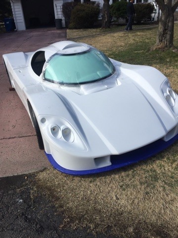

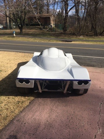

Hello fellow current and future SLC owners. My name is Stephan and I just received the majority of my 2017 white SLC on Sunday, February 25th. Graziano, flywheel and Infinity box still to come due to backorders... I am in the Yardley, PA area wanted to introduce myself. I am certain I will bug the living daylight out of this forum with a million questions along the way...
A brief intro about the car
LS setup for Graziano
Carbon tub, carbon wing & splitter. Carbon seats and door covers, dash and front splitter. 12" x 20" in the rear with 335-25-20 Pilot Sport Cup 2, 10" x 19" in the front with 285-35-19 Pilot Sport Cup 2.
I already purchased the Bosch starter for the Graziano on Amazon for amazing $179.00 new with no core charge and no shipping The ring gear was $147.00. The clutch was an interesting find. I decided to use a dual friction clutch with Ceramic and Kevlar facings based on the Lambo V10 pressure plate. Good for a lots of torque and HP. The price was acceptable considered that some companies asked me for my 401K.
I'll be back with some pictures soon...
