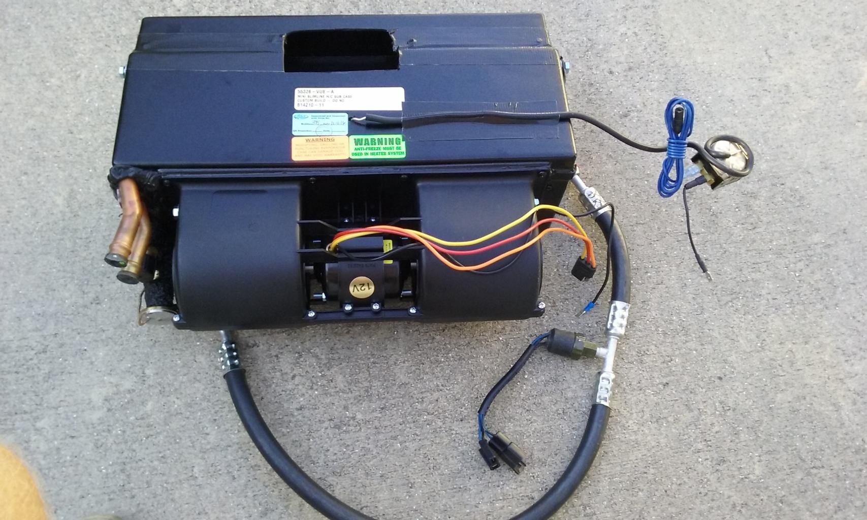

SLC AC fitment

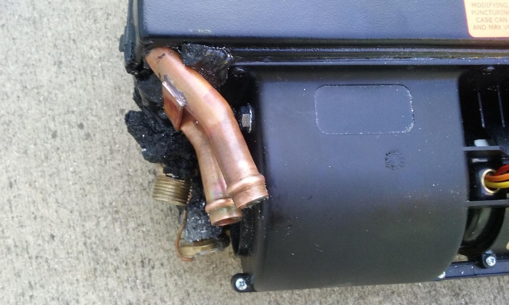

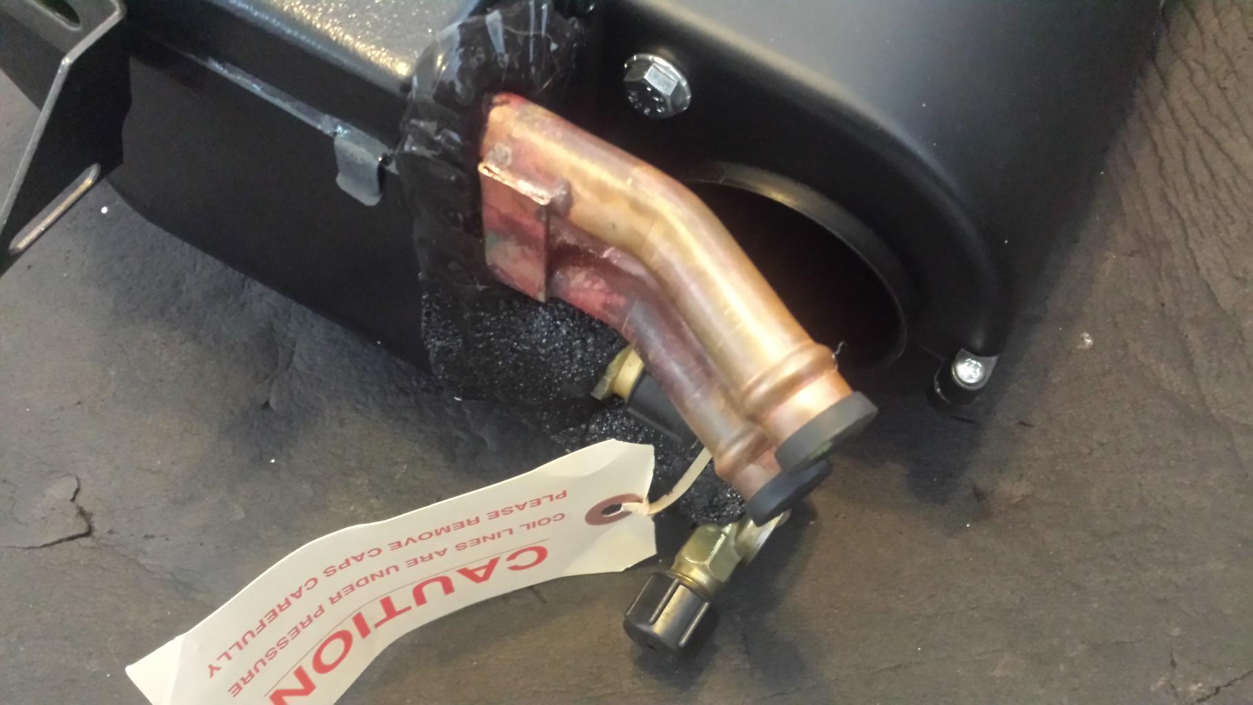

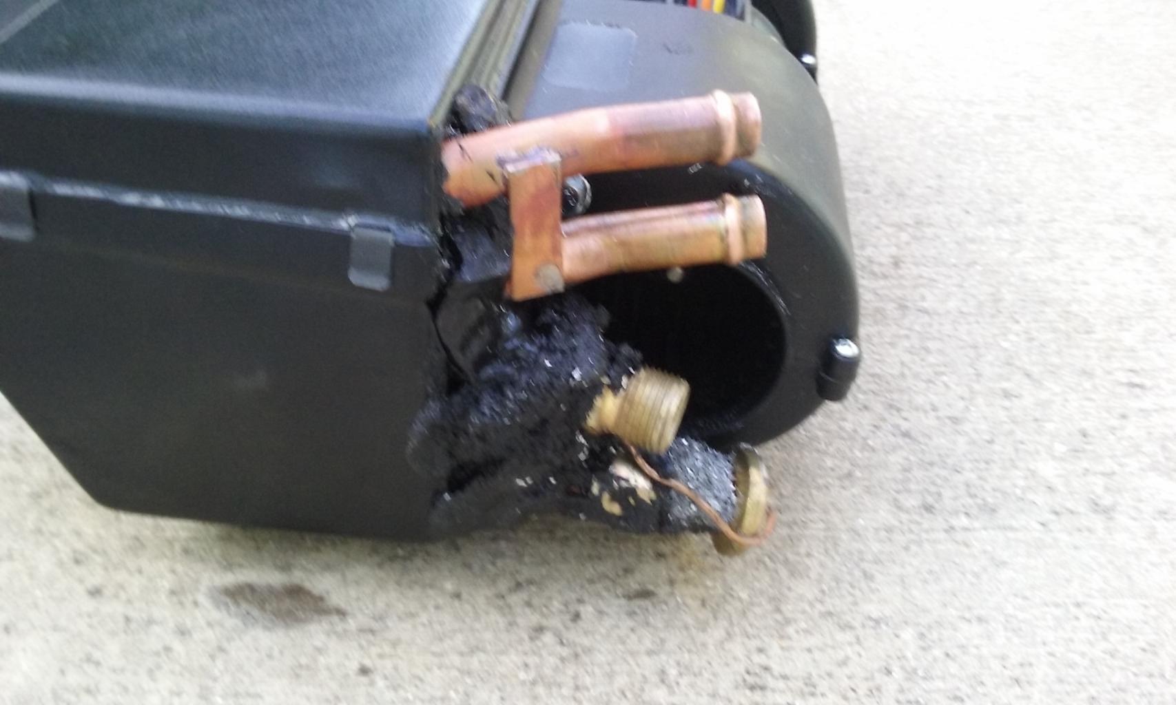

I need help fitting my evaporator unit. I just unpacked my Vintage Air system and noticed that the ports for the heater are on the same site as the refrigerant fittings. Also they are facing toward the wheel house and actually hitting it. Looking around for pictures I noticed that older units have the heater ports on the opposing site.
Thanks for your feedback.

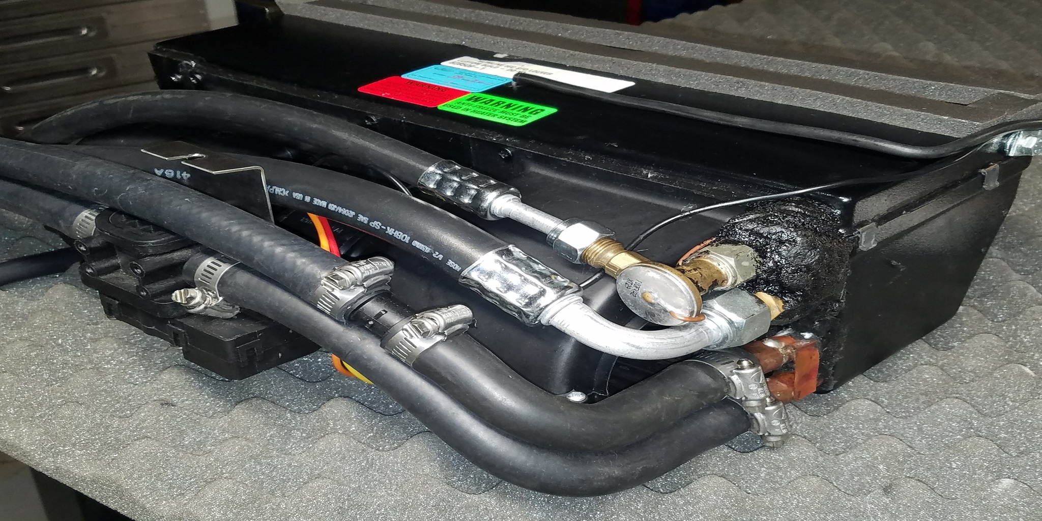

Stephan you are right the newer unit has re-arranged heater pipes. My old style evaporator was taking months to loose the gas. A difficult to find leak was in the evaporator core. Vintage air replaced the unit free under warranty, so I have experienced both units and already had side bulkhead cut. You can get new one to fit and keep the heater hoses inside the cabin. Last photo is what you have. Others show the copper tubes bent inward and up. I could fit heater hoses but needed very slim spring hose clamps for clearance. I used a drill shank that was a good fit in the tubes and bent them very carefully by hand. It worked with no leaks.
I do not use the RCR 'Anchor' ducting, it is far too heavy for what it is. I made my own smaller molding to adapt rectangular air outlet to 2 duct hoses. This works very well and I drive in Florida 90deg.
If I was building another SLC and making my own ducting I would rotate the unit 90deg. It fits and would make hose runs easier as you have freedom to bring them inside any position that suits. Hope this helps you.

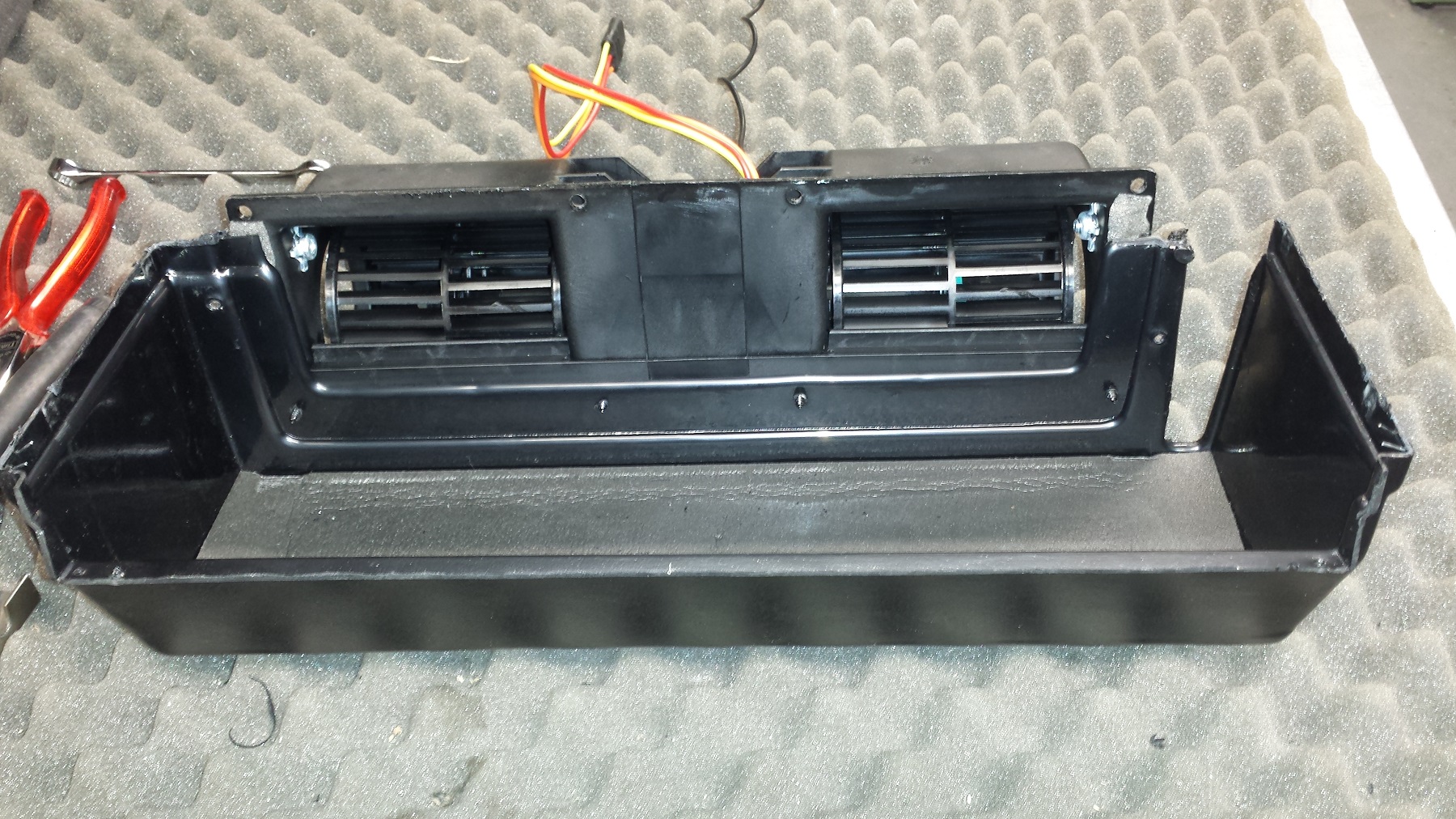

I am reposting this to keep it chronological and under the same title

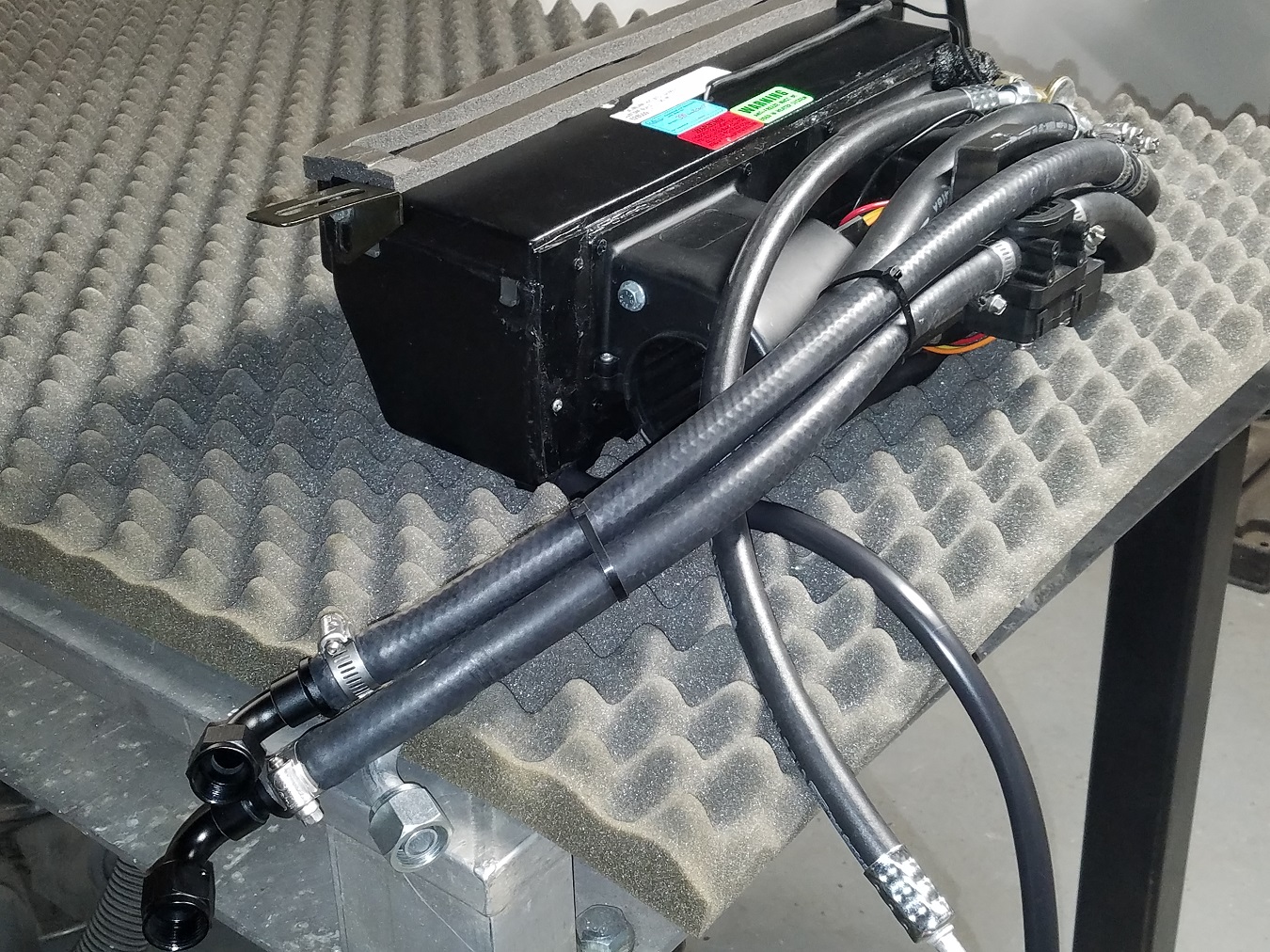

Here are some impressions on the alterations of the A/C unit. I inverted the evaporator 180 degree and added the servo valve in the back. Easy to service and to move without disconnecting a hose. The housing was shortened and the exit holes relocated back 2 inches. Plenty of room behind the unit now.
Thank you John,
Any comment is appreciated.

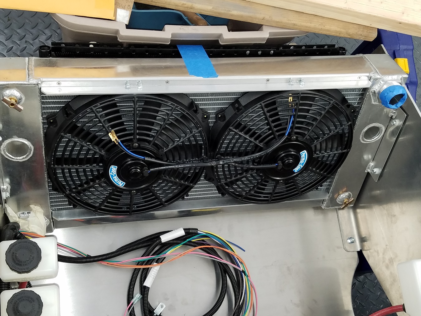

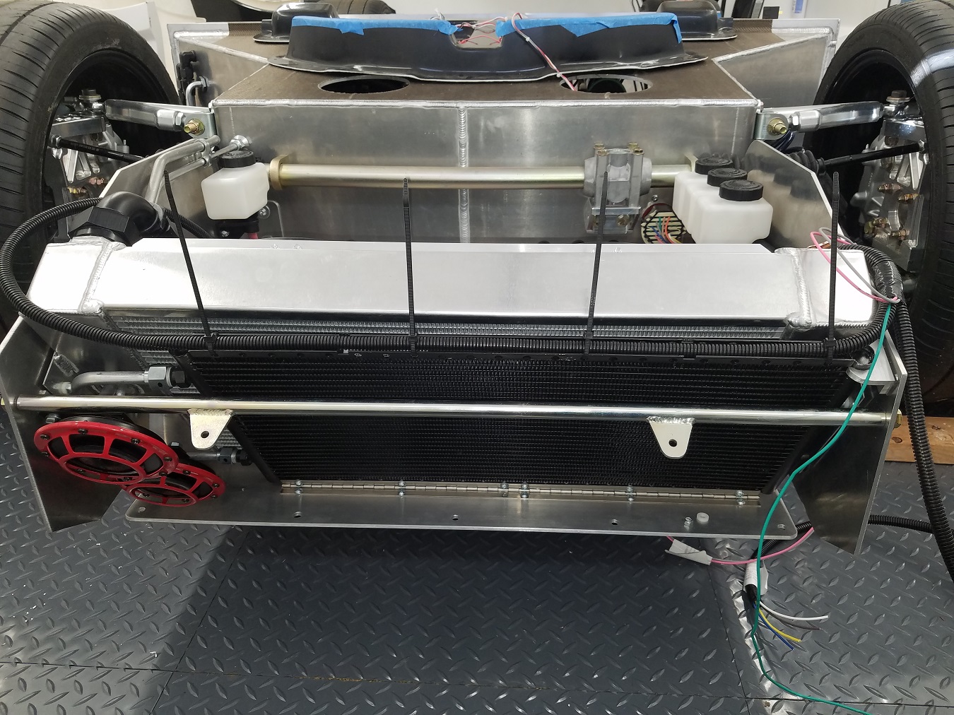

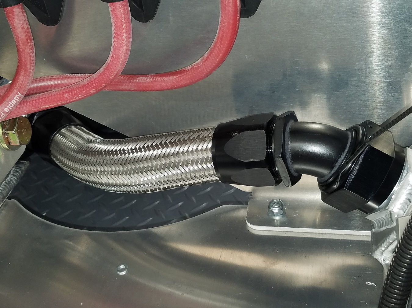

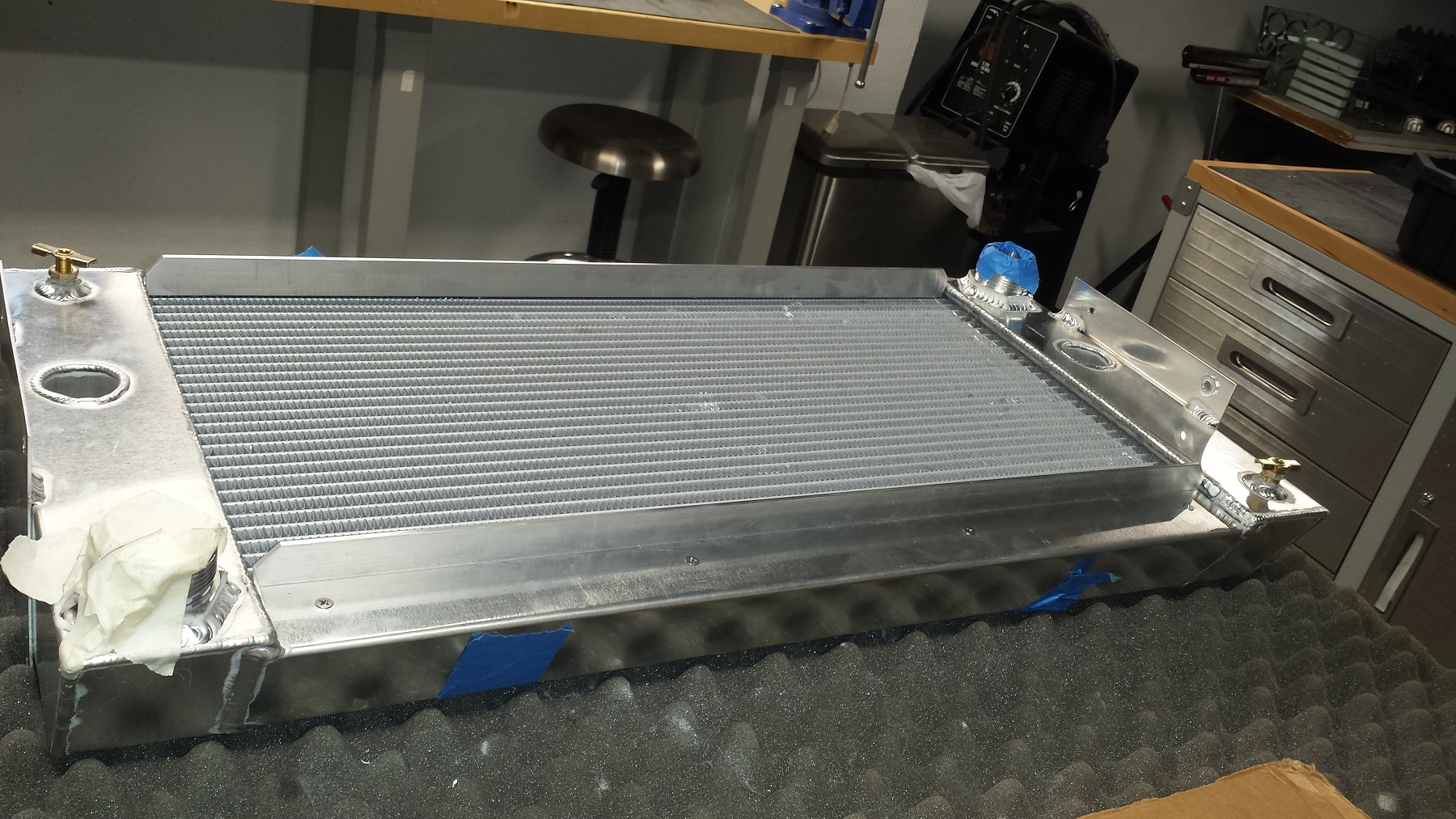

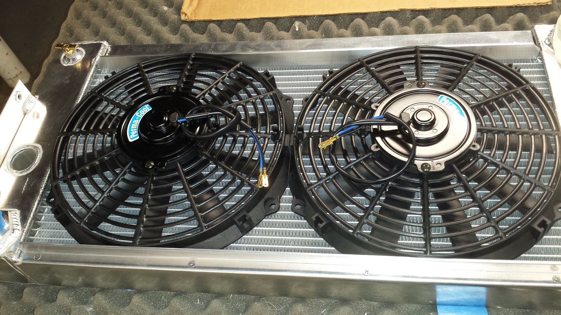

Here is what I did to the radiator. I converted to -24 AN. The original hose connections had to be cut off due to the openings in the radiator being too small. There was an obstruction and I did not want to take the risk and have a bottle neck in the system. While happily cutting I though why not trying something different... I also installed an very simple perimeter and cut back the shrouding on the fan surround to be able to accommodate within the space provided without overlap to the top and bottom.

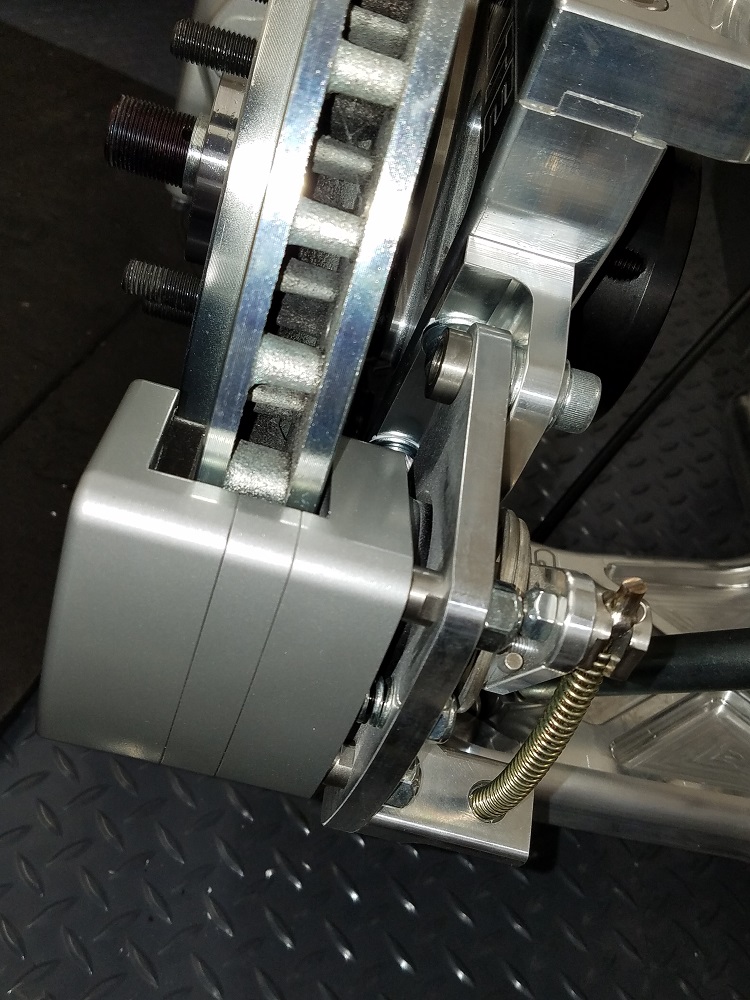

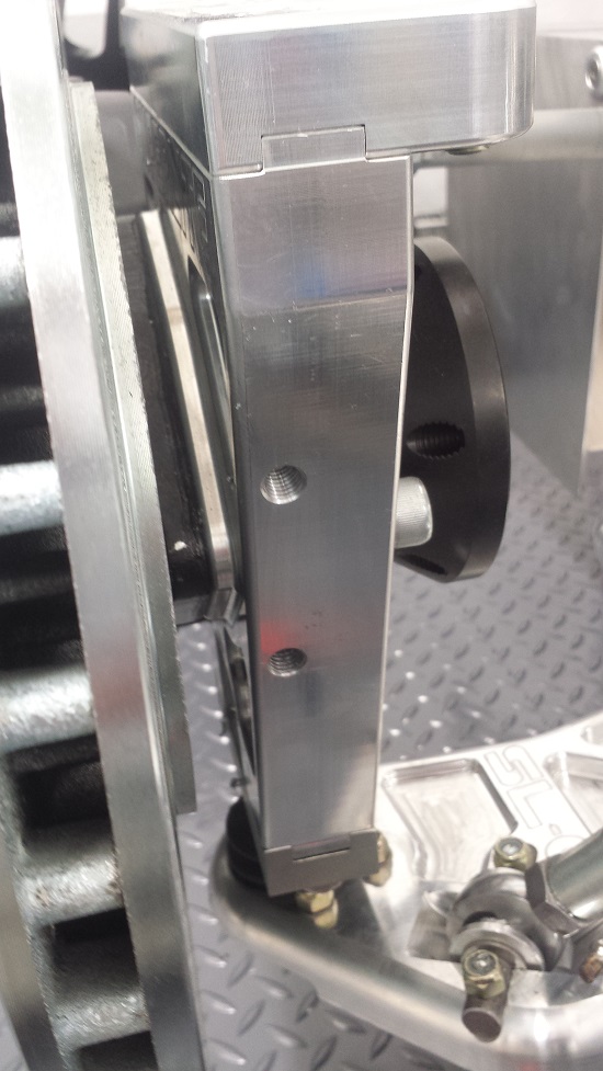

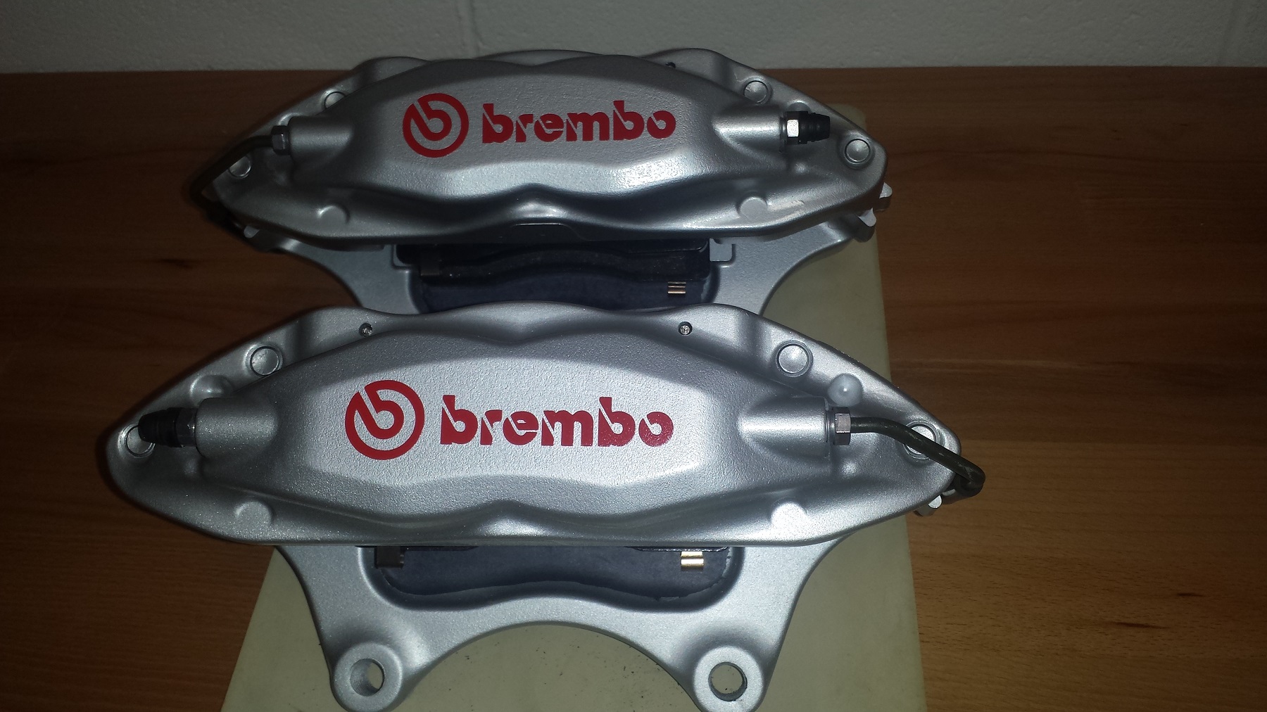

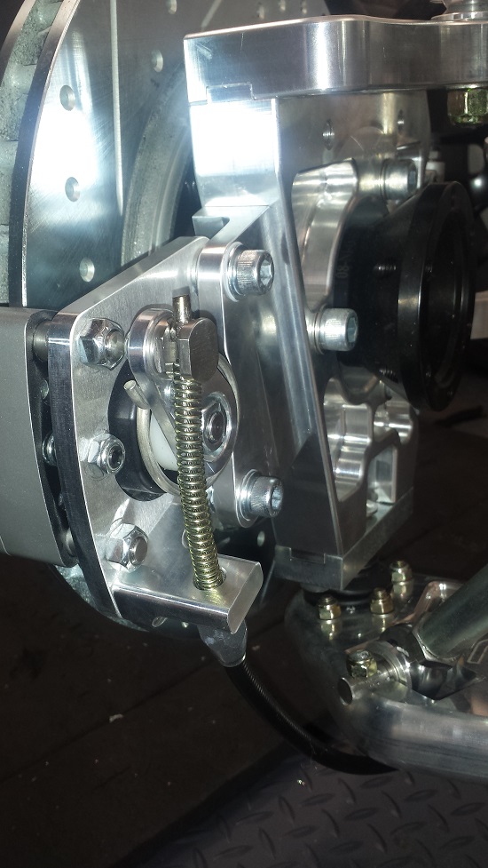

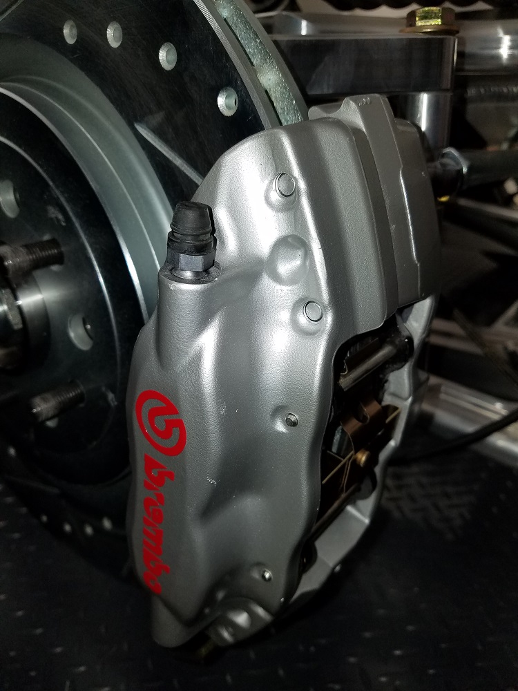

I am not sure if this is worth showing but to get the story complete I think I should document it. Work on the emergency brake calipers.

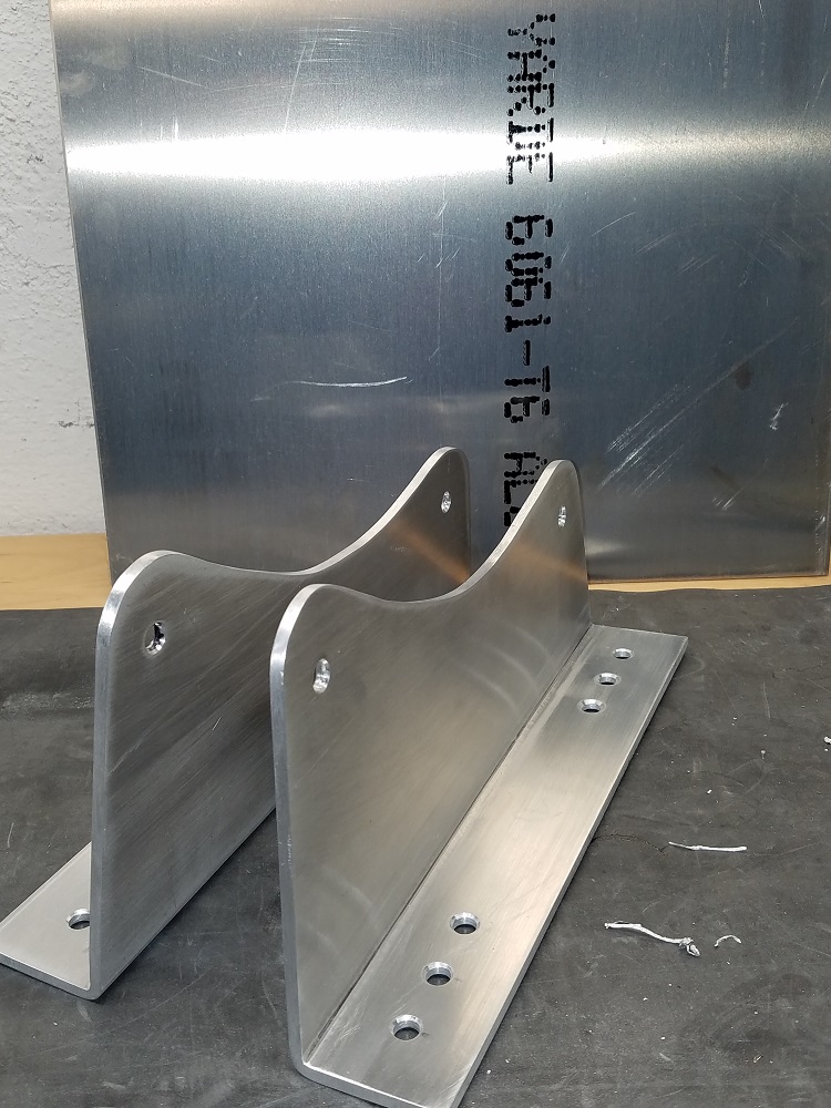

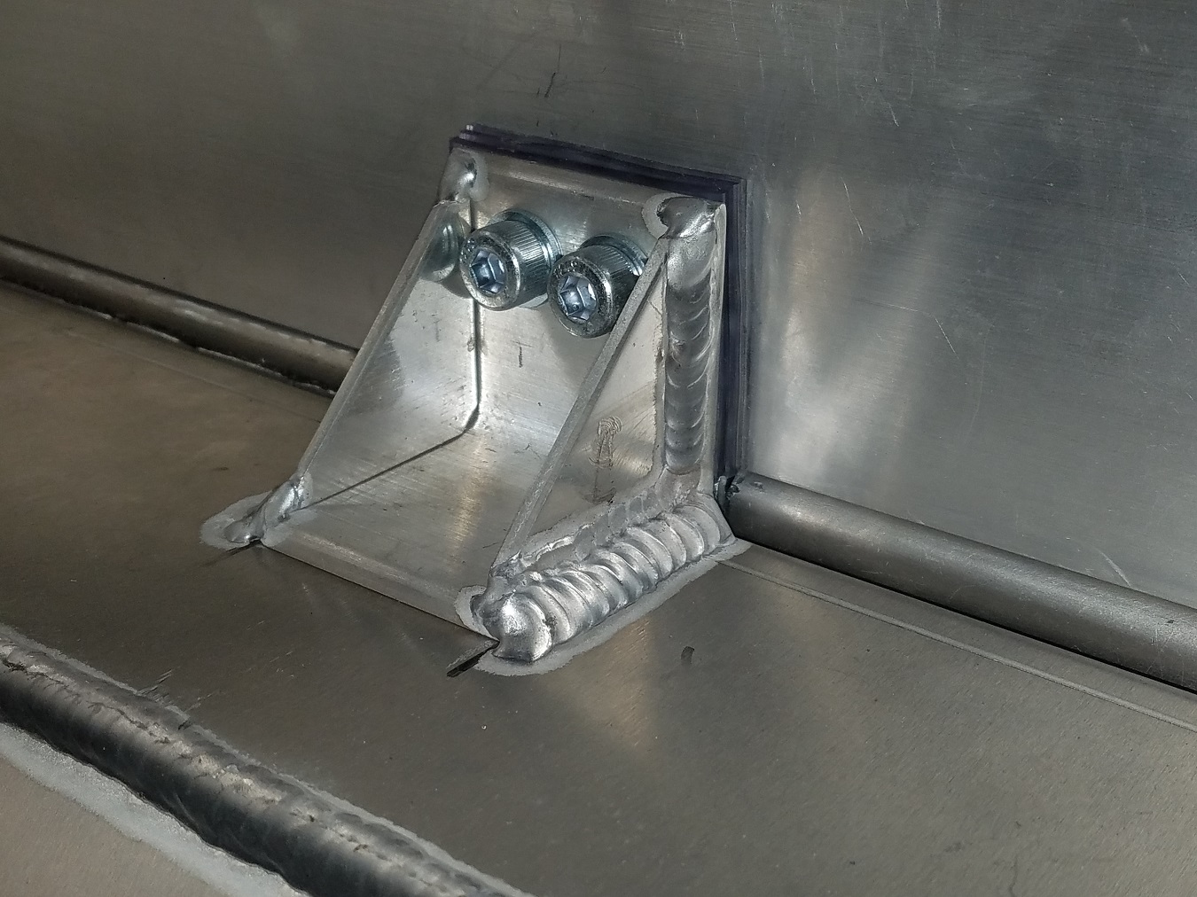

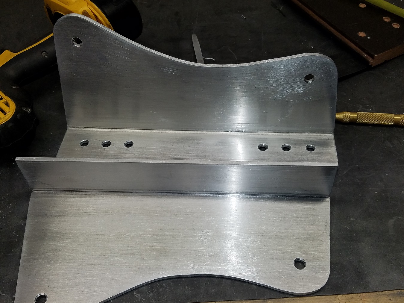

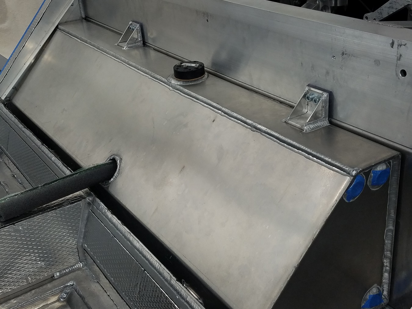

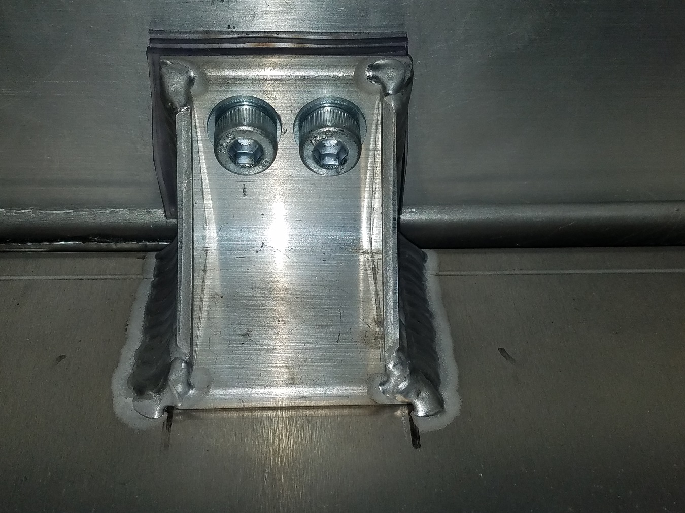

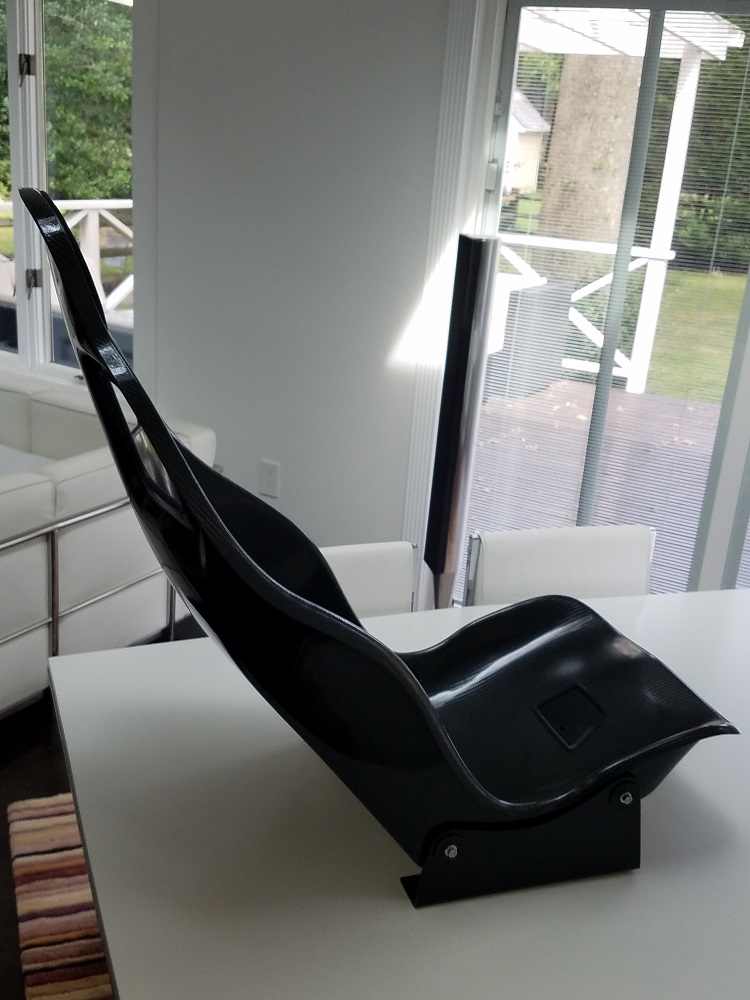

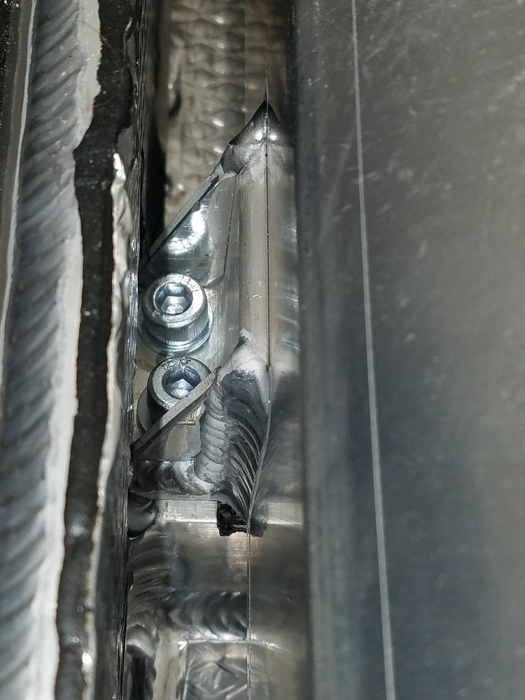

I sold the provided RCR seats and changed over to the Tillet B5. Here are some pictures of the bracket fabrication. Now they are parallel to the fuel tank cover and tub in a 45 degree recline.
...more radiator pictures. Here you can see how the -24AN tubing looks in action in the front end. I decided to mount the condenser to the side without any contact to the radiator and fill the space with the horns.
Hello David,
thanks for reaching out. You are correct. It was an easy method to block air from escaping underneath the radiator. Another reason was that the condenser is only mounted on one side and the hinge will support the condenser along the entire bottom. It also can flip forward and you can work on the radiator since there are not connected. This is a solid installation and nothing had to be invented. The hinge is very light and an easy and affordable part to source.
