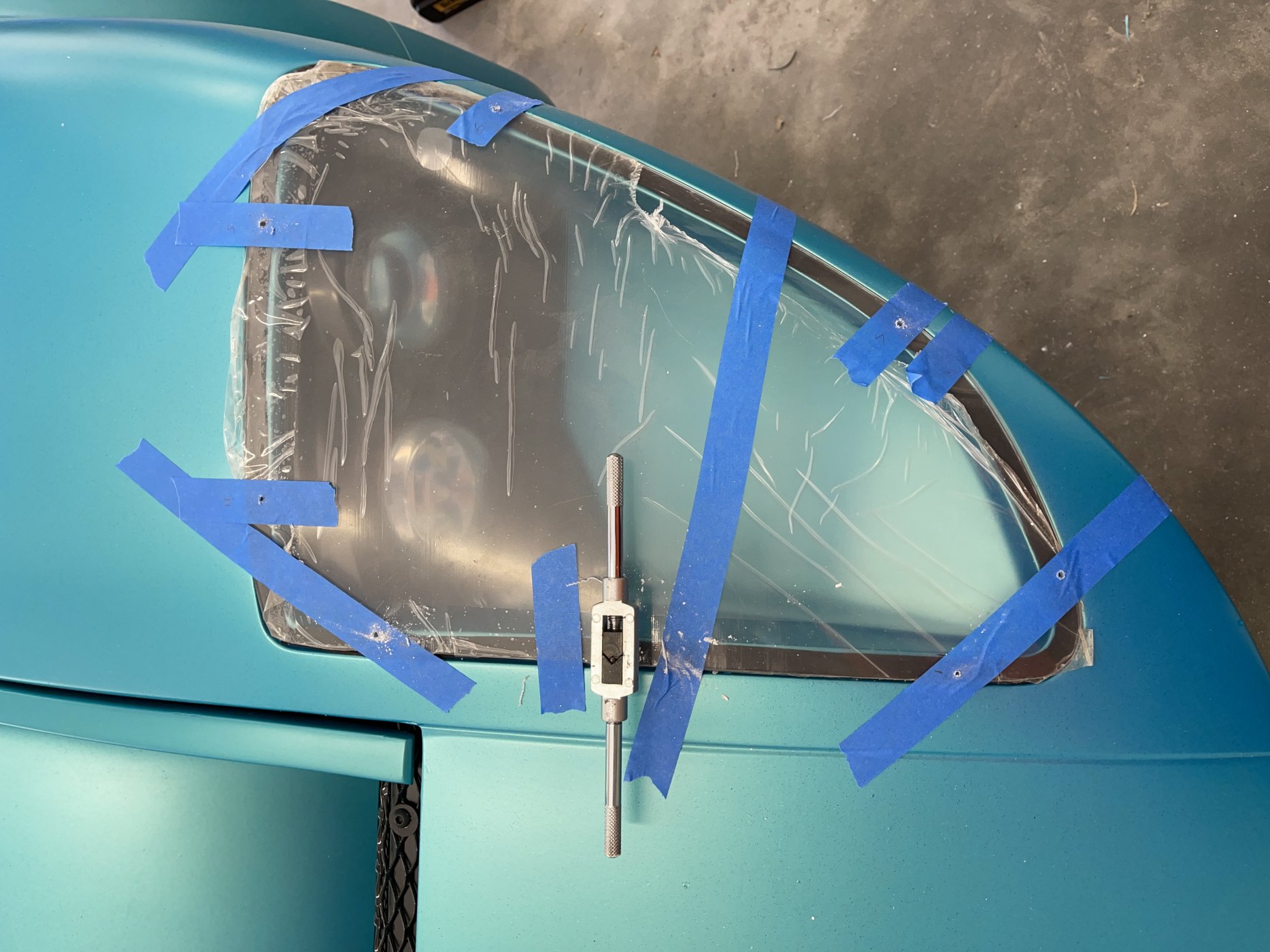

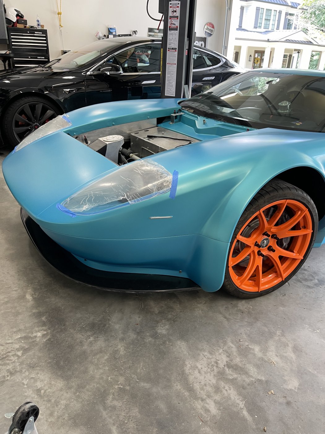

Getting ready to put on headlight covers. Tape, drill, rivnut.
From Mcmaster Carr I have 1/2" 1/6" thick weatherstrip.
Already have from prior order is 6-32 screws and a countersink bit: https://www.mcmaster.com/catalog/127/2664
Will tape the covers in place, tape over where I intend to drill, drill in place for all 5-8 holes or whatever is needed through plexi and body.
Then I will install rivnuts in body and take care of gentle countersink in plexi. Hope I don't crack my covers. But then, I'm finished.

Despite me drilling the wrong size holes I got the headlight covers on. Awaiting the correct hex head screws to finish it. No cracks in lexan yet.

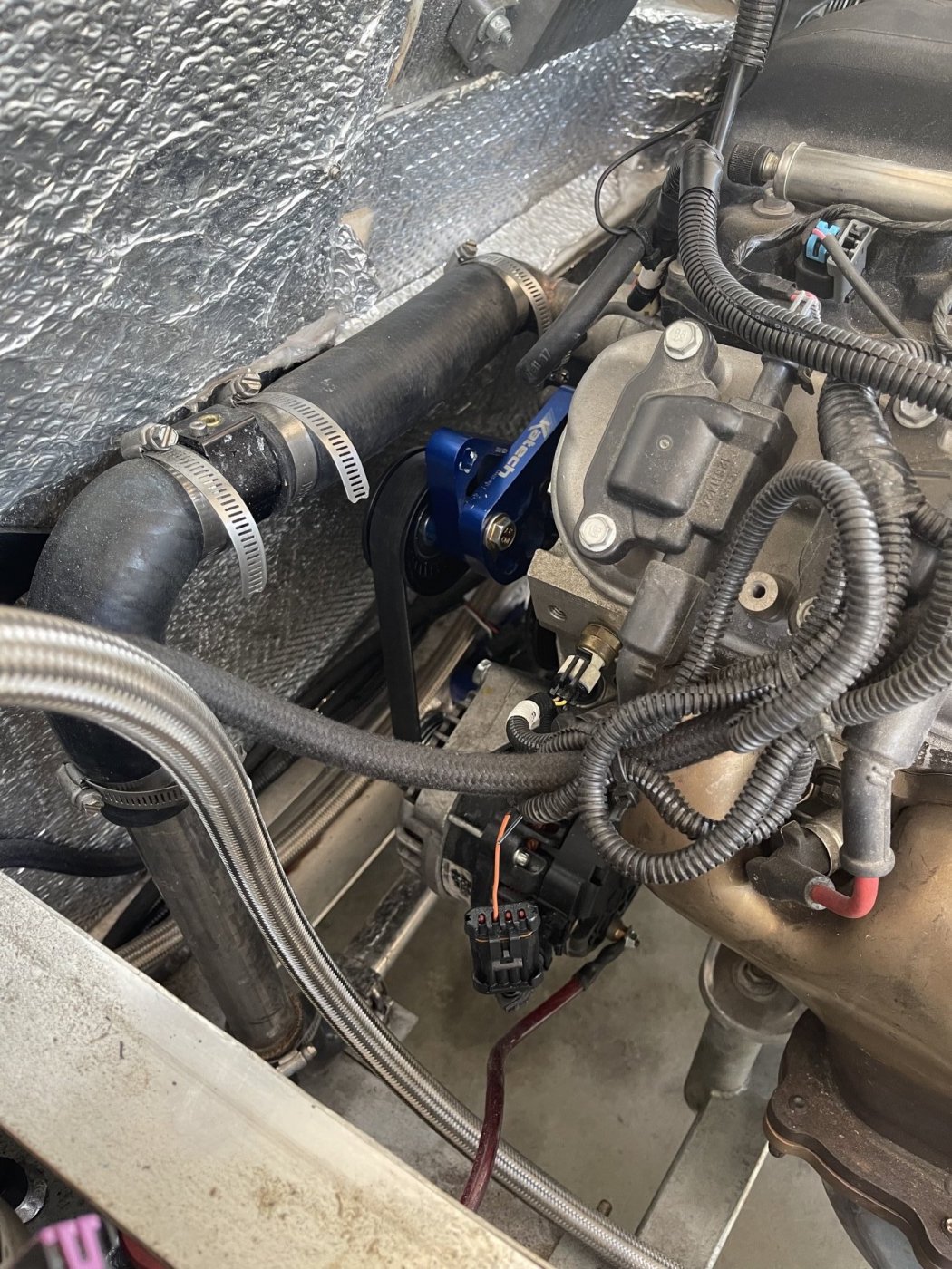

Alternator not charging. New 8301AN for Chevy Silverado from Carquest. Fits perfect. But with car running was only getting 12V. Needed to jump start twice. Will see if Advance Auto can test it or replace it with limited lifetime warranty.
Idler pulley was a dud. It is in the pic above the water pump and next to AC. It was a little bit smaller than the other two on the front dress, and I think narrower between front groove and front end. 2 belts shredded in under 200 miles.
Open to suggestions on both of above. I did have a replacement pulley and installed it. Things look like they line up.

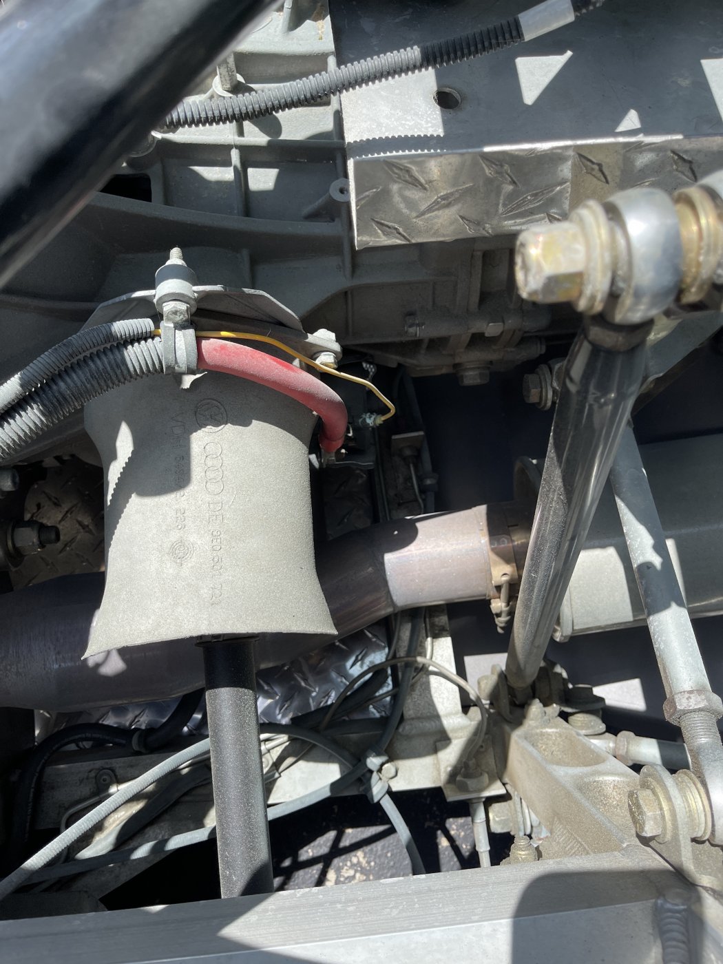

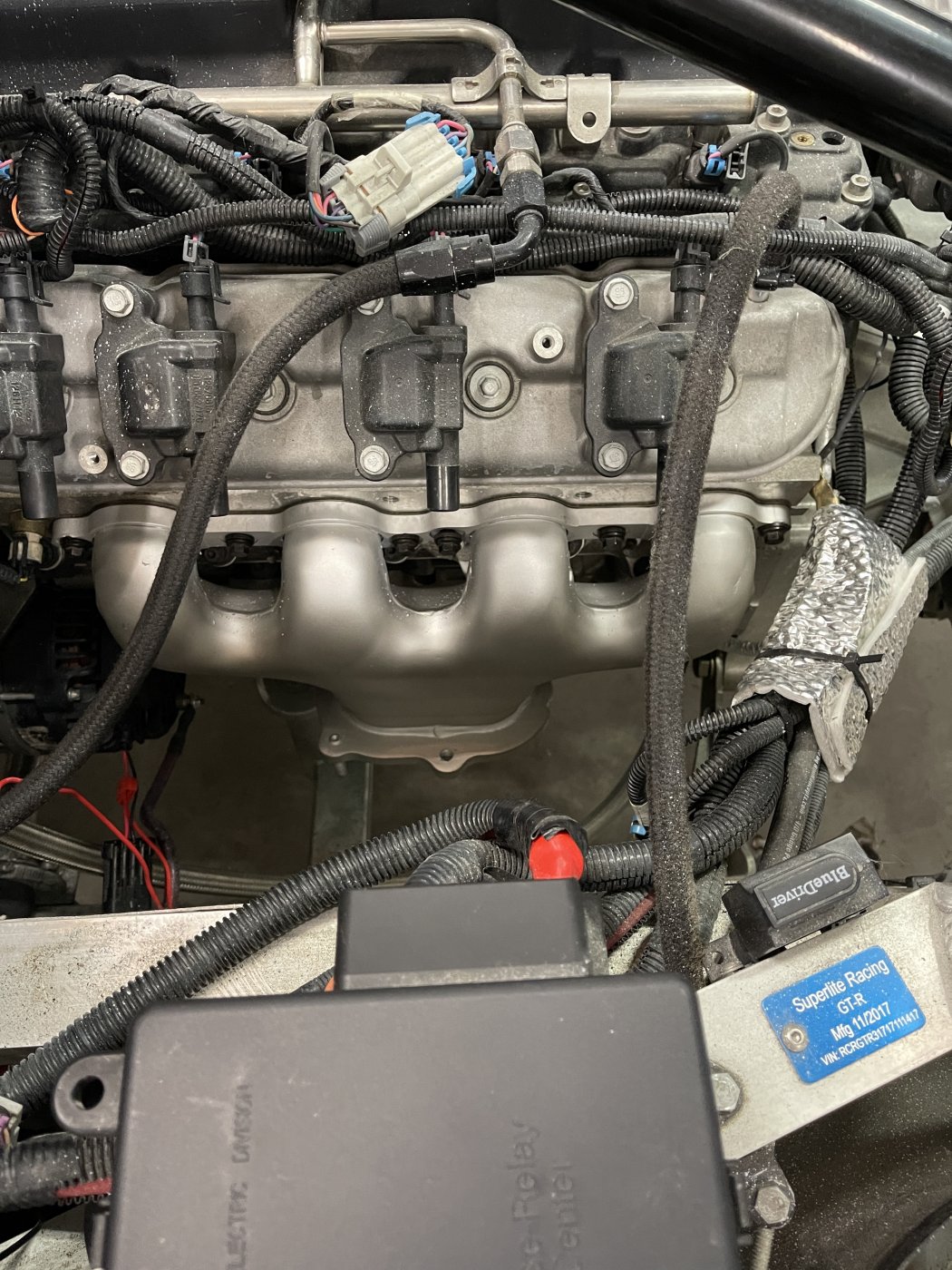

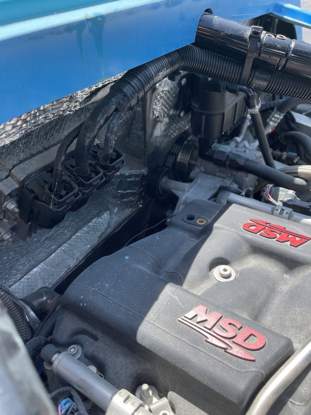

Wires in loom to close to headers. On top side was cam sensor wire and alternator 1 wire. Now in heat shield and rerouted. Slightly melted, but loom took the beating. Under the cat was the starter ground. Insulation melted. Got to cover and heat shield it. The starter + cable was too tight on the CV shield and got it wrapped now.

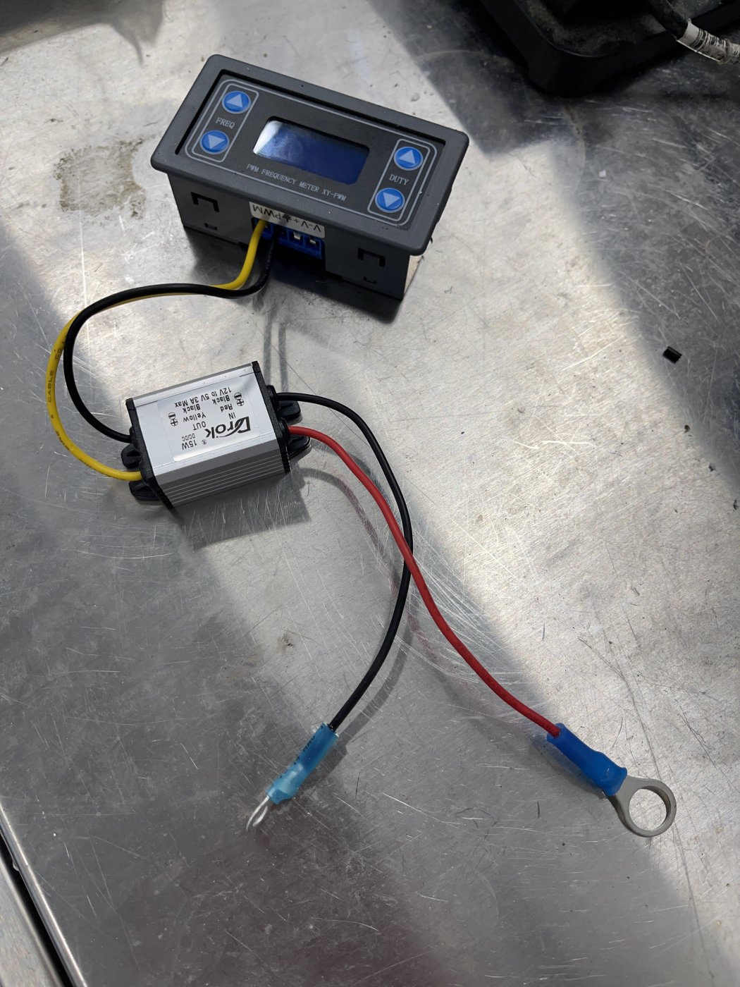

The above pic is showing the 12V to 5V converter and the PWM. If you look at the wiring I have the yellow wire in the incorrect position in this picture. Yellow is V+, black is ground, will run a wire from PWM to alternator L tab (tab closest to 1 wire lug).

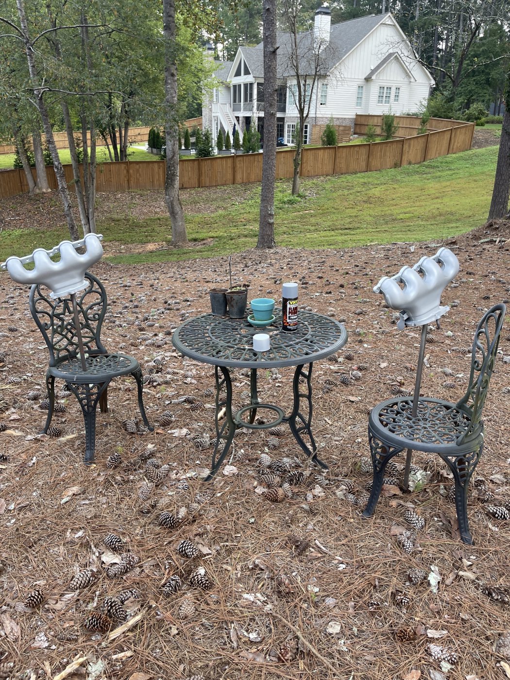

Been a bit. Pulley problem was not just the undersized idler. My Katech adjustable idler loosened up from the Superlite mount. It was leaning forward 5-10 degrees. Took it off, cleaned it up, bolted back in tight. Hopefully all is right with belt now.

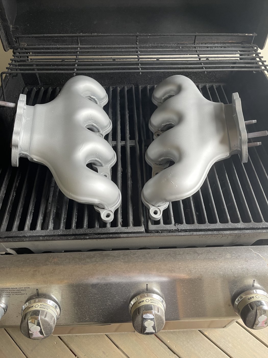

Removed the exhaust system and wrapped the pipes to the muffler. Used VHT primer and paint on manifolds. Not real way to wrap these things. Jet-Hot is better, but they wanted $1000 for manifolds and a total of 6 feet of pipes (about 3 feet per side).

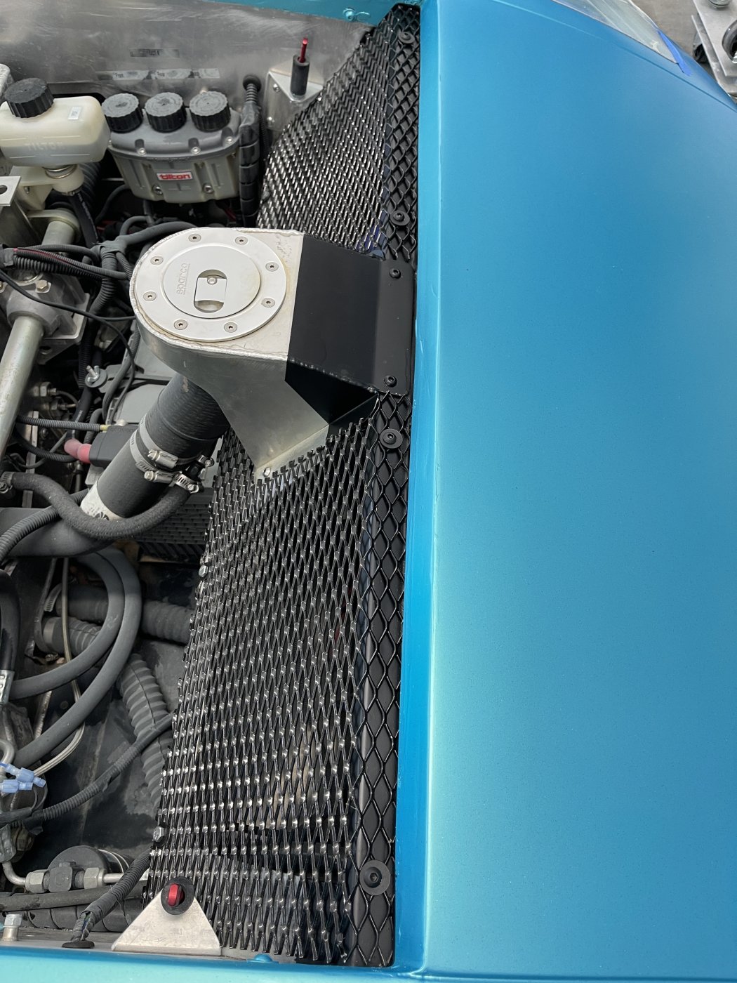

Tomorrow should have it buttoned up and running. Want to add foam tape to H-Crafts front wheel well liners to reduce a little vibration. Have to JB weld on some zip tie tabs for my mesh.

Loose front dress or something. Another belt thrown. Got a 1/2" shorter belt. Going to go over every bolt on the front of the motor and see if something has loosened up. Ugh. Keep pluggin away.
Steven Lobel

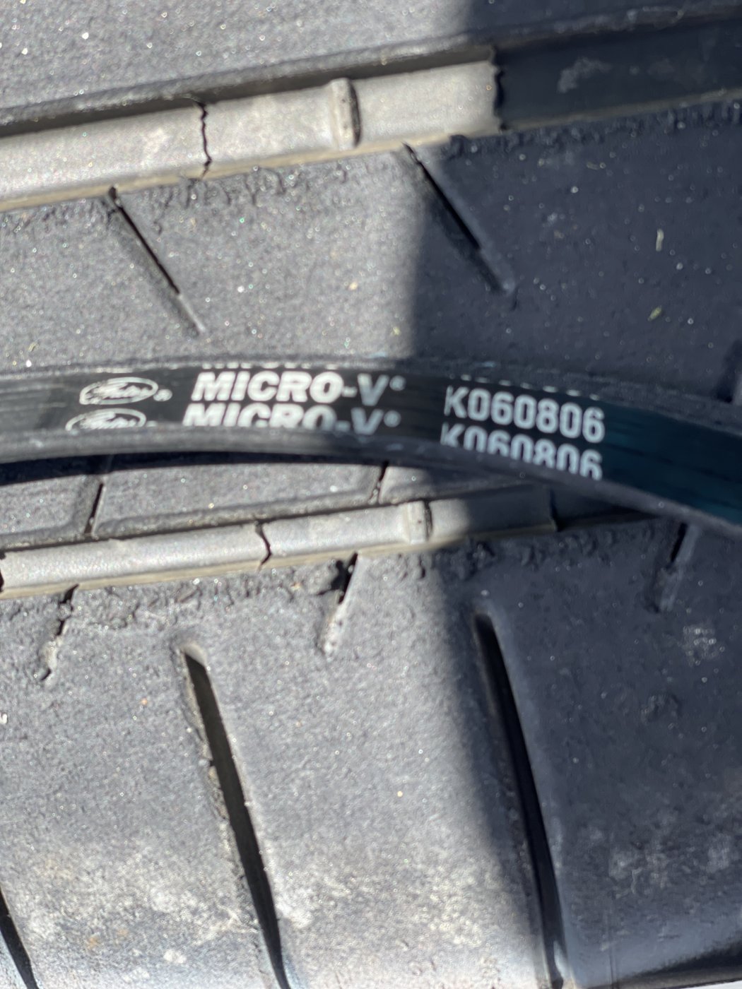

Able to swap out the belt. I was able to downsize to a K060798.
80 3/8 outside length.
A full 3/4" from prior K060806.
Certainly able to get more tension on this one.
Hoping my belt was just too loose the entire time.
