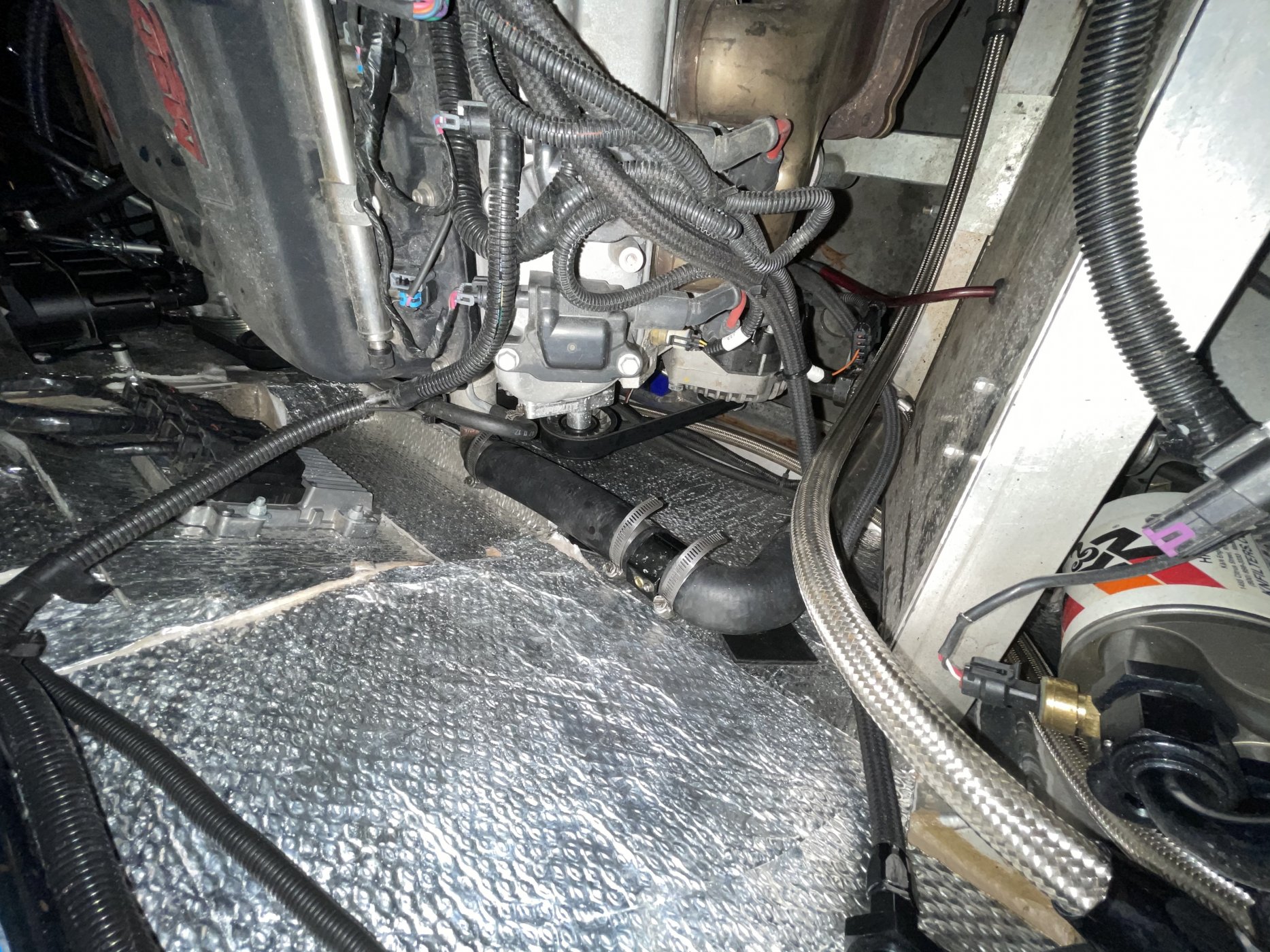

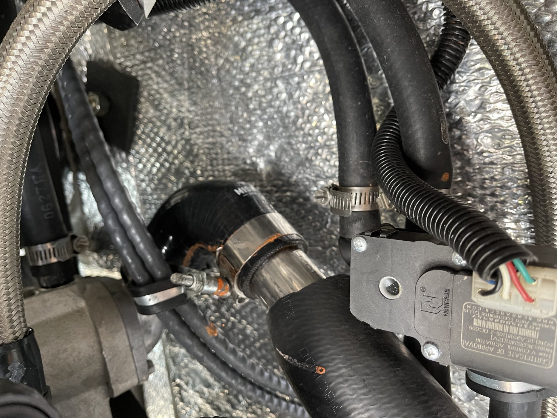

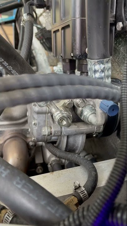

Ideal hose clamps. That’s what the Lemans car has. They never leak. For some reason I had it in my head that T-bolt clamps were superior. Maybe in price. 9 in my front setup. 15 in my rear. Going around replacing them all. Nothing but leaks. Yup, I even replaced almost all of them once thinking they were 2 mm too large. Anyone need 30-40 clamps?

Managed to fix my AC leak ( I think). Large leak from low side schrader valve and small leak from high side. No leaks at my crimps after I fixed the one at low pressure fitting at compressor. Got to get another can of R-134 to test it. Was blowing cold.
Coolant leak fixed with cheap hose clamps.

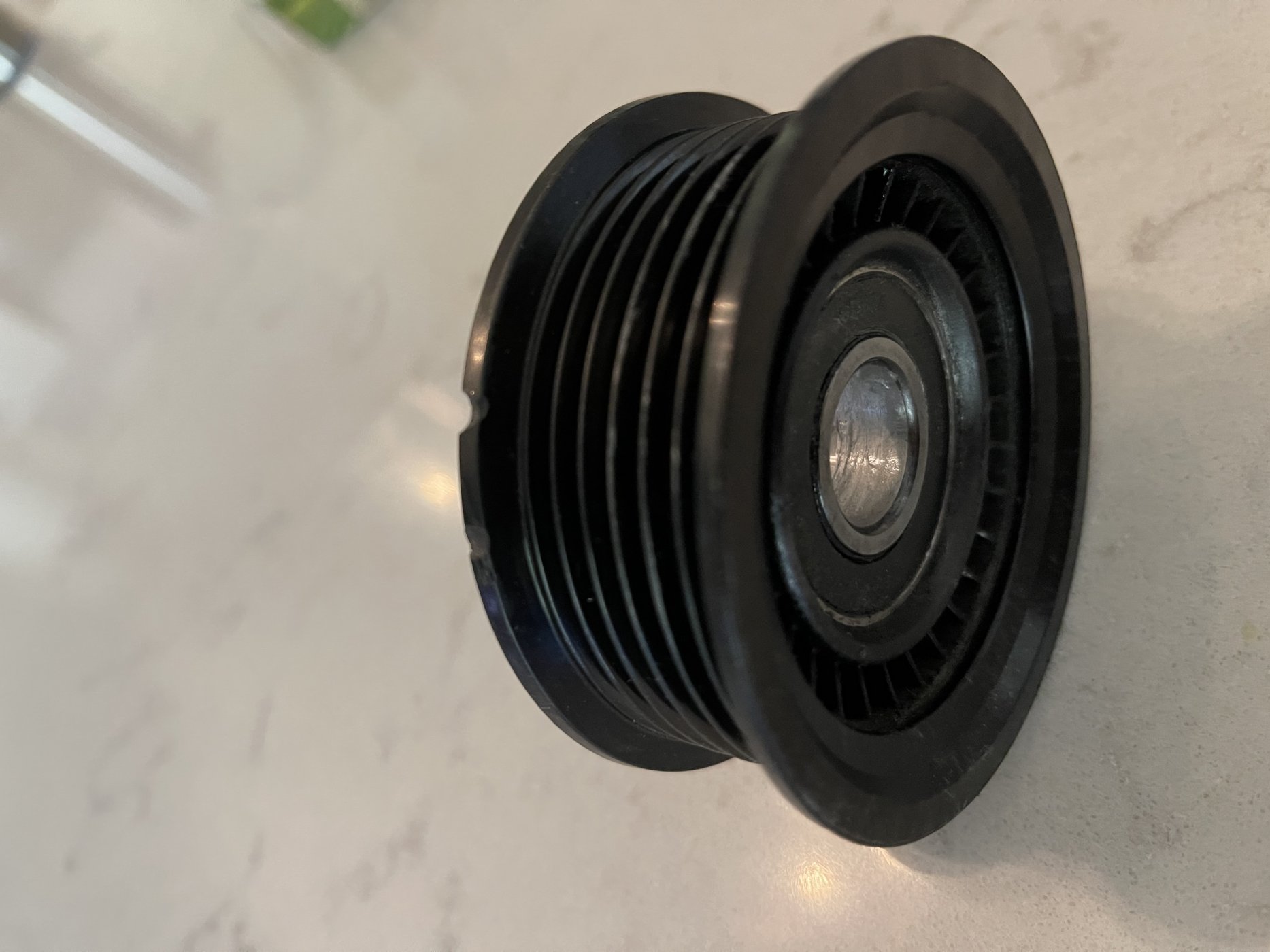

Shredded my serpentine belt this weekend. Maybe alternator alignment off, maybe an idler pulley had chips. Spare belts ready, pulley replaced. Hope the pulley is the answer. Thoughts?

Larry L.
"Maybe alternator alignment off..."
I've always checked pulley alignment by simply laying an appropriate-length straight edge across the face of two adjacent pulleys.

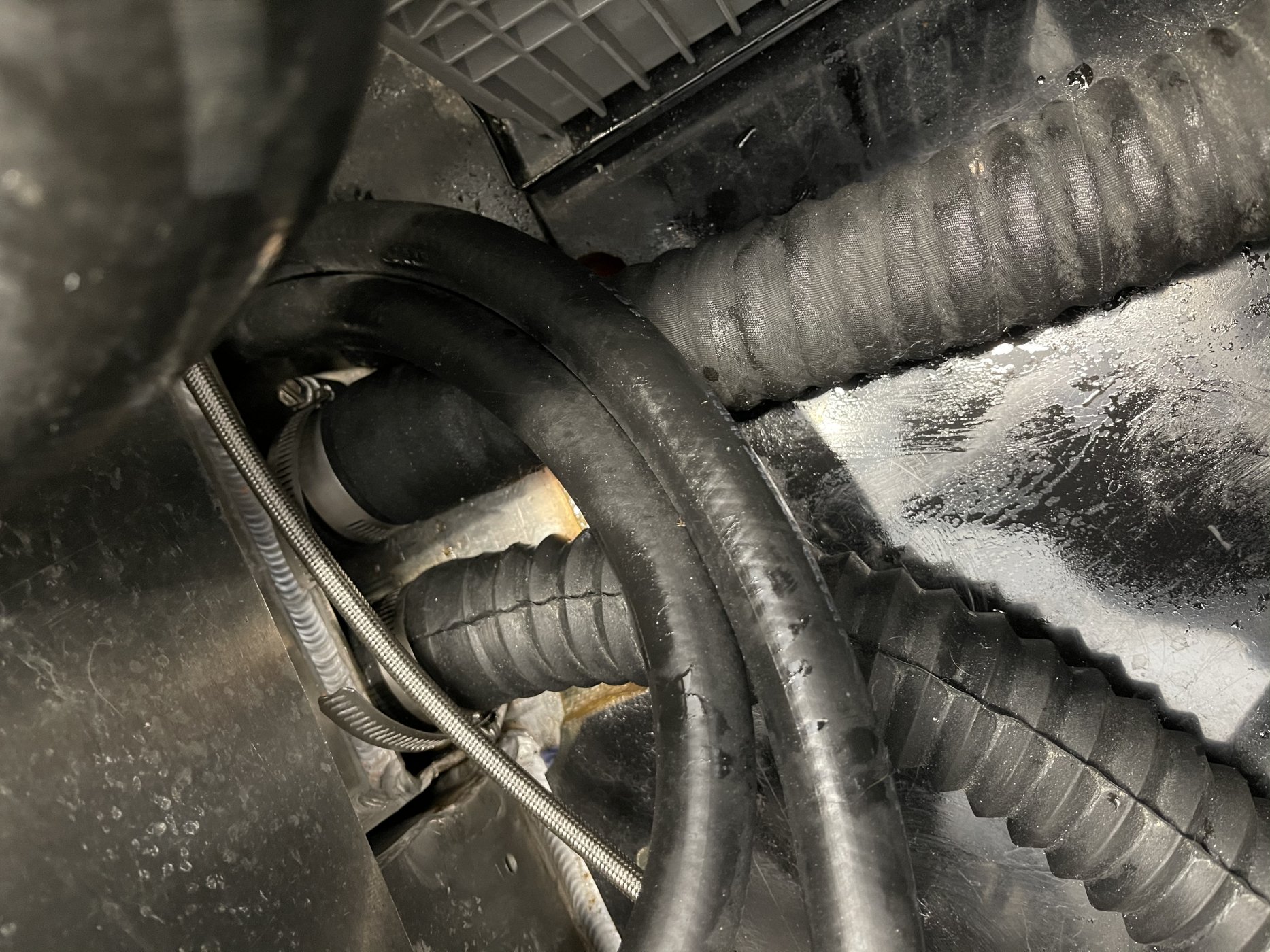

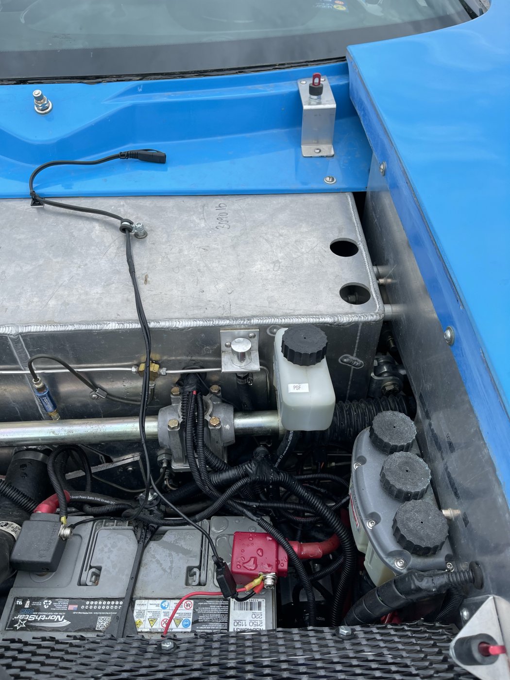

Track testing today. A couple easy laps. Brakes require lots of push, but hey, they are manual. Only weird thing was I had gas shooting out my VVR vent check valve for a few minutes in the pits. Popping the gas cap off did not remedy this. Called it a day when it happened after driving from pits to starting gate. Got home and took off valve and not clogged. Relocating from firewall to up under top of filler. Has not happened on street runs or prior track testing.
Original location:
New location:

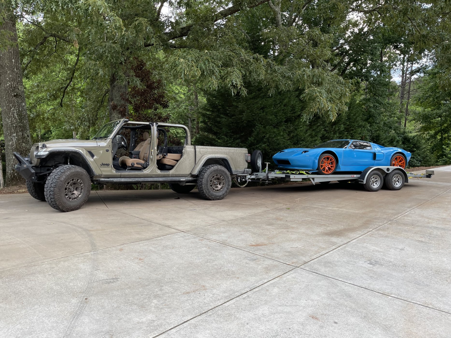

Loaded and ready for AMP.
62 and overcast tomorrow. Chilly ride up, great day for the track. If this goes well mechanically, I'm ready for a light sanding, a few filler spots, and RDE Customs in Kennesaw/Woodstock to spray it.

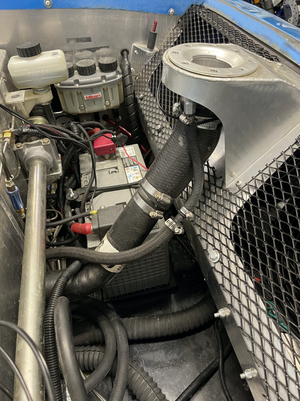

Found another small leak in coolant line-replaced with ideal hose clamps.
Idler pulley making noise, replacing with Katech.

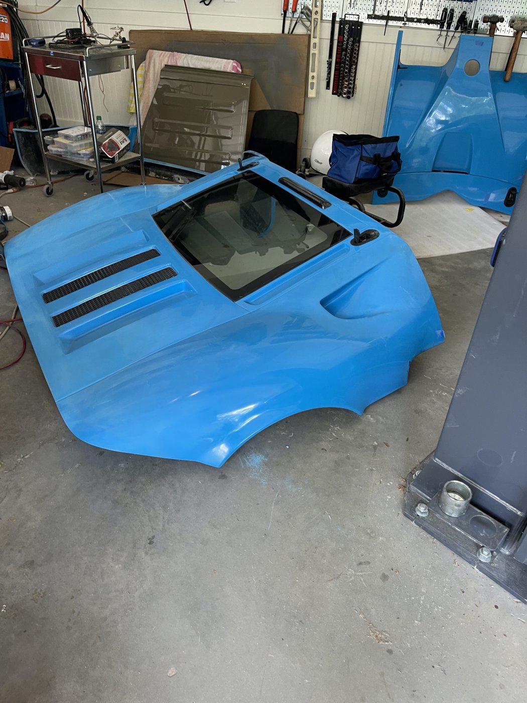

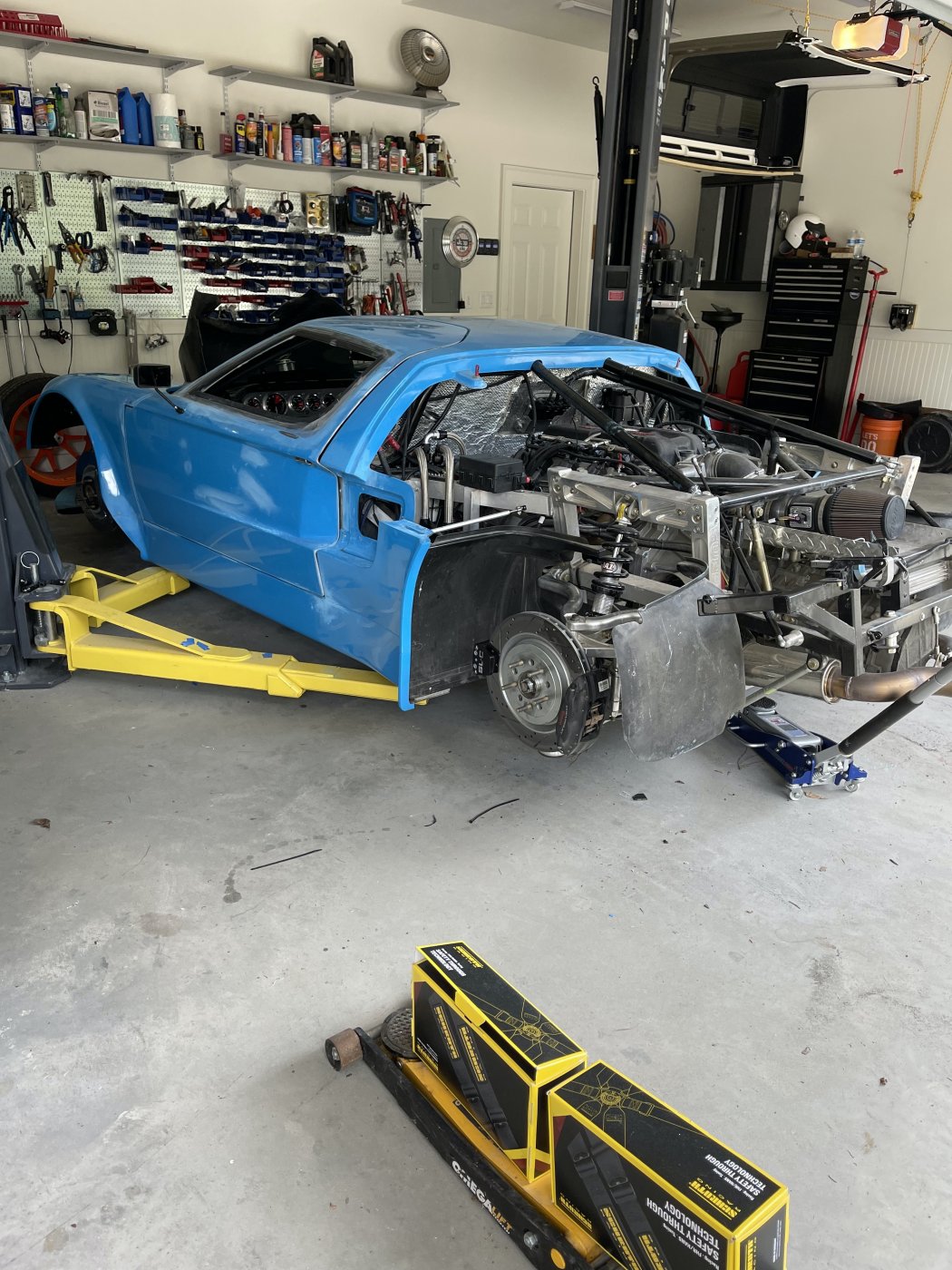

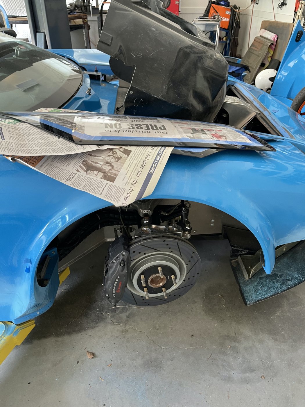

And while that is going on, decided to disassemble for sanding/filling and off to paint. So weird running 115mph one day and looking like it is demolished the next.
