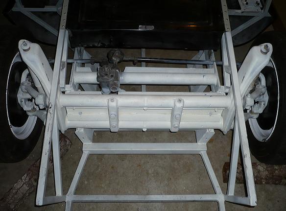

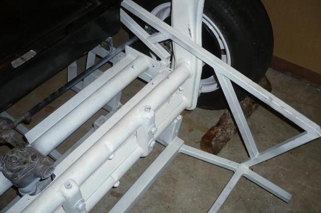

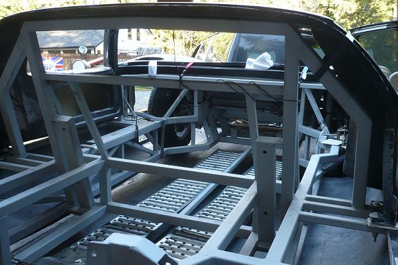

A GTD with the front welded on 4 inches too far forward would be most unusual. Post some pictures and should be able to identify and if you PM me a chassis number I can perhaps see what other info I have lying around.
Here are a couple of pictures, but not a lot of critical details I'm afraid. Reading a little more on the site, this kit has a space frame (?). My ignorance is fading already. Any observations are appreciated.
The type and location of the front end are my primary interest. If it needs to be removed and repositioned would we be better off putting something else back on.

Welcome to the site Tony. Saw something new today...A VW front suspension on a GTD. Between this and the Dr.Who string, this site has become a beacon of enlightenment.
That's the exact same front suspension I started out with as well (not a GT project though). Pulled it off, sold it on Ebay, and built a typical unequal length arm suspension. Can we assume you're handy with the welder?
Can you provide some information on your fabrications skills or experience or background? This would assist us in assisting you. There are other "modular" pachages out there for the DIY'er (Mustang II for example), all the way to a fully fabricated suspension and steering.

Leaning toward the Mustang II front end.
The VW front end comes off this weekend.
