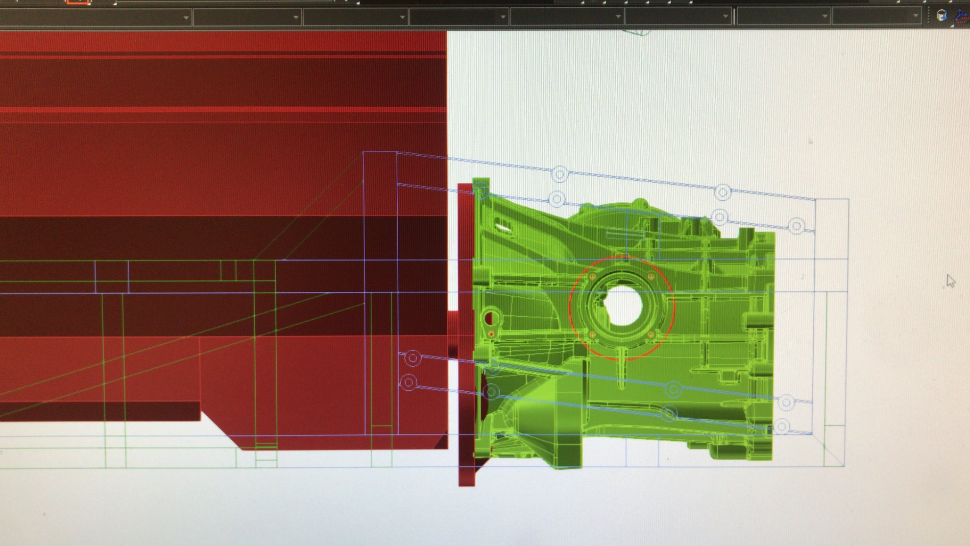

what do you think about an Audi R8 manual transmission ?
The position of the drive shafts would fit perfectly...
