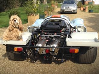

As my 917K is an outright race car, and in order to comply to "historic" type regulations in various series I have to run an aircooled Porsche engine. Mine is a "breathed upon" 3.6 ltr (964) engine and mated to a 915 gearbox for lightness. The G50 type are way heavier, and weight, or lack of, is everything in racing, especially with the 917, and the last place I want extra weight is on the tail end. Having to run silencers for most meetings does not help its balance, although I do remove the dog before a meeting !!!!!!!
